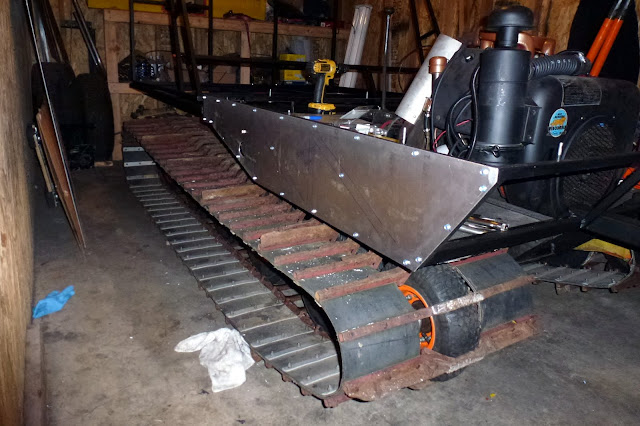

Got some sheetmetal done yesterday...
Cold evenings make is "no so fun to be in the garage" times... :(

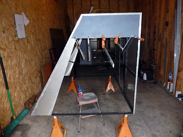

Side panes & floor bottoms... 1/8th thickness...
Front had to get some bends into it, upper & lower lips to wrap around...
Took a Dremel tool with cutting wheel - cut a line 1/2 depth of the sheet in the location of the bend (from inside), then just clamped it on my welding table and hand bent it to the right angles... Came out farely easy and simple...

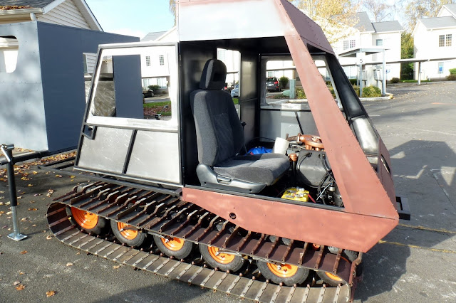

front cab wasnt much different... just a little more detail on smaller pieces...
LOTS OF SCREWING... :clap::clap::clap::wow:

Finished both doors last night... left garage at 1 A.M., crazy tired, but end result was very satisfactory.
Had the glass guy look over the doors & round ends... said it will be perfect.

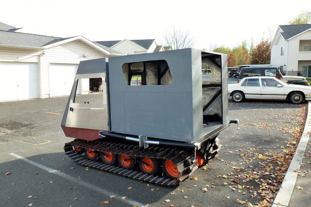

Anyways... getting ready to paint and putting on the final touches.....
so here we go...

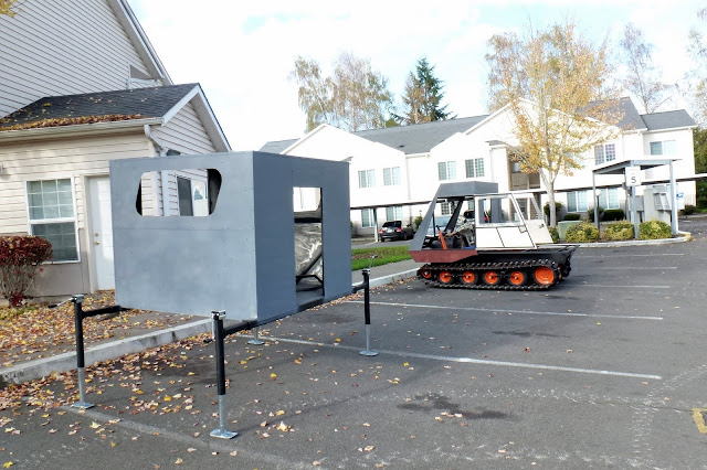

the whole idea behind removable cab...
:clap::clap: so far looks pretty sweet...
and a little video to finish it up...
