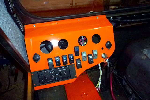

Re: lights... more lights... more buttons...
I guess its true - pictures speak 1000 words...
So, for anyone with a question, feel free to ask.
[ame]http://www.youtube.com/watch?v=vDbDLbciU3s[/ame]

Nikson,
It looks great. I was curious have you considered building a compartment around the engine to help deaden some of the sound and even help with potential fumes.
If you dont mind sharing where did you get your fuse/distribution panel and your interior led dome light? The cat looks great and functional!!
Great work! Like the yellow top Optima for power source. With the Led's you should have nice bright light for night time running. You just need a bunk and a stove in the back and you are set!:clap::clap:
At this point, thinking of just running it as it is, afraid to take away any leg room as it is with the engine by doing the engine cover... plus I highly doubt that I will be able to get rid of a lot of the noise unless I do a heavy duty cover... but than again, with the air cooled engine, it wont be an easy task... - so to answer your question - no, no compartment., the ceiling fan will take care of the air circulation, so there wont be any fumes/bad smell issues.
All the electrical components were provided by my buddy, I bought it from his company's warehouse (they specialize in government rigs - policy, fire, EMT, etc). So components have been tested to be reliable & good quality. I honestly have no idea on the brand names, but can find that out... All I can say is that they werent like "cheap" :)
LED lights (including the interior one) are great and barely consume any power, my Wrangler is setup all LED as well, and I've ran lights on it few times for the complete night and battery didnt even "feel" it...
If needed, let me know I might be able to outsource those components at wholesale, since retail its all just "MADLY OVERPRICED"...
