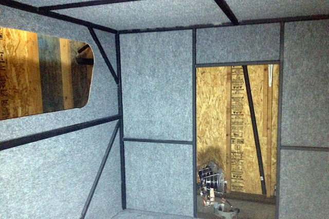

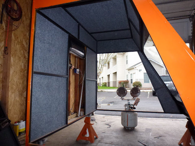

Re: rear cab interior - carpet
Pulled in another late nighter...
Got the rear cab carpeted from inside...
Will have to do some touch up on the frame paint, but nothing major.
Following 2 components were used...
Glue does wonders...
Had it taped up to prevent glue over-spray to the frame rails

if any thing the carpet gives it a nice cozy /finished look should help dampen some of the accustics in side the cabin to i used 1 inch close cell foam on mine dosn't look as good but it's quite warm.
Cozy is what I was going after... :)
That sure gives it a nice look.Not too dark so it should let those windows brighten things up inside.

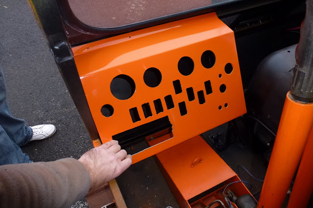

Re: dash/gauges
Cut the spaces for all the gauges & buttons...
Looks like it will come out to be a nice cockpit:clap::clap::clap:
Plan to keep it orange as well...

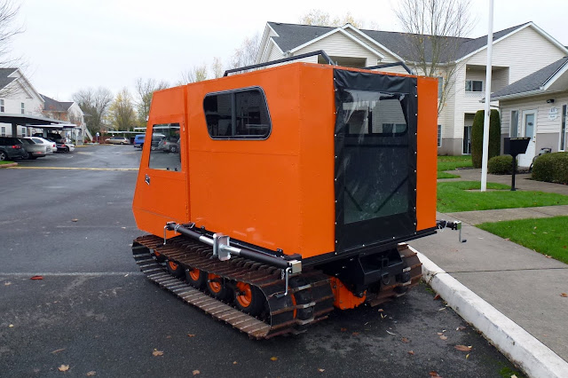

Re: Rear cab - soft doors/windows
so soft doors came out something like this...
I think they turned out alright...

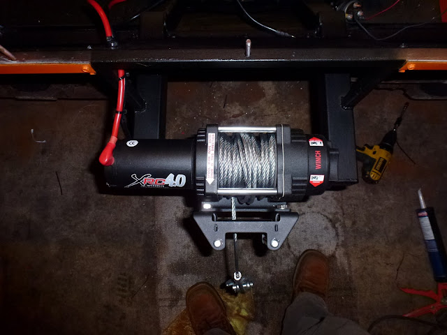

Re: winch & battery mount
got the winch plate welded onto the front bumper mount...
looks good, only concern that I've thought about is that I've stuck it out a bit far forward may be... not too bad though after everything will be done.
I guess time will show.

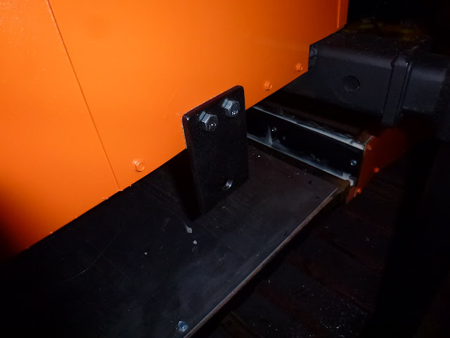

rear cab mounting tabs are pretty simple... few holes & few bolts...
some attention to the detail...
hitch pins to secure the cab on the rear bed...

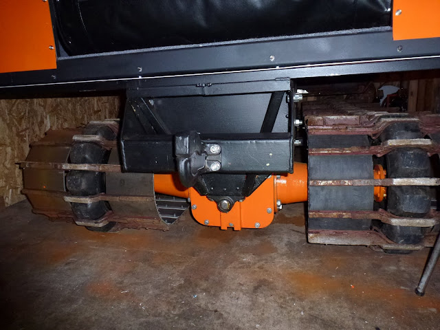

Re: tow hitch
I didnt see much functionality in the factory towing system for my use...
so I've gone this route...
I use rear carrier basket for extra gear... so this will be much more functional.

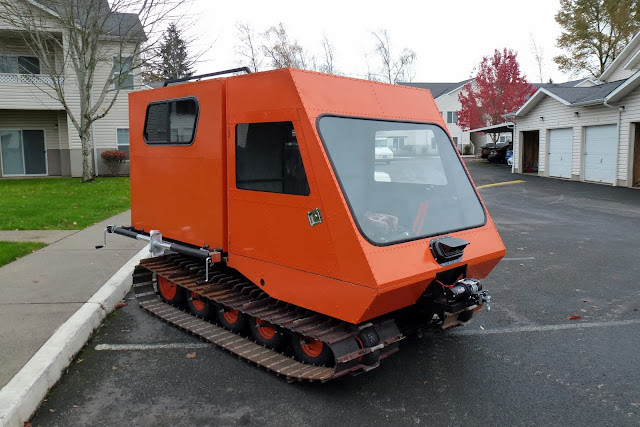

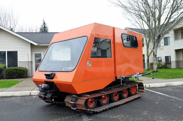

Re: Thiokol Imp 1402 OpenTop # 129
so... the new look...
ta daaaaa... :)
:flowers::flowers::flowers:
with the rear cab off...
and cab on...
and for those how doesn't have an idea of the dimensions on this thing...
I'm about 5ft 11in
