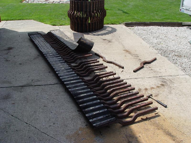

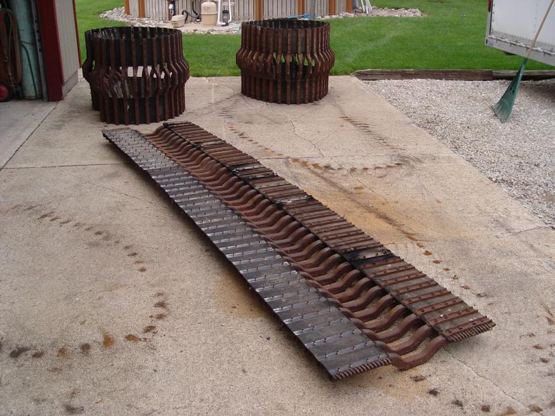

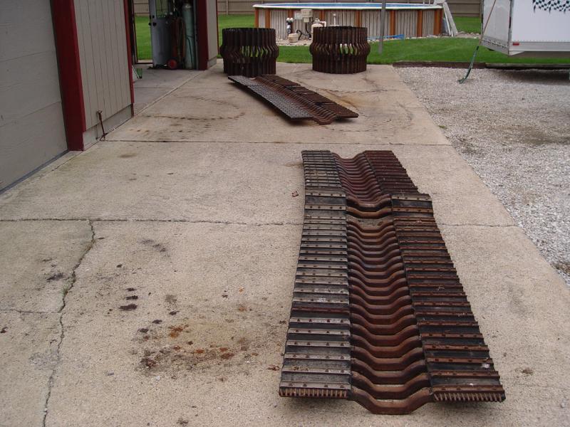

I started getting the lettering painted on. I also started dismantling the tracks. That involved unbolting 1,280 RUSTY nuts & bolts, then that meant picking up 2,560 nuts & bolts. Along with a impact gun, a torch, and three buddies it took the better part of three days to get everything dismantled, organized, and picked up. I swear that impact gun weighted 30lbs towards the end.

The track pics.

Couple of questions now that you're into track work. What type of finish are the grousers going to get? The reddish primer is common on Sprytes but I can't tell on my 601 what color they were originally. I have some NOS replacements for 601 that look like they were blue. Also have some that were unfinished (now rust). Mainer, with all the low time machines you've seen what is your opinion? What ply belts are you using? Lap joint or lacing?
Wish there was one answer but as some variations did exist, but the most common is the reddish primer. I can't map it back to the very beginning serial #'s of course but it did start on the first year of production. I have some black, blue, and the primer. I wish the red primer were consistent under the blue/black but that's not. Some had paint right onto bare metal. It seems as if the intention was primer plus black and then maybe they took shortcuts during production due to rushed production (?). I can't imagine any reason why you'd want a painted grouser and opt out on the anti-corrosion primer....over time the colored paint wears off here and there leaving the primer except for the drop-center portion that of course rubs away...and then people weld on wear pads. They sometimes also welded on metal reinforcement on the sides of the grouser too after they also put the wear pad on. The belts were all supposed to be laced.
