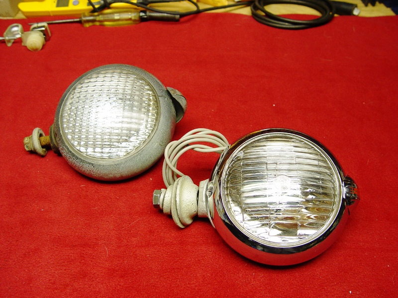

The dash... once again, has life running through it for the first time in about 22 years. The gage lights are lit but didn't show up in the pic with the shop lights turned off (first pic). Second pic is of the dash wiring when it was taken out of the cat. Then in the last two pics show the original rear roof light next to a NOS light that I have been looking for, for at least a year.

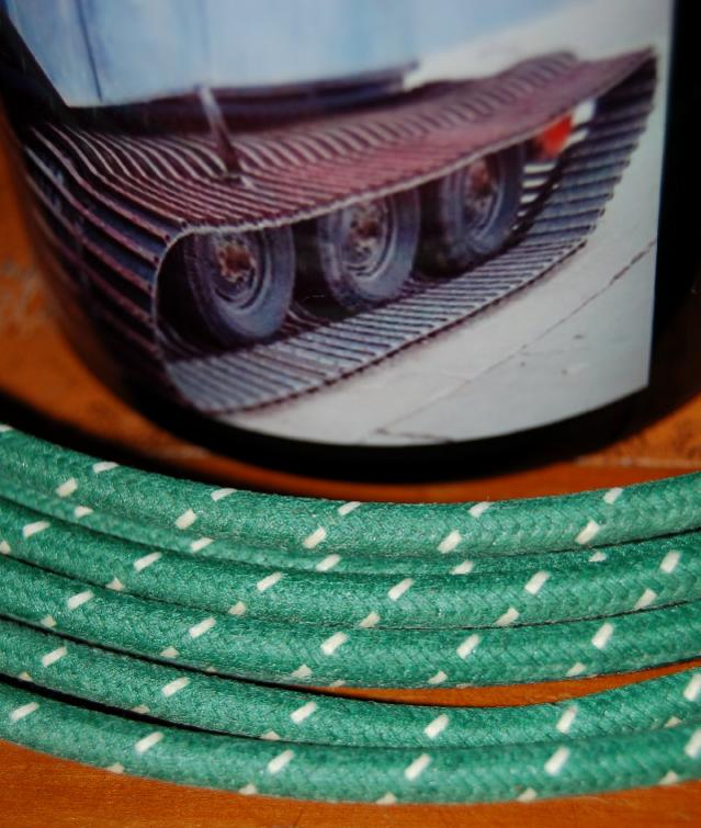

OK, Weatherby and I have been discussing the thread count issue and I ordered some to have a sample so we could really take it apart and count each strand... and sure enough, it's spot on! :glare: Look how beautiful that weave is... LOOK AT IT! WANT IT! :ermm:
Don't mind the coffee cup... just for scale :clap::whistling:

Is this wire cloth coating the new fire resistant kind? I know they make some that is identical to the old style cloth caoted insulation but is fire resistant.
Yea, this the modernized resistant stuff... some 'new-old-stock' needs to go by the wayside... old-cloth fire-style being a good example.

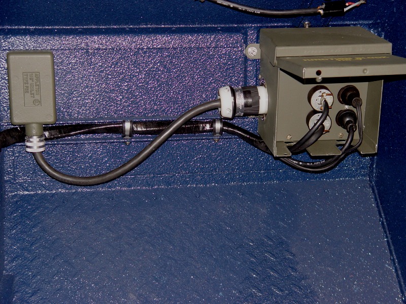

This is the 110v junction box that mounts on the pass side fire wall to run all the 110v heaters, when plugged into a 110v source (battery, coolant, oil, & coolant circulating pump).
That's rare. Most all have those removed. I only have a handful.
Seems the military always took those out, removed the turret, and also finally pulled out the brass pole in the back.:hide::boobies:
Yea..... I'm haven a "really" hard time trying to find a NOS brass pole:rolf2:

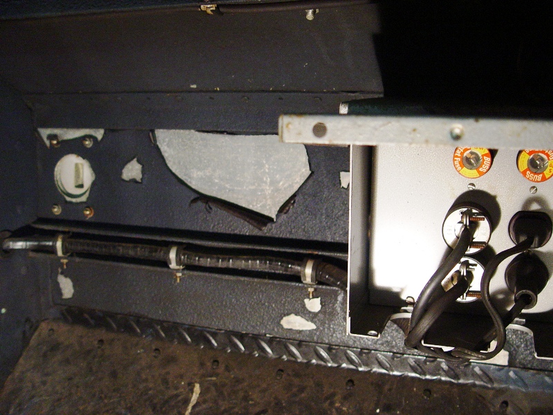

is that your new bedliner paint peeling in that pic? :sad:

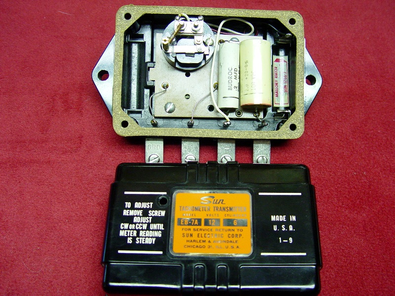

All the wring is "basically" done including the "cold weather accessory heaters" which I made a completely original looking new harness for. I also found a brand new "original" / NOS roof mounted front spotlight. After allot of searching E-Mails & phone calls, I have discovered there is NO way you can get the original Sun Tachometer to work in today's era, because the transmitter box that controls the tach needs a 1.35v "mercury" battery to make it work, and of course those battery's have not been made for years. So your only recourse to get one of these "original" style tachs to work is to send it out to a shop that will convert the transmitter over to electronic, mine is in S.C. now having that done, so when I get it back it will have a circuit board in it the size of a quarter (25 cent piece) and did mention??? all this for just $200.00:ohmy::angry:

This is the transmitter box that controls the tach, but it is now sent off to be converted to electronic. Those two batteries are the original batteries to power the box, but of course are dead now, and no longer being made.

Opened up my Tach and it had an Eveready 1.4 volt mercury battery--lots of corrosion. So was that second battery in you tach a spare??
I am assuming you mean you opened up your transmitter box and seen the 1.4v battery, yes you should only have one battery in it, IF that tach was hooked up on a V8, it would have two batteries in it, six cylinder has one battery. Mine came with two batteries because the Sun factory dose not know when they sell there tachs if they will be installed on a 6cyl or V8. Was your tach still working???? because mercury batteries haven't been made for years, and your battery should have gone dead long ago:unsure: I would REALLY like to see a pic of the inside of the transmitter box, battery,AND your tach:smile:
