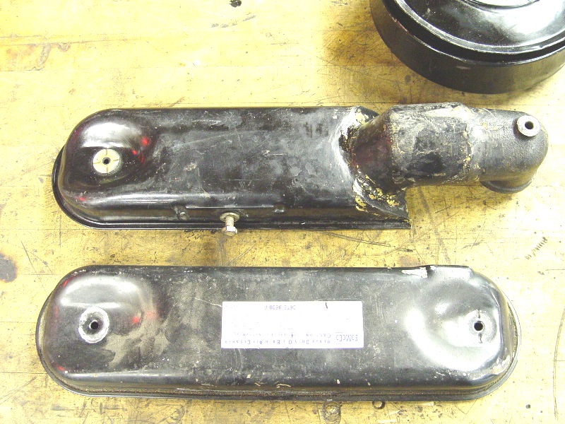

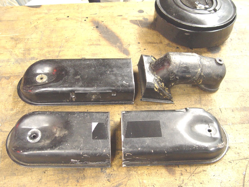

Here are some pics. of the new engine cover and the original cover. I had the new cover made out of .050 sheet steel instead of the original .050 sheet aluminum. I felt the original was much too week & flimsy and easily bent, which mine was. Can you send me some pics. of your engine cover I would really like to see that because maybe mine was also insulated like that and then removed at some point in time.:thumb:

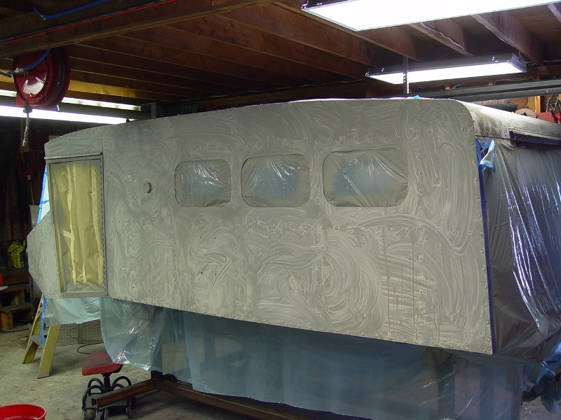

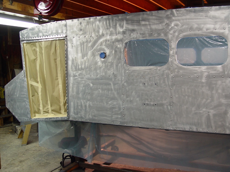

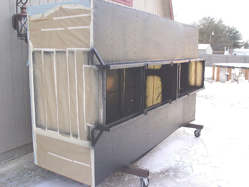

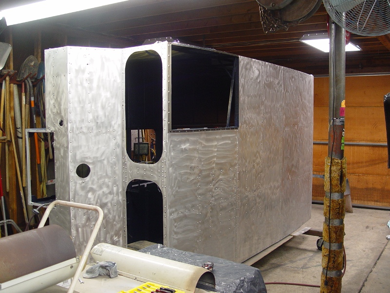

After the interior was painted I re-masked the cab so I can start spraying primer on the exterior after preparing the aluminum skin for primer & paint

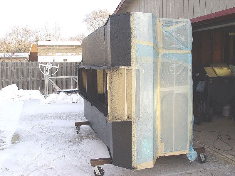

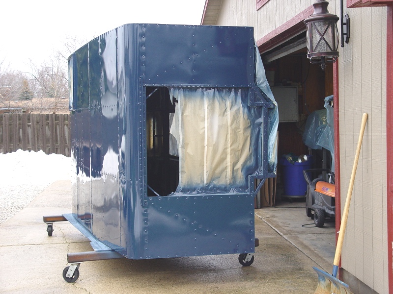

Now it was time to put the color on which was a very nervous time for me because as you can see I am spraying in LESS THAN IDEAL conditions including the very cold outside temps. What you don't see is all the prep work that went into covering EVERYTHING in my shop to keep over spray off and trying to maintain at least 60 degrees F. inside. And then setting up a blower to evacuate as much fumes & over spray as possible. The painting did turn out great BUT I would not recommended this way of painting for anybody unless your one of those people (like myself) that think that if you want it done rite you gotta do it your self. I was hoping to make it to 80 years of age but now after all the paint fumes I sucked in I probably wont make it to 70. I did ware a very good respirator but you really need a fresh air supplied suit to spray in conditions like this. Also I still need to do both sides but that will be after New Years and it will be dry enough to put it back on it's bottom so I can get at the sides.

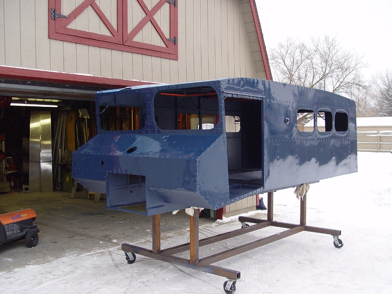

All of the painting is done, what a pain in the :censored: that was. After all the striping, wet sanding, preparing, mixing, masking off, & spraying, the labor involved in painting something like this including all the small parts (CORRECTLY) is ENORMOUS. I'm not saying I did a "PERFECT" job, but it did turn out good. I now have a better understanding why/how nice paint jobs on restored classic cars run $5000.00 and up.
