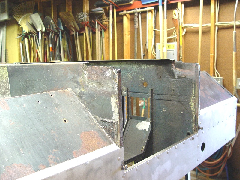

I know these pics. have been somewhat boring lately, but I am hoping they are helping somebody out or will someday. I replaced all the flat supports on each side of the frame (or what the rear bench seats set over) the originals were 1/8x1/2'' I replaced them with 3/16''x 1'' flat stock. I felt the originals were far to week. Removed door handles for paint. I need help from somebody out there that has a or can take a close up pic. of the front grill assy of a 601 or any Track Master for that matter so I can see how that 3/4'' square tube mounts just below the grill, mine is missing as you can see in the pic.

Finished soda blasting the cab, it will not remove the bed liner type of coating that is on the inside of a 601 cab. It took 5 hours to do all of the outside of the cab and doors & roof hatch with only about 4 1/2 bags of soda.

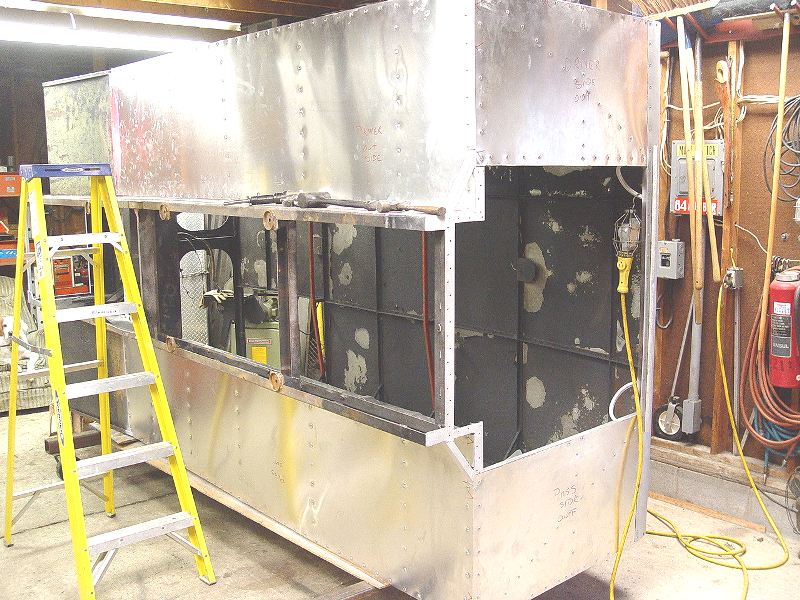

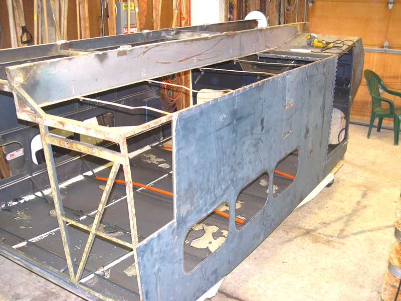

Well I finally found or should I say made some time to get working on that 601. Between work and trying to do the fun things you do during the summer months not much has happened on it until this last week. I finally installed the new sheet aluminum that replaced the damaged sheet aluminum that I had removed, let's just say I learned allot about riveting it's not as easy as I thought it would be (that is if you want it to lay flat and no puckering between rivets) I'm sure the guys out there that have done allot of this stuff know what I'm talking about but this was the first time for me, I now know why I've seen guys use so many Cleco clamps to hold the aluminum skin on when working on aircraft skin, (I used none). I also talked to the Line-X spray on bed liner guys about doing the inside of the cat they also did some sample or (test spraying) on the inside just to see how it will look going over the original coating that is still on in the inside, To make a long story short, It adheres excellent and looks great so that looks like that is what is going to be put on the inside.

looking great! Wish we could have tore ours apart that far to do the paint - we used paint stripper and scrub brush on ours to get the old paint off - but we didn't strip the underside at all. Can't wait to see paint on it! Looks like you were able to find the right kind of rivets?
Thanks and yes I did find the correct rivets the only ones I do not have yet are the ones that hold the rear door hinge on which are a little longer 3/16x5/8 as apposed to 3/16x3/8 that most everything else uses, the longer ones should be in the mail within the next day or so.

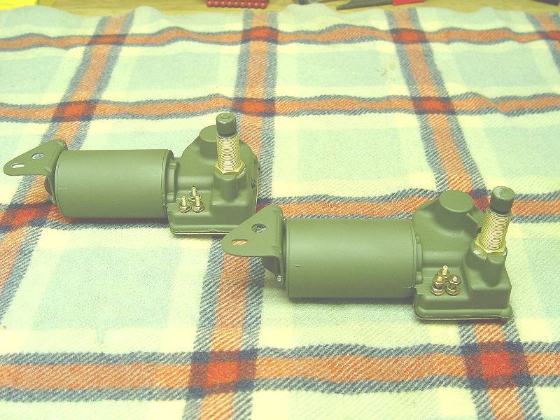

Well I know it's been awhile but between some hunting trips & just doing things we do during the summer months work on the 601 was/is slow, but things will start to get back to a faster pace now that I will have the time that I need to really give a 100% towards it. In the last month or so I have been preparing the inside of the body to get resprayed with a spray on bed liner type of stuff, I had a new engine cover made and FINALLY found all the parts to rebuild my wiper motors, mine were replaced at some point in time with motors that had the wrong shaft length. These motors are made by American Bosch and they no longer make them, so getting new ones was out of the question However you can get this same style of motor but they are made over seas and not by American Bosch. I was lucky and found a CO. that still has parts to rebuild the the original American Bosch motors, my new motor cases are even stamped with the year they were originally made 1963 how cool is that! my 601 is a 1963:punk:

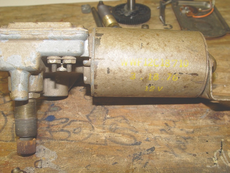

does the place have any more? We are in desperate need of wiper motors for our 4T! We have nothing!
Karin
Karin
Hi Karin, this place has only SOME parts still left and then very few at best. The one part I know they have a lot of are shaft assy. 1" 2" & 3" length, yours would need a 1" shaft, however a longer shaft will work. They do not have all the parts to make a complete motor any more. If you have no motors at all AND you want the correct American Bosch motors they are not that hard to find, most any OLDER tractor, front loader, military truck, boats,or anything that has a cab with a windshield from the early 80s on back used these motors. But if you just want that style of motor you can buy them brand new and they look the same as the American Bosch motors. You can find them on E-Bay rite now just type in MARINE WIPER MOTOR and from AFI marine you will see them for about $70.00 hope this helps. I will be gone from now till the 22nd of this month.

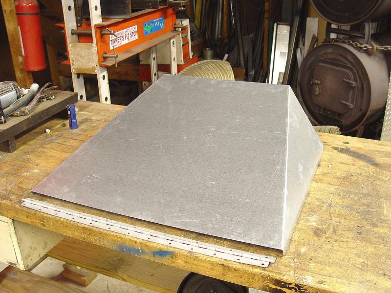

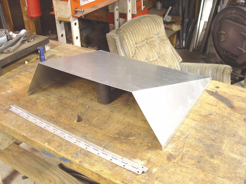

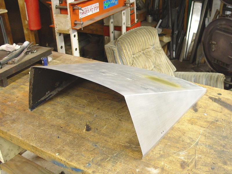

Here are some pics. of the new engine cover and the original cover. I had the new cover made out of .050 sheet steel instead of the original .050 sheet aluminum. I felt the original was much too week & flimsy and easily bent, which mine was. Can you send me some pics. of your engine cover I would really like to see that because maybe mine was also insulated like that and then removed at some point in time.:thumb:

weatherby, love your work.... what has me wondering is why you have your barrel stove chained down?and what kind of leg (back scratcher) is that?:mellow: Turkey? you must be burning old av gas in the stove and trying to keep it from going supersonic.:tongue: Just remember when you get that
601 done it would love to move west. of course after you have had your fill. and fun with it. (Don't tell painer)
Such a glorious demonstration of excellence! OK, now I can be painer mainer from time-to-time... but I think if I had as much perfection, sweat, tears, blood, wifely anger, etc... into a 601 like this... hell... dig a big hole for my aluminum/steel casket! ;) It's been done before...but not with a 601. Maybe Mainer will be the first! ;) I know, gruesome, yet appreciable thought. Boggie... hands off... you know that rig needs to head East after Weatherby is board with it. ;) Actually, after Weatherby catches his breath for a while... I have dibs on his consulting services to redo one of mine! I just have to start saving now to pay for it! 8(
Weatherby, don't mind us little snowcat biatches bantering over your prized goods... it's just the ultimate form of flattery. 8)
I had to LOL when boggie commented on that turkey leg and my wood stove being chained down, well I mostly use the leg to scare all the little kids that come around, (just because), and the chained down stove? well I'll get to that in just a second. But first I need to let you guys & gals know that I found out that about 4 years ago Mainer paid a large sum of money to the RUSSIANS to launch a satellite (the U.S. wanted nothing to do with it) to look for ALL rotting, non-running or running Thiokol 601 602 & 603 snow cats. The U.S. doesn't know what Mainer (if thats even his real name) and the commies have up there sleeves but they believe it can't be good. They also believe he has a large number of them already stashed over there in commie land. I know he has picked the state of Michigan clean except for the two he THINKS he taking back to Main (if thats really where he lives) this weekend. We have set up road blocks from the Soo to Marquette for this weekend, and if he slips by there, my buddies at the boarder are instructed to drown him in all the special paper work like, permits,documents non-documents,registrations,license,etc etc. etc. etc. etc. until he just gives up and leaves those cats there at the boarder and tells them to call Weatherby & tell him he can just have em. Now this leads me back to why I have that chain around that wood stove, It's a boobie trap for Mainer just in case he or any of his commie friends try to load my 601 on the back of a flatbed some night when I'm sound asleep I figure it will pull over the wood stove & make all kinds of racket that will wake me and scare them off:mrgreen:
