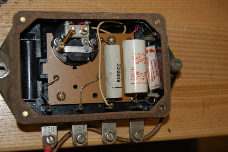

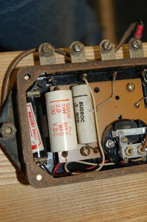

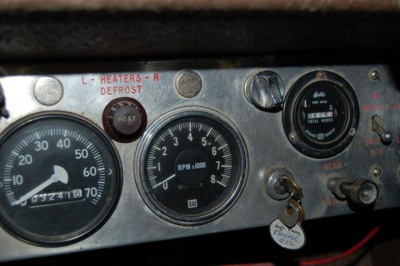

Here are pictures of the inside of the tach transmitter and the tach itself. I think it was working, I thought it was working. :w00t2:[/ATTACH][/ATTACH]

NOW this makes more seance, your tach may haven been working, but that's because your tach IS NOT hooked up to the transmitter box, because your tach is not the original Sun tach, it's a STEWART WARNER and that tach dose not need a transmitter box to operate. Somebody removed the original Sun tach but left the transmitter box which is very common. Thanks for those pics.:thumb:
I got my transmitter box today. The first pic. is of it in original condition, Pic. number 2 is after they convert it over to electronic.... You get all that for just $200.00:shock:

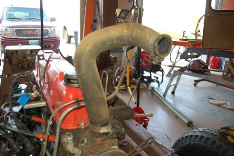

Thanks for those pics. Your upper hose is shaped just like mine but I've had no luck in finding one yet. I don't know if It's off of a tractor, car, or truck:unsure:

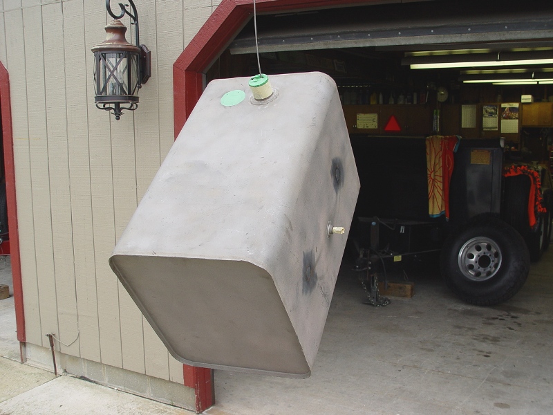

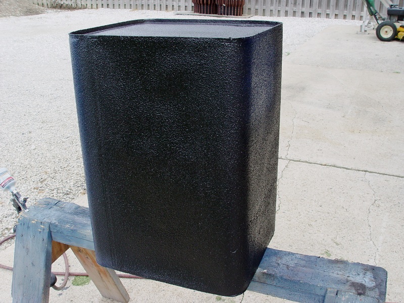

I was getting ready to install the fuel tank about 2 weeks ago when I knocked it off my bench and it hit the cement floor and put a nice bend in the corner seam of the tank. After I bent it back into shape "naturally" it started leaking when I tested it:furious: So I dropped it off at a tank repair shop to fix the leak and wile it"s there I also had them coat the inside of the tank. They told me they would have to sand blast the tank to make sure there would not be any other leaks, so when I got it back I seen they used WAY TO MUCH air pressure when blasting the tank and it "warped" all the sheet metal on the tank so bad that I can't paint it now because the shinny paint would make the tank look very wavy :angry: SO now I will have to respray it with bed liner and then paint it blue so it will "help" hide all the warped sheet metal. These pics show it being resprayed with Bed Liner then painted.

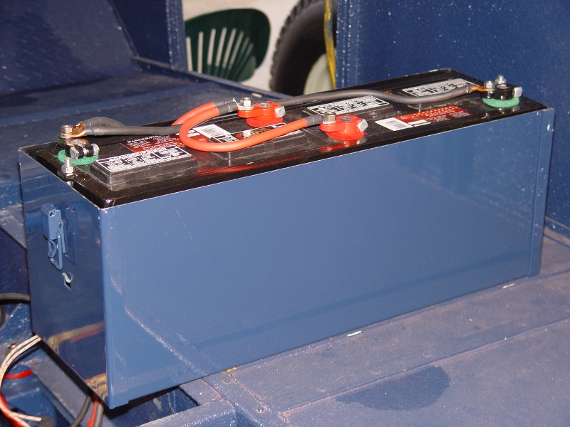

I have the fuel tank installed and started making a fuel line from tank to fuel pump, also a pic of the battery box & batteries.

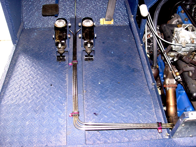

I have the radiator & all coolant lines installed and have coolant running through the motor. I bent up new stainless brake lines for the steering & clutch master cylinders.
Good god man... I'm going to frame that photo of the pilot's floor... always the worst/nastiest cosmetic area of every 600. I could scramble-on and eat-off that floor! Then drink my OJ with that stainless line!
