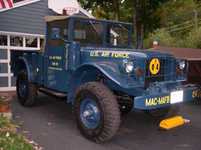

Hey, weatherby, found your tow vehicle! :thumb:
Man, would that pair ever be a sweet display at a show!! :w00t2:

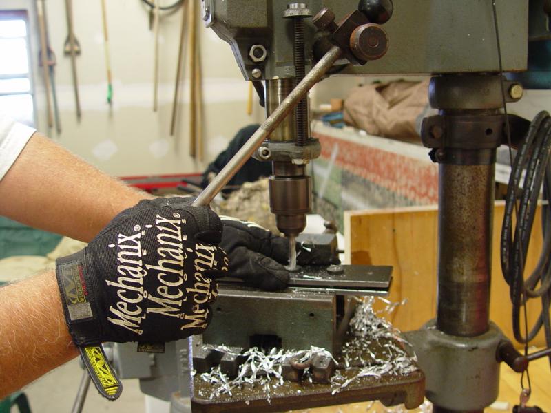

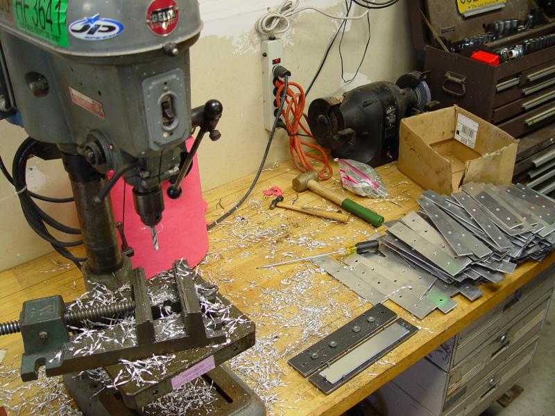

I have been working on building a die to press out new replacement backing plates for the tracks, it is turning out to be "much" more complicated than I thought it would have been to make such a simple looking part. I have been able to get them very close, but not EXACT, at least not with any kind of repeatability. However I think I finally, after about 4 major changes in the die design, I think I have it dialed in and it is far more complected of a die than I started with. I've learned allot about pressing out a part when you have to build your own die. There are allot of factors that need to be considered that I never realized when that press makes that stroke. I'm also VERY lucky because I have the privilege to use some very accurate & expensive machinery that I DON'T own, like a CNC mill and other mills & surface grinders, without that privilege this would not be possible for me. Or maybe I should say, when this die is done, I will owe some of my buddies BIG TIME. In the meantime I have gotten all the grousers blasted, and I will be coating them with Por-15. I have the new belting it is a three (3) ply belt, and I had stainless steel lasing installed on the ends, they are not the same that the factory used, because the belt expert guys say this style of lasing is SO MUCH better. Also got my front seat frames blasted & painted.

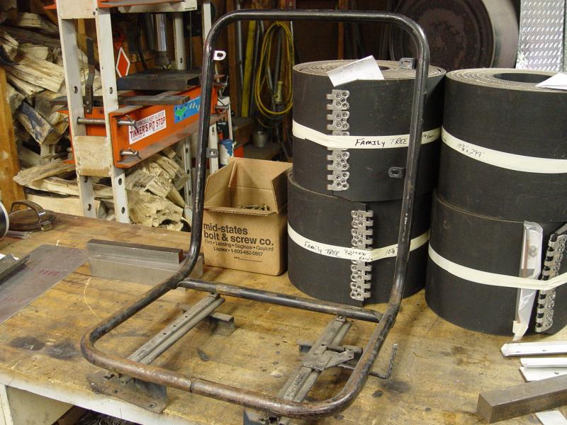

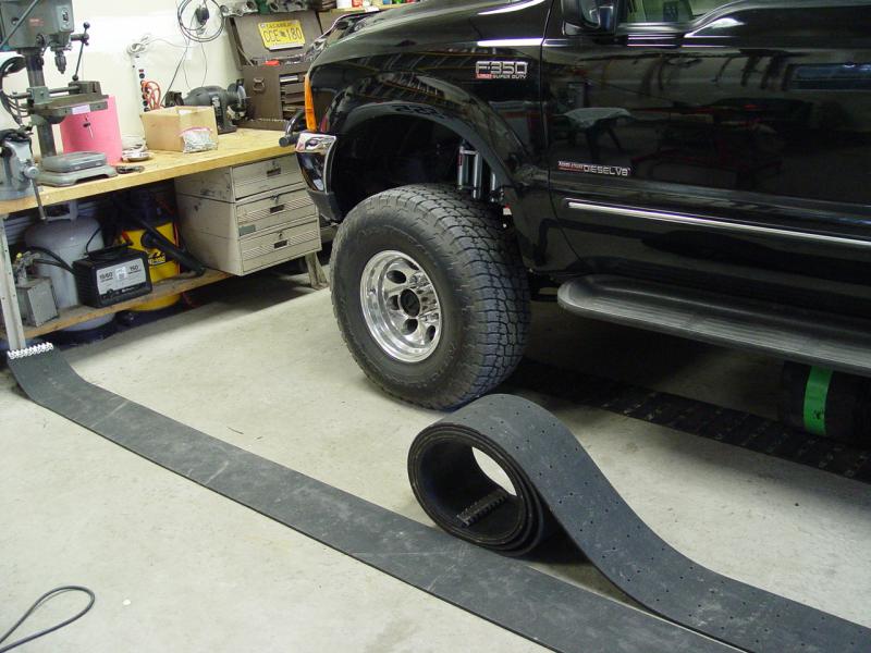

That belting was $6.00 and change per foot at 10&1/8" wide and 299" long x four, the lacing was "I think" about $80.00 in stainless x4. The belting has no holes, I will do that. I bought it from a belting manufacturing co. in Dearborn Michigan.

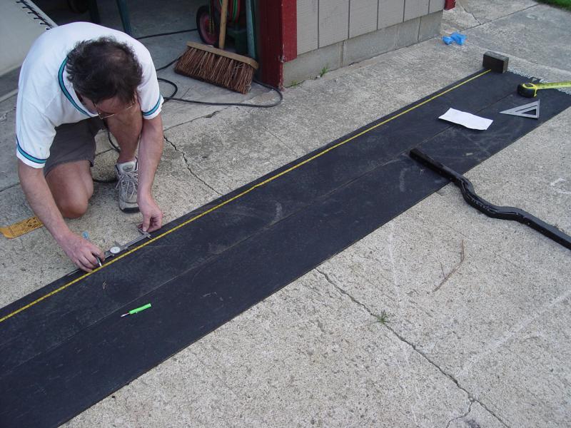

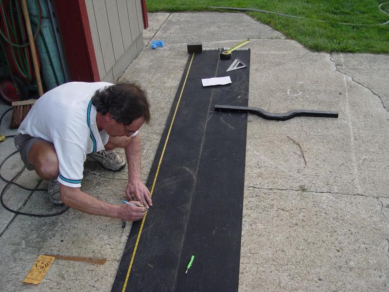

I've been working on the tracks and building a die to make the backing plates for the last several weeks now, very tedious & time consuming work. A Buddie of mine (Bill) helped with figuring the spacing and marking the belting for the grousers, I could not stay bent over for any length of time to do the measuring & marking, so I "really" appreciated that help, he also was a BIG help in getting my backing plate die made (he is a journeymen toolmaker for General Motors). Hunting season opened here in upper Mich. so I took all my track material up to my house up there, so in the evenings I can work on drilling all those holes in the belting and the backing plate material and do some bird hunting during the day. Next week I will head back down state where I work on the cat and that's where I will press out the backing plates "after" the holes are drilled in them. As you can see in the pics, I made a jig to drill the holes in the belting and the aluminum backing plate material.

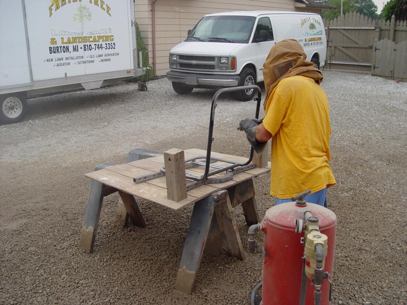

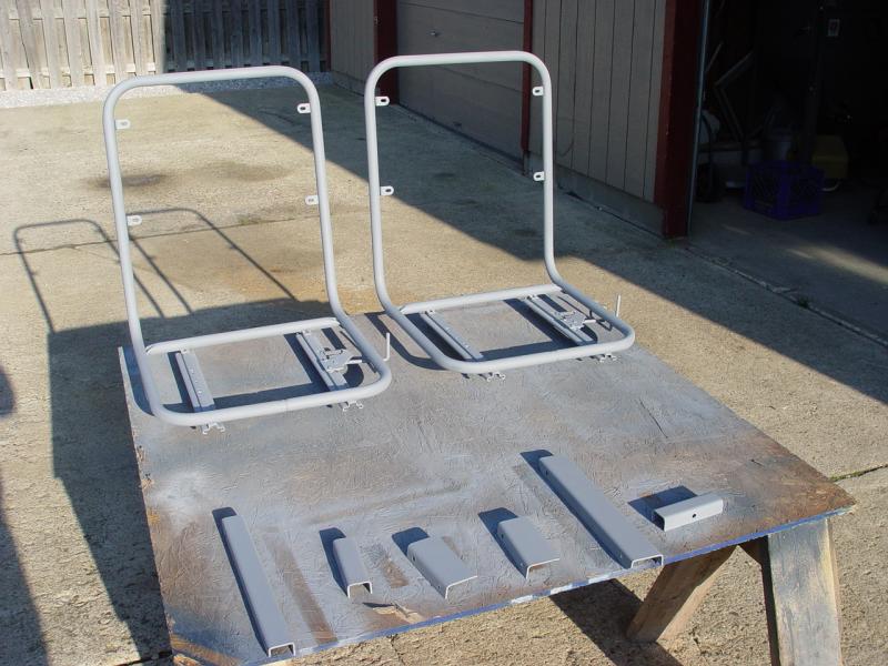

I finished pressing out all the new backing plates. In the first and second pic, it shows the left plate as being a new one, the middle one is a new one that has been bead blasted, and the right one is a original one that has been bead blasted. I bead blasted all the new ones to give to give them a "dull" (or mat finish) look. I also have all the grousers re-coated with Por-15.
