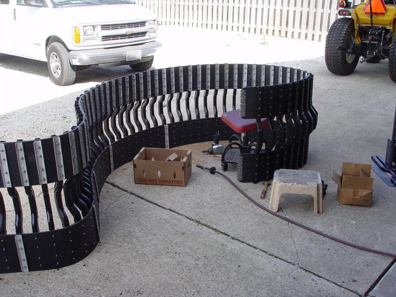

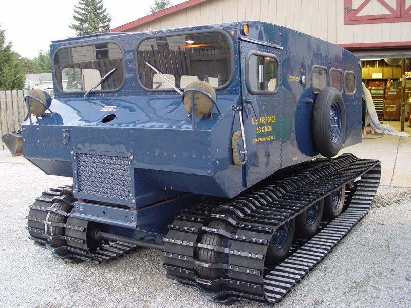

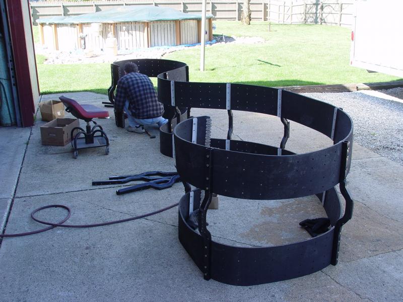

Wellllllll......it's been a LONG time coming but it's finally here..... the tracks are DONE and INSTALLED back on the 601..... and for the first time in about 22 years, it moved under it's own power. It is now about 95% complete, I still have some things that need to be done, but they are all small things, like painting the engine cowling & installing it, also install the seats and the lights and the beacon that go on the roof. There is still some lettering that has to be painted on, and install the spare military fuel cans on the back. I also received in the mail today, some very special pics.from another Fourms member WESLEY. He sent me pics of my 601 when he looked into buying it back about 15 or 16 years ago the same time I was trying to buy it, BUT I never took pics of it sitting ware it had been sitting for some years before I saw it for the first time back then, and always kicked myself for not taking those pics. But now I have them and they are very good color pics.thanks to WESLEY:thumb:

Well, very nice job, just tell me that mainer has not driven it yet? and I will open the bid at 20K. very nice! now what are going to do with your spare time. your wife wanted to know. :brows:
That is just gorgeous Weatherby. Absolutely gorgeous!
Congratulations on an unbelievable decade+ journey!
Clearly a Concours-grade restoration by a master.
I hope you are capturing the first 'steps' on video and the first trip out will be well video'd/documented and of course GPS'd. 8)
If you wouldn't mind bagging/tagging the maiden voyage day's: Gum, cigarette buts, fuel receipt, few chips of POR 15 on the ground/trailer, etc... I'd appreciate taking those on board for the museum documentation of the future. 8)
Nice job. Tenacity pays off.
Regarding the track belt prep: Will you do it differently the next time, or did your drilling fixture work as well as intended? Also, anything special by way of drill bit tip profile, and/or drill size vs bolt size?
I need to rebuild the tracks on my sw48, so any suggestions would be welcome.

125a....I think I would do it again the same way, the drilling fixture worked great. It's not a complicated or expensive fixture to make, and if your willing & able you can save allot of money drilling your own holes. The bit that I used to drill through the belt is not really a (drill bit) at all, It's a cutting bit. A drill bit wants to screw into rubber rather than make a hole. The size I used to cut through the rubber was a cutter bit that measured .4000 which is very close to a 13/32 bit and that made a perfect size hole for a 5/16 bolt to go through rubber. To go through the aluminum, I used a .3250 drill bit or 21/64 which is 15 thousands over size for a .3100 thousands bit or 5/16 bit and that also made a perfect size hole to drop a 5/16 bolt through aluminum:smile:

Thanks for the details. Where did you source the cutter bit? (Manufacturer, etc...)

125a....I got the cutter from the place ware I bought my belting from hear in Michigan. I cant remember the name of the place, but if you can't find one let me know and I will get you all the info to get one from them. Also I can show you a pic. of the cutter bit if you want. I don't know what state you live in, but there is probably a belting Co. in your state. So just let me know if you need that info or a pic.:thumb:

If you want it is real easy to make you own.
take a piece of tubing, sharpen the the outside with a grinder or belt sander and chuck it in your drill. wala instant cutter, you will need to experiment with what tubing for the size you get does not match what you drill with.
If you are going to do allot of cutting then buy one they let the plugs pop out the side.
...So essentially a spinning gasket punch.
Thanks, Weatherby, for the Flexco link; and Boggie, for an alternative.
