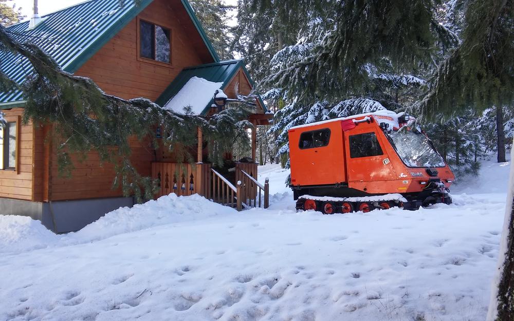

We made it up to the cabin on the 27th no problem. I was able to make the 2.5 miles up the mountain all the way in 2nd gear. All temps were in the green. I think I finally got the slipping clutch problem solved with agressive adjustment.
Last year at the Leavenworth Jamboree the track wanted to jump a tooth in sharp turns which was annoying. Last spring I added an additional leaf to all 8 spring packs for a total of 4 and increased the idler tire pressure to 70 psi which seems to have fixed that issue.
We had it stuffed with gear and there is about a foot and a half of snow with numerous drifts. The 1402 took it all in stride. I think I finally got it working the way it should with the reliability you need. My wife even commented on how much she enjoyed the ride and thats a good thing. :biggrin:
We went snowmobiling yesterday for 3 hours. I rolled off the side of a drift into a shallow treewell and my wife did a face plant in the snow. We haven't ridden in 3 years due to a lack of snow and it was obvious. Had fun but we are both wiped out today. Getting too old for that crap. (60+)
The cat is much more tame.

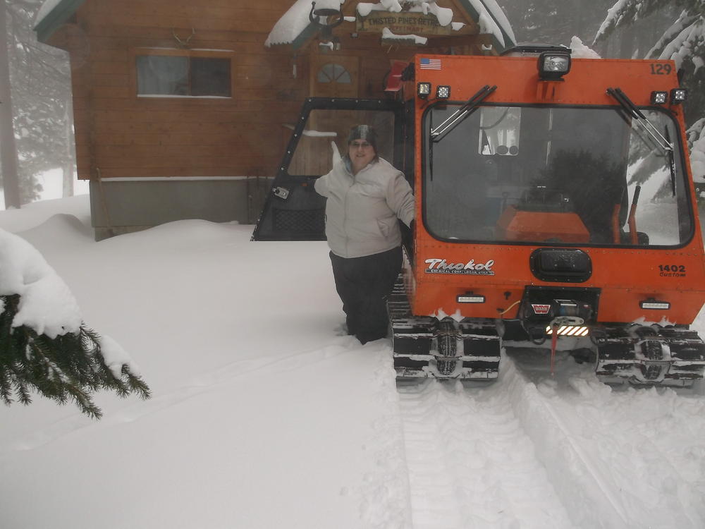

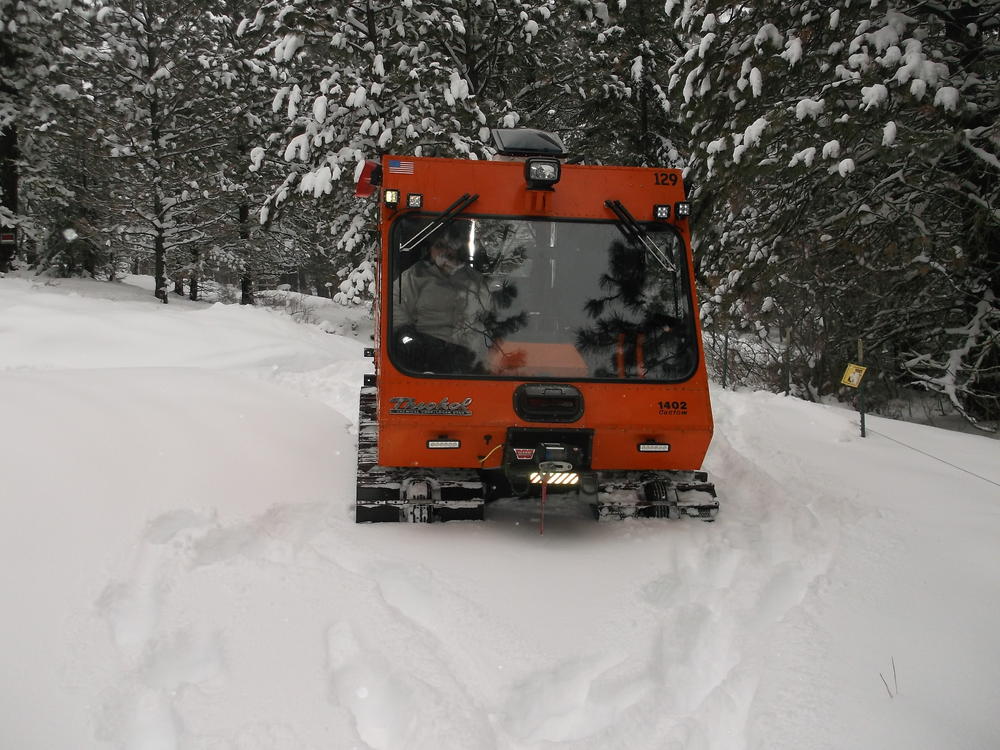

We made it back home from the cabin with no problems. The cat did everything we needed it to do. It was stuffed with everything we could get into the back of a Chevy Tahoe with the seats down. I actually had it in 3rd and 4th gear (down hill) and it surprisingly went faster than I was comfortable going (which is unusual for me). We did a little side slipping on an icy part of the hill but recovered no problem. I'm still learning how to drive this thing in different conditions. We had everything from deep snow, packed snow, ice, and drifts and I was happy with how it handled all of them. It actually does pretty good for only 30 horsepower. I even brought my neighbors 92 year old mother up to their cabin and she loved it!
Temps were in the single digits and low teens most of the trip.:bitterCol We were there 6 days. The cat started instantly every time I turned the key. Nik had put an Optima yellow top battery and a breakerless electronic ignition in it when he rebuilt it and I definitely think that is the way to go in a snowcat.
The pictures are where we turn off the road down our driveway.
The only thing I am going to think about changing is the engine air inlet. With the outside air temps in the single digits, the max heater outlet temp I could get was 125- 135 degrees going uphill and about 100 going downhill, which was ok, but I would like the engine to run a little warmer than that. I cowled the engine in order to keep the cabin from getting too hot which was a problem Nik had, but I don't think he ever ran it when it was this cold outside. I was thinking about putting a manual shutter door inside the air intake duct to limit the amount of cooling air to the engine. (A servo driven thermostatically controlled one would be better but maybe overkill) Being this is an air cooled engine, there is no thermostat to control the engine temp like a water cooled engine.
Something to think about for spring maintenance.
We are really happy we were able to buy this thing from Nikson. It sure makes getting to and from our cabin in winter a lot more pleasant and certain.

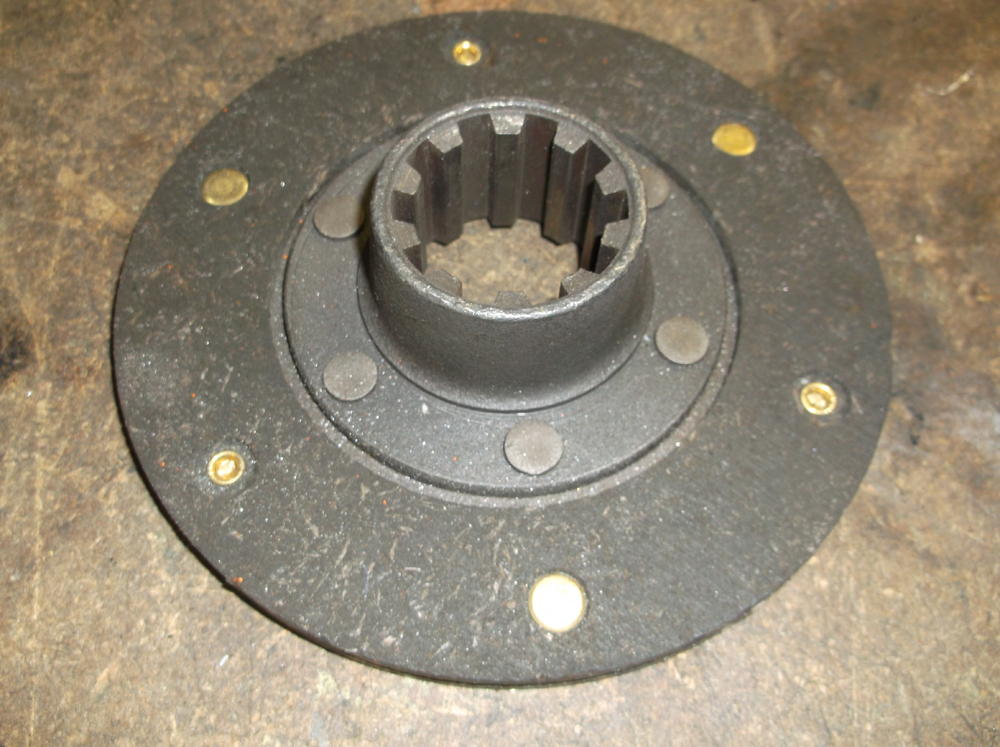

Nik put a new clutch in when he rebuilt it in 2012. When I got it the disk was down to the rivets after one season but the pressure plate and housing had issues which contributed to that. I replaced the entire clutch assembly in 2014 and have had to adjust it twice after only about 25 miles. That just seems excessive. It takes about an hour to adjust it with all the covers that have to be removed. More if you are in knee deep snow.
I kept the two old clutch discs and have relined them. I found some linings on eBay that were the right size and thickness for about 10 bucks each. They were made for Brushhog pto driven brush cutters as an impact clutch. They appear to be a fiberglass composite material. They look like organic type brake linings rather than carbon metallic. Was able to drill, counterbore and rivet them to the disk with no problem. A new one from Wisconsin is 250 bucks and they don't sell replacement linings.
I soaked one in oil to make sure it wouldn't swell or come apart, but haven't tried one yet. You have to pull the engine to change the clutch so it can be an all day job or more.

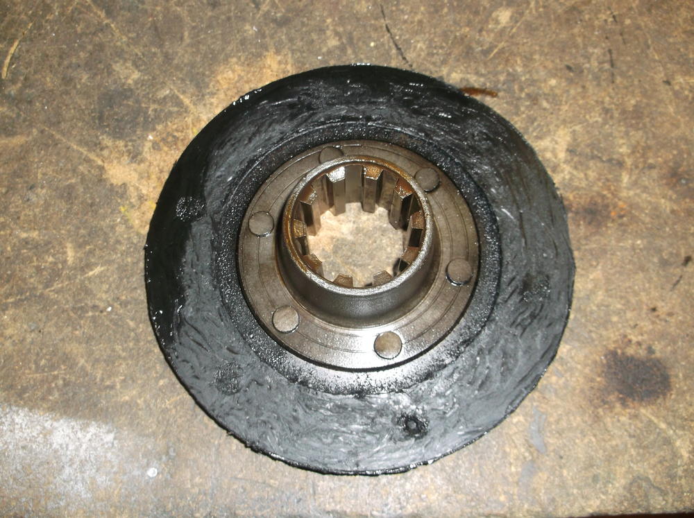

I finally got the cat in the hangar and pulled the engine. The oil in the chain case definitely smelled roasted. Removed the chain case and disassembled the clutch. The clutch housing had a lot of sludge and the disc was worn about .030 in thickness with a sticky goo that filled the rivet holes. This happened after only about 30 miles. This is most likely the result of using the wrong oil. (5W-30)
I have a relined clutch disc and will use JD Hy Gard oil in the case after I flush it out real good with solvent. I found some correct size linings on ebay that are made for Bush Hog pto driven brush cutters as an impact clutch. A pair is about 20 bucks as opposed to $250 for a new Wisconsin OEM disk. I had to drill and counter-bore holes for the rivets. The rivet heads are .050 deep on each side so that will provide about .100 total wear before it is down to the rivets. The last picture is the new disk.

Normally those PTO impact discs are not made to run in oil:sad:
I was worried about that too. I had a lining that I drilled wrong so as a test I left it in a can of oil for a month then put it in my solvent tank to see if it would stay together and it did. That really isn't a dynamic test, but at this point I really don't have any other options. The disk that Nixon had replaced when he rebuilt it looked to be carbon metallic? as it had strands of copper or brass in it and was worn to the rivets after one season. It was a factory product. In that case the clutch pressure plate had a bad pin, cracked adjusting ring, and the wrong oil. Lots of variables.
The disk that came with the complete new OEM assembly that I replaced in 2014 looks to be organic (no metallic strands) and of the same composition as the PTO discs with what appear to be embedded fibers of some type. (Fiberglass? Kevlar?) It still experienced what I believer to be a lot of wear but with the only variable being the oil.
Brake and clutch lining material is available from some of the industrial suppliers (McMaster Carr) in various coefficients of friction but they are in sheet form and would have to be machined to size and don't specify whether they are suitable for wet applications.
I am hoping that using the new oil will solve the slip problems. It will be an experiment. If it doesn't work this time, I'll try something else. I've had the engine out 3 times now. I'm getting pretty good at it.
