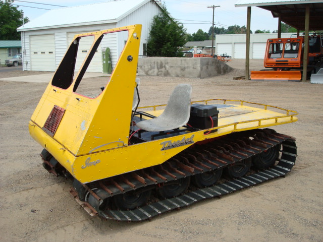

For anyone who doesn't know, this is what the cat looked like when Nik bought it. I don't think I would have undertaken the restoration. I usually tell people when I show them the picture that "you would have had to pay me to haul it away".
Fortunately Nik saw the possibilities and had the drive to make his vision a reality. I'm glad I was able to buy it from him.

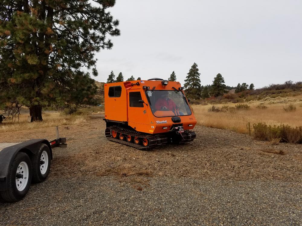

Getting ready for winter. We took the cat back to Ellensburg after sitting in my hangar all summer. I had hip surgery in May and Spine surgery in Sep. so I should be ready to go when the snow flies. I am anxious to see if the new Kevlar clutch and gearbox oil work.
I wanted to get it over the pass before the state starts salting the roads. I spent a lot of time this year on corrosion control.

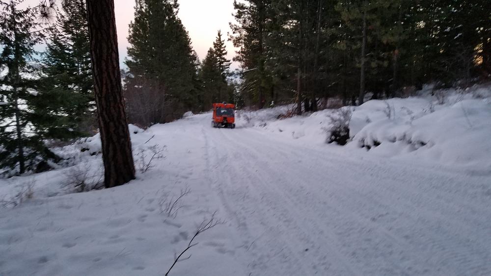

We made the run up to our cabin yesterday. We have about a foot of snow and the temps are in the high 20s. It looks like the clutch slipping problem may finally be solved. The combination of the Tribco Kevlar clutch disc and the John Deere Hygard oil did the trick. There was no indication of slipping. This morning I took the inspection covers off and the oil still smells fresh (not roasted) and there is no reduction of the clutch engagement force. This is after several trips up and down the mountain. I even had it in 2nd and 3rd gear. I couldn't do that before without the clutch slipping. It is finally working the way it should.
We had the rear cab so stuffed with gear I could hardly get the back door closed. I am a little appalled by how much gas it uses though.
I hope to get some videos and will post them later.

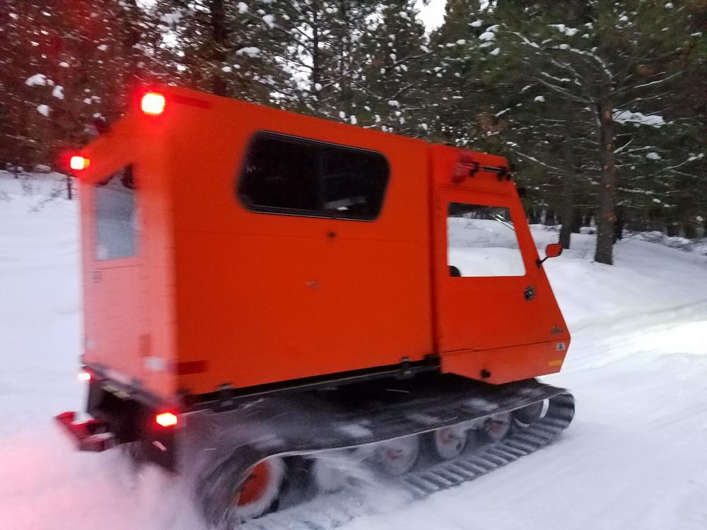

I want to give my heartfelt thanks to Cidertom, MNoutdoors, ben2go and mtncrawler for the advice they provided in my efforts to solve the slipping clutch problem. I have made 5 round trips up and down the mountain for a total of about 35 miles with no issues. The new clutch will get the cat going in any gear. It now will climb in 2nd and 3rd. Now that it is working the way it should, the 30 hp is plenty of power for what we are doing. A little slow climbing a steep grade, but we made the trip up in about 35 minutes. It would be about 10 minutes with a snowmobile, but I would have had to make 4-5 trips to haul up the same amount of gear and would have had to burn the same amount of gas. Not to mention being in a warm comfortable cab.
It would be real hard to maintain a machine like this without the wide experience of the guys on the forum.
Thanks again.
The last picture is a little blurry due to high speed. :yum:
