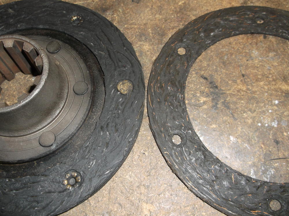

Here are some pictures of the clutch facings. The organic one that I just removed has some cratering, probably from heat that delaminated the lining. The second photo is side by side, organic on the left and metallic on the right. The metallic one on the right is one that Nik put in new when he rebuilt it. He also gave me the one he replaced and it was the same type, but not worn to the rivets.
I'm going to do a little more searching to see if I can find bulk carbon metallic lining before I put it back together. Carbon metallic has a higher heat tolerance, but if the new oil keeps it from slipping, it won't get hot.
All advice is welcome.

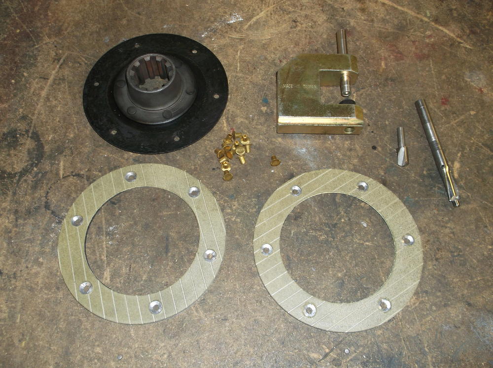

The UPS man delivered the new Tribco clutch facings today. So I jumped right on getting them drilled and riveted. They have a 1/16" Kevlar lining bonded to a 1/16" steel backing with the oil grooves installed. I countered bored and countersunk them to leave the rivet head .050" below the facing. This will allow for .100" total wear. Also, when it wears out, the clutch plates will contact the brass rivet heads while there is still .013" of lining left preventing contact with the steel backing plates and damaging the pressure plate. This is essentially the same rivet depth attainable with the standard linings, but easier and less fragile due to the steel backings.
The pictures are a step by step of the process.
I hope to get the engine back in tomorrow and see how it works.
Thanks again to everyone for the advice on this.

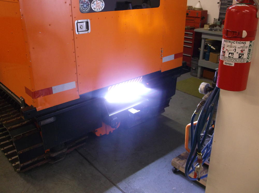

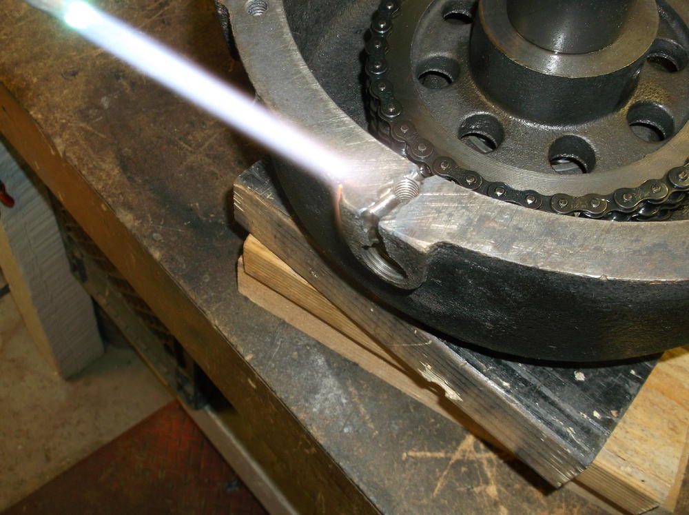

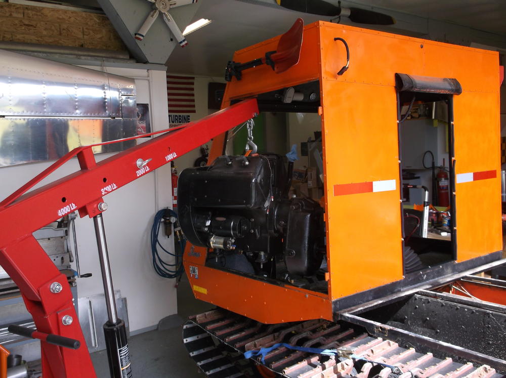

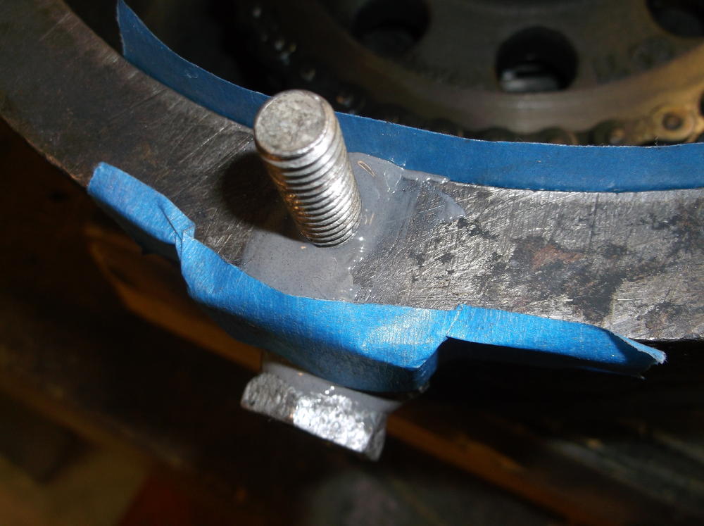

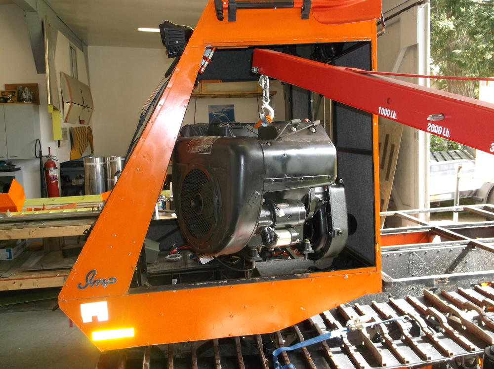

One step forward, three steps backward. I put the engine in and got as far as tightening the engine mount bolts when I noticed a spot of oil on the floor. Crap!!:evil: I tightened the gearbox drain plug some more and it got worse!!:furious: So out comes the engine again. It seems there is a crack emanating from the drain plug to the gasket flange and up into the lower bolt hole. I always had a little oil in the belly pan but the new lower viscosity oil ran through the crack much easier. I have had problems with cracks in cast material near a tapered pipe thread before. A tapered pipe fitting can put a tremendous amount of radial force on a hole. Just like a wedge.
My solution was to grind out the crack, hit it with a torch to carbonize the oil in the crack so it doesn't affect the filler material. Then I used JB Weld to seal it up. I have had good results with this product on similar not structural applications. I also JB'b a stud into the lower bolt hole. To prevent this from happening again, I JB'b a 1/2" to 3/8 pipe reducing bushing into the drain hole. This extends the stressed part of the fitting outside of the cast housing. It is just a drain hole so a little smaller size is OK.
This process would probably work for for any non structural part of a cast housing with a crack at a bolt or plug hole.

It's all back together again. (Second time a charm) No leaks. This new clutch seems to be a little "stickier". Less pressure is required for engagement and that is a good thing. Probably due to a combination of the new oil and Kevlar clutch linings. Now I have to wait for winter for the real test. This is the 3rd time I have had to take the engine out. I'm getting good at it, but don't want to do it again.

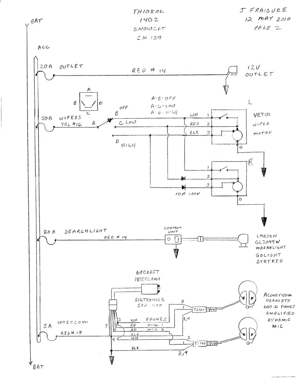

I never got around to making a schematic of the electrical system on the cat so sat down and got that done. It may be of use to someone with the same requirements.
The diodes are used as blocking diodes. I wanted the tail lites and instrument lights to come on with any of the head lights. (High, Low, Fog) Without the diodes, a parallel hookup would result in all of the head lights coming on at the same time with any switch since they would feed back through the tail light circuit.
The blocking diodes in the windshield wiper circuit are needed because there are two wiper motors on one switch. The wipers don't run at exactly the same speed, so as they get out of sync, without the diodes on one motor, the park switch from one side will feed back to the other side and they will never shut off until eventually they both open the park switch at the same time. With the diodes, the right one will stop then the left.
The hour meter relay allows a single N/C oil pressure switch to run a low oil pressure light and an hour meter that clocks time only when the engine is running.
I put in the manual breaker so that the entire electrical system can be disconnected from the battery when I leave it parked. A big marine or RV disconnect switch would work as well.
Feel free to ask any electrical questions. I'll be here.
