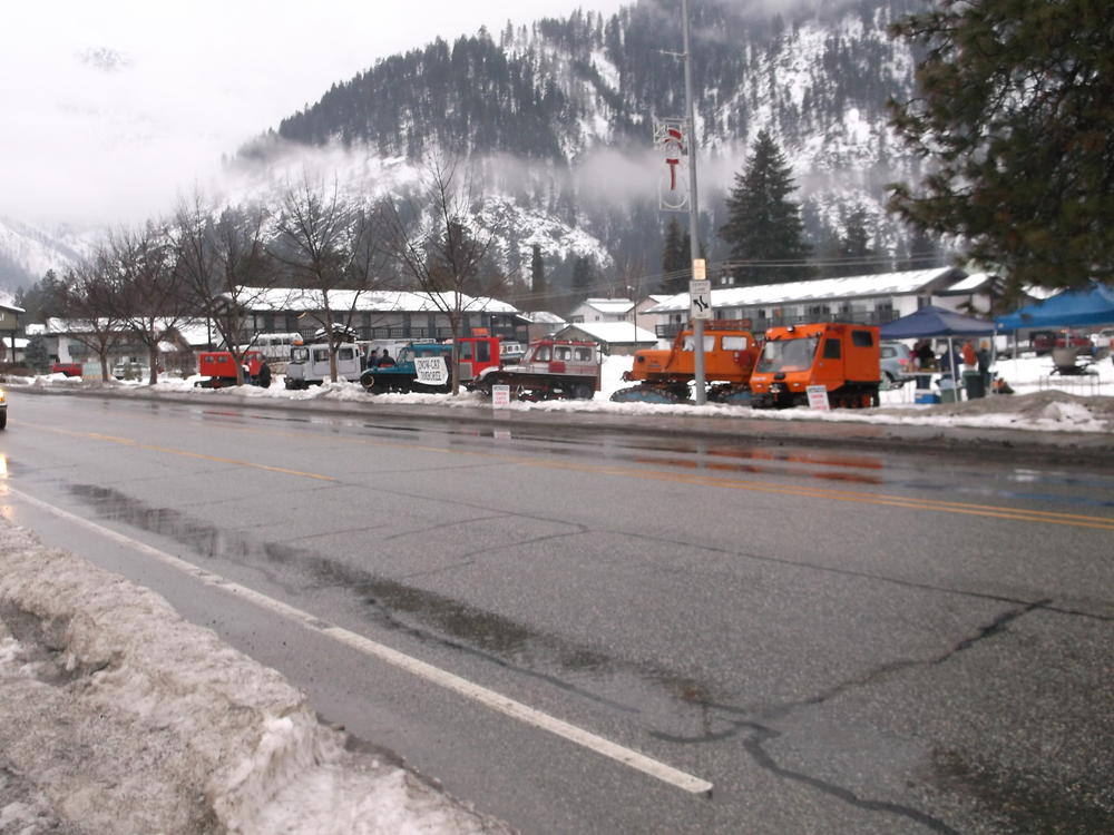

I actually made it to the top at the Leavenworth Snowcat jamboree. Slow but sure. Took me 2 hours up and 1-1/2 hours down. I think there were about 16 cats this year. Snow was slushy and temps were in the 30's but we had a great time. Many thanks to Nick, Marco, Jim VT, Jinn and everyone else for making this a memorable trip.

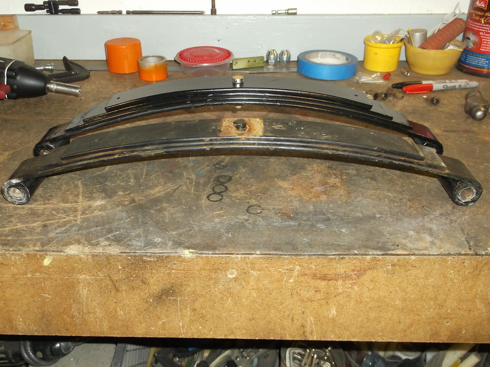

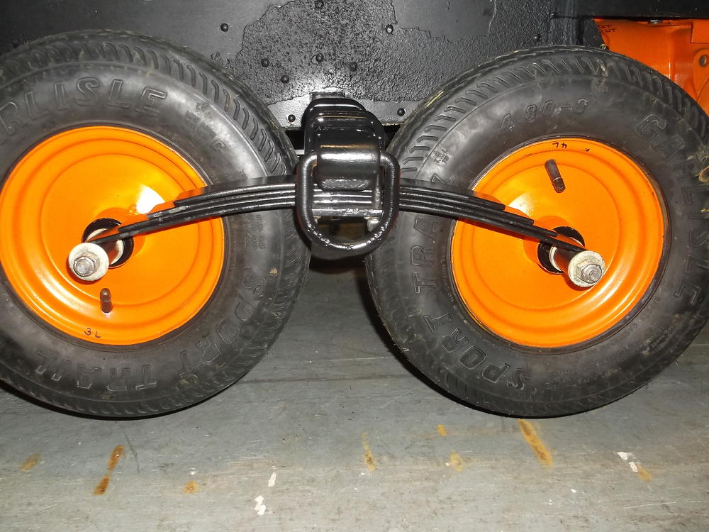

I had to bring the cat home for service after the Snowcat Jamboree in Leavenworth. I had a sticky throttle cable to fix, so I decided to go ahead and upgrade the springs as I had planned to do this spring. The weather here has been in the 50'S so might as well do it now. Hopefully will get some snow and I can still use it this winter.
Last year I had tried to install new springs that were heavier and had about 2 inches more arch but found that the upper track guides hit the cross frames due to the wheels being lower. So I removed all of the old springs, reached them up about 1/2 inch and added a 12" long X 3/16 thick leaf to the top This should give me a tiny bit more ground clearance and a little heavier suspension to compensate for all the extra weight of the custom cabs.
First picture is of the old spring with 3 leaves, second is the re-arched spring with 4 leaves and the 3rd picture is the side by side comparison.
Height to the top of the old was about 3", to the top of the new is about 3-3/4"

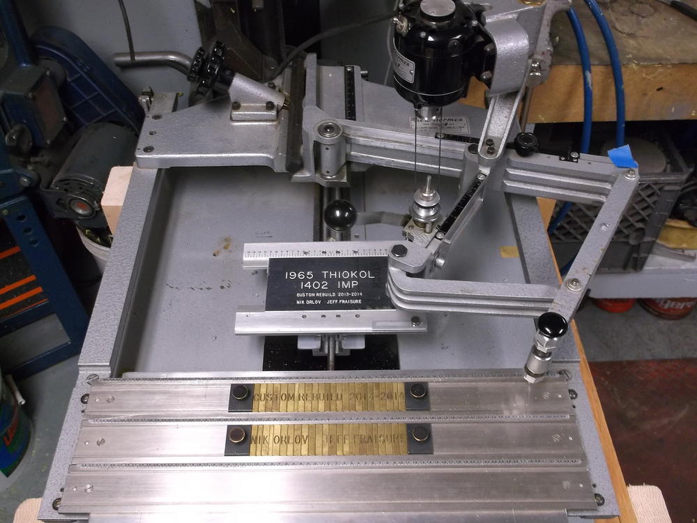

I got a new toy a few weeks ago. It is a NEW HERMES engraving machine of about the same vintage as the cat. So I couldn't resist making a data plate for it.

If you really want one, contact me through private mail with your requirements and I'll see what I can do. I have a number of colors (black, blue, red, gold and silver as well as several woodgrains. The largest letter I can make is 1/2" and the smallest is 1/8". Something similar to mine would be about 20 bucks I think.

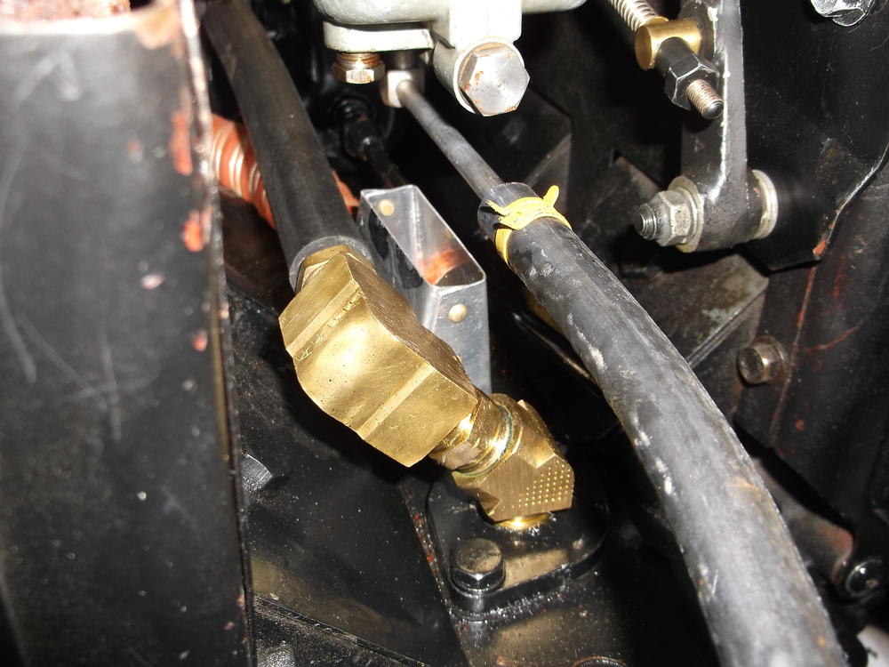

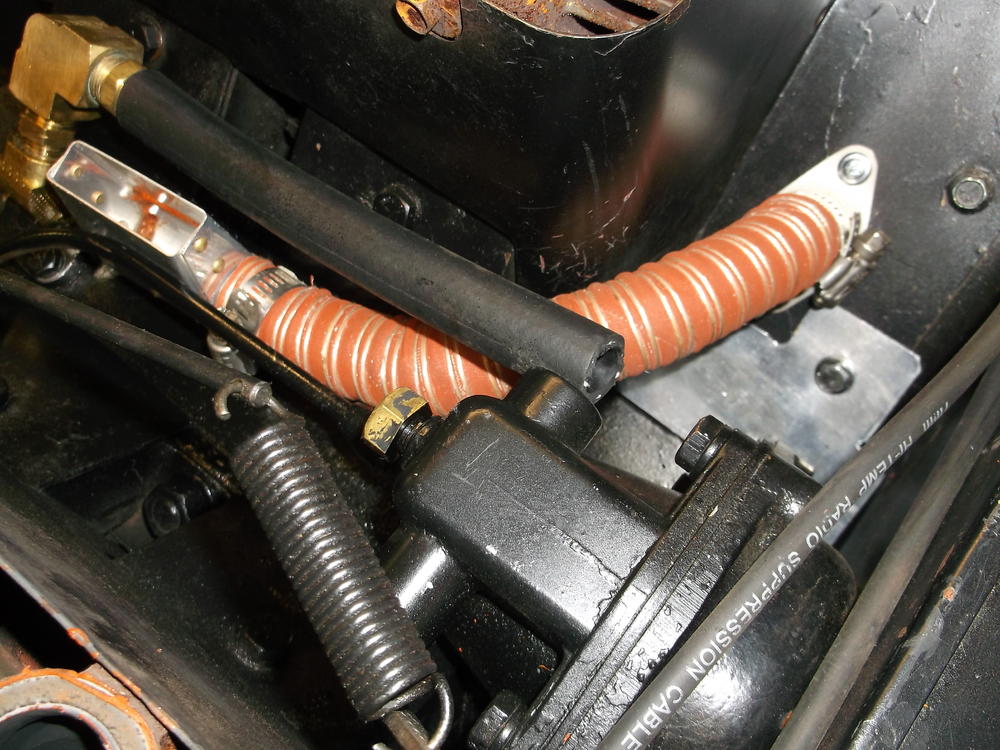

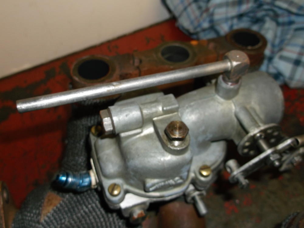

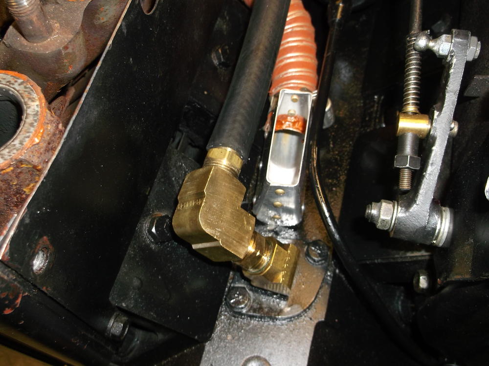

One of the things I forgot to include in my thread was the problems with heat on the Wisconsin engine that involves the carburetor. Even before I built the cowling, I noticed that there was always a smell of gasoline after shutdown. A closer look showed evidence of gasoline dripping on the top of the engine from the carburetor snorkel. I thought maybe the carb had an internal leak so I tore it down and checked it out but could find no problems. What I discovered was that the heat from the engine and exhaust manifold was boiling the gas in the carb after shutdown due to heat soaking, and it was draining out the drain on the bottom of the snorkel onto the top of the engine, WHOA! I found that was a common problem back in the day when these engines were used on corn binders and such but it is not cool on an engine that is inside a cab.
The first thing I did was use a thick insulating gasket between the carb and intake manifold, which is part of the exhaust manifold casting. Second, I removed the drain screen and drilled and tapped it for 1/8" pipe thread and installed a 90 degree fitting with a long tube. A drain hose is clamped to the tube and runs to a bulkhead fitting made from a 3/8" bolt out the bottom of the tunnel. I put a cheapo fuel filter in line with it to keep crap from getting sucked into the carb when the engine is running.
Third, I made up a cooling duct that picks up cooling air from the engine shroud just behind the flywheel fan and directs it onto the bottom of the carburetor bowl. Problem solved and no more gas smell in the cab.
