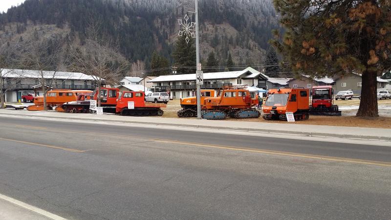

We just got back from the Snowcat Jamboree in Leavenworth Wa. yesterday. There was no snow but everyone still had a great time. We hung out in the parking area with good friends, good food and plenty of adult beverages. The hotel even let us have a campfire in the parking lot. 12 cats made it this year.
Check out more pictures at http://www.forumsforums.com/3_9/showthread.php?t=61614

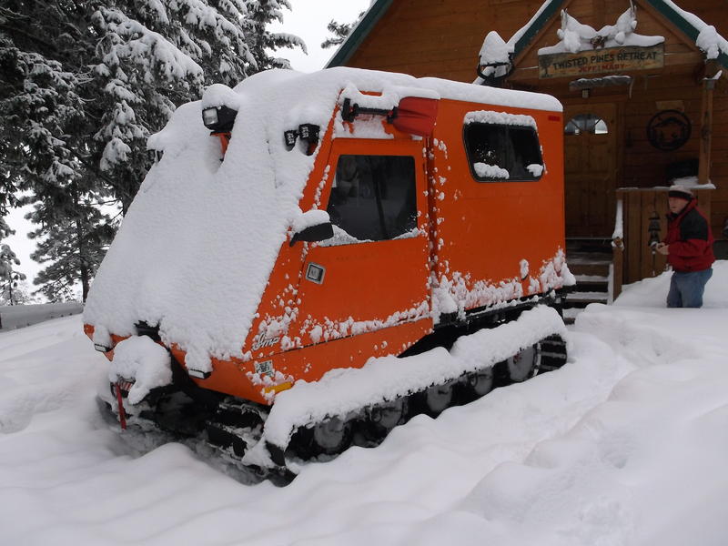

FINALLY!!! We got about 2 feet of snow at the cabin in the last 2 weeks and 6 inches while we were there. We actually have more snow now than normal. We made it the 2 1/2 miles up the mountain ok, but the 1402 with 30 hp is a little slow. Some of our hills are pretty steep, and combined with deep snow requires low gear. Still, we got all of our gear up in one trip, as opposed to 3 or 4 with snowmobiles. We were warm and comfy on the trip down in heavy fog. The defrost and wipers work great. There were some clutch issues, something went wrong with the locking dogs and I had to hold the clutch lever continuously by hand. I'll fix that when I bring it home this spring. I may also try a set of springs with a higher arch to give the cat more ground clearance. All in all, it did the job I needed it to do.

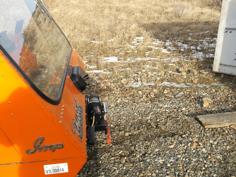

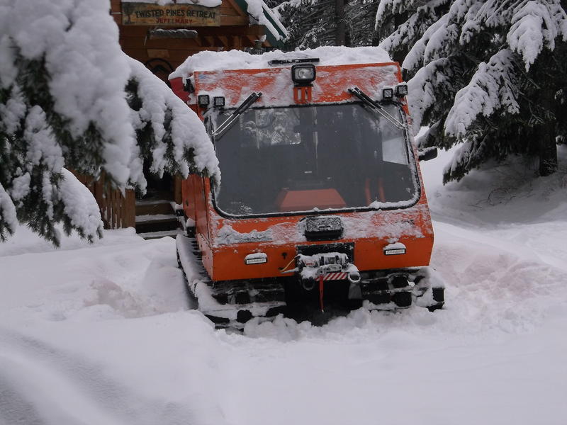

While at the cabin we got about 6 inches of new powder snow. Before we left I brushed off the windshield and a lot of snow collected between the grill and winch. Didn't think much about it. The defrost vent was still open from the trip up. You can see where this is going. When I started it up, all of the snow that was in front of the grill and that had filtered into the cooling air intake came out of the defrost vent and created an instant blizzard INSIDE the cab. :yum: Needles to say that item will now be on the preflight checklist!

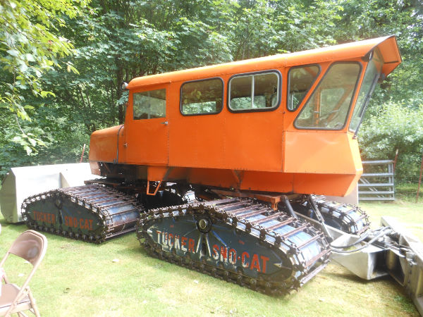

I don't know why snow vehicles that have a top speed of 10 or 20 mph need to have windshields that lay back for Mach 3 speeds. Here is a machine that we modified thirty years ago. The "Bassackward Sno-Cat" still runs fine and the visibility for the six way blade is great. Clearing the wind shield is not necessary unless there is wind. The wiper does not get much use. Looks ugly, works fine. Easy to load as the pontoons are right where you can see them.
the Antarctic snow trac's were also equipped with frost free wind shields a forward sloped windshield would look pretty cool on my 2100 and make getting in and out a lot easier I always seem to get tangled up in the knobs in the overhead console
That may be the craziest looking Tucker yet. Can you post up more pics of that and the story behind it?
