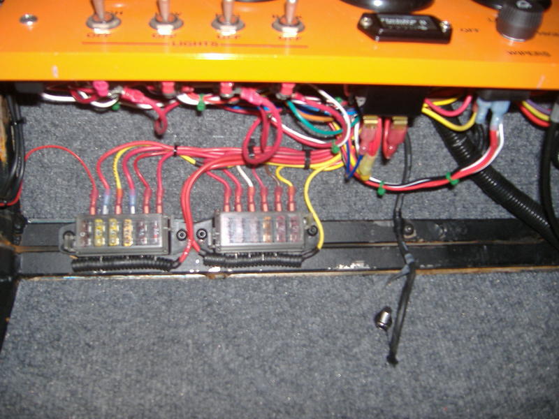

When I rewired the cat I reused the fuse block that was in it. (first picture) The problem was it was too big and only had a single buss. It was kind of in the way down on the floor panel. So I took it out and replaced it with two 6 circuit fuse blocks I got on Amazon.com for about 5 bucks apiece. I divided them into a battery buss, accessory buss and ignition buss. The floor is now clear.
Sometimes you have to do it wrong to know how to do it right.
ON (IGN): Ignition, fuel pump
ACCY: Wipers, search light, gauges, intercom, winch, 12 volt outlet
BATT: High beam and low beam, fog and back up lights, dome lights, fan
The battery buss is hot all the time. The Accessory buss is hot when the key is in ACCY and ON but off while cranking. The Ignition buss is hot with the key in ON and while cranking but off when in ACCY.

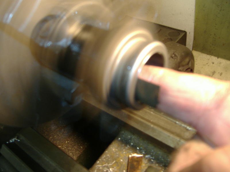

Finished up the steering cylinders today. The final honing and polishing was done on the lathe.

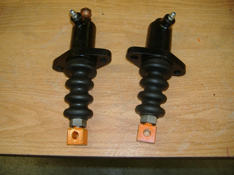

One of the steering brake master cylinders was leaking. I had planned to rebuild them but after disassembly found them both to be unsalvageable. The bores on both were very badly corroded. Fortunately, I found two new Wagner PN MC 36313 master cylinders on eBay for $80 each. The castings were a little different than the original but I was able to mill them to accommodate the steering levers. The webbing on top of the unit interferes with the lower part of the steering lever and must be narrowed to clear it.
I want to thank all of the people who have done this before and posted the part numbers and sources for these hard to find parts. I would still be trying to figure this out if it weren't for this forum.
Now I just have to fill it with fluid and bleed the system. Just a couple of small details left and it is DONE! :letitsnow:

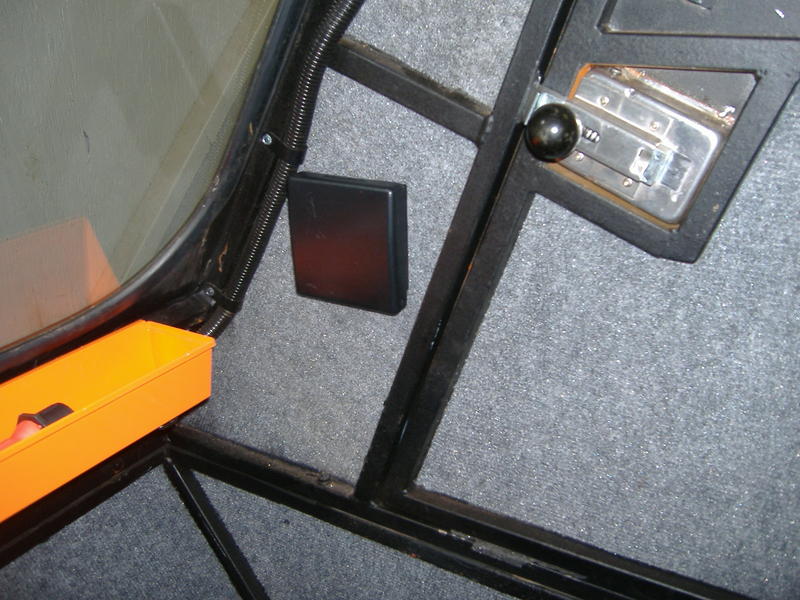

I got the brakes filled with fluid this morning, and they work great. Nice and solid. Got everything buttoned up, then I started going into snowcat withdrawal. What do I do now? So I put in a cup holder to ease the letdown.

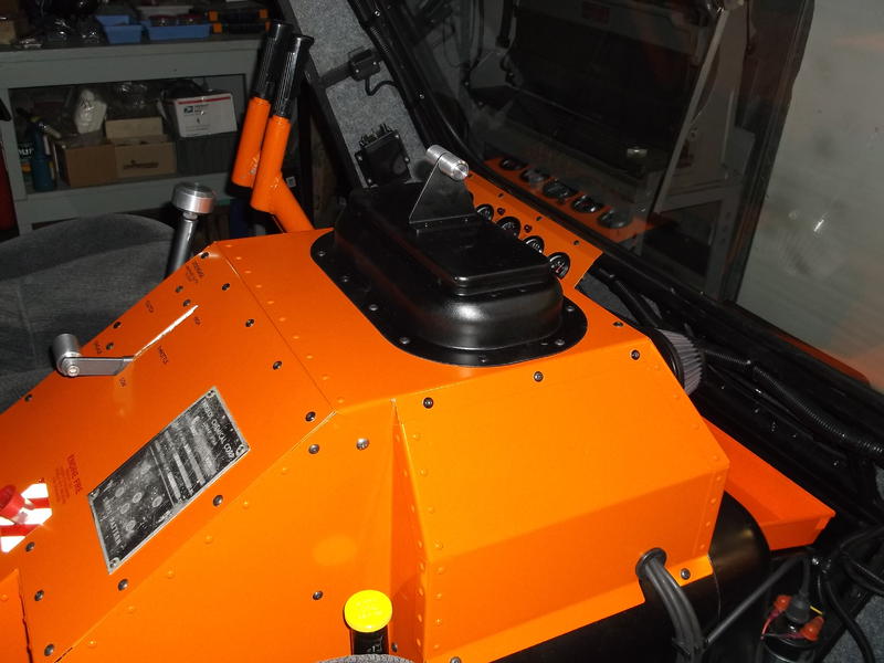

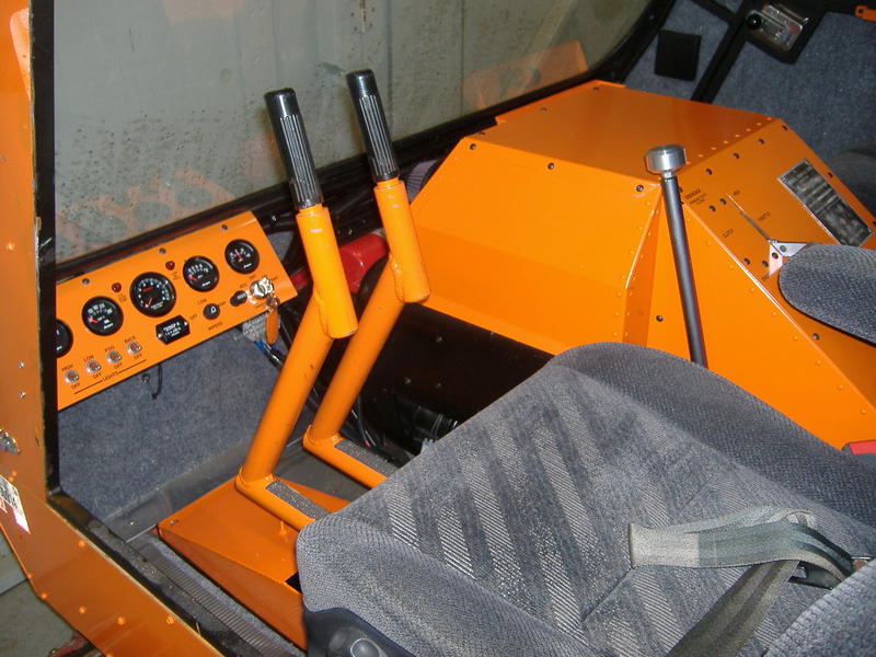

I drove the cat about a mile today in hot weather up the airport taxiway and back. Everything worked good. The cab did not get much above ambient temperature with the hot air vents closed. With them open there is a good amount of hot air for defrost and cabin heat. With the engine running, the air box barely gets warm. It gets hot when you shut the engine down from radiant and convective heat but you can still lay your hand on it. In cold weather I think it will be just right.
I pulled off the engine cover to give every thing a good look and retorque the manifold nuts. It should be good to go!

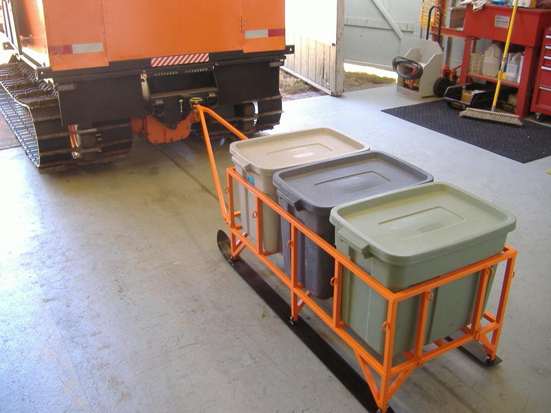

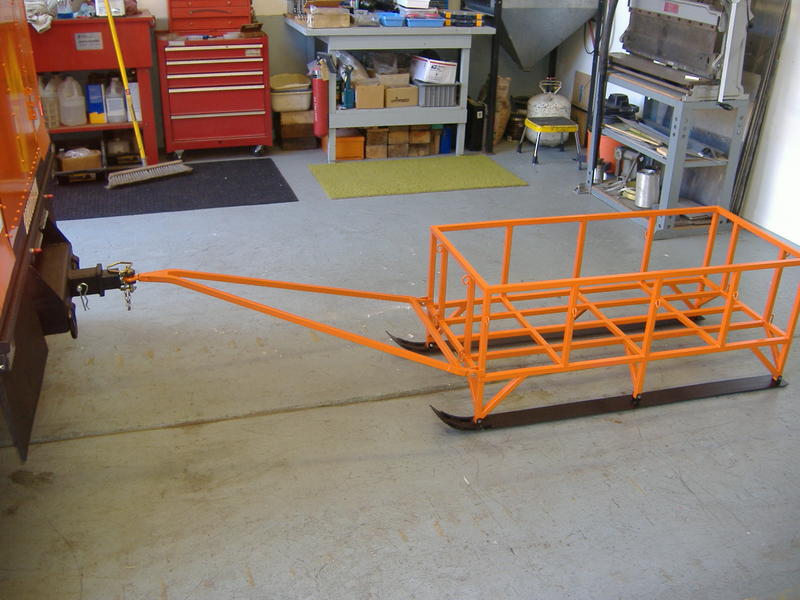

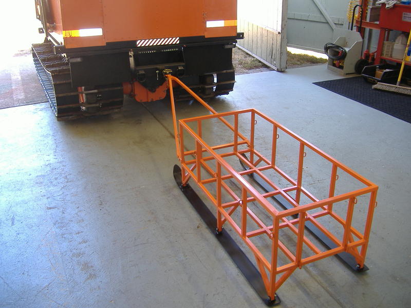

Had some free time so built a cargo sled for the cat. It is dimensioned to be able to carry 3 Rubbermaid 18 gallon containers. I didn't want to make it too big for weight and storage reasons.
Now we can carry even more crap to the cabin.
Forgot the pictures of the sled.

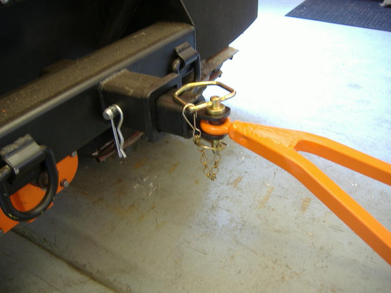

t problems I see is you should have put a swivel into the hitch or used a conventional pintle hitch and your ski stance is kind of narrow. craftsmanship is however a-1
There is enough play in the hitch to tilt over 45 degrees each way. The sled will be used on a road that is mostly packed snow from other cats and snowmobiles, so I'm not too worried about that aspect since my cat travels at a blistering 15 mph (or less). A pintle hitch would be just too big for the size of the sled.
Indoor storage considerations dictated the width. I've also got a Harbor Freight receiver platform that we can use too, but that adds weight to the cat chassis.
Very nice!!! This cat looks great and even better is that fact that it is functional. Great job it is really fun to see these projects come together.
what will happen is your sled will track in the cat tracks and will tip some. are you skis the same as your track width?
jim
for what he is using it for I believe it will work fine but being used in my conditions over un improved trails or broken up sea ice it would take a beating the old folda sleads were only good for about a year around here
The skis are the same width as the inner edges of the track. It should ride straddling the high point made by the rear end. I used to tow one like this behind a snowmobile. It worked ok but took a beating due to the faster speeds. I now use a plastic tub type for the snowmobiles.

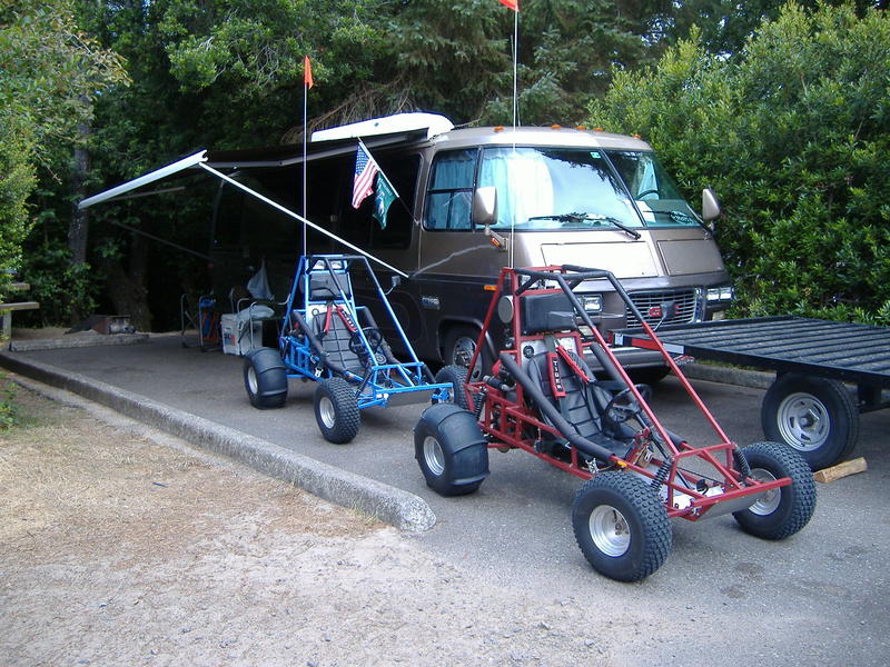

Heading down to the sand dunes in Coos Bay for a week or so. I built several dune buggies 20 years ago and still have 2. They have an 18 hp v-twin Vanguard engine, torque converter drive, rack and pinion steering, 5.17 Dana differential and independent suspension. This is my wife's favorite sport. The fuel tank is made from two 1 gallon stainless steel salad dressing pots from a restaurant supply welded end to end. Kitchen supply stores have all kinds of cool stainless stuff you can make into something useful. I once made a turbine exhaust adapter from an asparagus steamer.

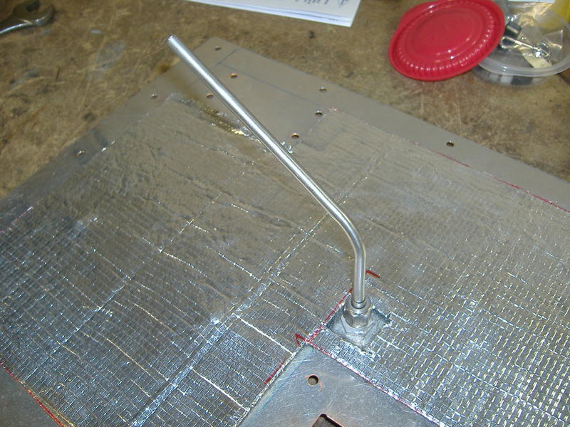

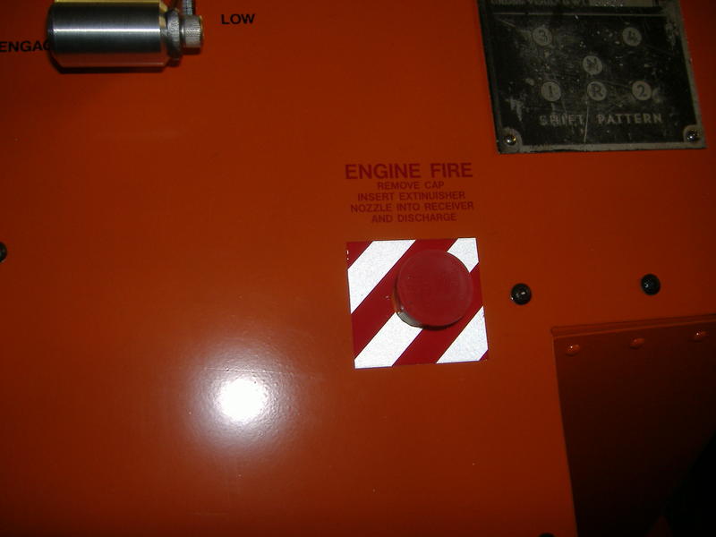

In an earlier post I talked about installing an engine fire suppression system. The engine on my cat is very tightly cowled and would pose a serious problem should a fire develop inside. I have a 2.5 lb remote Halon fire bottle but I decided that would be overkill. (Plus, they are expensive and can only be used for whatever they are plumbed to. I had plans to use it on my new plane which would be a more effective use.) The total volume of the engine compartment on this cat is very small. I also had a 1-1/4 lb Amerex Halon unit so I mounted it up over the windshield. In order to access the engine compartment, I made a receiver that mounts on the angled part of the air duct. It is about .875 diameter and about 1" long. One end is threaded 7/16-20 to fit the union. The other end is bored about .005" larger than the outside diameter of the extinguisher nozzle. I then bored an o-ring groove in it for an MS29512-014 o-ring. The groove is bored just deep enough radially to provide about a .010 squeeze on the extinguisher nozzle when it is inserted into the receiver. This prevents any Halon leakage into the cab. I used an AN 815-4d union to connect the receiver through the cover and to a 1/4 stainless tube and AN818-4J coupling nut and sleeve on the inside. The tube is bent to direct Halon into the carburetor area which is the most likely fire point. 1.25 lb of Halon is enough to flood the engine compartment and the tunnel. The initial discharge pressure of a Halon extinguisher is 125 psi.
This setup has the advantage of allowing the extinguisher to be used elsewhere if needed.

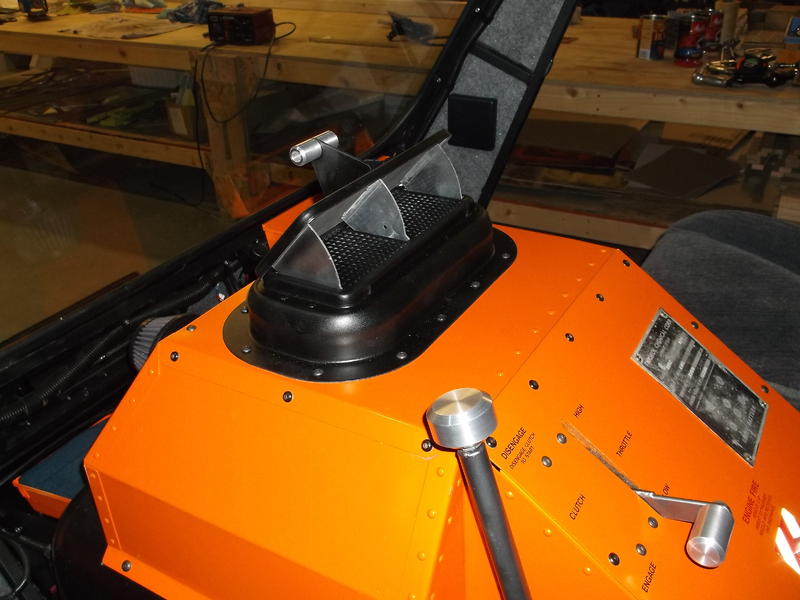

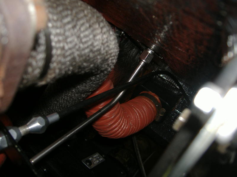

I was planning on taking the cat to it's new home this week but I had a problem with my defroster vents. They were a little too close to the exhaust manifold and melted. (Plastic) So I am going to use a Peterbuilt Semi-truck cab side air vent (all steel) mounted on top of the cowling. I'm waiting for the parts and will have a post about it when I get it done.

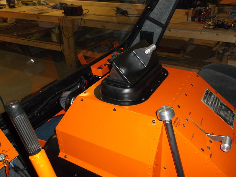

I took the cat up on the taxiway the other day for a little test flight. To my dismay I discovered that the plastic defrost vents I put in the front of the engine cowling MELTED! :shock: A little too close to the manifold I think. Good thing I found this out before I took it over to the mountains. So I made a couple of covers for the holes and found a horse trailer vent on ebay that is all metal. I like this better anyway because it will deliver much more air right onto the windshield and is fully adjustable from zero to a lot. It can also be opened the other way to blow hot air into the rear cab. Another advantage is that after engine shutdown, I can open it to vent hot air out of the engine cowl as this is the high point of the cowl. The engine can then cool more effectively through convective flow. This is the same type vent that Nikson used on the front of the cab for fresh air.
I modified the vent with a lever so it can be opened from the top.
