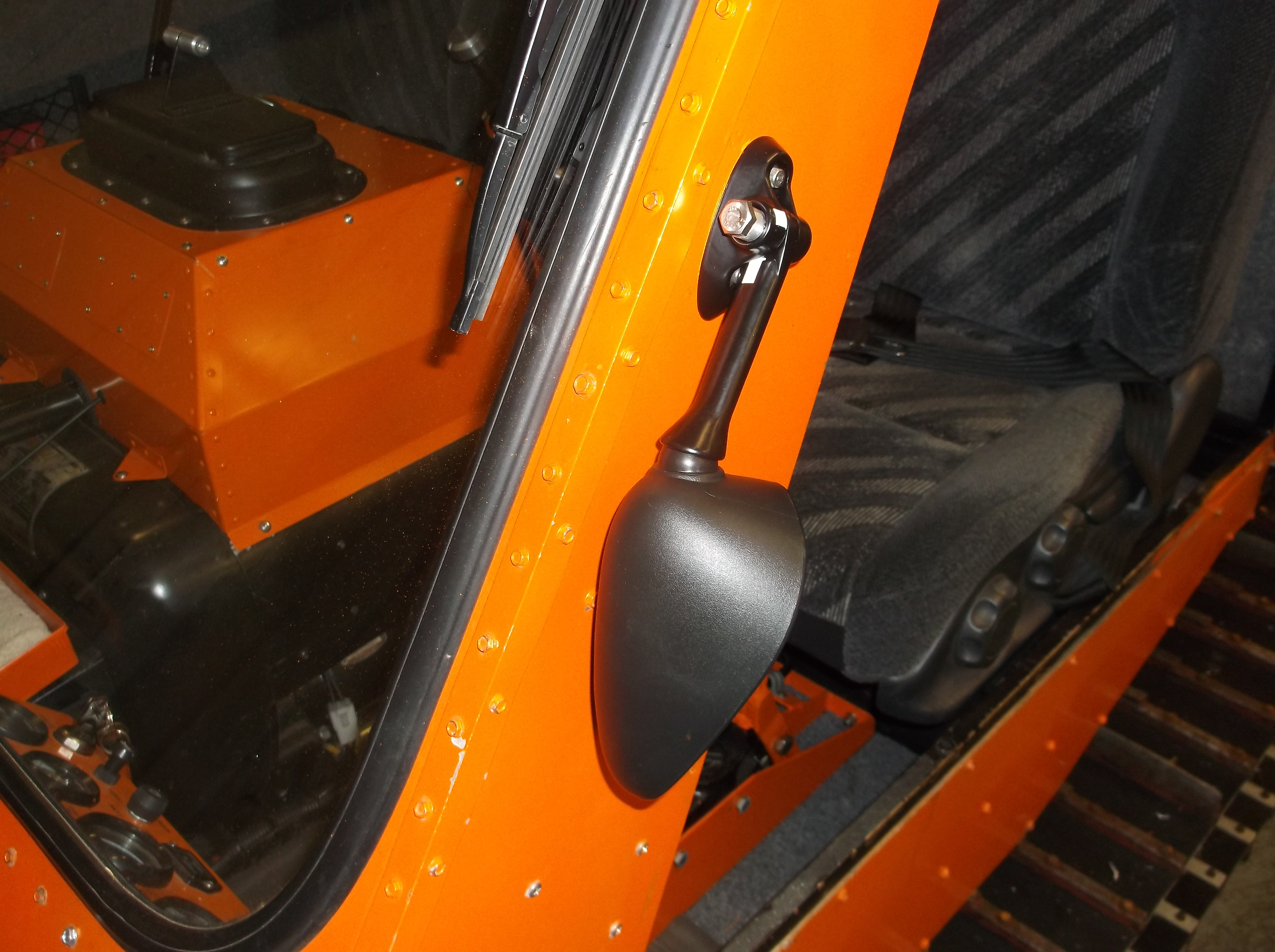

I have tried about 3 different external rearview mirror installations on this cat but none have been entirely satisfactory. The primary issue is I need to be able to fold them in so they don't get torn off when I put the cat in the storage container. I currently have mirrors from a Suzuki motorcycle which can be folded down out of the way, but they are too small for the distance from your eyes that the field of view is inadequate. A friend showed me the mirrors he got for his front loader tractor. They are much larger, fully adjustable and can be folded forward out of the way. They come with magnets to stick in the front loader uprights. I took the magnets off (my cat body is aluminum) and made two 1"X 1" spacers to get the mirror a little farther out and will use two 2" stainless screws to attach them. I'll install them and post the results on our next trip over to the cabin.
The mirrors were about $30 on ebay.

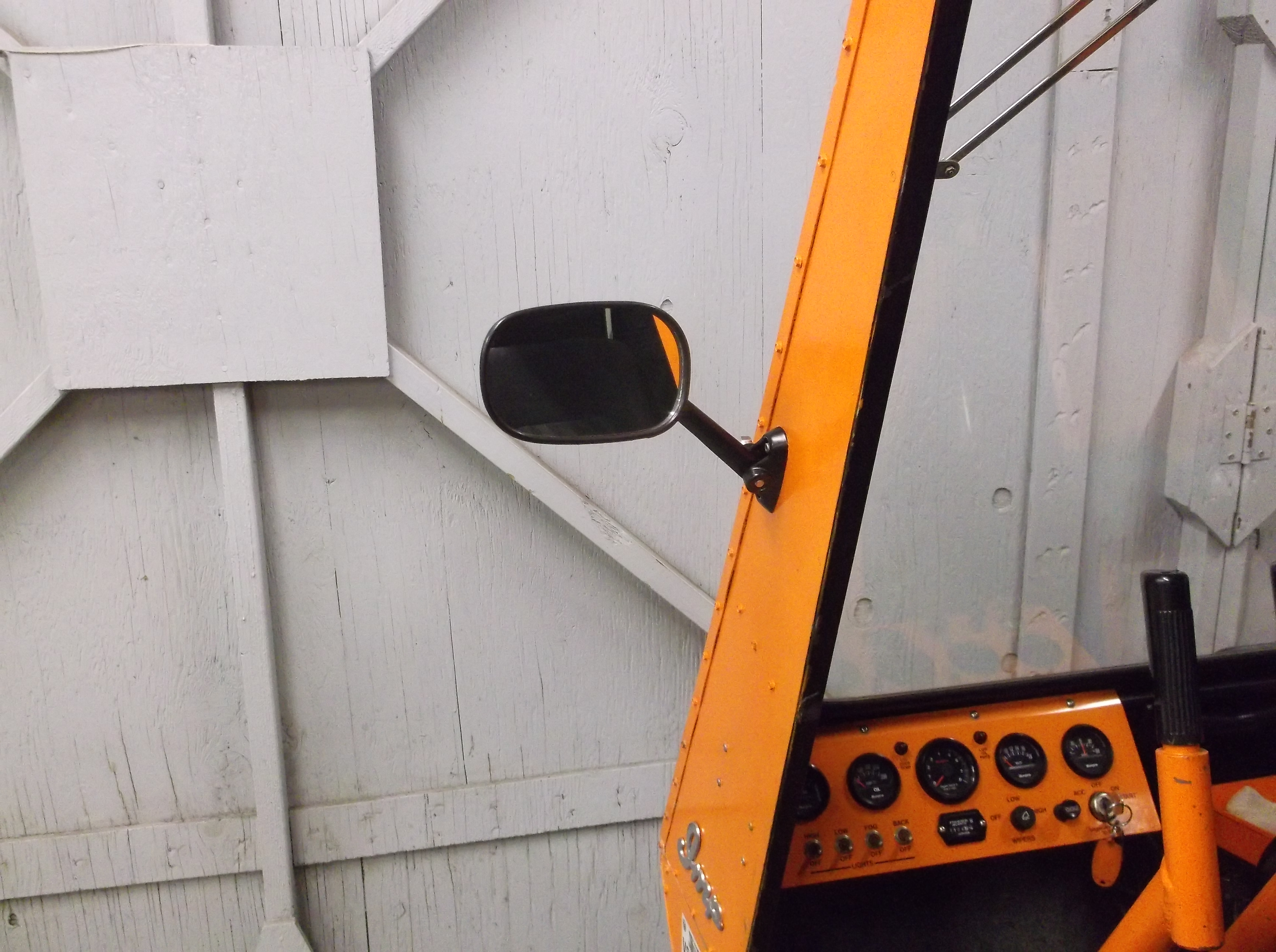

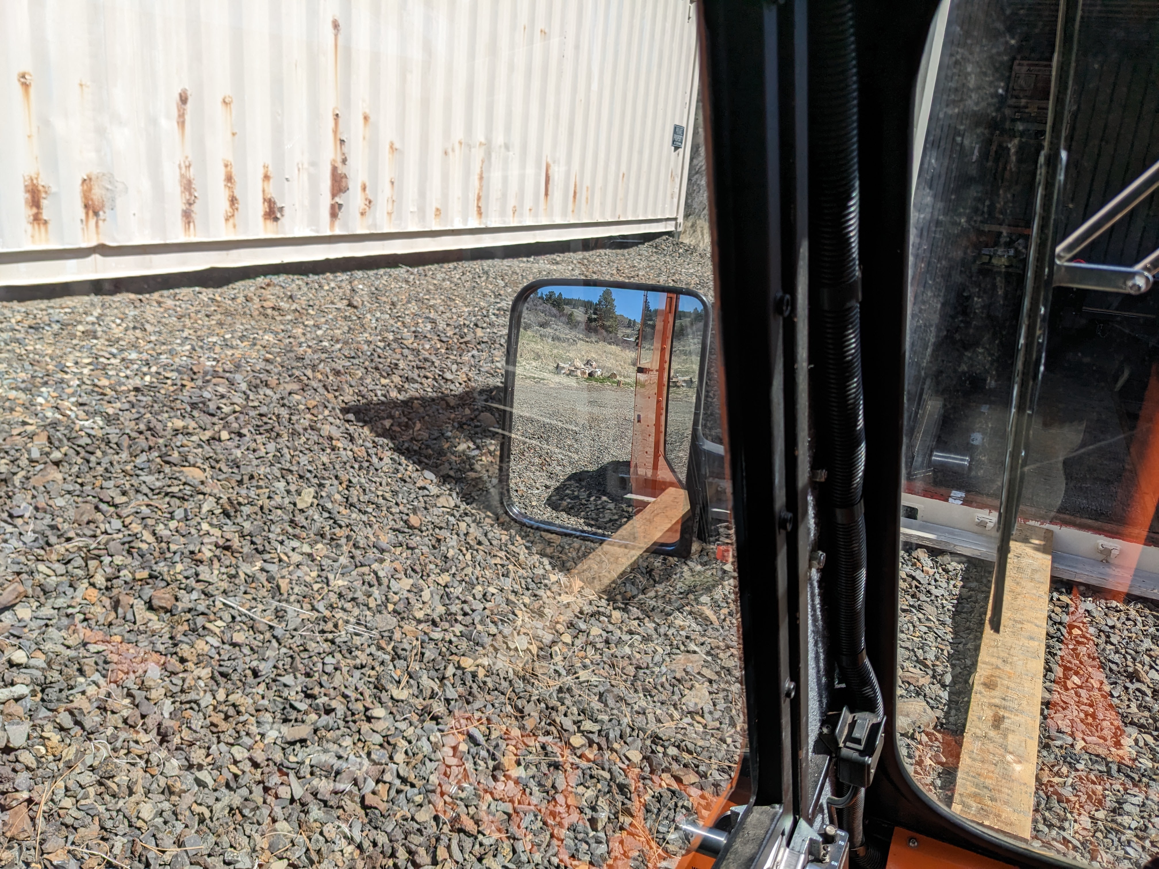

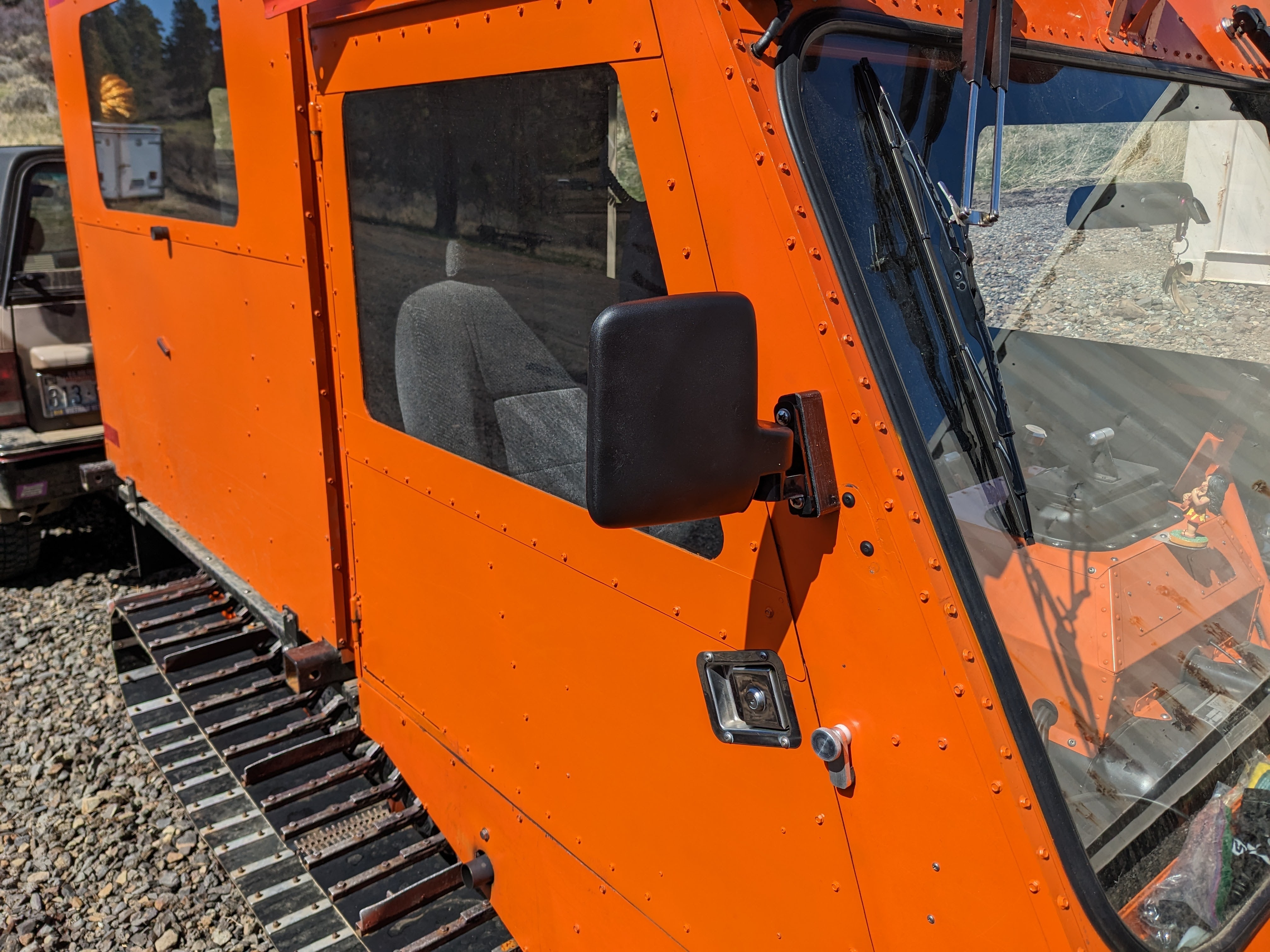

I put the new tractor mirrors on today. They are way better. These mirrors are about 3 times the area of the old motorcycle mirrors so the field of view is much greater. I mounted them on noticeable. To gdt them out past the door frame. They swing 90° forward and back so they are out of the way when I park it in the container.
Unfortunately they are not as streamlined as the old ones and produce a little more drag. Cruise speed dropped to about 5.28 mph from 5.33. Probably not noticeable.

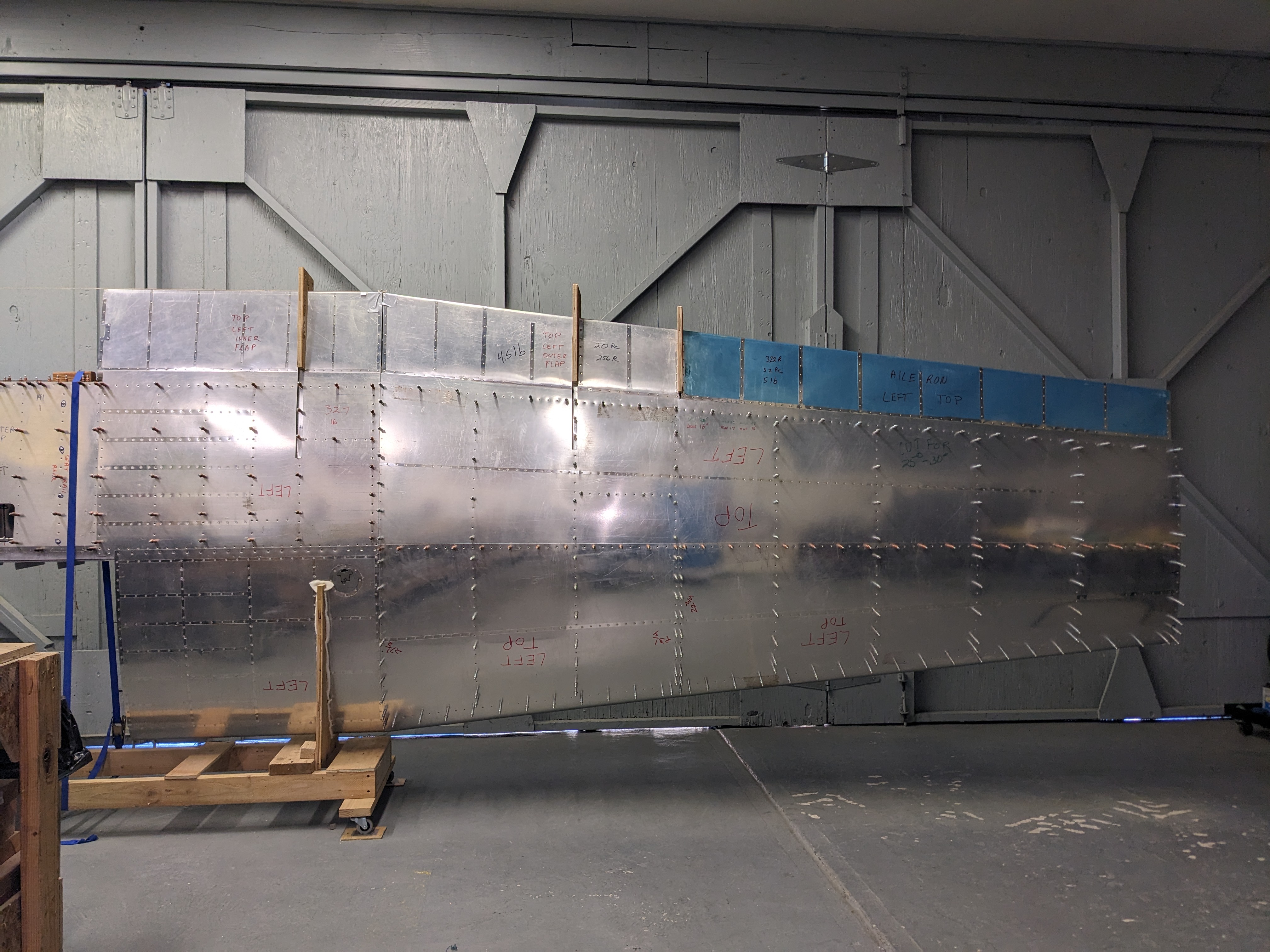

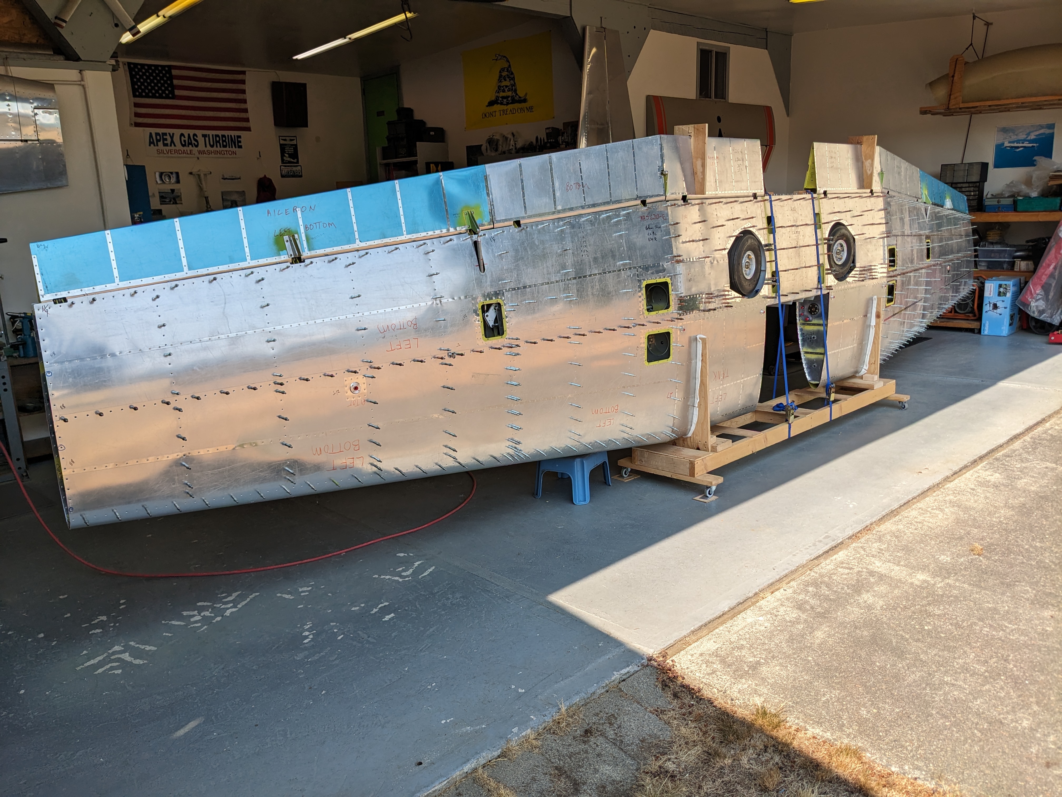

We haven't been to the cabin for a while because it's TOO DAMN HOT. I have been working on my plane though. The wing is pretty much done. All the parts are made but I have to take it apart, chromate the inside and do the final riveting. This has been an ongoing project from before I got the snowcat. It is scratch built, not a kit. The only things I didn't make are the wheels, tires and brakes, the nuts, bolts, bearings and the engine core. I did make the prop gearbox, prop hub, blades, exhaust, accessory drive and fuel control mods. It is an 80% scale Air Force T6A trainer. I finally got to where I have the time to really work on it. The wing is 27 feet long and 5 feet wide.

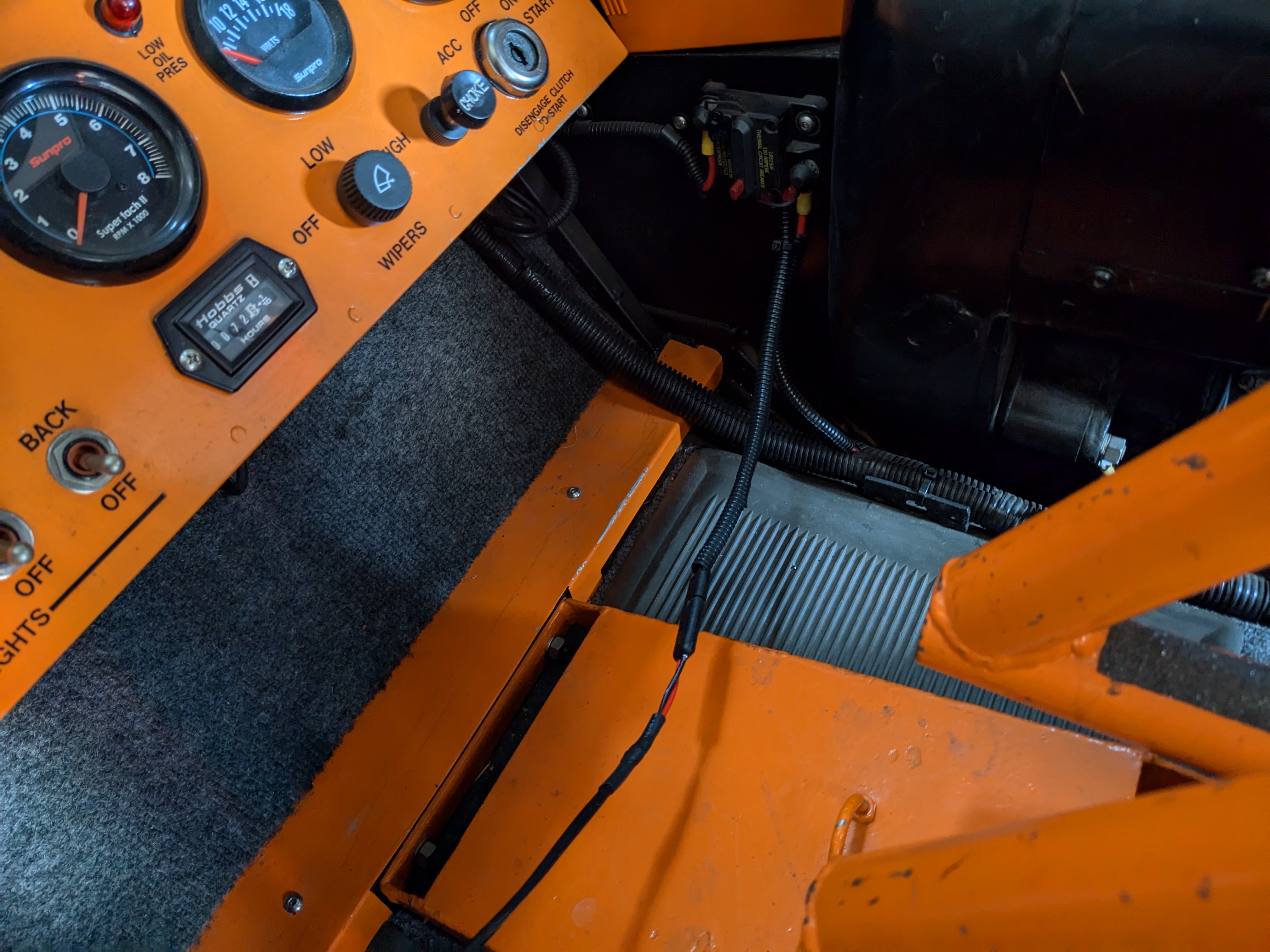

My last post was almost a year ago. Time flies! We never got
enough snow last year to get the cat out of its box. It did get stinking cold though. Down to about -10. When I checked out the cat this spring the battery was low and it wouldn't start. Took the battery home and charged it up. It is a 3 year old Optima so should be OK. That made me get off my ass to put a solar battery maintainer on the container. I used a 25 watt panel with a 5 amp charge controller and a 2 pin SAE rubber connector (like for a trailer) with a pigtail connected directly to the hot side of my disconnect switch. The whole thing only cost about 35 bucks.

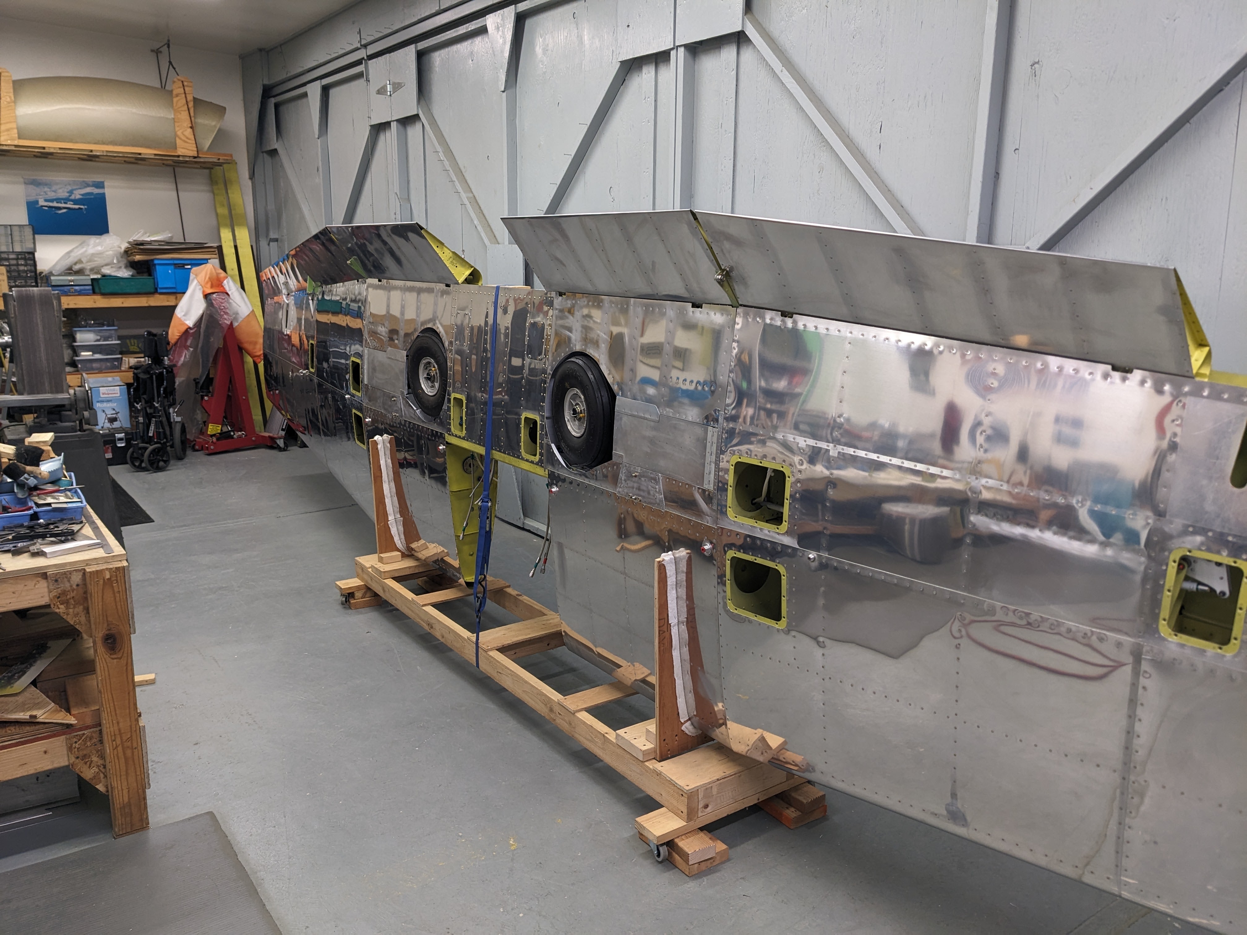

Been busy this year though. Got the airplane wing all riveted and finished. There are 10,104 rivets give or take. Now I'll start on the fuselage. We also got our taxiway paved in July so no more dead summer grass. Put a new torque converter in my 76 GMC motorhome. The old one developed a crack. Heavy sucker. AND (drum roll) we welcomed our first grandson to the world on 3 Aug!

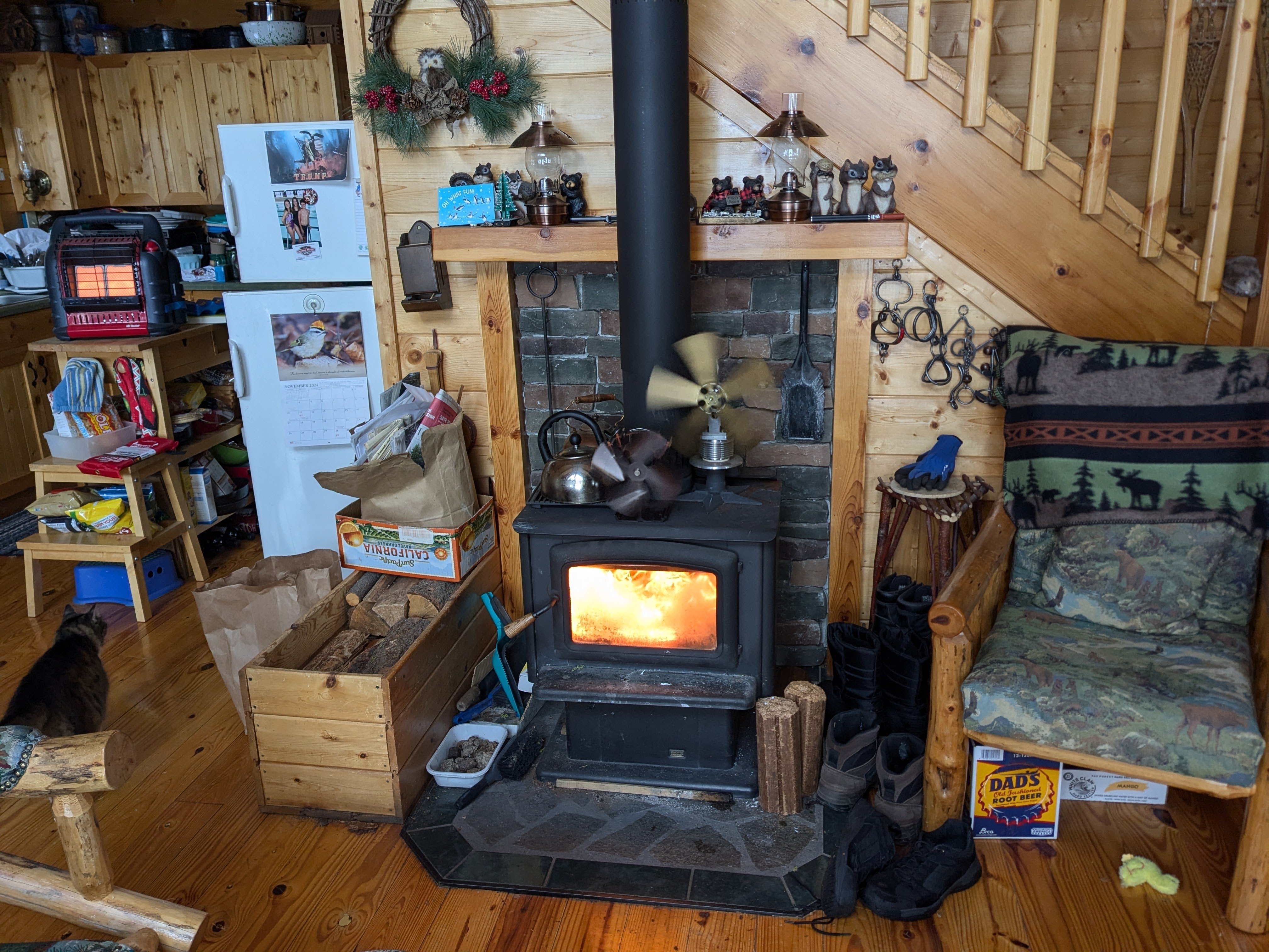

Is your five blade stove fan noticeably more effective than the smaller four blade? We have the small one at our camp, and while it does move air, it is less than impressive.
Just chiming in. Years ago bought one of those thermoelectric 'self powered' fans and while they're kinda cool, they don't move any cfm to speak of. You're better off with a ceiling fan moving air around. Just saying.
