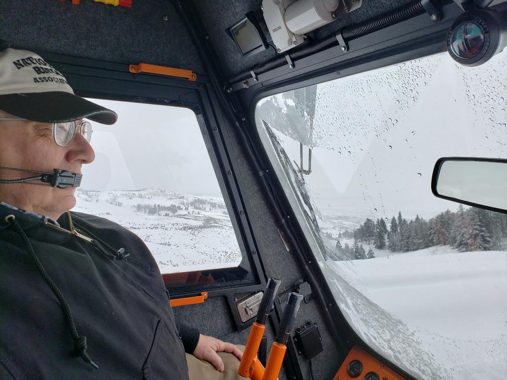

Thanks KT3. We had a good trip to the cabin last weekend. There is about 2 feet of snow up there now. More than we have had for many years. The cat did great! Temps had been down to single digits but were mid teens to mid 20's while we were there. Just right.
Snowmobiling conditions were as good as it gets. I went out with a 20 something friend (I'm 66) Big mistake. I tried to keep up with him and about ripped my new hip out of its socket when my foot slipped off the running board in a steep turn.. Still limping.
My wife and I are getting to where we prefer to take the snowcat when going to friends cabins or sightseeing than the snowmobiles. Slower, but way more comfortable.
We had this very weird snow snake hanging off the deck rail when we got there. I have never seen anything like it before. One of our friends had one too. Conditions must have been just right for something like that to occur. There was about 4 feet of snow that slid off the roof on the deck. As we warmed up the cabin, you could hear it creaking and groaning for a few hours as it slid off the roof like a glacier.
We tried to use the groomer we bought 2 years ago but haven't had enough snow to use it till this year. Got it all hooked up and found the linear actuator that lifts the front would stall and not lift it. So much for that. I brought the actuator home and found the front bearing on the motor was loose radially in its retainer. Fixed that, cleaned up the armature, put in new brush springs and cleaned the corrosion off the thermal overload on the brush holder. I tested it with a little 10 amp battery and it lifted the front of our car so it should be ok now.

You got the wife plumbed into that headset? I’d turn the volume all the way down and let the rocking snowcat nod my head in agreement.:rock:

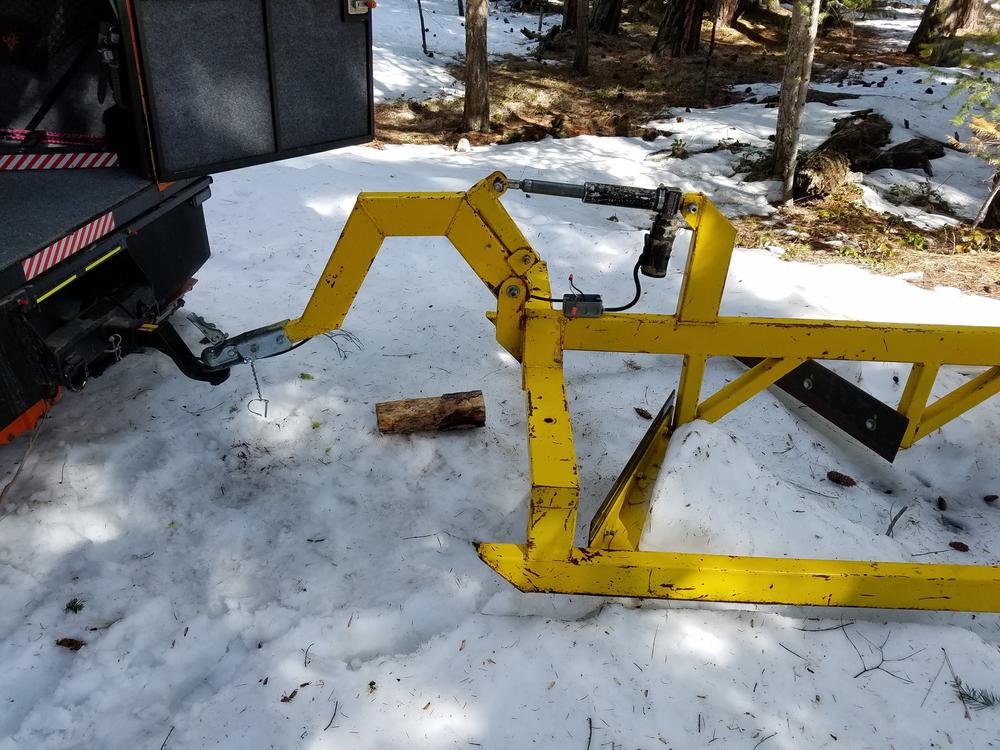

I had taken the lift actuator off the groomer on the last trip because it was stalling out before it would raise the groomer. I fixed it at home and brought it up to test today and it worked fine. Except now there's no snow to groom. Maybe next year. We've had it 3 years now and haven't been able to use it yet. I think if I tried to use it in this sloppy stuff I would just have a big mess.

Hey, how much travel does that linear actuator have?
How much time does it take to go from limit to limit?
Thanks for your input!
It has 6 inches of travel and takes about 10 seconds. The rated force is 500 lbs. It has an internal auto resetting thermal overload to prevent motor burnout in case of stall and at the travel limits to eliminate the need for limit switches.

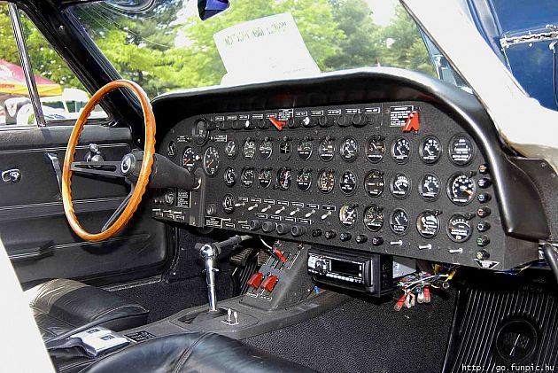

I saw this dash on the interweb a while ago, and thought of you. (and then notices the poopy wiring job on the sound box)

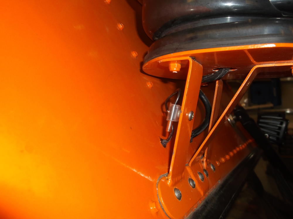

The only thing I did to it this summer besides routine maintenance was I added an outside thermometer. I think I got it on ebay for 6 bucks.
I mounted the probe under the search light away from the body.
Nice to know what the temp is outside when you are toasty warm inside.

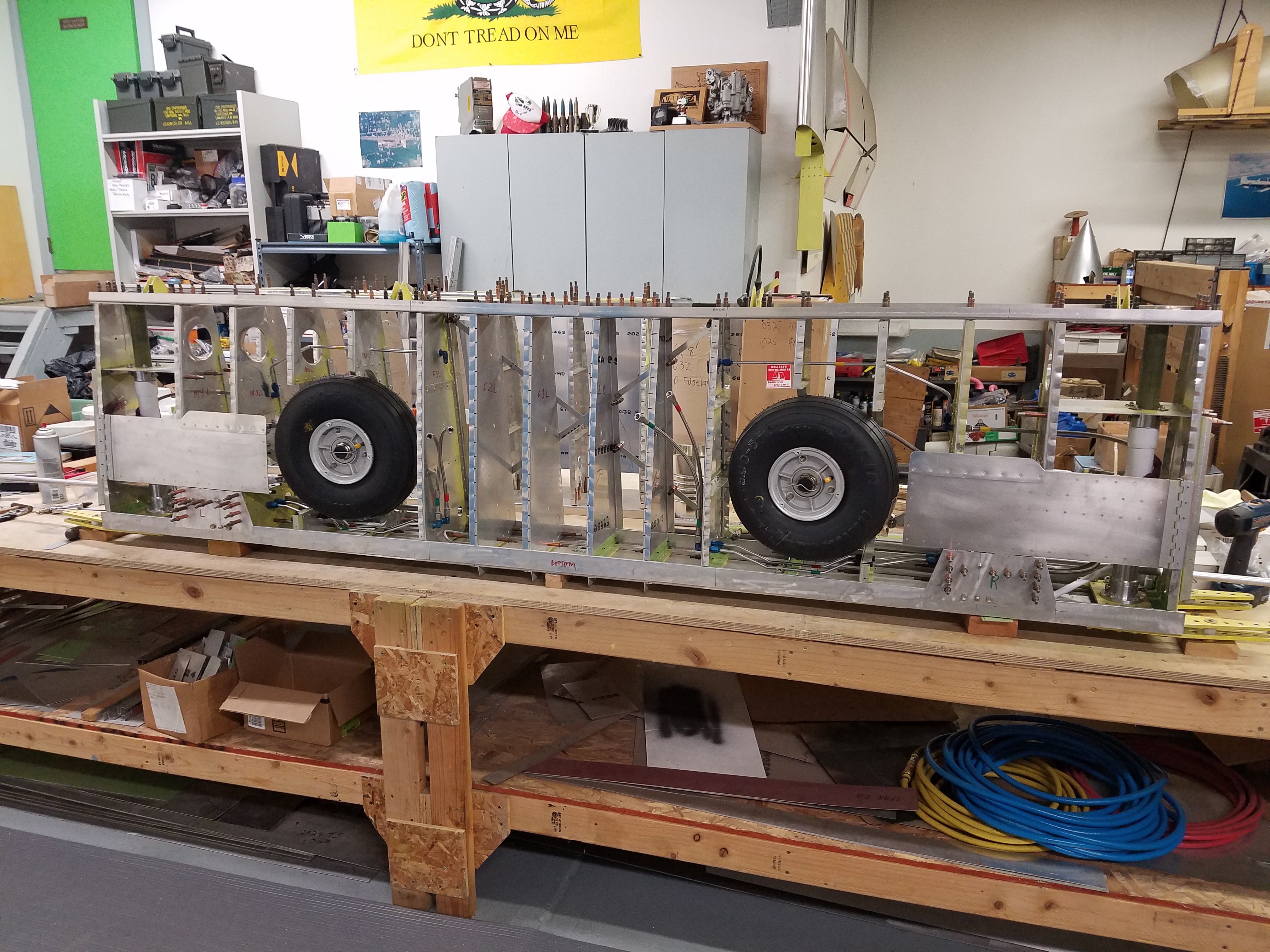

I did get quite a bit done on the center section of my T6A. Got all the hydraulic lines and linkage in. The gear is functional with the gear doors and retractable led landing light. I have to disassemble it and chromate everthing, then it can be riveted and skinned. This was the most difficult geometry problem I ever did. Very small variations in linkage length and it won't work. Getting it all crammed into the wing was a challenge. I could never be an aeronautical engineer. I'm so slow I'd get fired.
You tube video
Without rivets and skins its a little flimsy looking. I tested it with air but it will be slower with hydraulics.

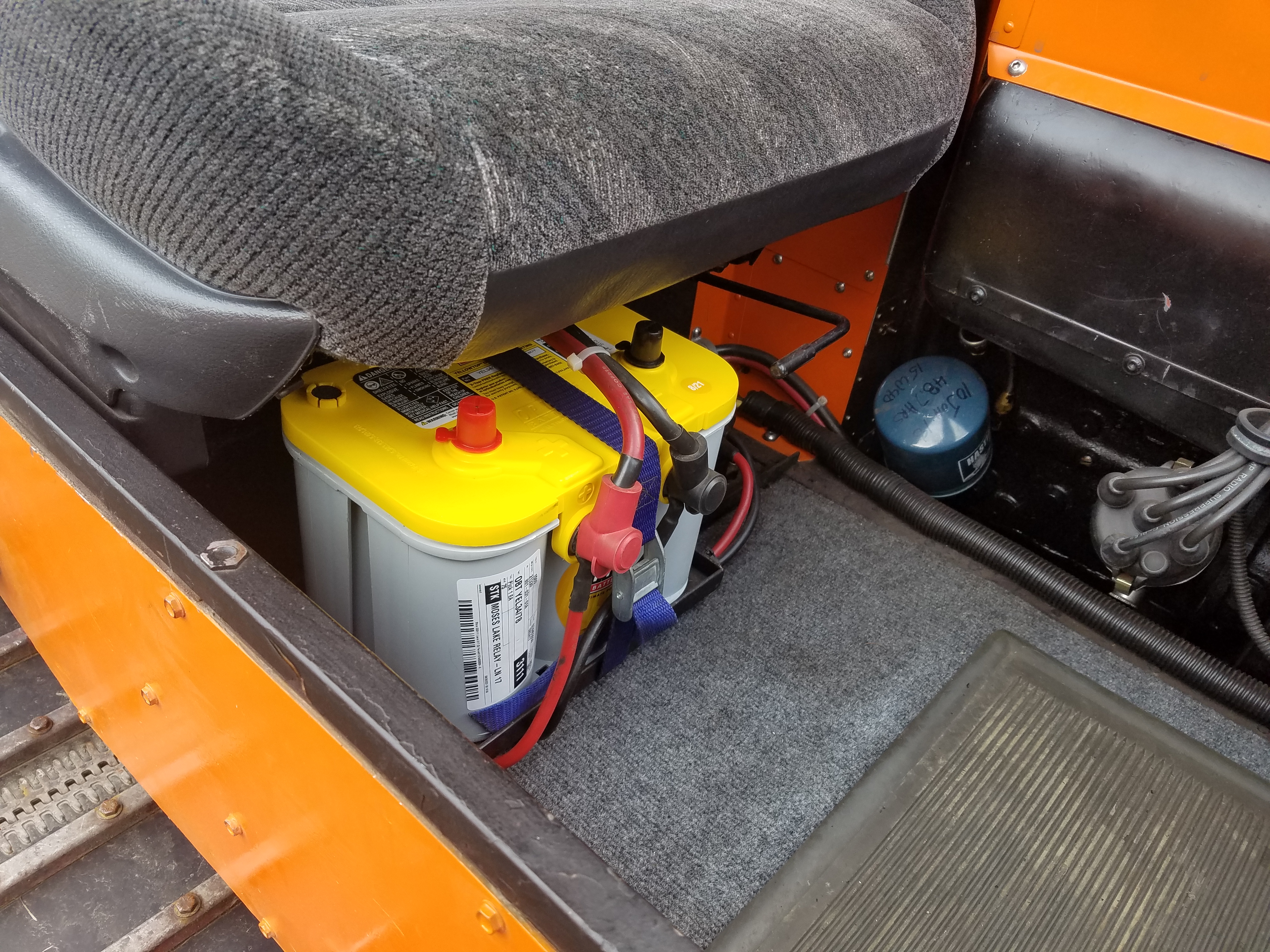

Finally made it over to the cabin. Our last time here was Sep. 6. I was down sick for most of October. So now I have ton of winter prep to do in a short time.
Went down to the container to check on the cat and it had an almost dead battery. Enough to engage the starter gear but not enough to crank it. It has an Optima yellow top battery that Nik put in when he restored it. That was in 2012. Just doesn't seem that long ago. I may have been able to recharge it but once a battery has gone dead I don't trust them. Especially in a vehicle like a snowcat.
With it in the container it is real hard to get to the battery so I pulled the cat out with my truck. Went down to OReilly in Ellensburg to get a new one.
$338!! 😳🤑 I knew they were pricey but jeez!
It started right up. Checked it over and aired up a few tires so its good to go.
I'm going to look for a solar battery maintainer to put on the storage container. I have a battery disconnect switch in the cat but it was really hot this summer which may have contributed to the dead battery. Still, 9 years isn't bad.

Do you have ability to use battery tender and leave it while you are away? Mine snowcats connected all the time while not in use. I bought multi port Noco that works for all fleet
