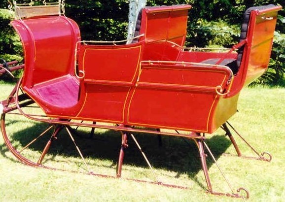

I mostly work on mine :snow2_smi: , but the portable bar helps keep me going .Its been almost 2 years in the restoration and should be running in the next week or so .I probably did not need the popcorn machine and portable BBQ in the back ,but it seemed to be warranted to go along with the ice cold beer and Buffalo wings . I plan to use mine at my Ranch in Idaho to access back country lakes and streams for fishing ,playing and going to town . WE are 54 miles in the backcountry and it will be used daily along with the "one horse open sliegh" that I use at Christmas time .
