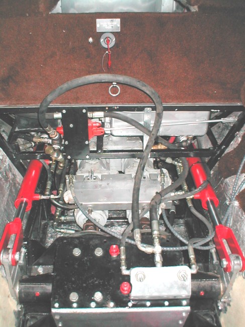

News Update : June 20th 2007
:hide: FFmember BIgAl was found today hiding under a chair ,crying from happiness and damn near hysterical . It appears that crossing the hydraulic lines and introducing a "Charged Oil" hyd line into the hydro drive system has created a working drive system once again .
When asked why he was hiding under the chair ,BigAl, through tears, replied that he was waiting for the other shoe to drop and that he did not want to be hit on the head when it happens . It appears that he has had a run of bad luck latey :snow2_smi: .
Because of a newly sealed asphalt driveway BigAl was not able to do more than move the Yetti in the shop . It was kept in the low speed setting .
Tommorrow he will be pulling his Yetti trailer up to the shop door and loading the Yetti to perform futher test in the gravel area behind the shop . Both high and low speed settings will be tested .:17875:
Al stated that when he fired up Yetti and moved the drive lever control it jumped forward or reverse with no hesitation at all ,even at a idle . This is a first ,as in the past it has always taken a minute or so before movement started ,if at all and at considerbly higher engine RPM's .
At this point it appears that Al has "Jerry Rigged " the system together and plumbed into a hyd charge line to see if this would indeed correct the problem before spending additional money for new hyd hoses of the proper length .
He promised that this "Slip Shod" job would be replaced and correctly installed once all test are completed and he is sure the system is working correctly .
He was later coaxed out from under the chair and escorted to his home by his wife who promised him a DR. Rum and :boobies: .He did request a cooking pot be placed on his head ,before leaving the safety of his chair , just in case all hell broke loose .
Updates to follow ............

HALLLiLUyah HALLILUYAH HALLILUYAH HHAAA AAhhh ahhh yuuuuuuuyahhhhhhhhhhhhhhhhhhhhhhhhhhhhhhhhhhhhhhhhhhhhh!!! Guess I can put my gun back in the safe, Damn it.
CONGRADULATIONS BIGAL! Now we just need some snow and you will forget that ridiculas idea about moving to a place that NEVER sees any snow.
WEll I certainly will not feel confidant until I can run some test behind the back of the shop today ,but it sure seems like it is now running correctly . If this is indeed the fix I needed , it should take about four hours to make permenant repairs , replace the front seat and buttom everything back up .
Then I can get Yetti out of the shop and decide switch to direction to go on the KT4 .

Well guys , I ran some test . I am just not happy with the performace . Top speed appears to be about 8 MPH now . It does not squeal anymore but the torque leaves a lot to be desired . It has one hell of a job trying to climb the hill behind the shop . Just runs out of poop at the tracks . Motor is still running strong and not struggleing .I sent off a email to those guys on Ebay who rebuild these things and recieved a quote of $2200 for each set . Thats $4400 for rebuilt units and me doing all the labor to R&R .
I have another call into a hydro expert to see it he will come out and attach test gauges to be damn sure this is where the problem lies before spending this type of money .It may just be better to trailer the damn thing down to Chico ,Ca. and just let them fix it . Not having any real speed numbers to use as a guideline is tough .
I still believe the lines are routed incorrectly. Your almost there. BUT I would just take it to the experts and have them run the lines right.
BUT 8 MPH in a Kristi KT7 is very fast! No power? Thats normal too. Sounds like she is running better than normal! Hell the fact that it even starts amazes me!
