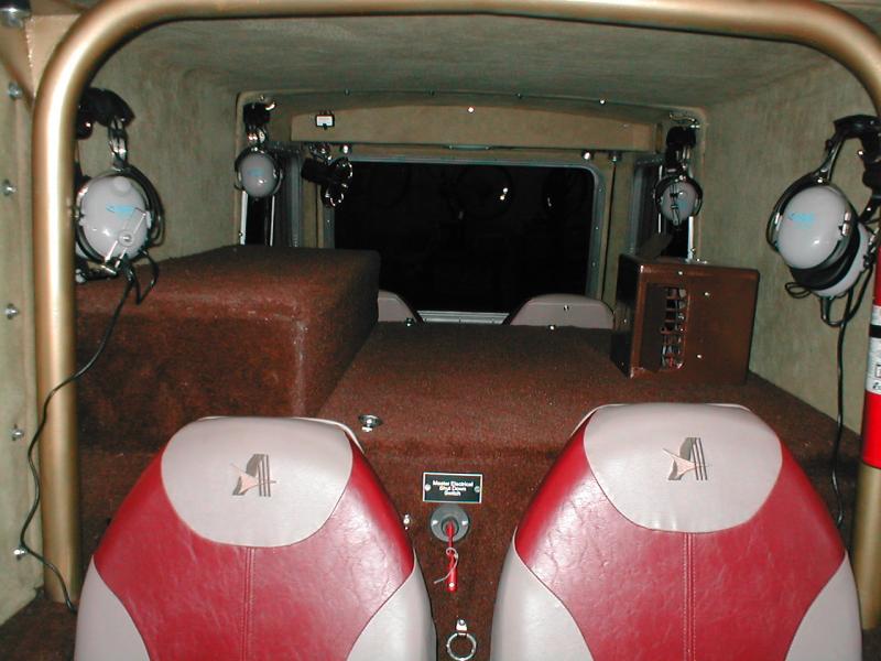

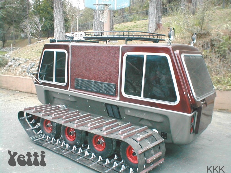

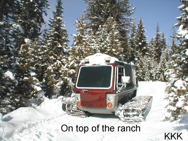

I just realized that the finished snow pictures of Yetti never got posted .
Yetti is now in Idaho and kept in a heated garage on the Ranch . I have taken her out a few times and we enjoyed her . I still need to adjust my steering linkage a little bit to get a better balance and open the the hydros drives to 100% .I will do this when my new shop is completed later this year . This is no big deal and other than that she runs very well
This past year saw me wearing many different hats and being in many locations in this world , so forgive me for not catching up on this earlier .
AS of now I am 3/4 done with my 2nd snowcat restoration and that will be my last one .It can also be found here on ForumsForums
Its a little Kristi KT3 ." Old lucky #13 " Very plain Jane and no bling bling but still restored with love and determination .
I thought these pictures had been added quite some time ago but maybe they were lost when the thread was down for awhile .
So heres the picture that no one ever expected to see .
Good Night and thanks for staying with me to the end ! :smile:

She's snazzy, Al :clap:
Overall, a very modern looking rig, now. Put some hours on; snowcats don't like sitting still !
It looks like it could have just rolled off the assembly line at a factory. Great work and fine pictures! I like the roll bar and all the custom interior work you did.
