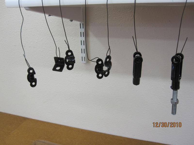

The 602 cab is off getting the paint and undercoating work. Here are some miscellaneous brake/radiator parts getting the POR15 treatment!

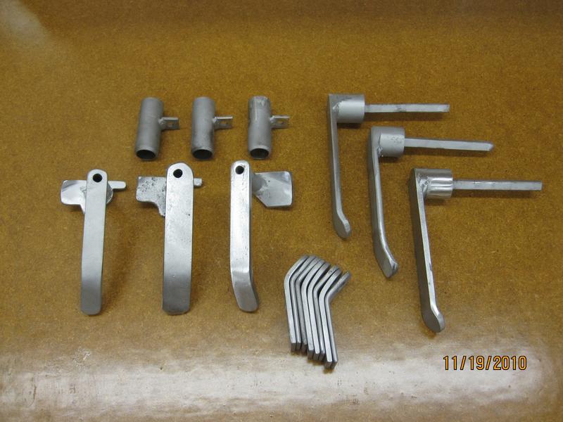

The pictures of your door handles. I need a set of these! Can you have another set made?
Sorry Snowcat...the handles are pretty much the originals...I think one had some reman work done to it. Pretty sure you could fabricate...let me know if you need some spec's and measurements!

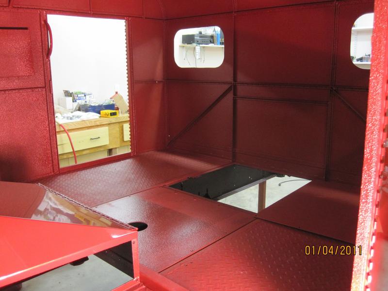

Okay Kevin...what is a Rep. point????:whistling: I am smelling new paint fumes as we talk:brows:

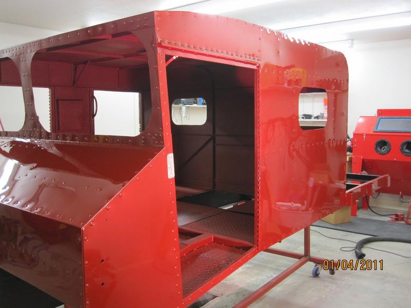

Can't wait to see the new paint on the cab!
Just learned how to give you another rep point... well deserved!
Don't want to jinx it... but this clearly has the makings to be the finest civilian 602 restoration on the planet.

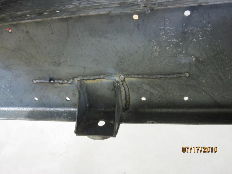

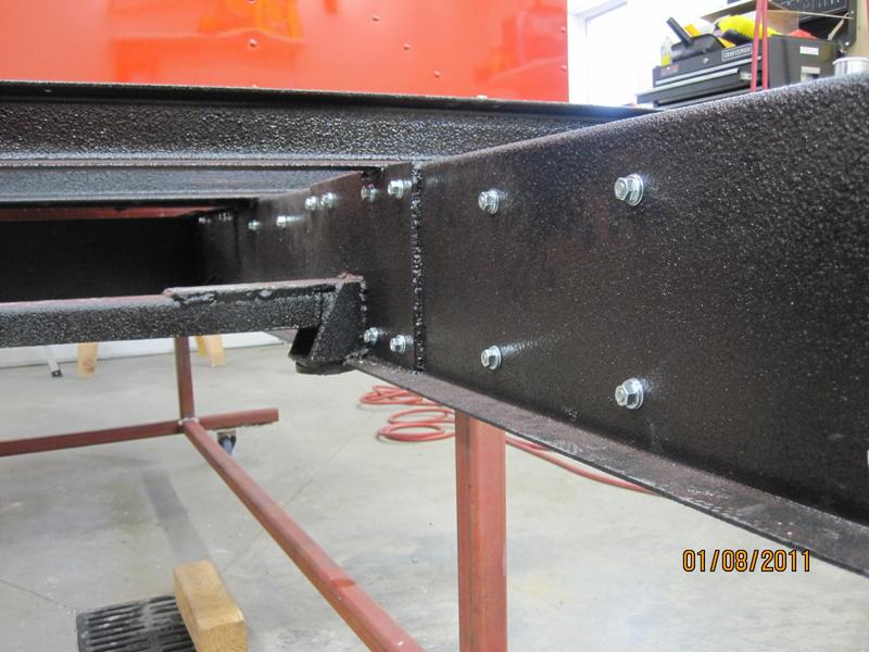

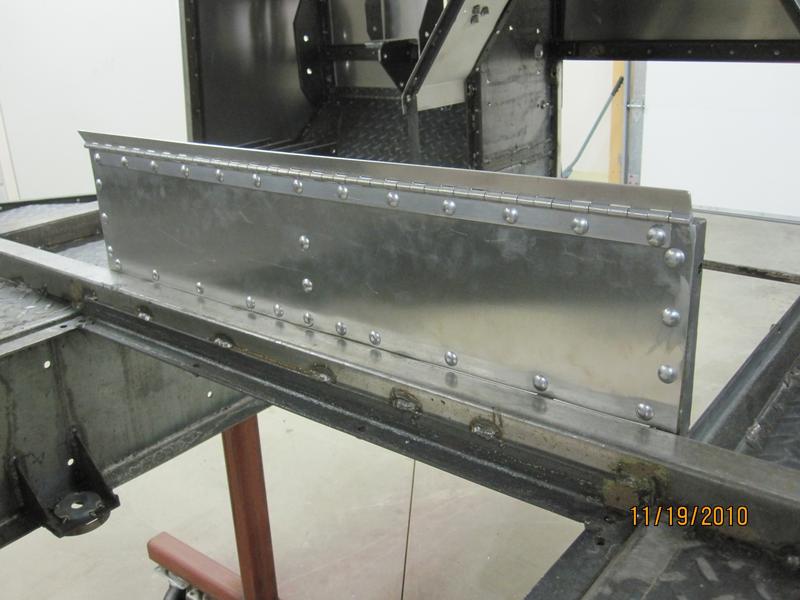

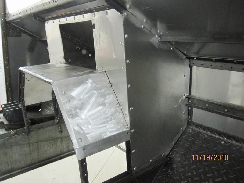

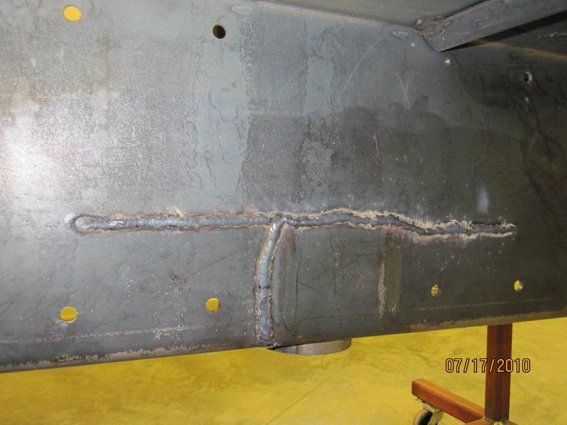

My 602 was original used for 47 years as an utility cat for a rural electric company in Duboise Wyoming. That part of Wyoming is particularly rugged and as you can imagine employees are not always as gentle with equipment as all of us forum members. Anyways, there was significant cracking to the lower structure of the cab. A 8'x10"x1/8" had been added to help reinforce the cat cab longitudinally. Also, I welded 3/8" plate in areas of high stress along with welding of all the cracks.

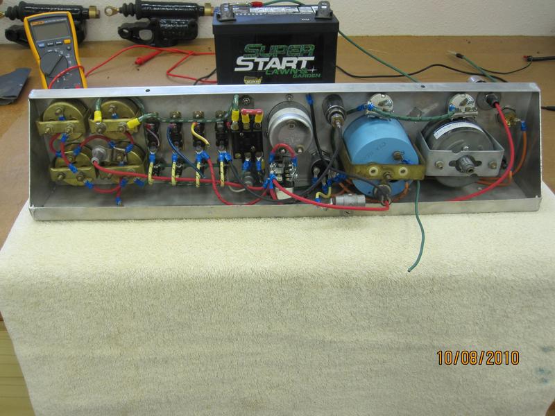

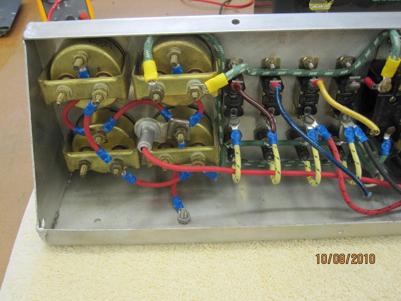

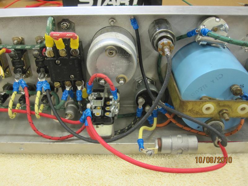

Also got around to pulling some wires:clap:
Nice job on the reinforcement, I had some cracks on my 601 but very minor ones.
Don't forget the rubber grommets for the wire going through the side of the engine compartment. Looks good:thumb:
