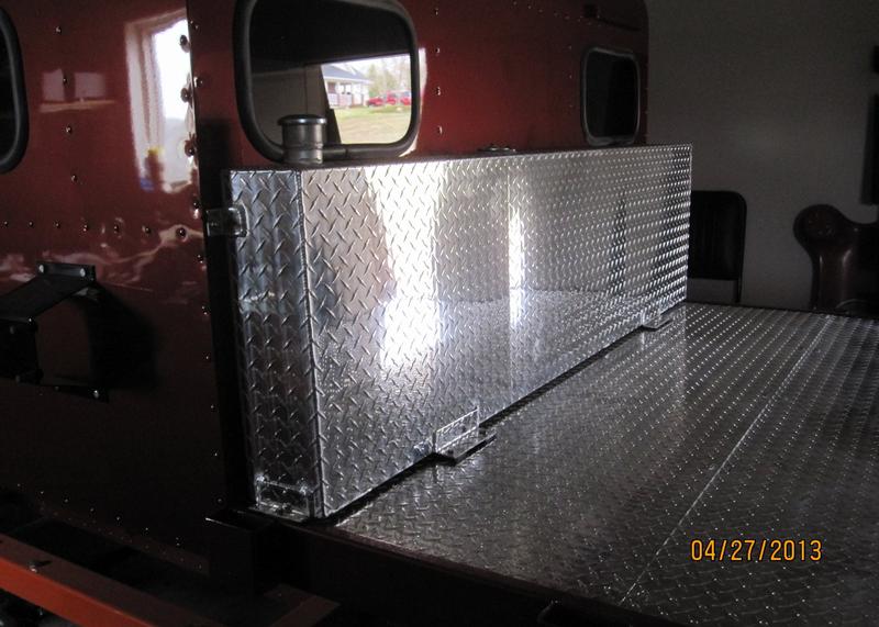

Finally getting around to doing a little bit of work on the restore. Did a diamond plate deck with new gas tank. Ready to put radiator back in and get her started!!
Very nice Dan, top notch job......One complaint though, it's been over a year since the last pics....try to work on that ! :thumb:

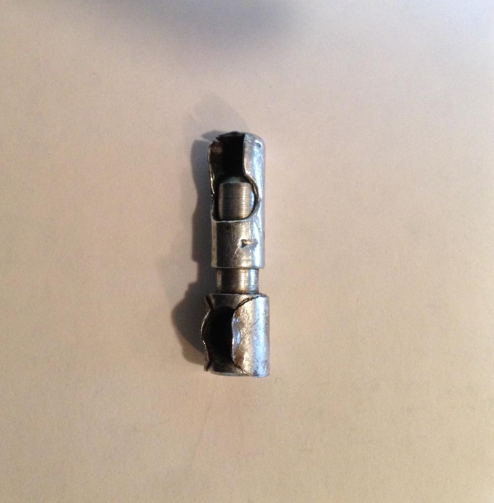

These are pictures of the swivel linkage between the throttle and carburetor on 1962 Thiokol 601/602's. Does anybody have an idea where I should look to get a replacement. The Napa boys were clueless.
Boy that is going to be hard to find. I think you may end up having to fabricate you own using two standard ball joint ends. Going to be tricky because it is so short but I think that is what I would try.
Ya, been all over both of those sites but have not found a double ended assembly....and yes she is well taken care of:brows:

Very, very nice... I can't quite make out the number of layers of poly... it *may* need another dose or two. :whistling: Sweeeeet! I agree with the Weatherby... need more pics! :clap: Some of those pics make me want to fry up breakfast and eat right off the deck diamond plate. It would add just the right bit of snowcat seasoning. :brows:

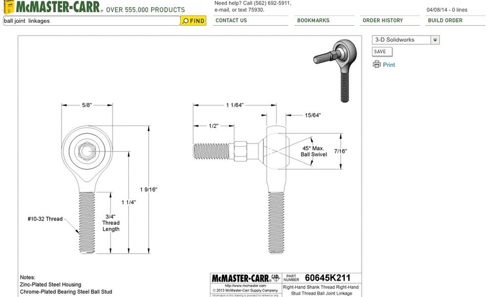

Steel Ball Joint Rod End
Linkage, 1/4"-28 RH Thread Male Shank with Right-Hand Threaded Stud
Each
In stock
$4.76 Each
60645K221
Stud and Shank Thread Size 1/4"-28
Length (A) 1 1/32"
Stud Length (B) 9/16"
Length (C) 1 9/16"
Thread Length (F)
Plus this
Linkage, 1/4"-28 RH Thread Female Shank with Right-Hand Threaded Stud
Each
In stock
$4.55 Each
60645K421
Length (A) 1 1/32"
Length (C) 1 5/16"
Thread Depth (F) 11/16"
Additional Specifications Right-Hand Threaded Stud
Female Right-Hand Threaded Shank
Without Grease Fitting
Able to stand up to frequent use, these linkages offer superior wear resistance. All are ball joint rod ends with the studs attached to simplify mounting. They have a chrome-plated, bearing-steel ball stud that’s machined to fit perfectly inside its housing, which is zinc-plated steel. Linkages are great for clutches, throttles, and shift control rods. Periodic lubrication may be required to keep them operating smoothly. Maximum ball swivel is approximately 50°. They are not load rated.
The combined two of these should get you where you want to be. Not original
But functional if you want original I'm thinking custom fab, or parts machine
Part numbers are McMaster Carr

I think this is what I will try to use...it will need to be machined down just a bit in length...thanks for your help Boogie!:brows:
