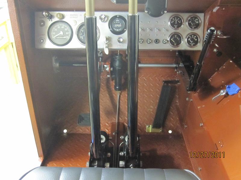

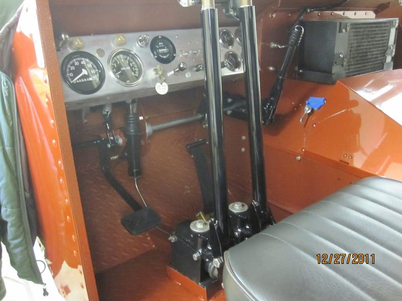

Been working on completing the hydraulic steering lines and the clutch line. Finally have it all back together and all lines bled!!
