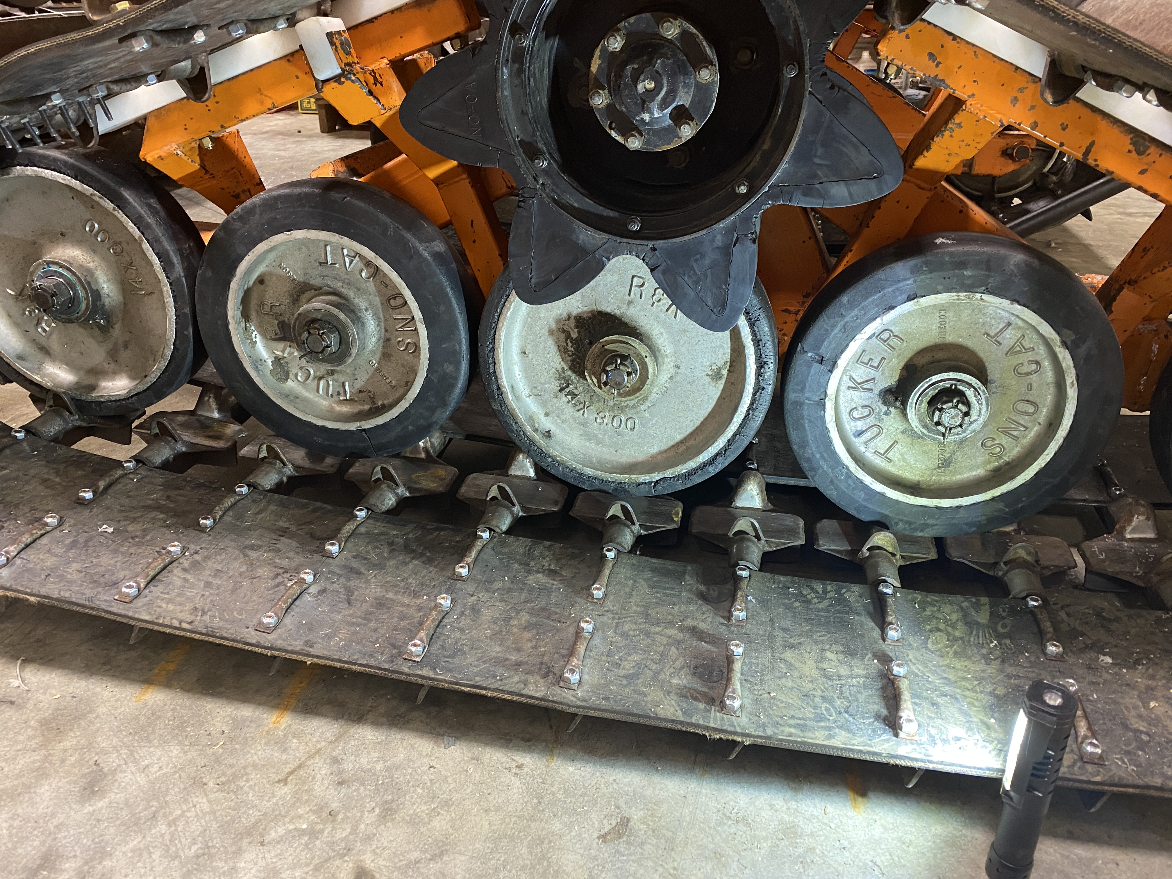

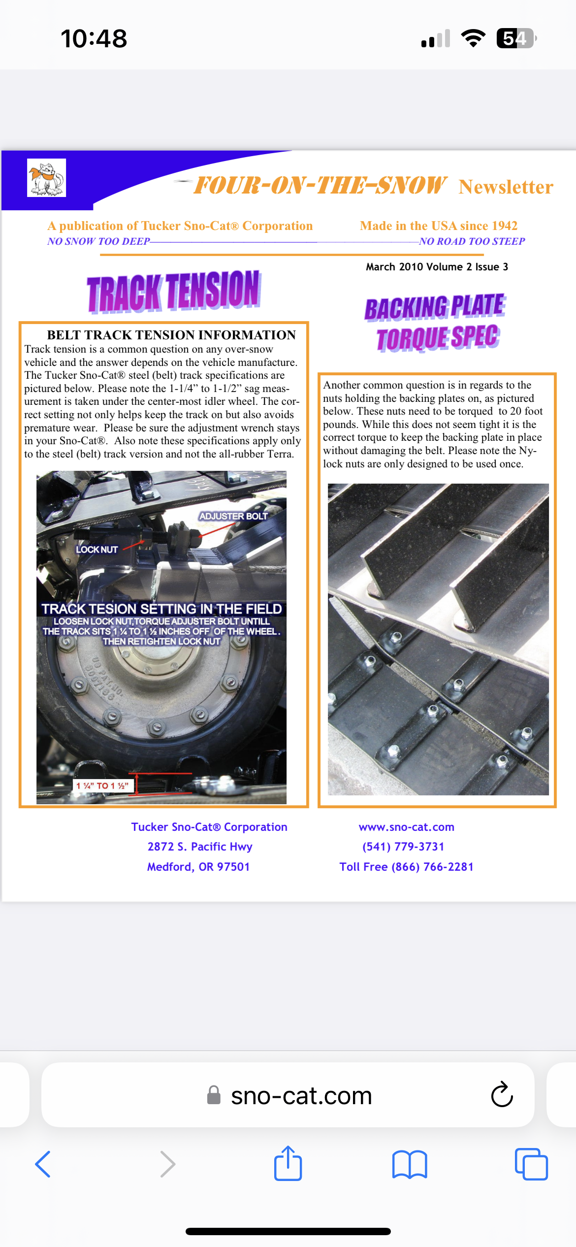

Not much information on how tight to run the tracks. With the track unit off the floor the middle idler wheels are above the metal track guides.
To tight cost horsepower and fuel and high wear. Too loose the track comes off.
Any advice or experience on setting and measuring track tension?
I believe Tucker says inch and a half, idler wheel to grouser measured at center of track when jacked up off the ground. I've been told a little looser is ok as long as you're not slipping the track on the gear.

Okay thank you. That seems about tight enough.
The tracks I took off had the adjuster all the way in, as loose as it could go, and there was maybe 1/2” slack under the middle wheel. Tracks were simply too short before and tight as a drum.

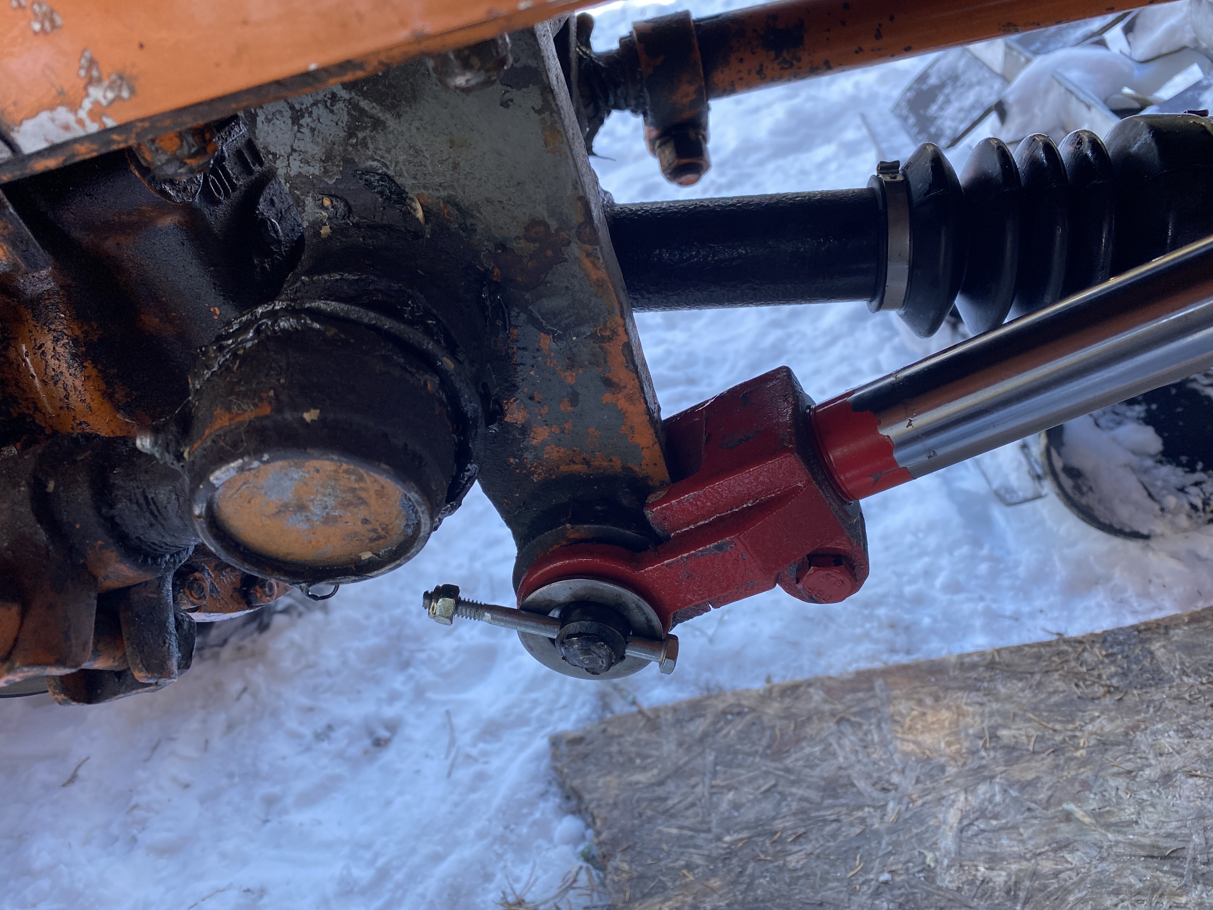

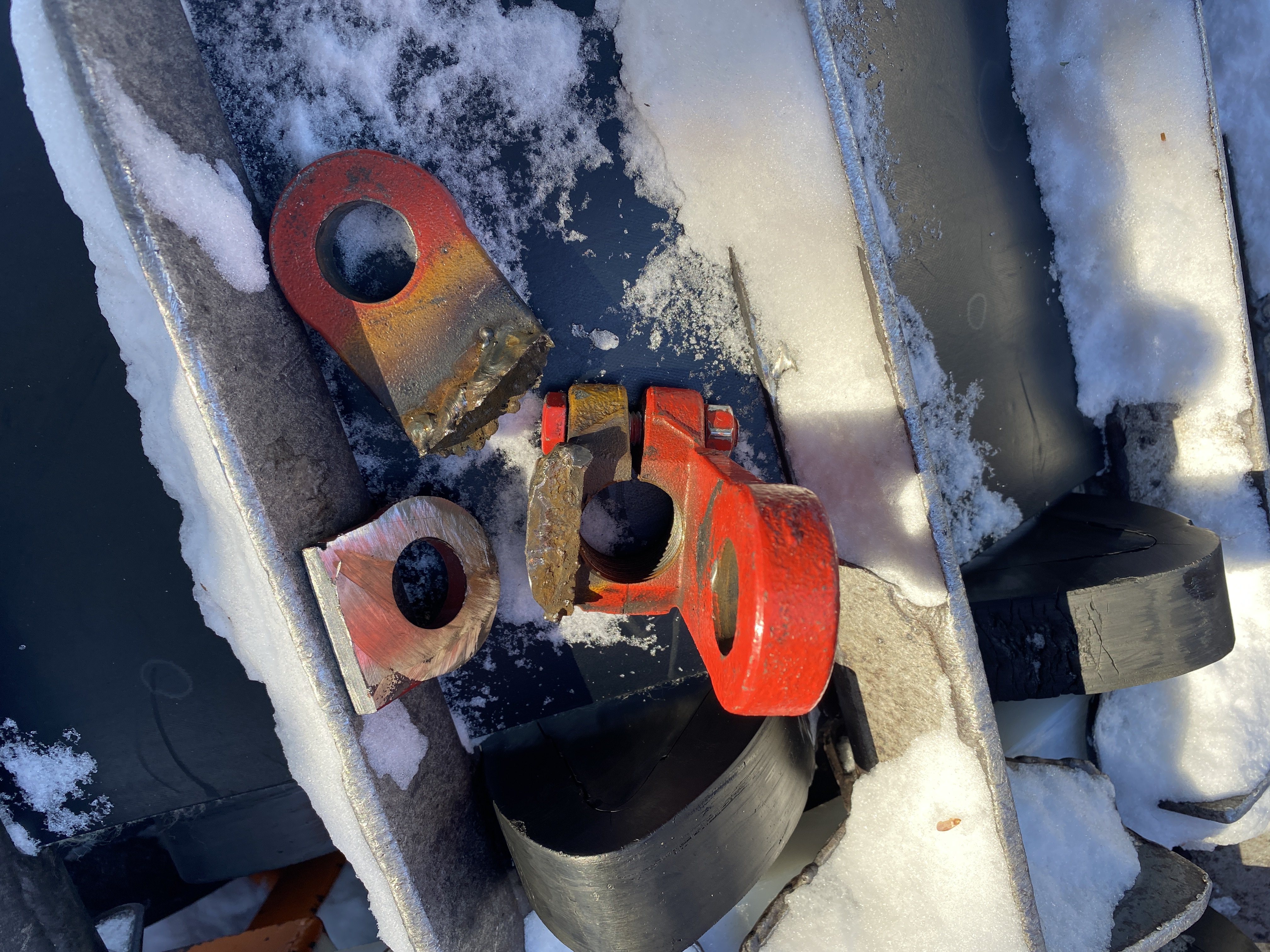

The steering Ram was replaced and the width of the yoke was not wide enough so they had cut an arm off and rewelded the arm not very well. The pin was now too short for both end bolts, so a washer was welded on one end and a bolt through the other end.
The washer welded on the end of the pin came off, the pin then slid out enough to put a little stress on the welded yoke and it broke. No more steering.

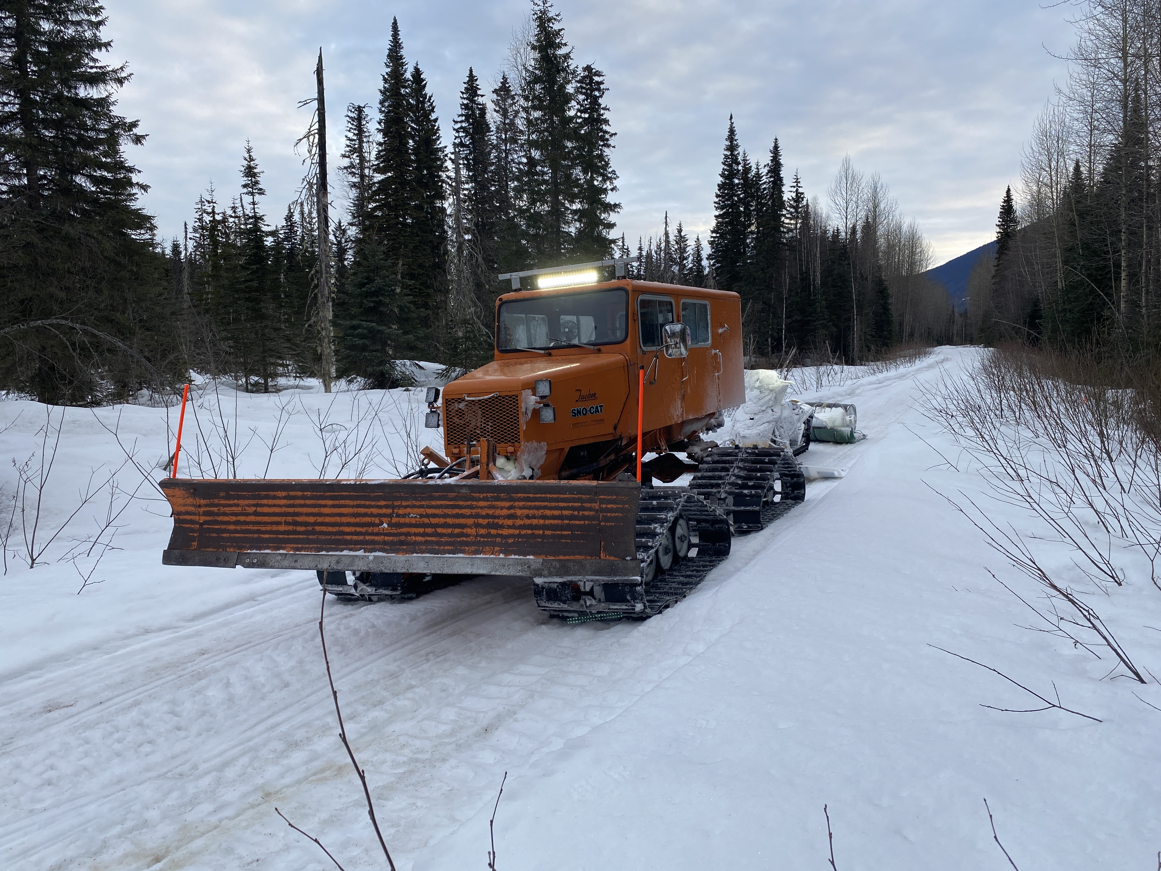

This was now 70 kilometres back in the bush.
We have a “man cave” at the clubhouse that has been collecting stuff for years and one of our fellows from New Zealand spotted a clevis. Turns out this treasure fit the rod on the ram perfectly and after carving off a bit with a zip cutter and hacksaw, it was now wide enough to slip right on the Tucker steering post. The old bushing were installed for the narrower pin, and being longer, I could put bolts through each end of the pin. No welding and better than before.

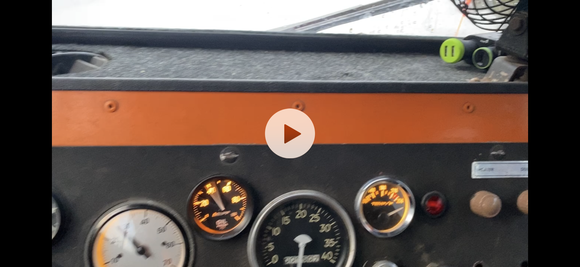

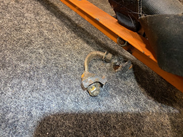

The hot ignition key post comes from the battery. And at one point when I had the dash out, it touched and grounded to the dash. The battery wire instantly melted and I thought I was going to lose everything.
So I replaced the melted wires and this time the wire from the battery was sent directly to a 30amp thermal reset breaker, and then to the ignition switch. That way I wouldn’t burn down my Tucker next time the ignition or something grounded or sparked in the dash.
Then, 90 kilometres later, the 30 amp breaker failed open, and every thing stopped.
We figured that out but something must be wrong as this burnt out a 5 pin relay for the electronic ignition, the transmission temperature gauge started acting like an rpm gauge (until it quit at the pinned position), the rpm gauge is stuck at 2200 rpm, the backup cameras quit, the fuel tank gauge doesn’t go past 1/3, and the usb socket doesn’t work anymore.
The only electric gauge iunaffected is the electronic EFI monitor.
That monitor tells me the rpm and the voltage is between 13.5 and 14.2 volts. Sometimes a little higher or lower and is not too rpm sensitive.
Does that mean my electronic voltage regulator is working correctly?
Something sure screwed my Tucker gauge dashboard.
Ideas?????
I would look at the ground side of things. I would imagine there is a heavy gauge ground from the battery to the engine. Check the ground from chassis to engine or battery. When you had the short the current had to seek ground back to the battery somehow.

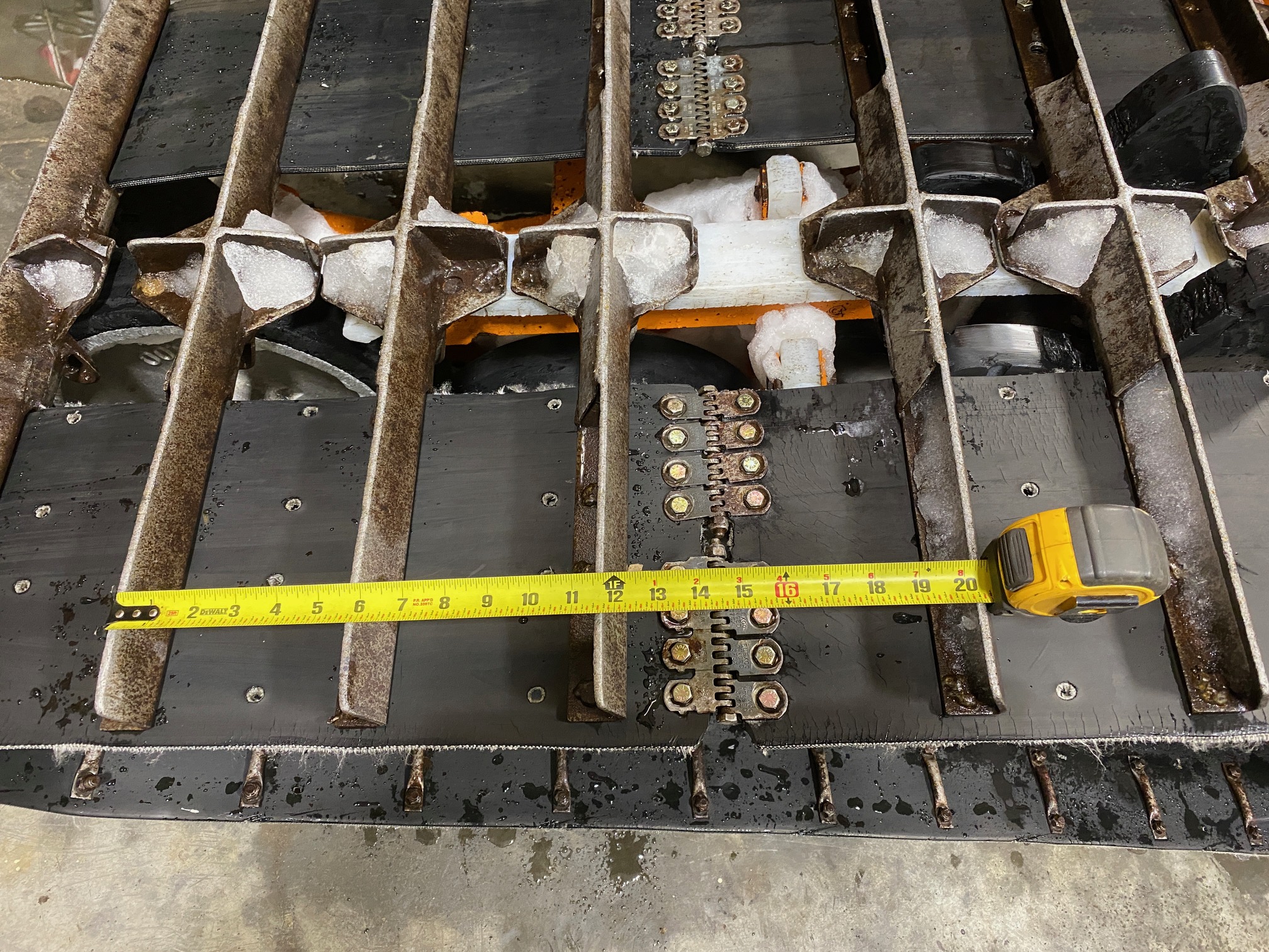

this situation is likely from the wrong belts..... Tuckers of this era had two ( actually three) pitches 5 7/8 and 6 1/8 Pitch are the more common pitches.. owners many times simply buy/bought the wrong belts.
get your build sheet and make sure your sprockets are the correct pitch for the belt spacing and you should be ok. as funny as this is there is more..... the carriers are different between years also, as tucker is awesome that way.
The belts I took off and various spacing. Anywhere from 9" to 5" so the 27 grouser were just attached to the belts with approximate spacing to fit the belts they had.
I bought new belting and and drilled the spacing at 6" and that was before I new I could obtain this Tuckers build sheet. The sheet says Tracks 28" x 3/16" W/375 lacing, 5-7/8" P.C. I thinking the 5-7/8" is the pitch so I drilled the pitch 1/8" too long. It seems to run quiet and not clatter so I thinking close enough. And since I am only running two belts per track the stretch will be minimal.
I was looking at the replacement steering ram and wondering whether it was the right size.
The shaft measures 1.25" in diameter. Is that the size Tucker used?
At the parts store I was told of other peoples experience with the Dodge two wire electronic regulators. The common problem is us builders never take the paint off the firewall or the mounting surface to give these regulator a good ground to dump the power from the alternator, and the result is always fired gauges.

The ram is not original.
It doesn't leak as it is fairly new looking.
The ram might be the correct diameter of ram, or not.
The ram is from Princess Auto and both ends had to be opened up and welded to fit on the Tucker, which make me suspicious.
Quite often in order to turn left I have to back up and jocky back and forth while holding the wheeling wheel over hard in order to get the Tucker pointed in the left direction. Seems like the ram is undersized because it is much easier to turn right as that is the end of the ram with the larger surface area.
this is common for the obvious reason you point out but consider the Horse shoe may be twisted it takes a lot of force to over come the binding created if the saddle or horseshoe is twisted. while the ram is off have a good look at it and the bushings they need to be parallel to swing easily. I am going out to measure a few tuckers steering ram to see if that data helps you.
