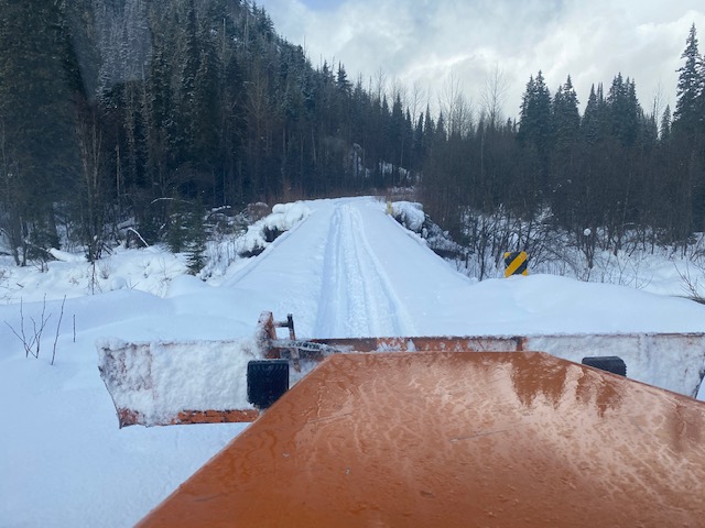

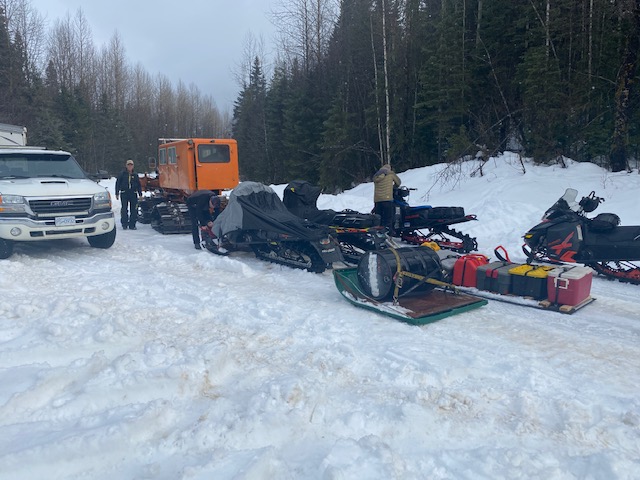

We are back from the trip. Didn't get very far. Snow was deep, wet and heavy. Tucker was pulling two snowmobiles and two heavy skimmers totaling 3,000 lbs. One skimmer was 45 gallons of gasoline. I was following old snowmobile tracks and while one track was on the sled track, the other track would dart off the trail pulling the Tucker into a hard turn and nose down stuck. It was easy to back out and get lined up again, but I gave up after 20 kms.
After turning the Tucker around and parking we continued on the rest of the way on snowmobile and came back 4 days later. The Tucker started up no problem at -6C, and after hooking up my snowmobile and the skimmer carrying a half barrel of gas, I headed back to the trucks.
Traveling on the trail I made 4 days ago on 4" fresh snow, the Tucker stayed in high gear and was burning about 15 lbs per hour less fuel than the trip out.
On Monday in wet heavy conditions the engine was running at 200F, burning 70 lbs per hour fuel, and the 727 was at 160F. In 20 kms the Tucker burned 100 liters. The exhaust pipe heat was extreme. Even the door sill frame was hot so I need to do some heat deflection and protection. I check the engine oil and it was still full, but the rad was down 2 liters.
All in all an extreme first test ride

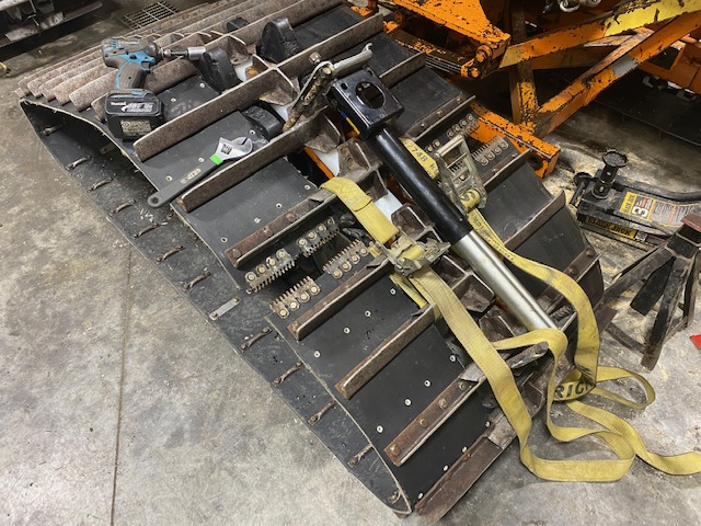

I had noticed one of the tracks was bumping, indicating a skip or slip of some sort.
Back in the shop I think I located the problem. The spacing of the grousers is about 5 3/4" and the space on this one track joint is about 9". So I'll shorten this joint up and it should cure the problem
After I cut 3" out of the track belt and had it ready to go back on, I thought I might as well check out the idler wheels.

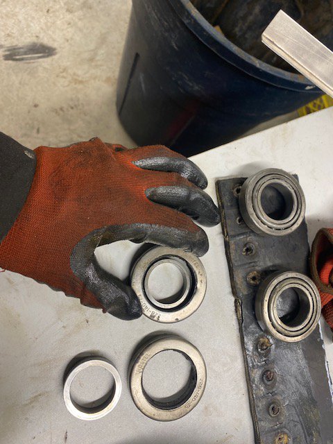

A couple were wobbly so I pulled them off.

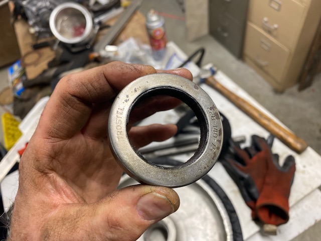

I didn't find any of the nice thick seal bushings with the o-ring inside, just the thinner bushings that barely touch the seal lips.
The one wheel had what look like original seals in there. The seal was Trostel 228-140-75 and look like they had leather or something for the seal face. It was totally worn out, but the bearing looked good. The cone was grey and worn so I changed everything in there. For a test I used a couple of the bigger seal bushings (with O-ring) and put the seals in backwards. I'm not so sure about this idea now as the space allowed for the seal is narrow and the seal may fall out. The bushing has to go in before putting the wheel on the spindle as the seal spring get pushed out. So the seal goes in and then the spring goes in over top.
The bigger bushings slid on tight, which is nice. No more wobble in that wheel.
The next idler wheel I took off because it was wobbly had bearing cones that were not tight anymore. The cones didn't fall out of the hub, but I could turn the one cone in place. So I clean the wheel up and installed new cones with red Locktite. I don't know if this will work to hold the cone in place in the hub or not. Comments on the Locktite idea?
No experience with the locktite, but have center punched the surface that holds the race of a bearing before. Swells the surface and keeps the race from turning. Maybe both.
The green race retainer made by loctite is probably better than the red also if this does not work there is a race that is compatible with the same inner bearing that is slightly larger in OD. You would need to take the wheel and have the inside race serating area machined to the new race OD but it saves the wheel I had to do this with a couple of mine but it is better than buying a new wheel.
Thanks for that. It looks like the wheel journal surface where the race sits has been peened once already, and is sloppy again.

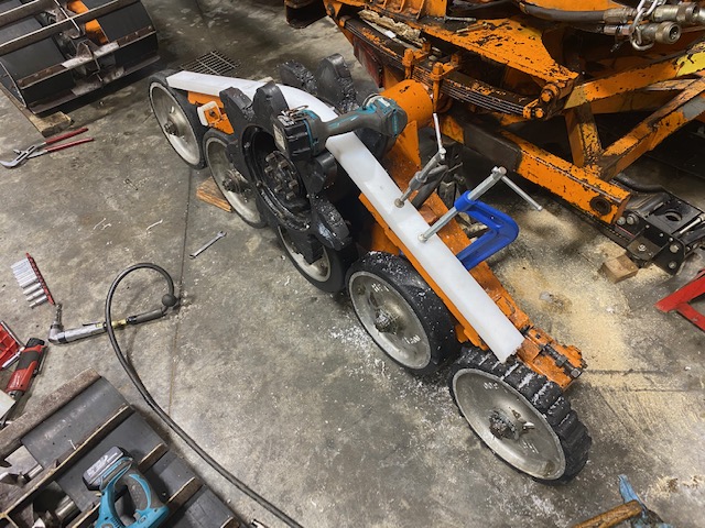

I going to put in new Teflon strips and Teflon rider "ice blocks" Does anyone know what height these should be at?
Should these be level with the Teflon strips?
Mine just clear the cleats where the sprockets ride when the cleats are resting on the Teflon strip in the middle. One think I did find about mounting the center Teflon strip is make it come as close as you can within reason to the rear idler mine is about 1/2” from touching the rear wheel. The closer this gap the smoother the transition when te tucker is in motion. At first I left mine a bit shorter than the factory ones and the machine vibrated so bad you could hardly drive it because the cleat were hitting on the leading edge. We did my sons and moved them up as close as we could his is very smooth even better than the factory length. I remade mine the same as his and it is very smooth now compared to original. It still has a little of the clack when transitioning from wheel to slider but that is unavoidable with the Teflon strips. It just makes it a lot better even better than original factory
The material isn't Teflon, it's UHMW plastic (Ultra High Molecular Weight).
The ice breaker blocks are symmetric when new. You could remove the center bolt and turn them around so the area below the bolt is now above the bolt. That would extend their life appreciably.

Speaking of inspired, I tried to correct a bad track spacing problem that was causing the track to "pop" every revolution. The spacing at the track joint was 9" instead of the ~6" spacing of the rest of the cleats. I cut 3" out of the track but it simply is too tight now and will not fit anymore. There was no slack in the track adjuster when I started either.
I have a local fellow here that will sell me belting for this, and he has sold us belting before for our other groomers, so What spacing should I drill the belt at?
It looks like the belting was drilled at a variety of pitch from 5.5" to 6.5" with most spacing at 5.75" so what should the total belt length be, measuring from the pin center at the joiner"?
We have a plastic supply shop that sells UHMW to local industry like pulp mills and sawmills and river boat builders. I'm lucky to live a good industrial town with good inventory. In cutting up the idler "ice" blocks I did notice that they seems nearly square.
I think this went pretty well, except no one had carriage bolts with the long shank. So i switched to bolts and a washer. I ground the bolt head down to help sink the retainer.

The variance in your grouser spacing is concerning. As I'm certain you know, that will cause premature wear on your drive sprockets. Tucker has used different grouser spacing. I think the most common is 6 1/16". When I bought my first Tucker from SnoTrans I was given a spare belt and it has 5 7/8' grouser spacing, so I would assume that was another dimension Tucker used.
I recommend every Tucker owner call the factory with your serial number handy and ask for the order sheet. Tucker generously and cheerfully will look it up and email it to you. One of the data points on the order sheet is the grouser spacing called "Belt Pitch".
