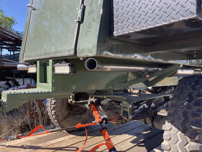

I am going to have the muffler shop install dual pipes, and if there is an issue with the exhaust being a concern,
I can run the exhaust up the back of the cargo box to the roof.
There is no longer enough room to put in the original exhaust pipe that went under the middle of the oil pan, so I have to come up with another idea.
There is room behind the oil pan and transmission to cross over and use the original muffler up the passenger side of the cabin.
So I was wondering about putting the exhaust and muffler under the cabin on the outside, or between the frame? Is there a reason I don't see exhaust systems under the cab to come out at the back end? Someone must have tried this?
For what it's worth, with Puti-Zilla it was decided to go with dual exhaust out the back. As Track Addict explained, one has to be careful how the pipes are routed so a track can't hit the exhaust. Here are a couple of pics of that installation:
But, your system would be different as the lower truss frame on this machine is straight and I believe yours is hourglass shaped. (It's likely we will have to add some heat shields to the system, but at this point we haven't determined where that will be necessary.)
Yup that will work just fine for me.

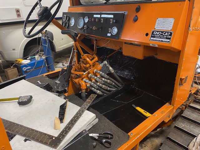

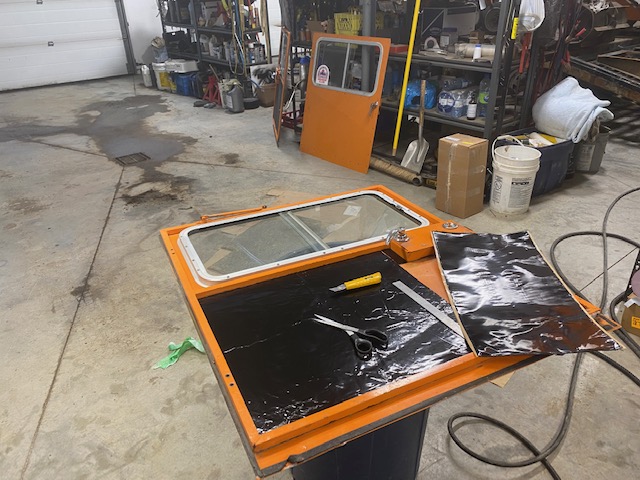

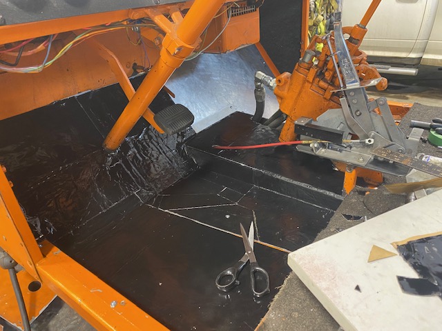

Installed some sound deadening HushMat today. That stuff is very sticky and have to plan ahead, when you peal the backing off it is going to stick to the first thing it touches!
View attachment 160355View attachment 160356
I think you'll be amazed at the difference that stuff makes. We use a different product, but same concept. We pretty much lined the entire cab with the stuff: floors, doors, kick panels, back panel, roof and firewall. Worth the time and money spent.
Incidentally, it looks like your door hinges are the model that use small plastic flanged bushings. Those tend to wear out over time. Are yours in good shape?
These hinges have the pins welded, so it doesn't look like there was any bushing of any sort.
The hinge pins don't seem to be too bad, other than needing oiling,

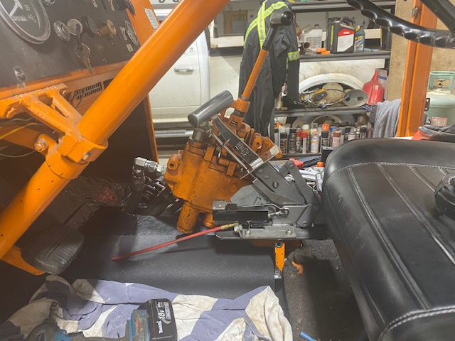

- I need the swing on the throttle linkage to the shift down line pressure to match the length on the 727, so made up some spacer blocks to raise the carburetor to get that swing clearance.
- But ... the switch on the drill pressure quit working. I finally located probably the last replacement swith in Prince George - the USA based company will not supply parts to their dealers any more. Interesting?

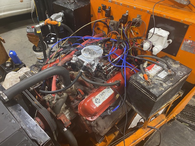

- Finally got to the point where I can try a start on the engine. I had replaced the points distributor for an electronic unit, replaced the mechanical regulator with a 1990 solid state unit, wired in a relay for clean power for the new fangled distributor, wired in a lock out so the Tucker will only start when the transmission is in neutral or park, changed the coil for a non resistor type, and hit the start key.
How's the moderator on the site as far as swearing?
After removing one too many grounds to the negative side of the coil the 318 started to fire. Bought some new plugs, but without the choke hooked up it would not stay running.
I was working on putting in a new cable (longer) when the phone rang and a buddy offered me his Holley Sniper 550-849K for throttle body EFI. His own project won't be ready for the EFI for a month or two, so I just have to order another EFI kit for him.
Might as well dive right in!
Bought a pocket full of brass fittings. Carburetor is off, fuel pump is off, plumbed into vent line for return fuel, bolted in filters and high pressure pump, working on adapter plate.
I'll make a temporary O2 plug in one of the stubby exhausts until I can get the Tucker down to the pipe shop.
Tomorrow is wiring - grrrrrr!!
It runs with the Sniper kit but with open exhaust the O2 leaves the engine full rich. The NO’s make your eyes water.

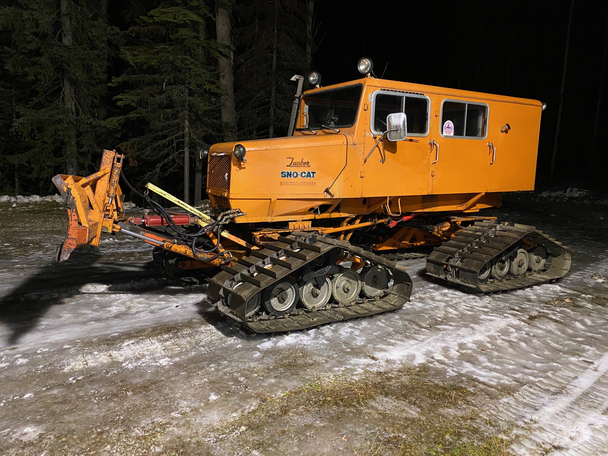

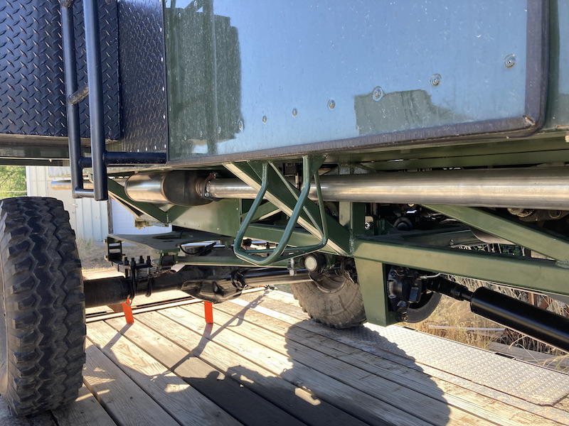

The Tucker is at the exhaust install shop. And again it is one of those precious and disappearing "old guys" that stepped up to the plate to do the fabrication.
He built his own shop after retiring several years ago, and I'm happy to find him.
We are going to make a single exhaust the tail pipe go up the passenger side so I don't have to stand in the fumes when at the back end. Looking forward to see what he come up with.

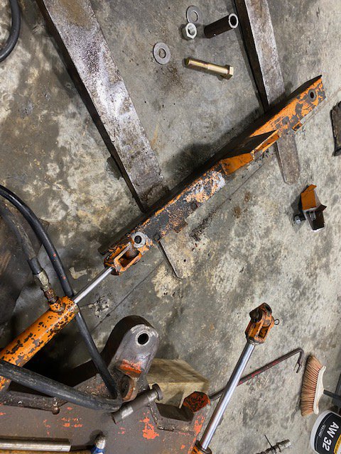

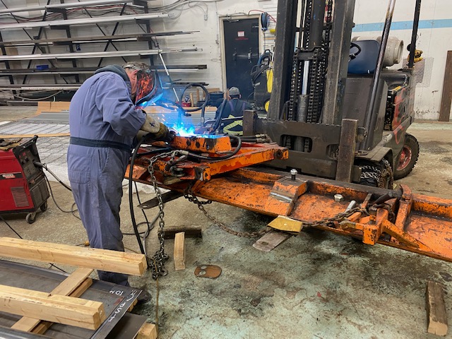

The blade system was in such dreadful condition I had to do something to get through the winter.
Replaced the main horizontal pin with a proper bushing and new pin. Replaced the vertical axis pin, which means I had to cut the back of the blade open. And welded up some cracks that developed as a result of the excess play. With too much play in the pins the blade is subjected to forces like a drop hammer and makes needless damage to the rest of the blade parts.

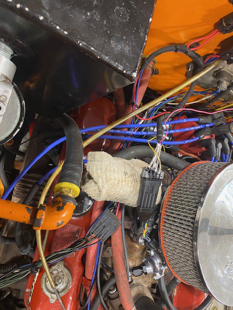

First time working with EFI install.
I bought the Holley Sniper 2bbl kit that comes with fuel pump, hoses, fittings, wiring, filters etc. for complete install.
I removed the engine driven fuel pump and bolted on a blank. I used the original fuel line as the return line and pumped it into the top of the tank.
I bought a better pre-filter with a glass bottom as I will no doubt get water in the fuel tank eventually.
It is a pretty good kit and the install went well.
Then the EDUCATION started.
The darn engine just would not run properly. After much head scratching and phone calls and a few beers with a great mechanic, we decided the O2 sensor was bad. When I unplugged the O2 sensor the screen would detect that the O2 was unplugged, so the EFI knew there was an O2 sensor there.
I was able to borrow an O2 sensor from an identical kit, and installed this with great expectations.
Well that fix cured exactly nothing.
The red on the screen was saying 35.6 which is full lean, so the EFI was dumping the fuel into the engine and the smoke coming put the exhaust was so black it looked like a wild diesel engine exhaust.
Since I had access to this other kit (and another day goes by) I swapped out the EFI body. It is a simple bolt down, swap fuel lines, and plug in the wires swap over.
And lo and behold the the EFI now reads the O2 sensor!
This education is not over yet folks.
The engine continues to act erratic, hunting and quitting.
Over a few more beers and war stories I hear about what electrical interference like EMF pulses can do to an EFI engine.
The Holley Sniper instructions said NOT to hook up the pink wire to the coil for constant power when the key is on, and when cranking for start. Thus I had faithfully hooked up the pink wire to the coil. It made sense at the time as this was an on and crank power terminal.
Upon re-reading this instruction again I pulled the pink wire off the coil and connected up the pink wire to the ignition switch terminal which was hot for start and run.
This all took lots of time.
And then the engine still ran like crap.
The Holley Sniper wiring harness is made to fit all sorts of engines and the various manufacturers setups. So on the 7 pin connector there is a twisted pair that is used to control the engine timing (advance) on some applications. Since my application doesn't use this connection it is left unplugged and was sitting above the coil. Ya, that twisted pair was picking up EMF from the coil and sends codes to the EFI, even though the wires are open ended. I noticed that when I lifted that twisted pair away from the coil the engine smoothed right out. So the instruction state that if in any particular application wires are not required, then you might pull then entirely out of the connector, which I then did.
Perfect right? Ya, not so fast.
While the engine was running, and much better, the O2 was reading, and the idle was getting better, the engine would still do weird bumps, the monitor would flash red - no data - and the engine would quit.
By now I'm pretty sure the EFI is still getting bad signal or inductance somehow, somewhere.

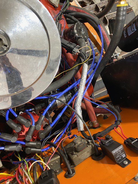

I tried wrapping the pink wire in aluminum foil as an EMF shield, but that made the engine stumble worse, until I pulled the pink wire out of the foil entirely, and then the engine ran better. So now what?
I tried moving the pink wire around to avoid the interference, but could not find a complete cure for the engine stumble.
To start I switch on the ignition key to the Run position and the fuel pump starts it's routine and the monitor screen comes to life. However, I noticed that when I then turned to the crank position on the ignition switch, that the monitor screen would go back to blank and start initialing over again. That meant the continuous power at the ignition switch was not all that continuous after all. The ignition switch looks original, so it might be al ittle worn. Therefor I needed a better power source for this fussy EFI.
When I installed the electronic distributor it also wanted clean uninterrupted power during crank and run. I installed a relay that was recommended to do just that. I checked the power out of that relay and it worked as advertised, there was power uninterrupted for run and start.
I spliced into that distributors power wire for power to the pink EFI wire. and then tried going from ignition on, and then to start, and watched the EFI monitor. That was the cure to that glitch, no more re- initializing when going for ignition on to start and the EFI was now getting clean power.
Every little step seems to be an improvement, but now I have to wait and run the engine through it's paces so that the EFI can learn what the engine likes and doesn't like.
I hope this EFI is worth the misery.
