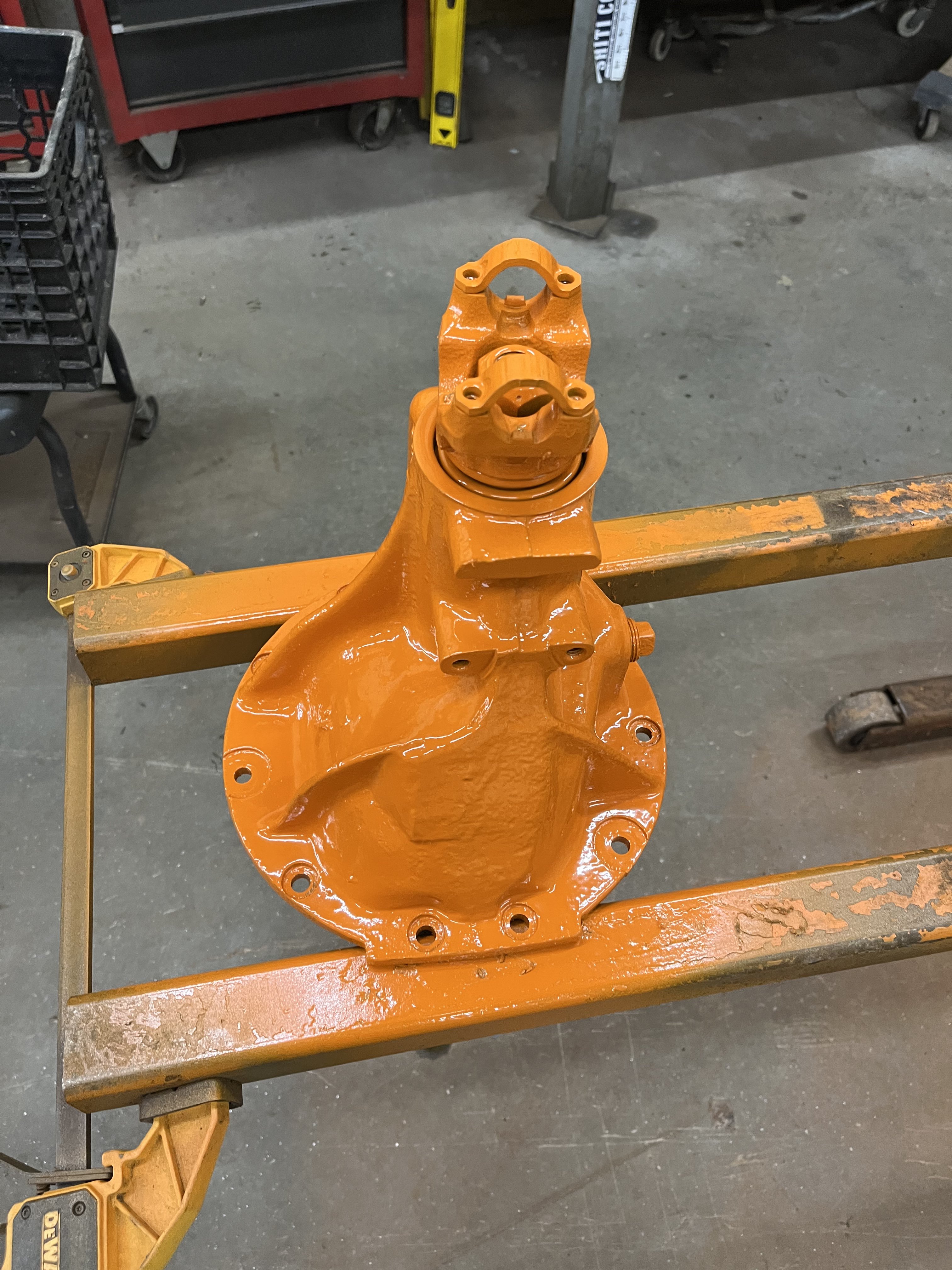

Differential is back and rebuilt like new. Mitchell Differential in Shrewsbury MA was a pleasure to work with.
Was all bearing and race wear that allowed the slop. New yoke bearing seals and adjustments. Knowing what I saw here rear is slated next year.
Some fresh paint and back in it goes.

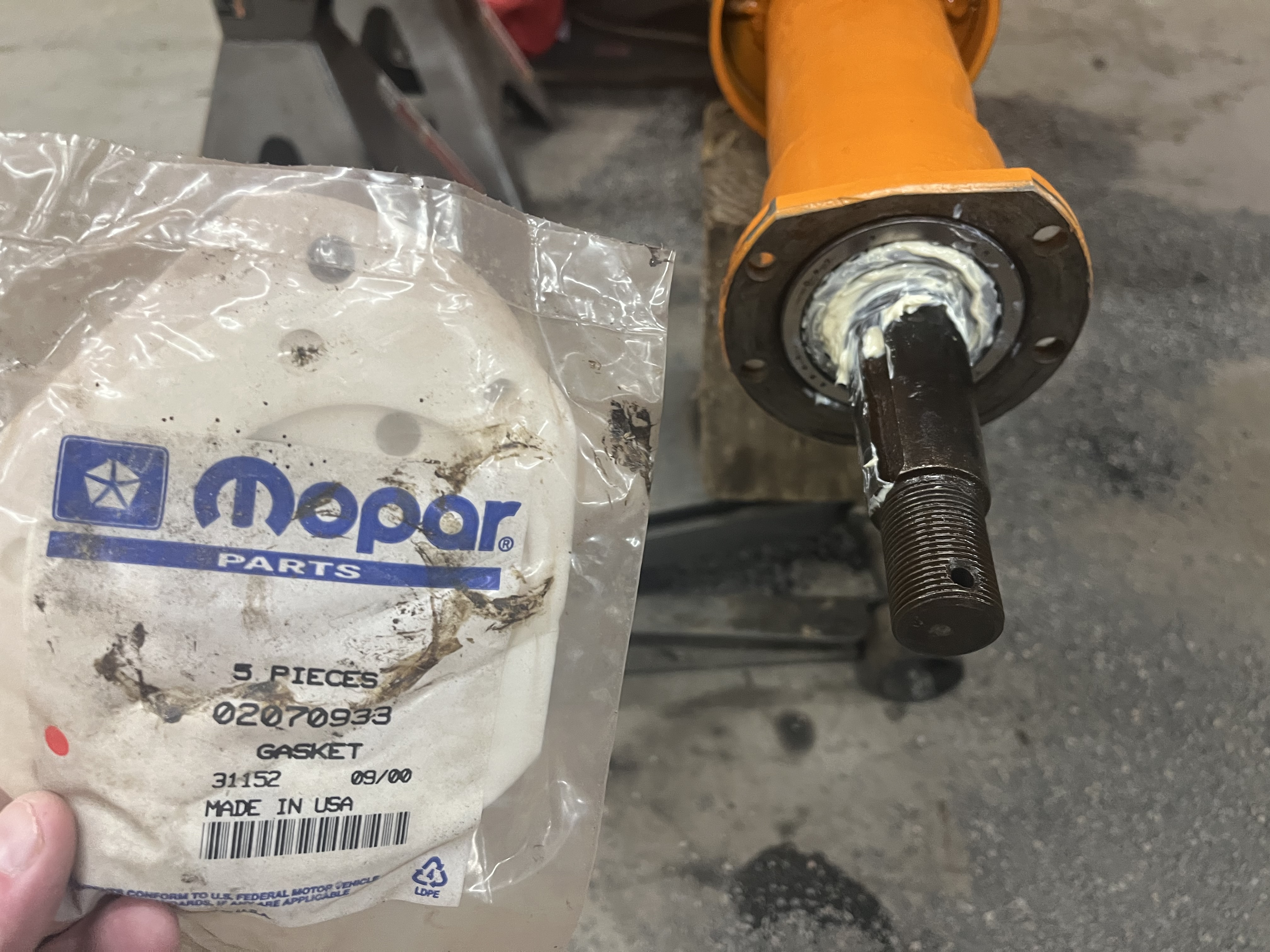

Need a new axle tube seal which is SKF 1900.
Testing out a theory which might be covered already. Different attack angles and side hilling allows the diff fluid to run past the axle seals.
The original design was for flat roads. Been inside a few of these and the bearings are always washed out with gear lube. Rears is probably less impacted but going up over sno drifts banks etc the oil leaks out.
So I lowered the level to about 3/4 incline. With such slow diff speed should be non issue. Will prob add some Lucas treatment to thicken sticky as well. Carriers need to come off again for paint so we shall see.

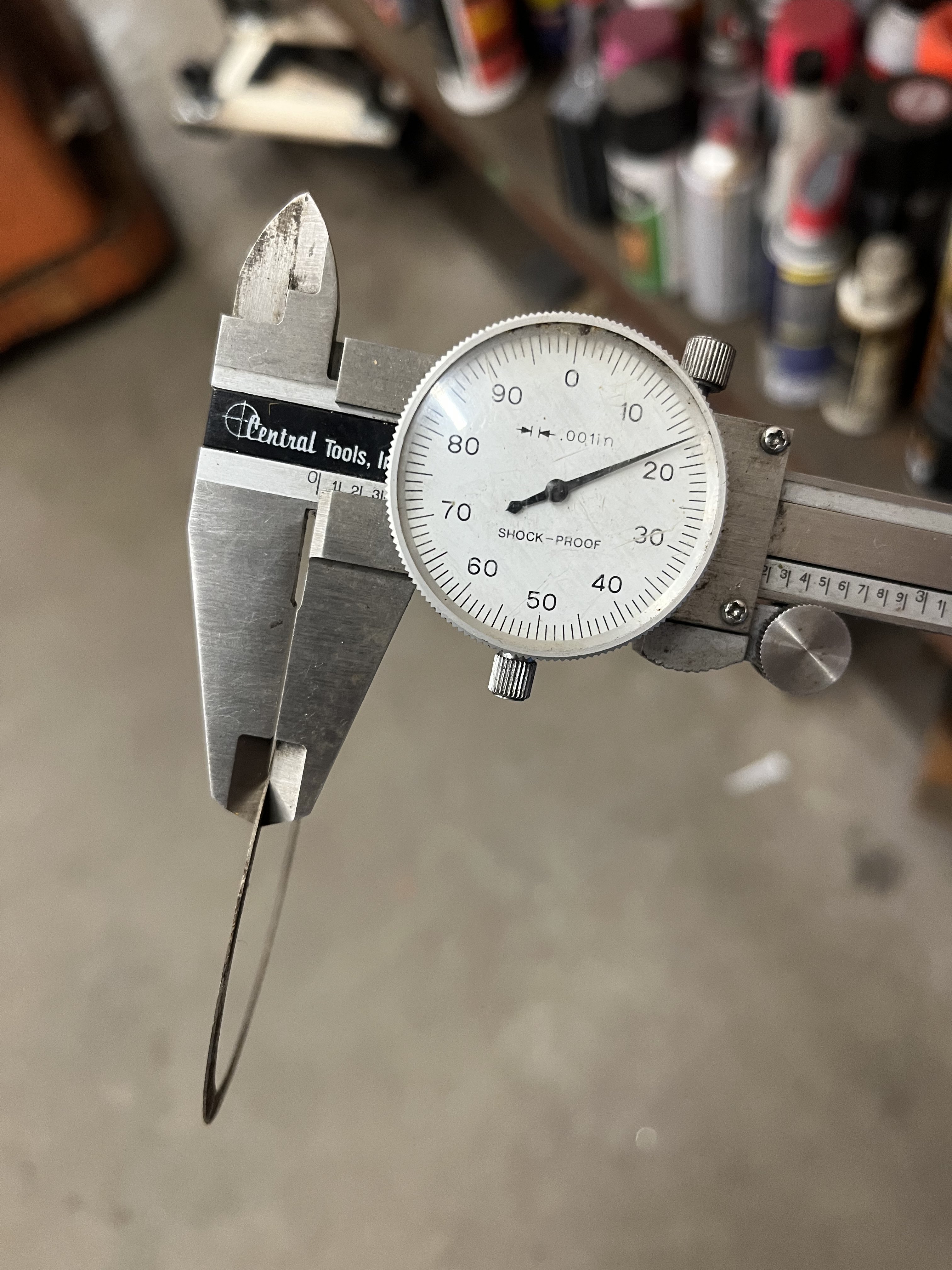

The early 8 3/4 used shims to extend the retainer outward with a foam sealing gasket. Removing shims reduced end play. Later they added an adjuster to one side to take up the slack. Tucker didn’t have this so started with tucker tolerance.
All the 8 3/4” cats I have had apart they are all recessed with lots of end play. My guess is it’s from years of slopping around.
My solution was to have these shims made up solve the problem.

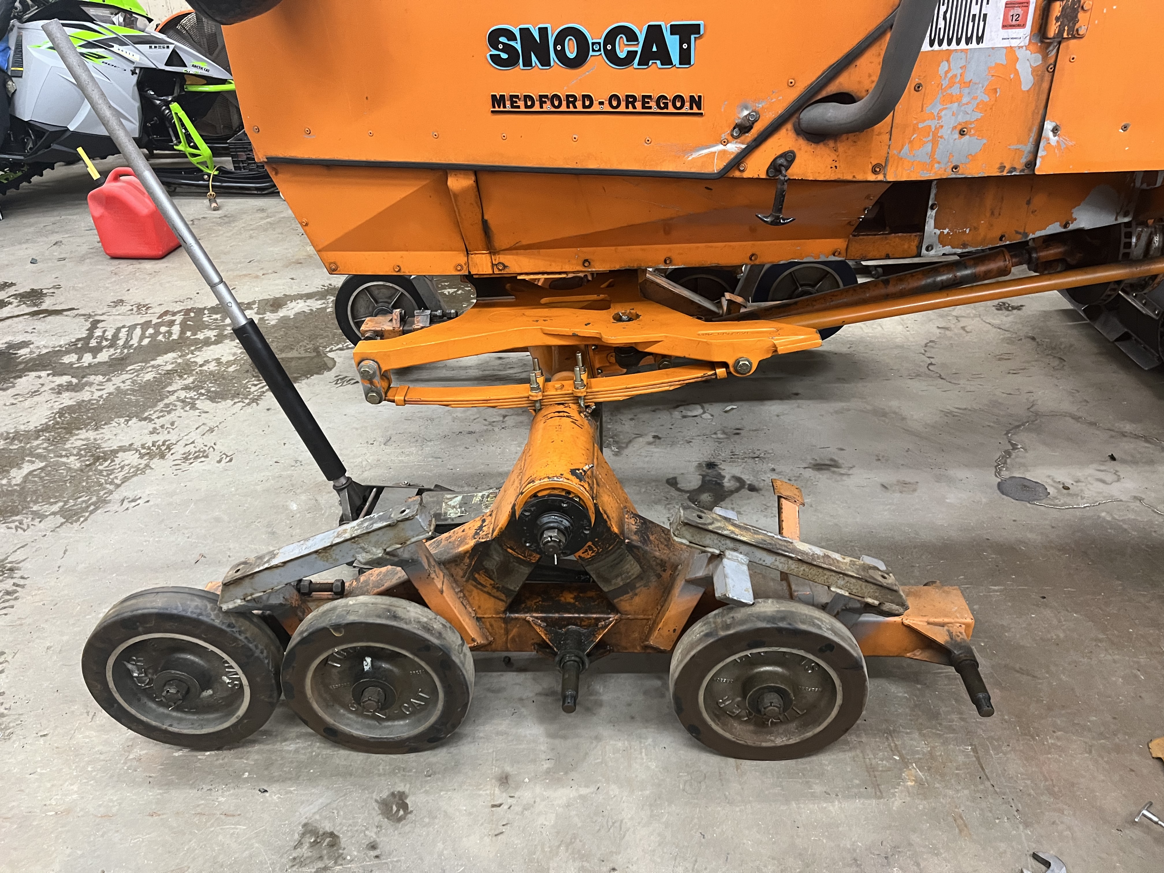

Axle play on the pontoon cats should move the sprocket and pontoon together. With the rubber track the carrier is fixed so the sprocket can move side to side hitting the carrier which you can see in the pictures.
These didn’t have foam seals. Diagrams don’t show but can’t hurt.
Set the axle end play. Needed two of these to get into what I think is spec.

Cleaned up the carriers for new tape and install. Here you can see the wear pattern well on the drivers side not as much on the passenger.
I also think the passenger side was replaced. That one has a snap ring retainer that is not on this model schematic and the other carriers don’t have the groove.
Also less wear in that side in comparison.
This cat came with a legend of the operator on MT Greylock running down the mountain missing a track. Maybe the carrier was damaged beyond repair?

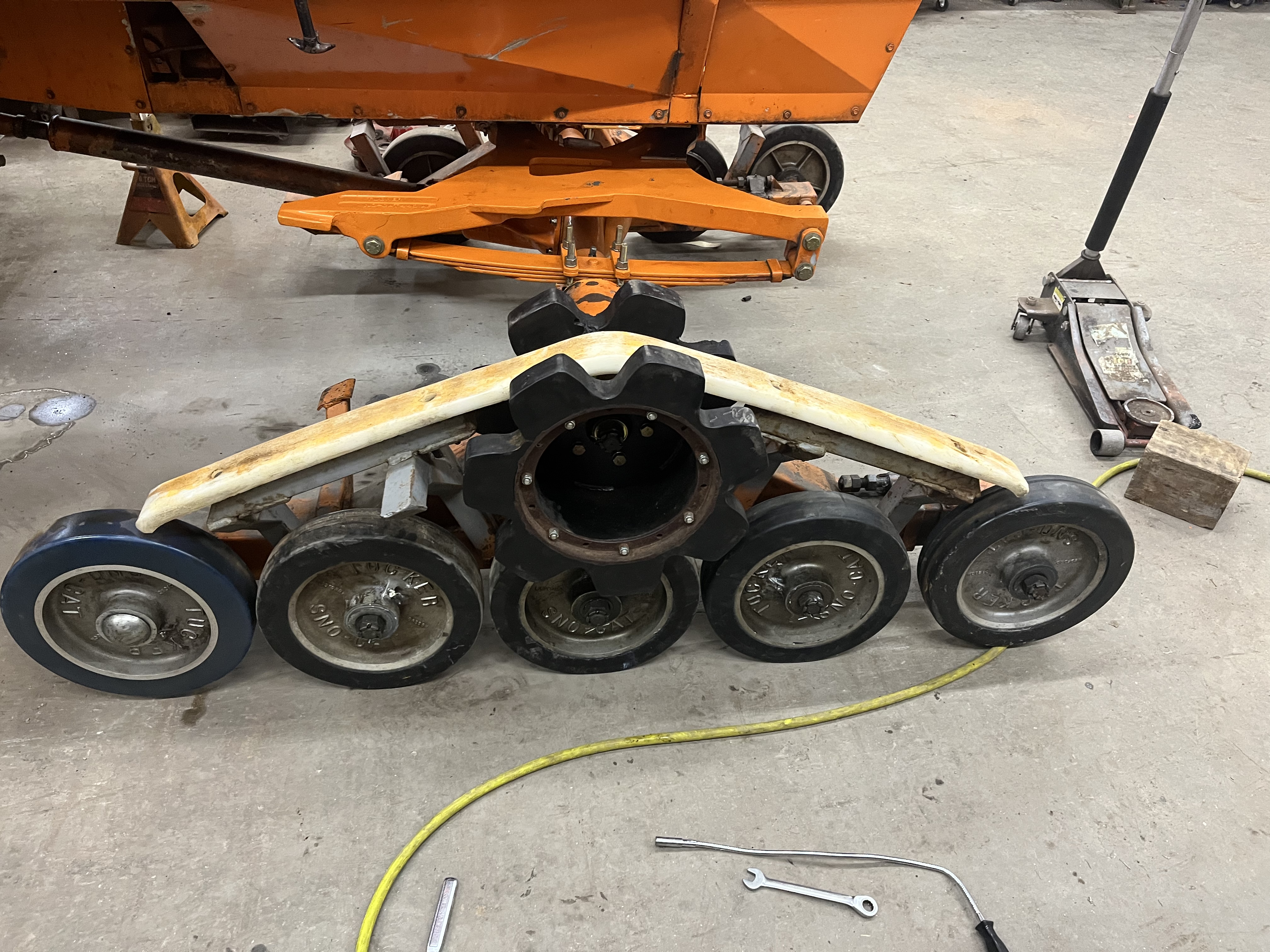

Carriers back on. Drivers side confirmed more worn. Used the same bearing tape measurements and had to trim and work the passenger side on.
Checked all the bolts front and back frame down.

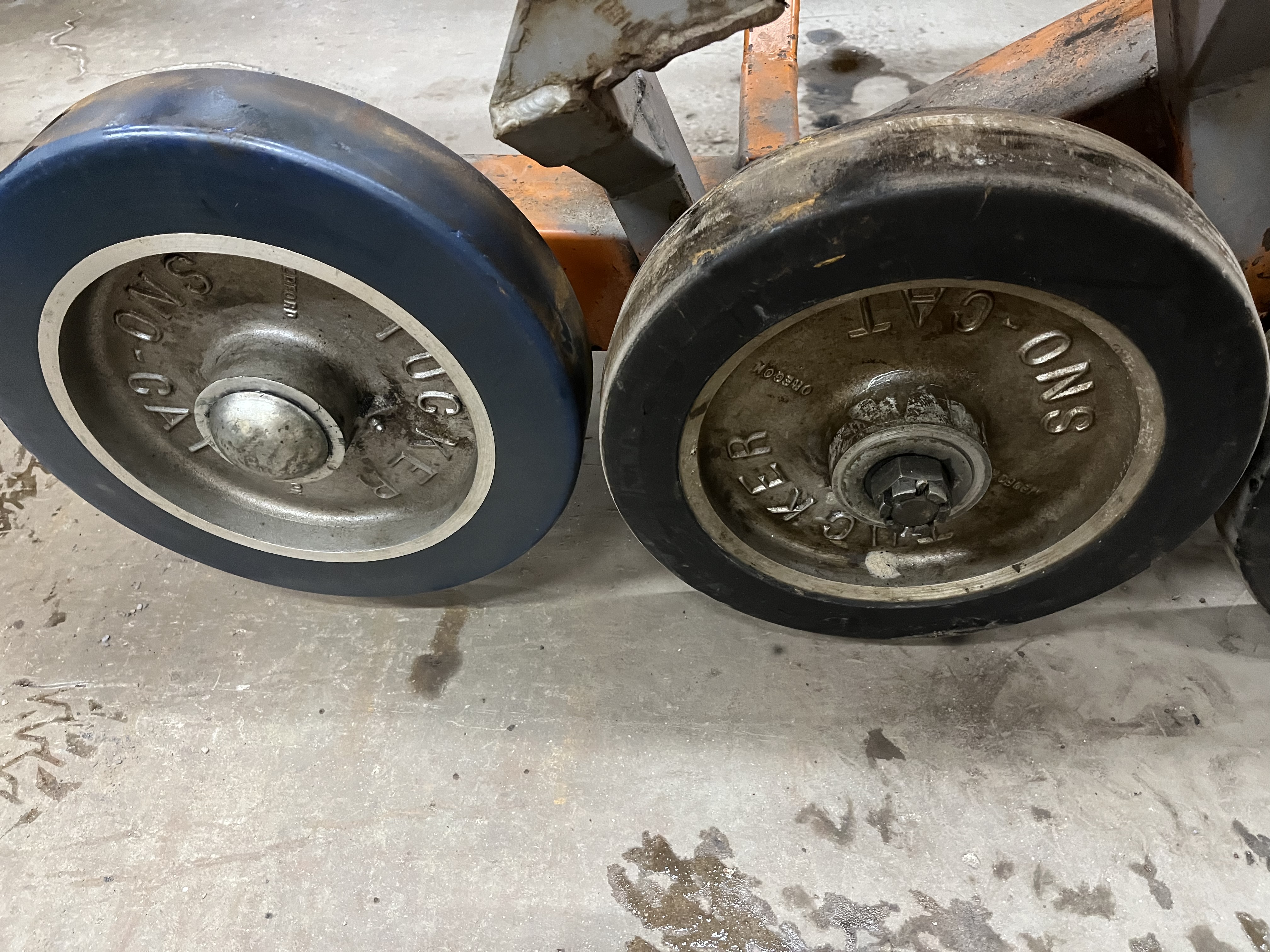

Hubs back on. This is an areas to get super tight and check regularly on all Tucker Sno Cats. They can loosen.

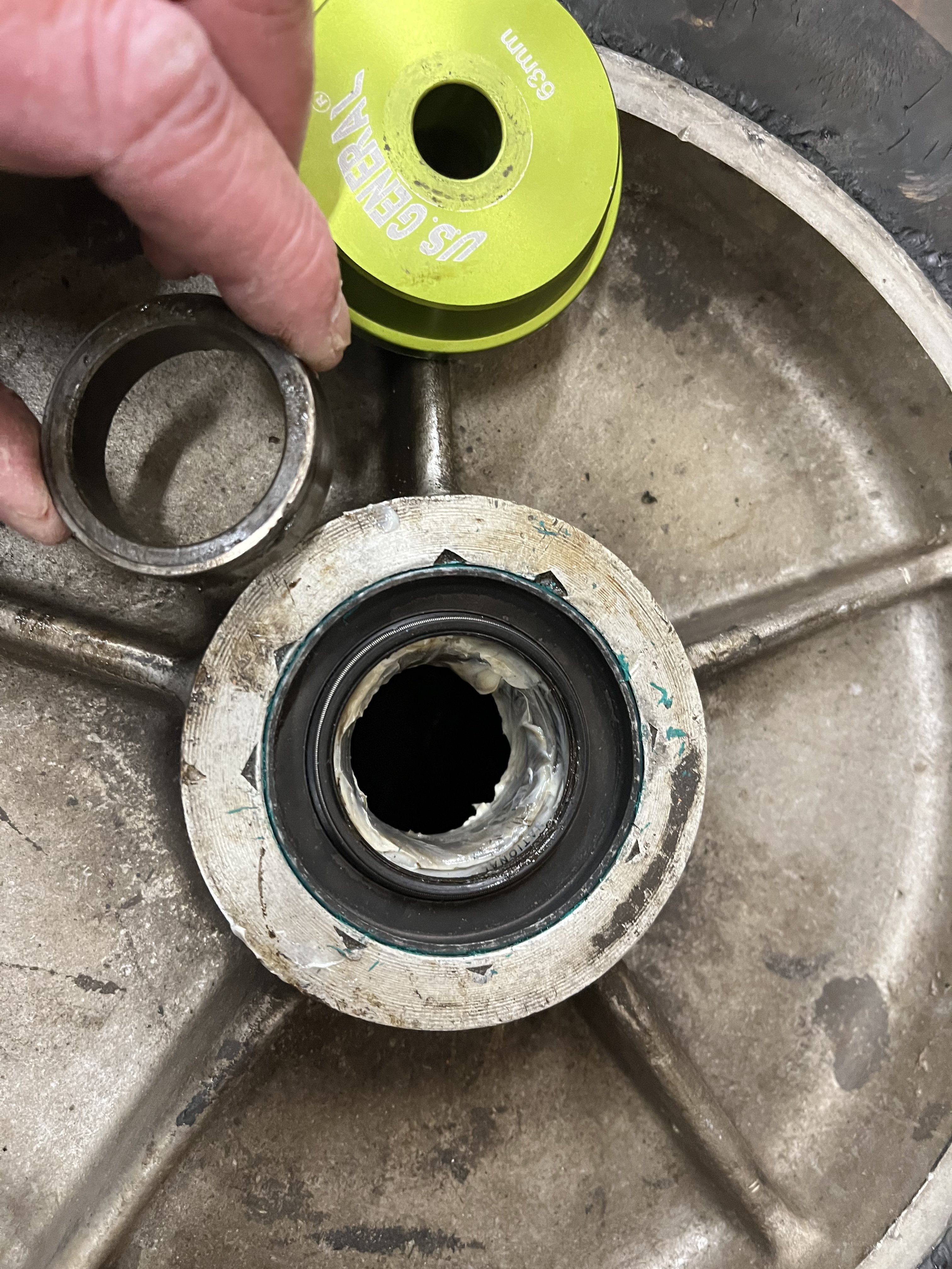

Three wheels have bad so will freshen those up. Greased the rest. This cat has mix of idler seals, washers, spacers.
Pricing out the update spacers with orings. May swap over if reasonable.

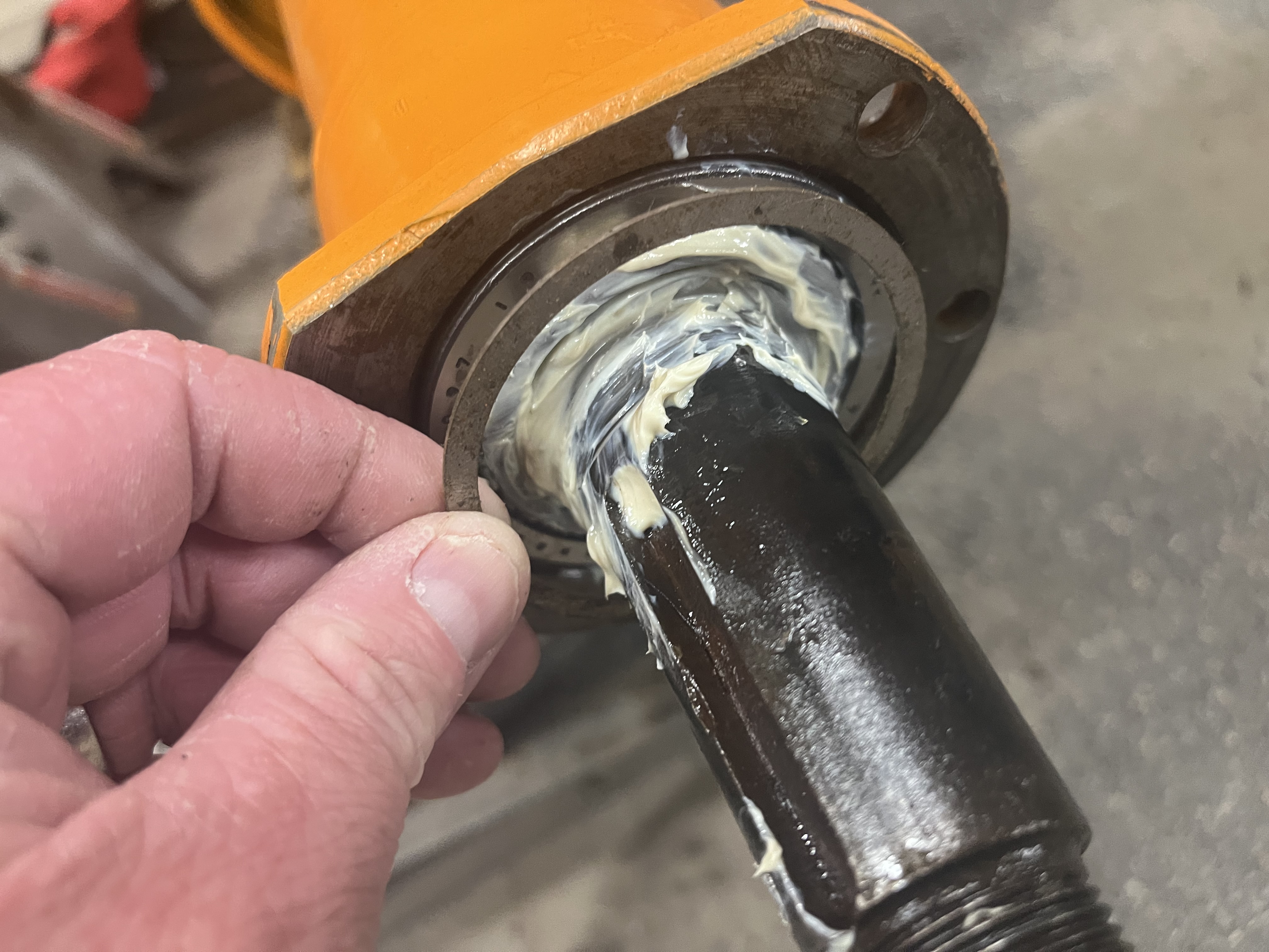

Trying to figure out this ice breaker setup. Idler shafts is shorter than all the others with a different nut that is recessed. Any input appreciated.

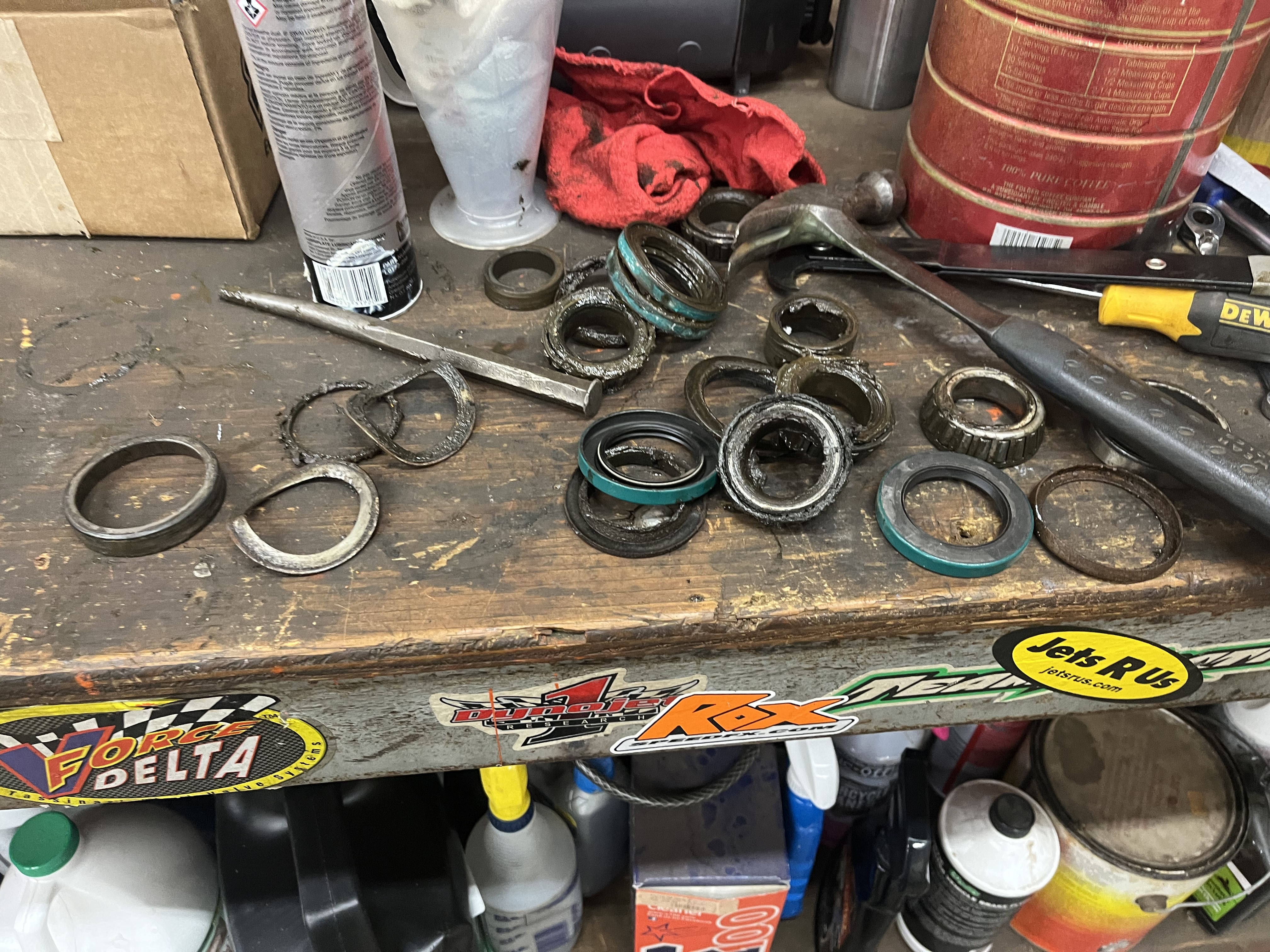

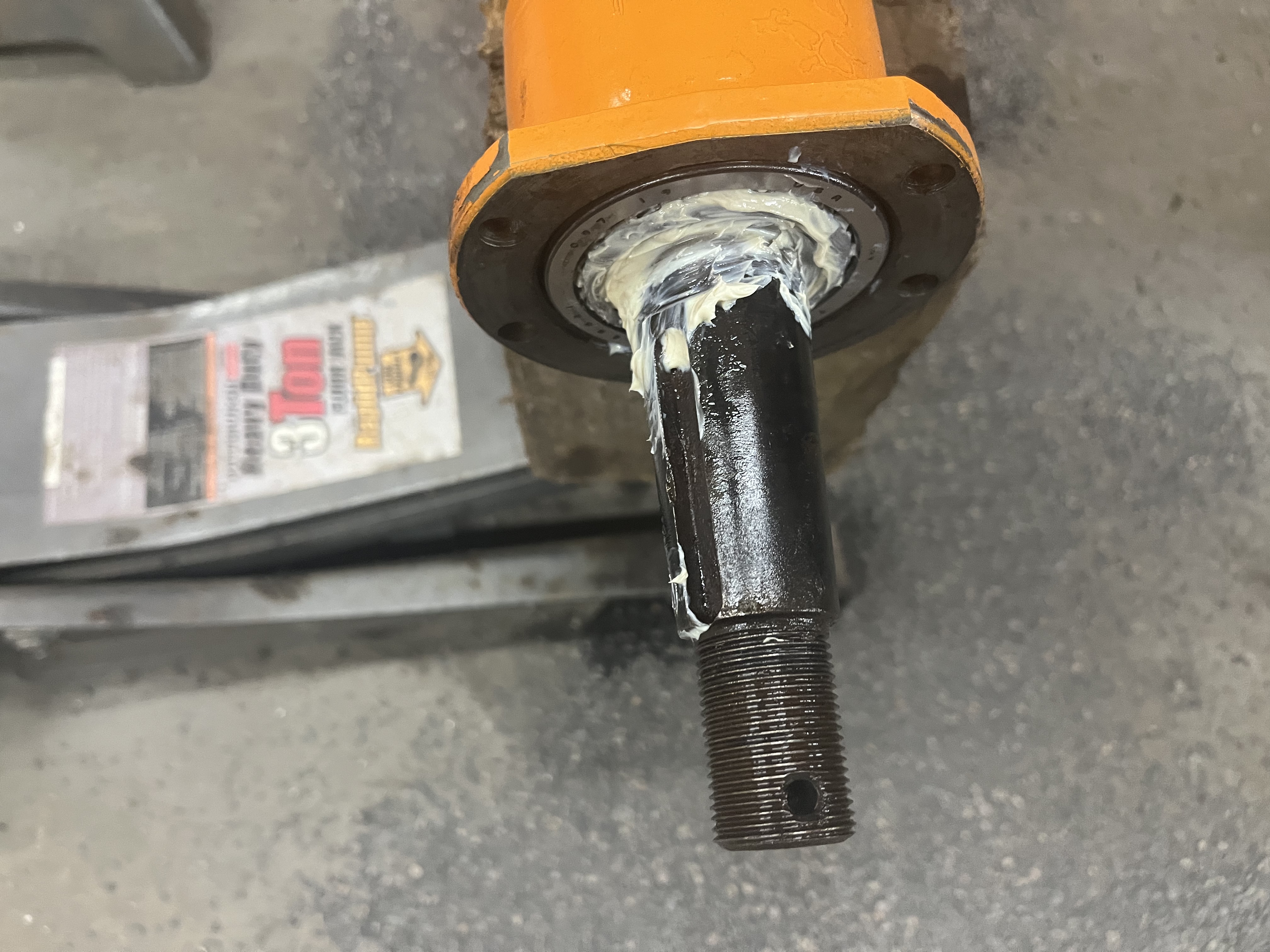

Spoke with dealer today. That icebreaker spindle is a newer style. If I understood correct it’s shorter, has oring machined on spindle in the back, uses a different nut and cap pictured here. More like a basic trailer bearing setup. Eliminates a seal, spacer, washer, and the need to machine orings in two spacers plus use less material.
Bearings are common A6 found anywhere. Seals little harder. Was also told Tucker installed the seals like any tapered bearing to hold the grease in. Thinking was Bill Cook started reversing them and the lip which let old grease moisture and dirt out and new grease in. The retaining washers followed later most like because the yankee ez lube hub forced seals out with cold grease most likely.
