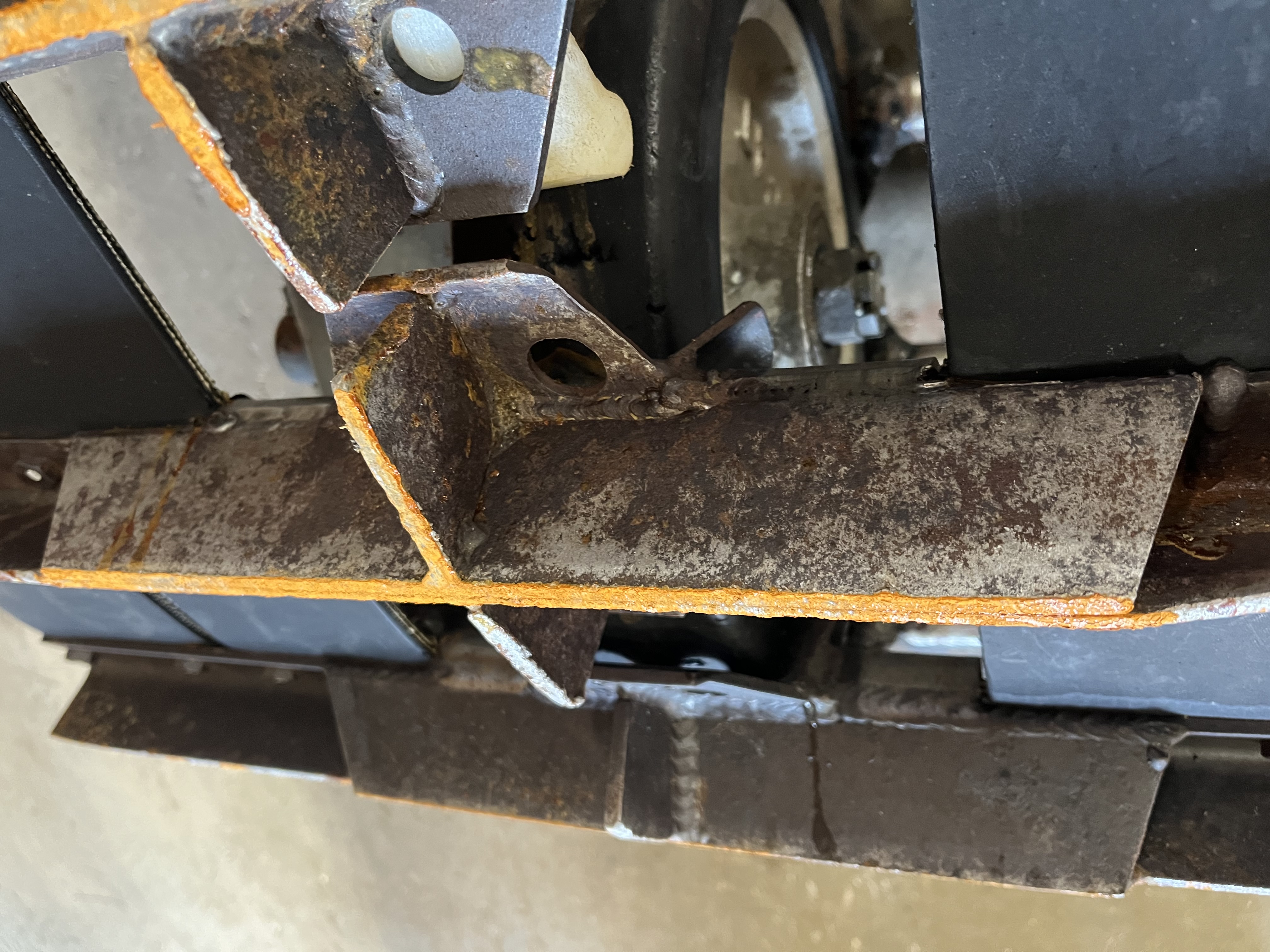

This grouser needs to be replaced. This a an aftermarket I believe. Looks exactly the same in all aspects but a thinner gauge and possibly softer. Haven’t found a other like it on the machine yet.
