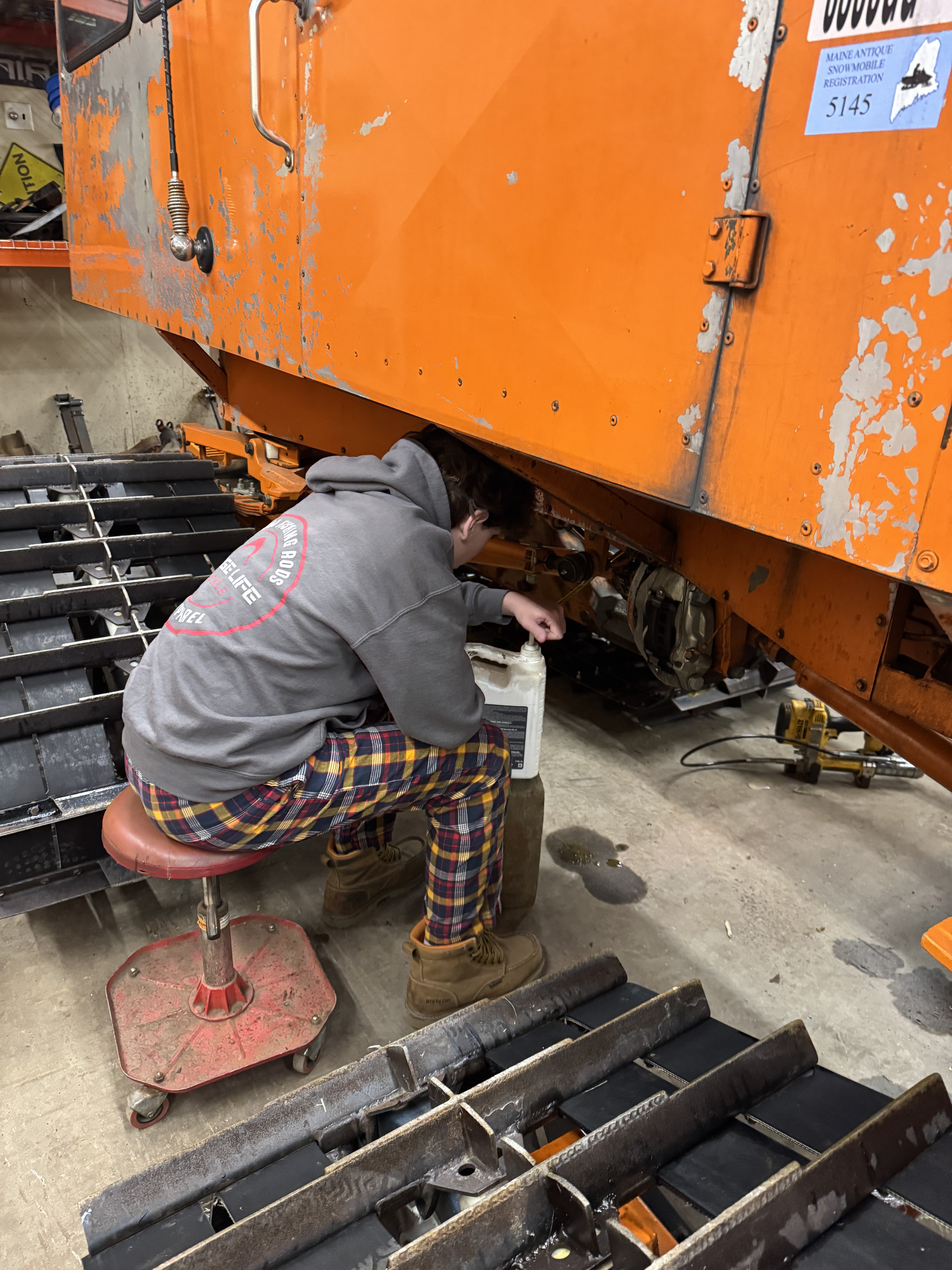

Had Jr in the shop today learning how to take care of stuff and drive the cat linking up the drive train grease fittings. Much quicker with child labor.
Transfer case fluid changed, idlers wheels greased and check for bearing tension, track tension checked and tensioners greased, carrier pivots greased, front and rear tables greased, clutch/brake pivot greased, fuel drained and run in fresh ethanol free/mystery oil/stabil mix, tie rods ends greased, pivot grease, cross joints greased, hydraulic piston pivots greased.

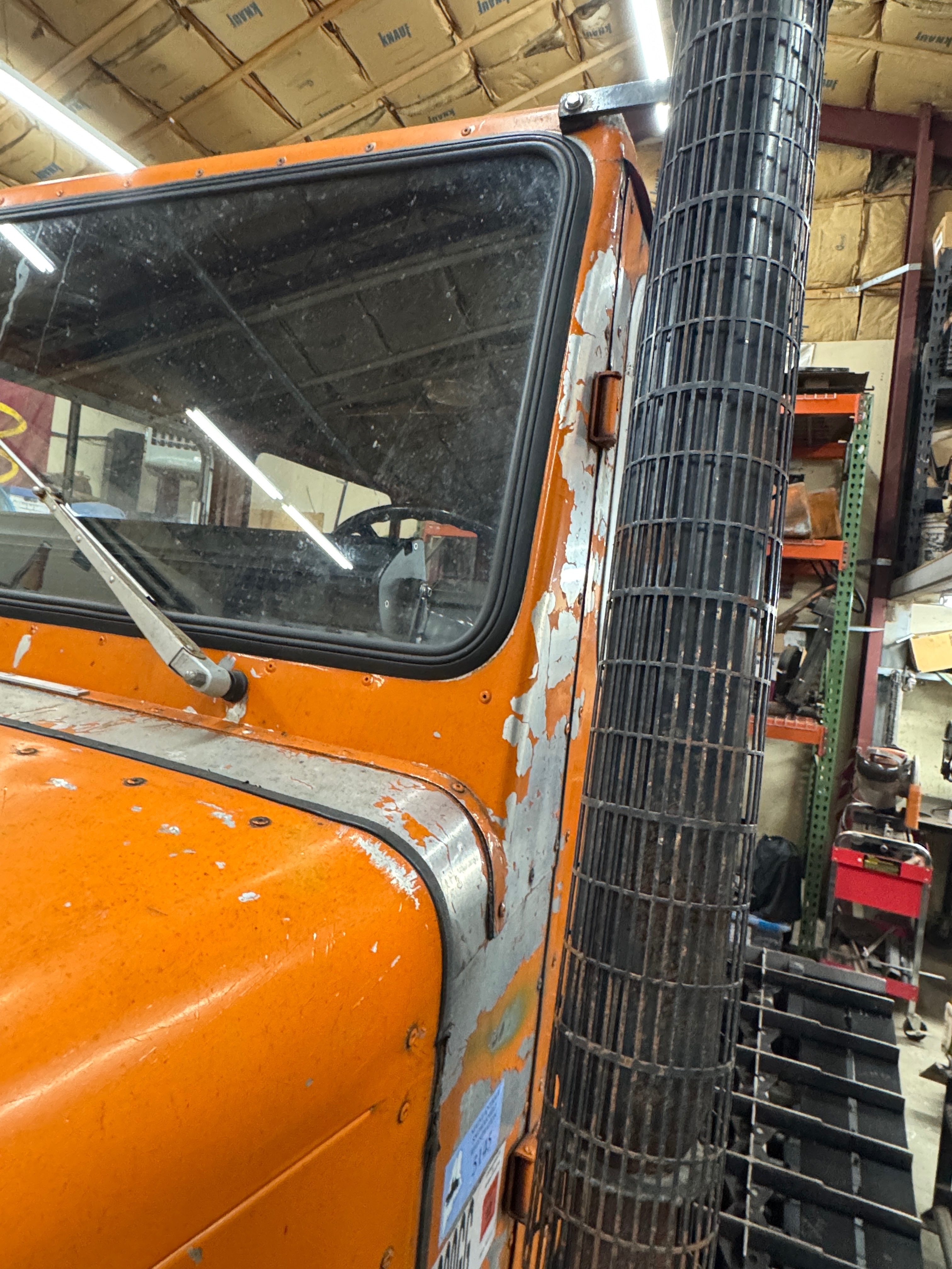

Bent the door back the wind grabbed.
