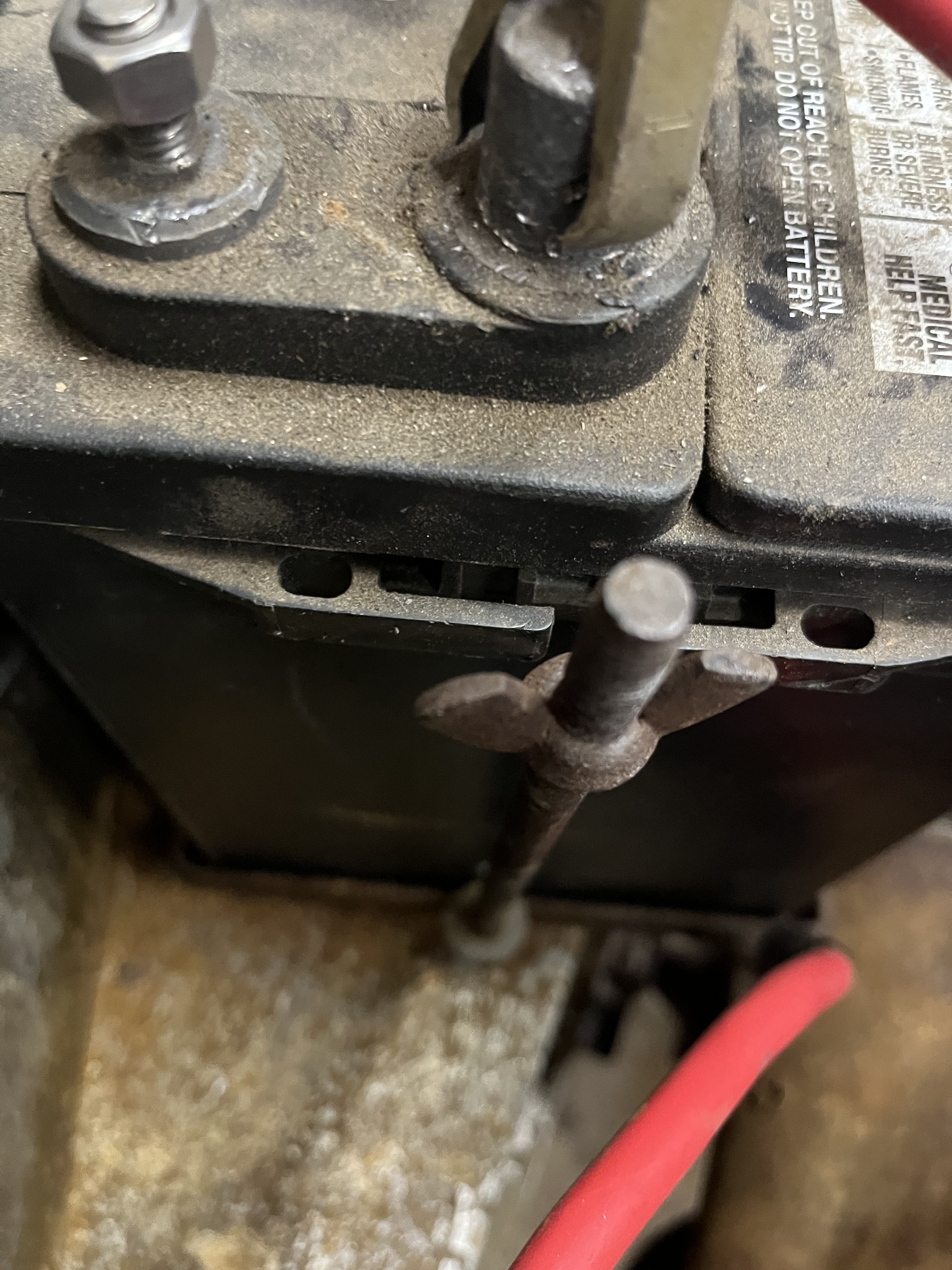

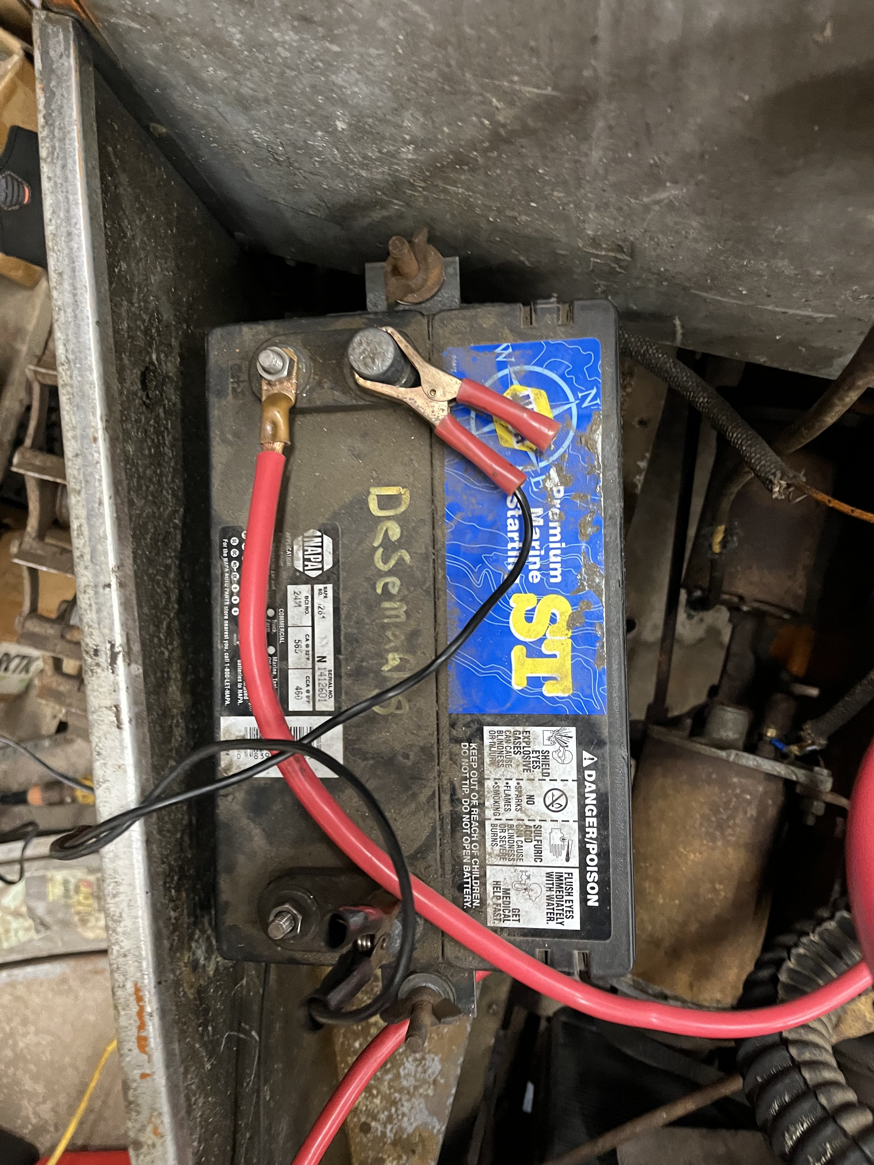

Looking for pics of what Tucker used for battery tie downs?
Think some had an angle iron frame that sat over the pattern but here I picture a washed welded to angler iron to fit the slot on the battery.

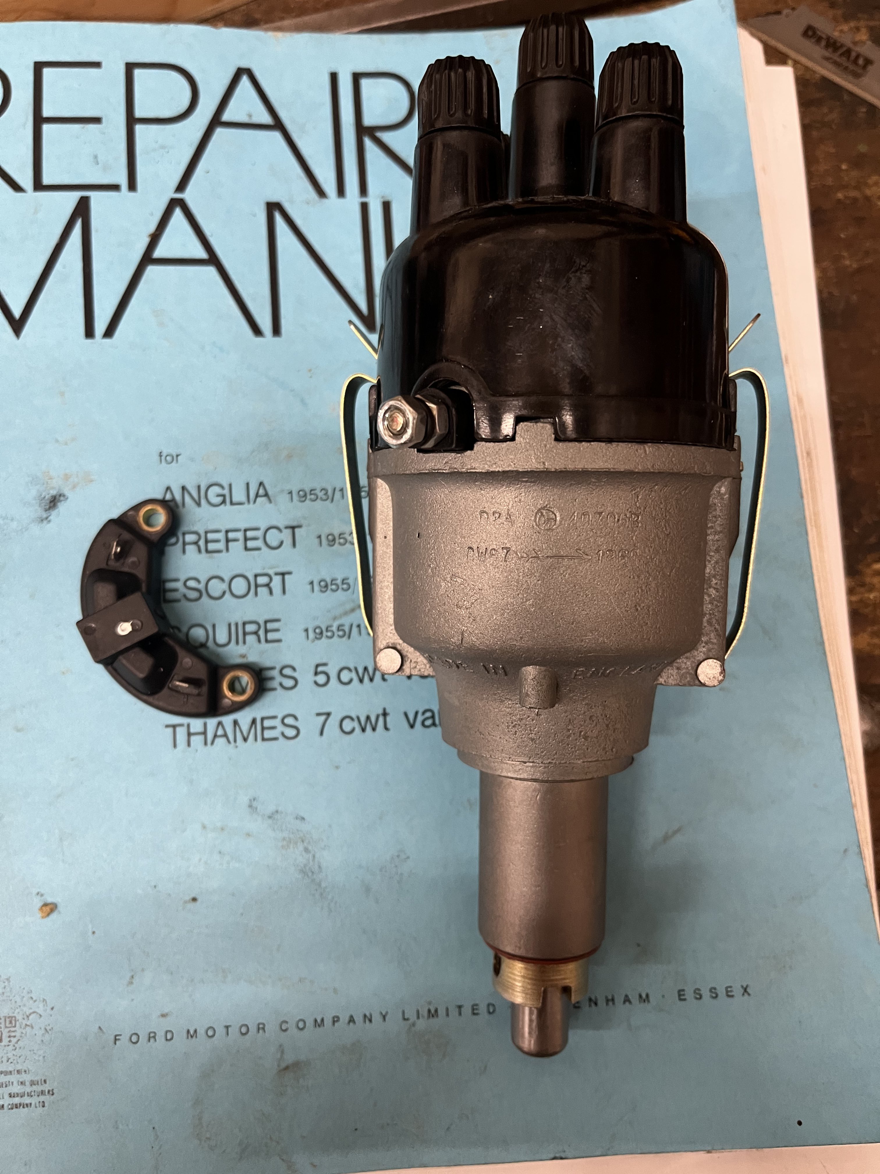

We plan on installing a Pertronix Ignitor II 9LU-146LS in the Undercover Kitten. Also required will be resistive spark plug wires adapted to the Lucas distributor cap using the screw on terminals. They say it “should” work. Will carry a new set of points and a condenser in a ZipLoc bag just in case.

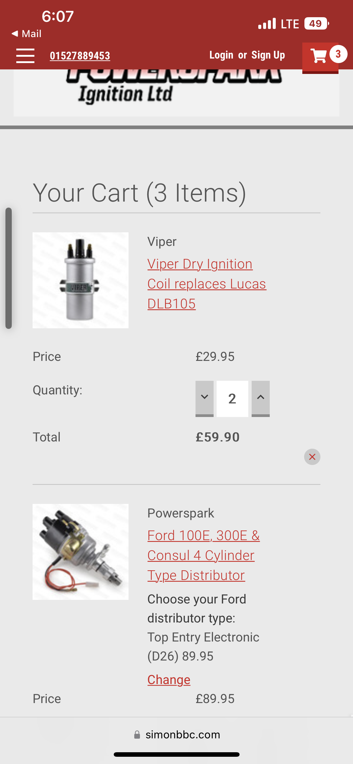

Powerspark send new module and new coil, wires.. Now have fat spark.

Also have a oem rebuilt distributor, coil and wires to go back timeless!

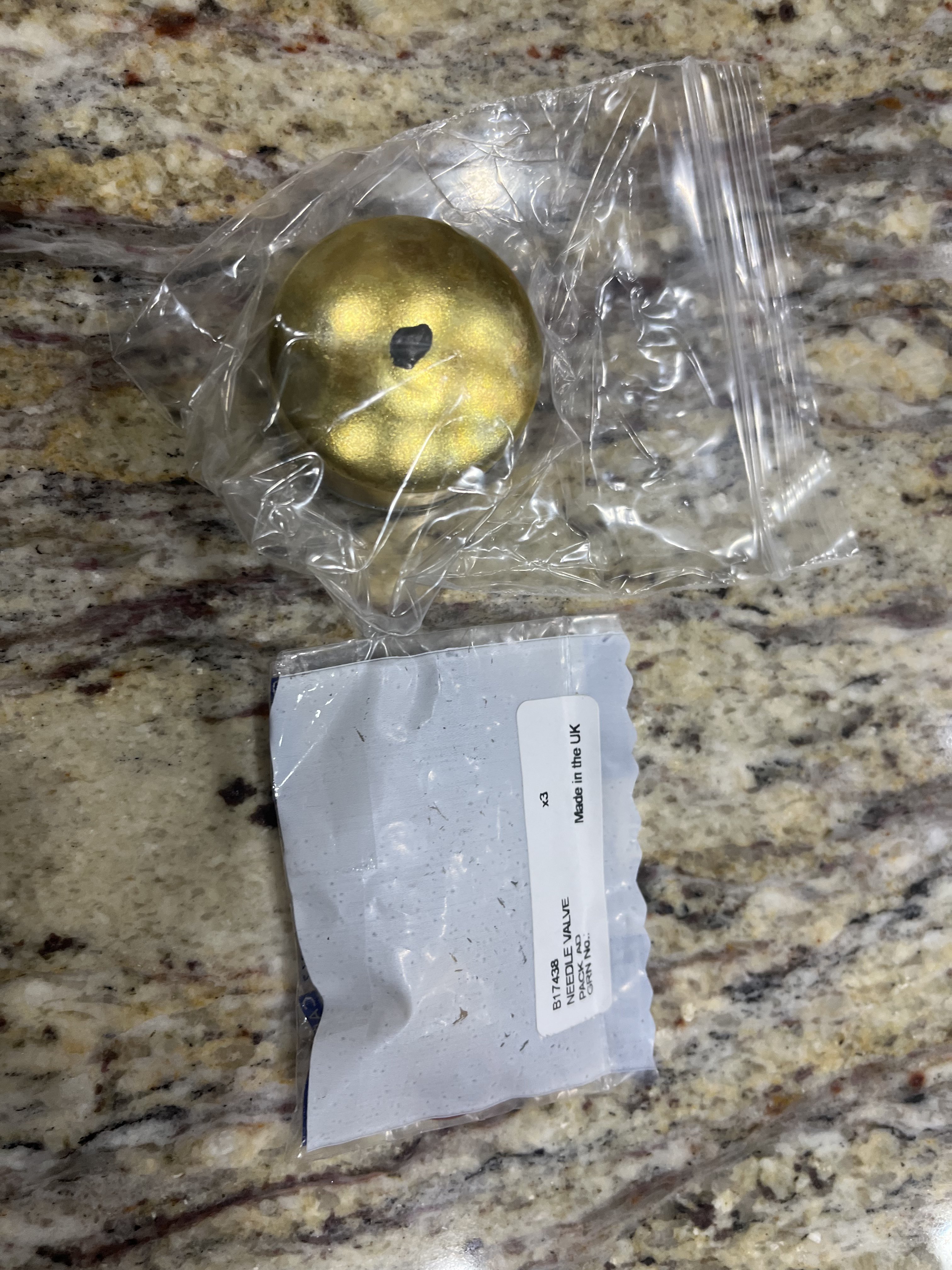

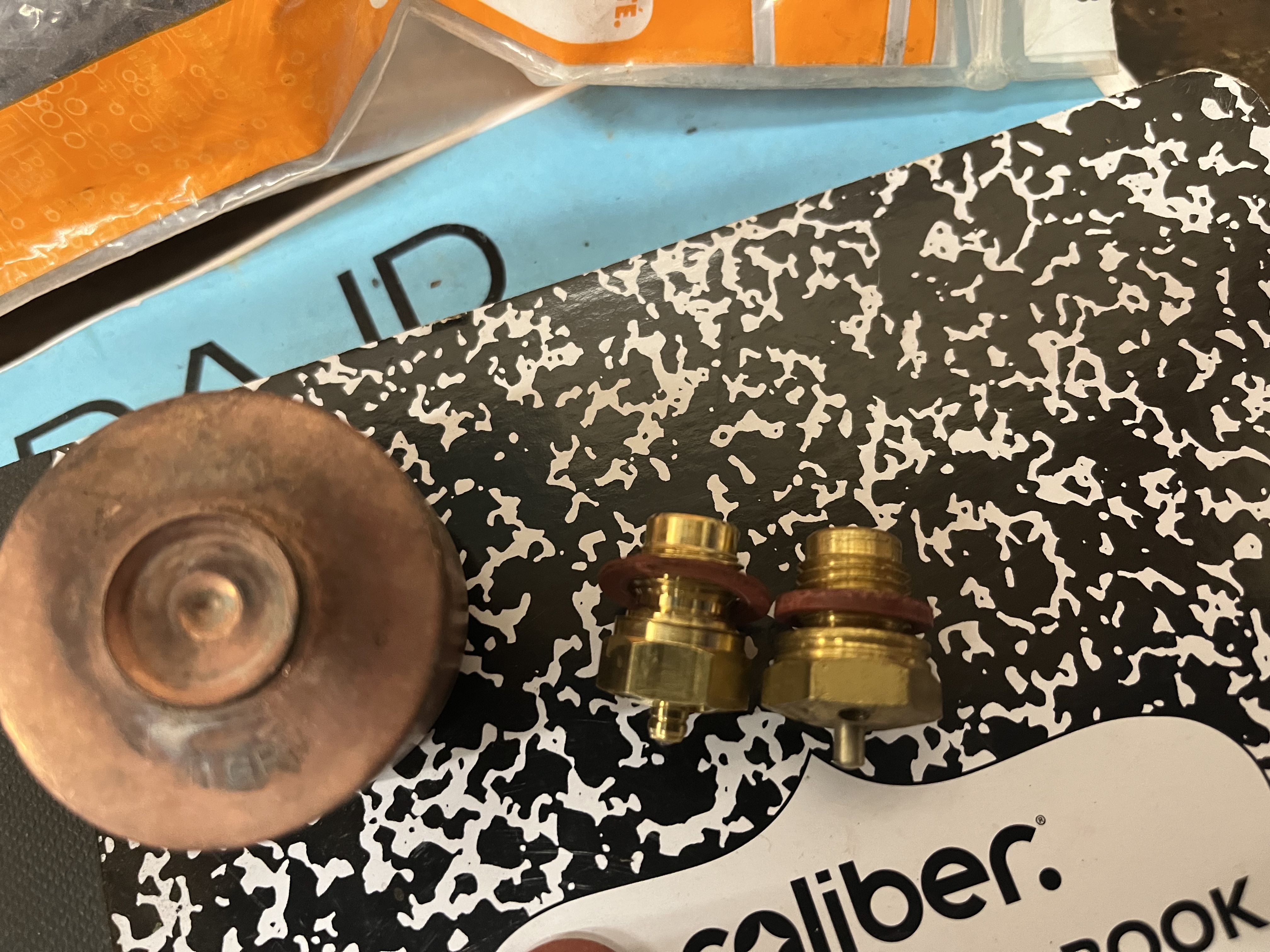

Back up and running. The inlet valve was aftermarket and tolerance was off.
Manual says to add fiber washers to adjust so ordered new solex valve with 2 shims.
Tried one shim for giggles still flooded added the second purring like a kitten.

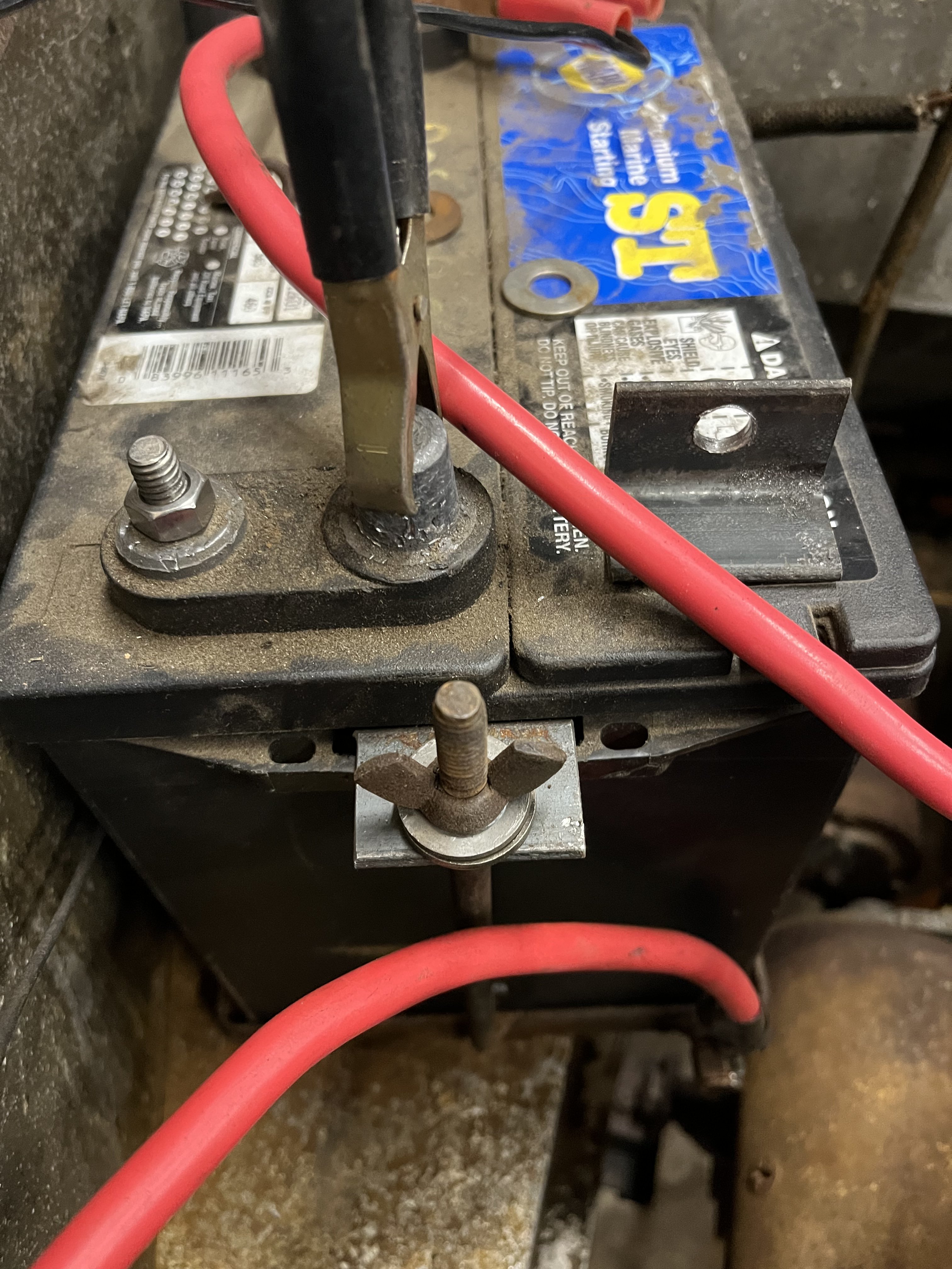

nice simple bracket, was your kitten 12 v in its new state.?
I have the same dilema, Im going bungee cord till i can make a proper angle iron frame. My 6 V battery doesn't have those sexy molded pockets

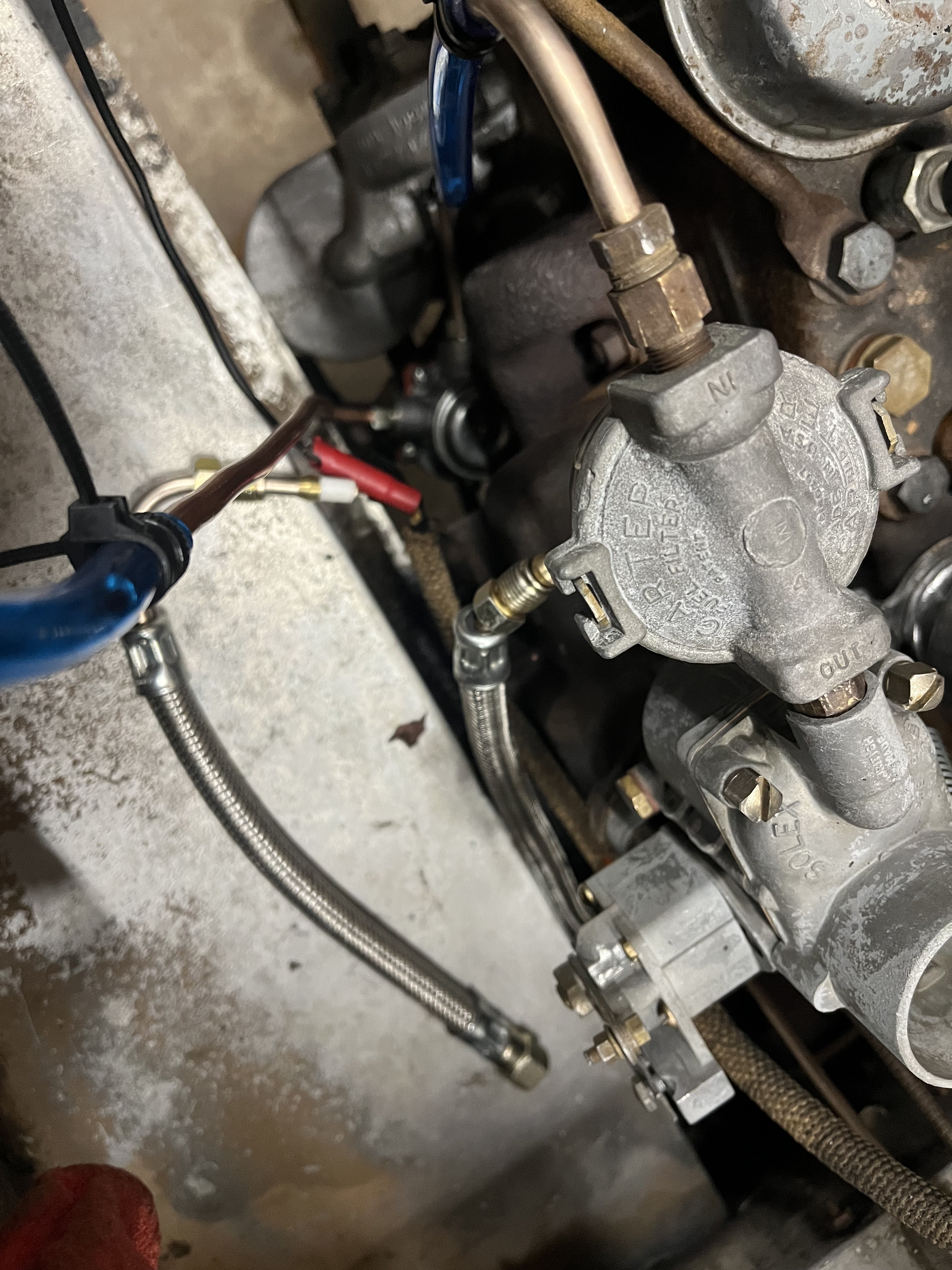

The replacement pump has a different orientation for the inlet outlet that can easily be adjusted but allows better line clearance by the frame.
The one that came off came real close to the frame. This replacement might allow more clearance so I sourced a flexible pipe off off a 105E model with a 90 I need to make a little more angle on.

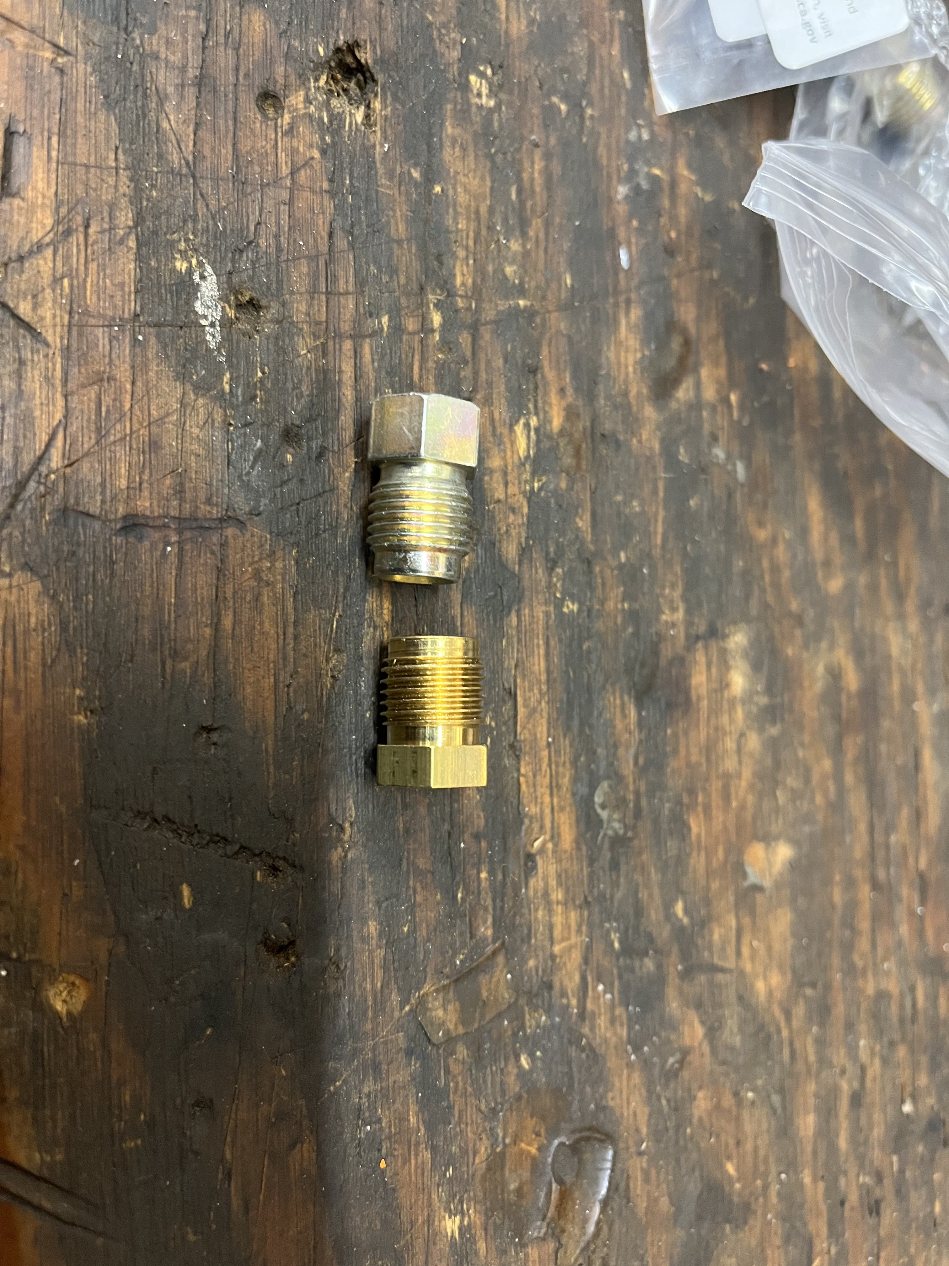

Fun fact is that Ford Anglia fuel pump ferrule fittings are 1/2” UNF England thread not 1/2-20 Ford thread found in New England. The 1/2-20 will work and is often interchanged but the threads don’t really like it.
Left is 1/2 UNF right is 1/2-20.
I appreciate your content so don't take this a me poking ribs. but I have that exact carb on a kitten as well and I can't believe you don't have a leak at the screen ( glass prefilter ) on your carb. I tried to install the screen there as well but my rigs whitworth thread receives a banjo bolt, the bolt has a screen inside. I can't find a nipple like you have in there.
I wonder if some of the delivery issue for you might be a deformed base for the needle seat?
The fuel issue was the after market inlet valve. Tolerance was off. New solex one fixed it. My research for anglia flooding on solex said common issue add a fiber washer.
The glass bowl has a ceramic filter and rubber gasket I replaced. There is also a magnet in there. Some where back in this thread are the part number.
Guessing it’s a male 3/8 npt to male 3/8 npt between the carb and filter. And 3/8 inverted flare to the other side.

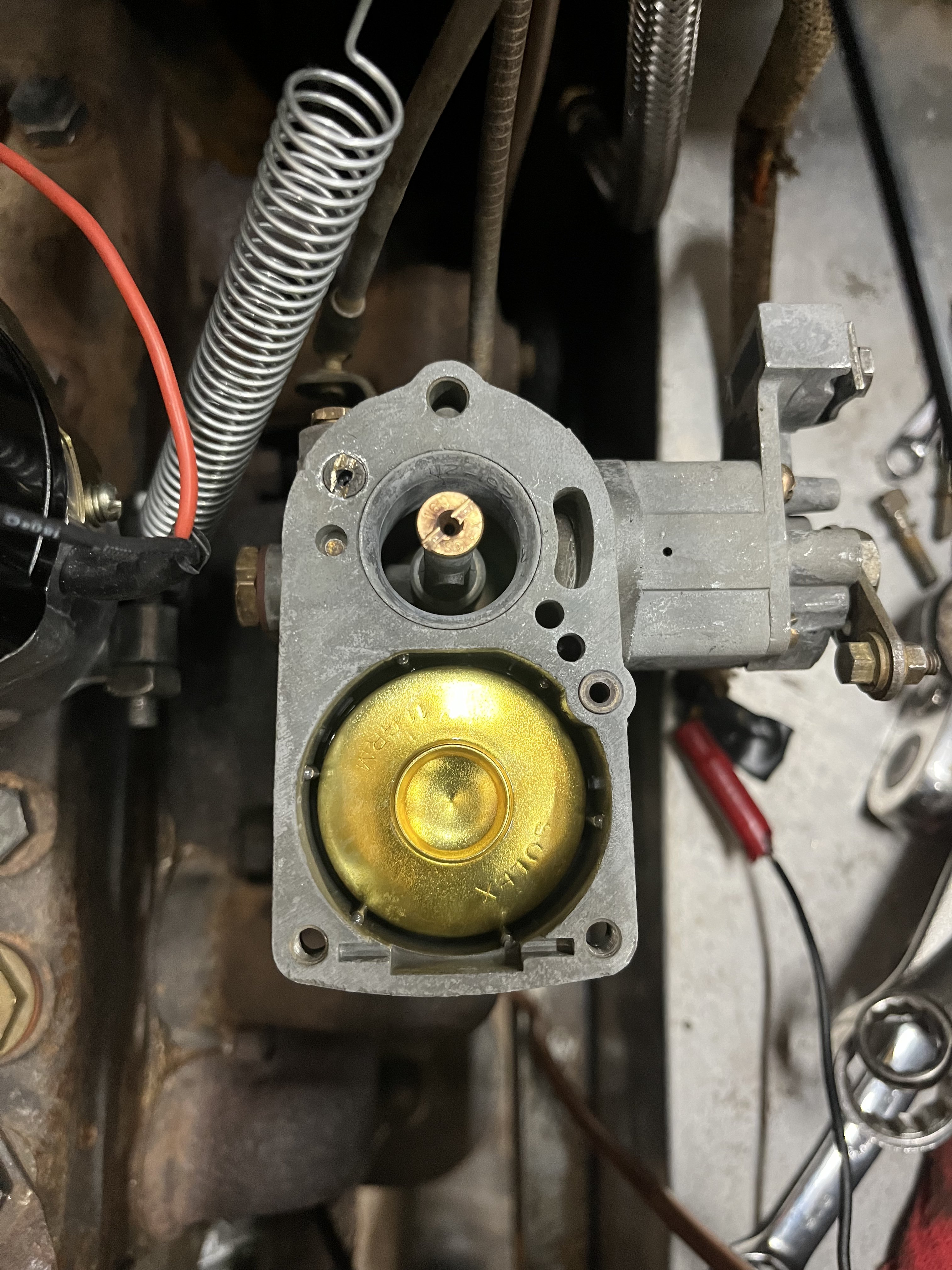

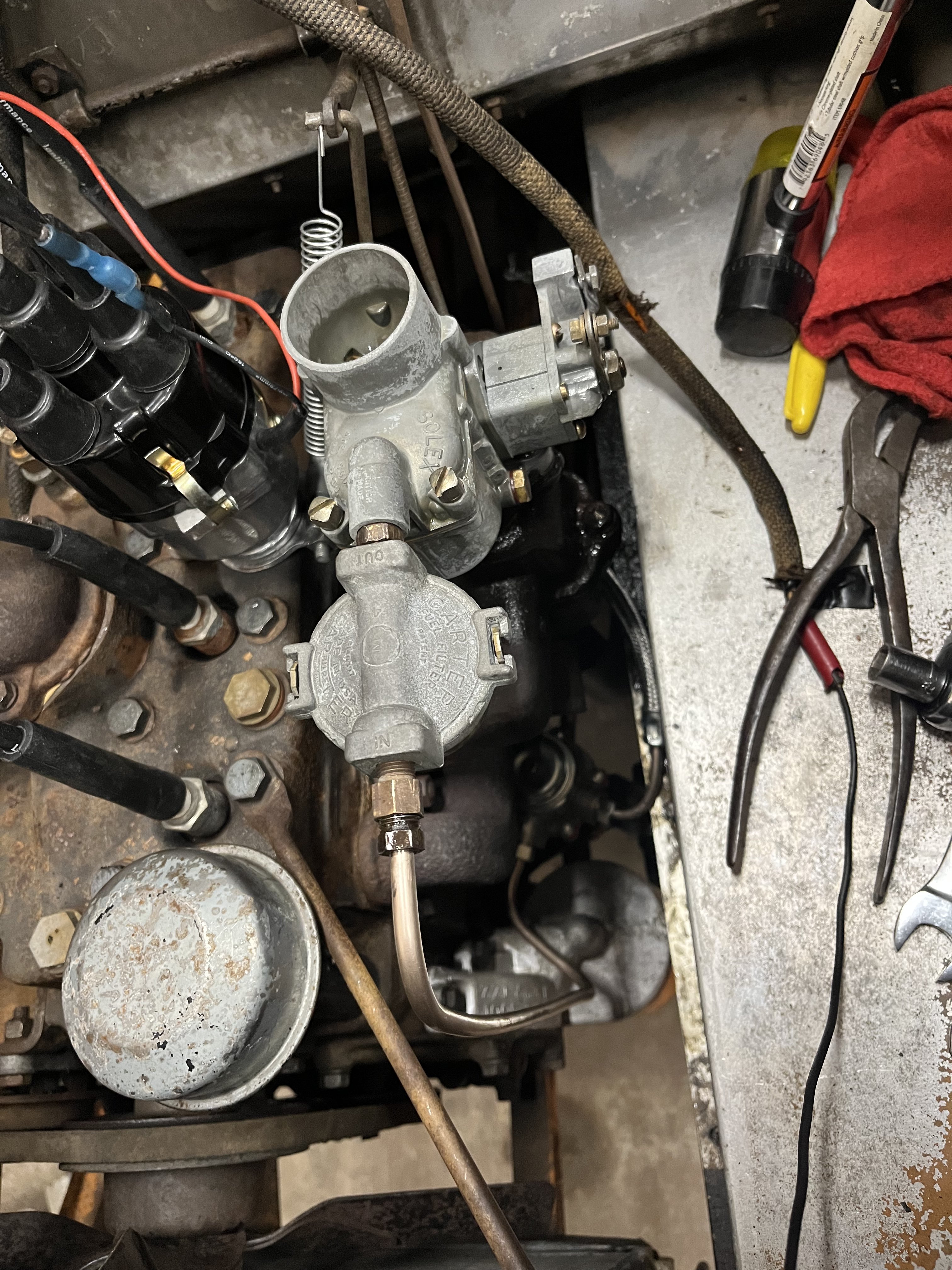

The Solex carb uses a fuel enrichment system rather than a choke to start. our Kitten had trouble starting and running. Took the enrichment pod off and cleaned the plate inside. Then made sure the cable held the correct position according to instructions found on a British 100e forum.

when it's flooding over is the fuel coming out of the venturi as drops or a mist? also the float chamber has to vented to the atmosphere. if flooding it should come through the atmospheric vent too unless it's plugged. just something else to look for. If not vented right carb will not work correctly.

Back into the carb, new float and NOS inlet needle with extra washer. This is believe was the actual issue but hadn't figured it out yet. Then into the choke which has been messed with by the different screws, broken air vent, and orientation was wrong in hindsight. Cleaned took it off back on. GMoose and the internet were helpful.
