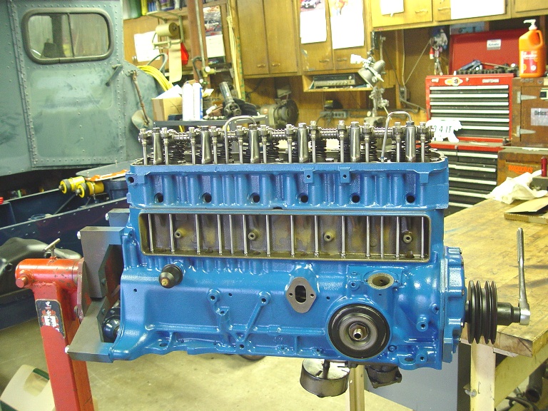

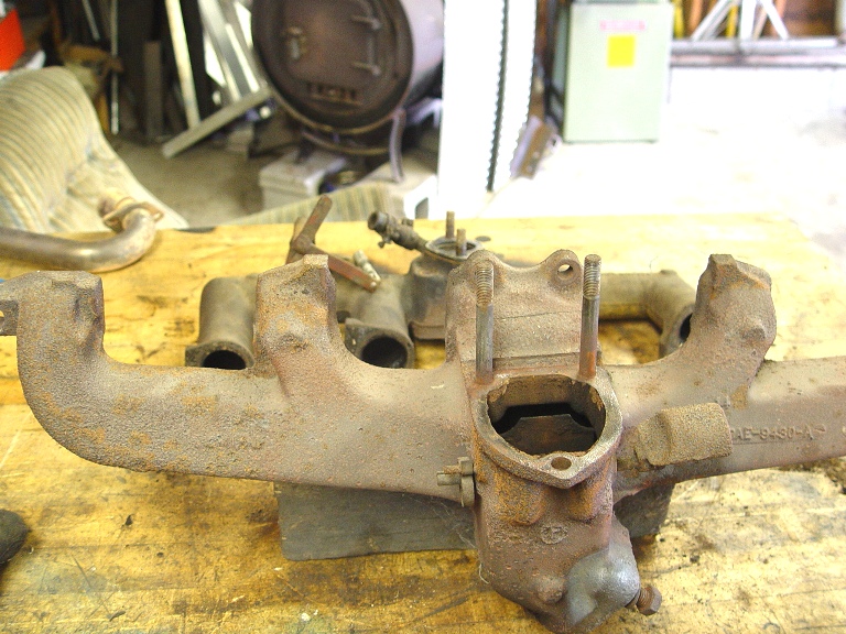

Well I know it's been awhile but between work & trying to spend time up north at our other house and all the upkeep with two homes It's been hard to spend quality time on the cat, but I finally got some time to work on it in the last several days and update my thread. As you can see I got the engine basically back together after making sure all tolerances are correct. It looks like I will be welding the crack in my exhaust manifold I can not find a new one even with the help of a lot of you guys out there. I will be starting on the carburetor next, to get it back in new condition and also I will be switching the 35 amp generator over to a high amp altanator then it will be close to starting it up, but that will be a couple of weeks yet because I have to be out of town all of this up coming week and some of the week of the 23rd for work. So thats all I have for now .

Good God Man ! Is everything you do have to look so damn good ???? Smear a little grease on something, for cryin out loud . I can only think of one other fella on FF that works at your level . Its that fella up in Canada with that perfect Snow Trac . I think i'll go out a polish my lug nuts that I got from Mntpooper .:moon:

Well as my two daughters,most of my friends and all my neighbors tell me is that It's starting to happen! (But they didn't think it would take this long) and that is, you guys are starting to wounder what they have known since that day I came home with that WHAT IN THE HELL IS THAT THING (as they put it) on the back of my flat bed trailer, is that he's not normal:stooges: But I did think it was nice of them to offer to get me help when ever I want it, GEEEEEEEE I wounder if that means helping work on the snocat??? :yum:

I just thought I would show you guys the crack in my exhaust manifold before I get it fixed, (the crack is between the two studs in the first picture). Also I,am switching the 35amp generator for a 160amp alternator

:thumb: Good price!! You wont be sorry. This mod will allow you to easliy run all kinds of things that would have strained that little generator (winch, strobes, etc...).
