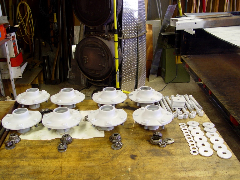

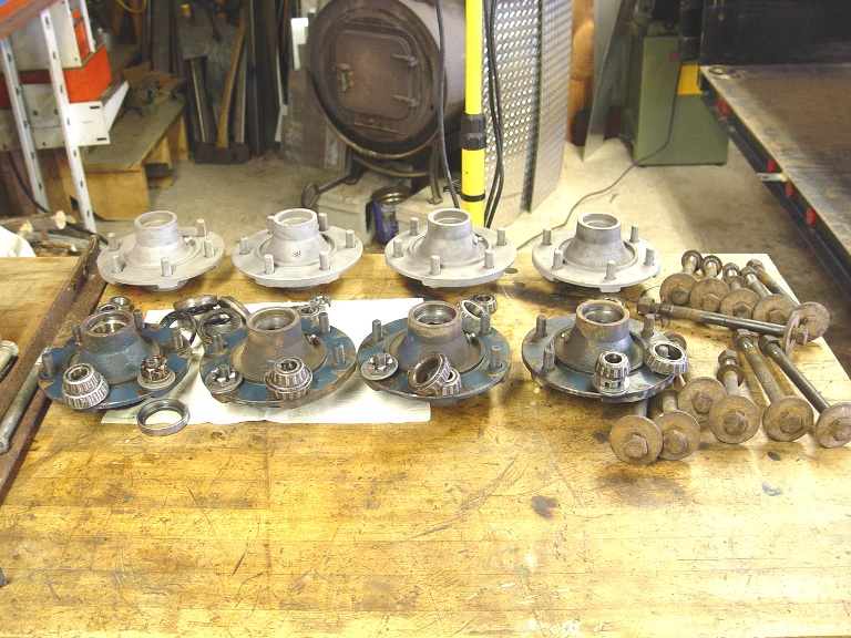

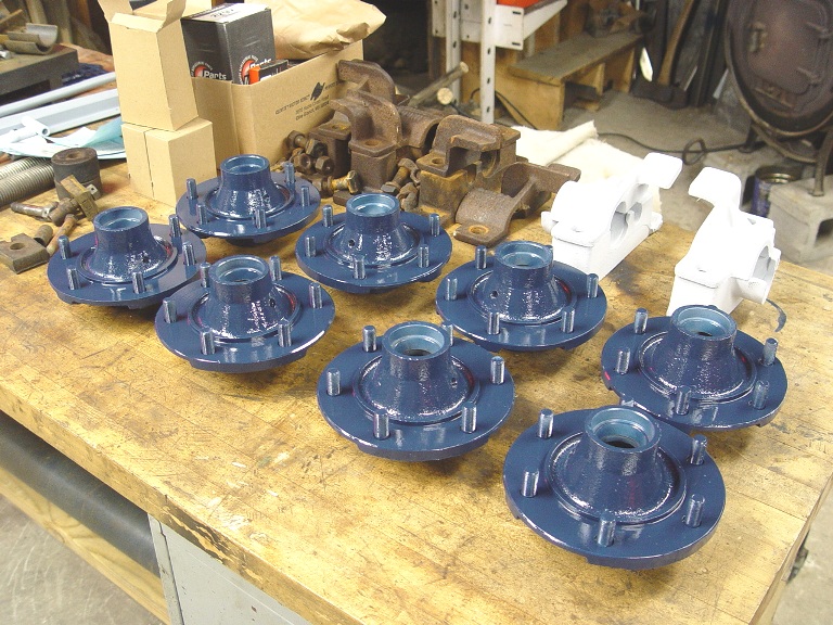

I,ve been away on work for a wile so I haven't had much time to do much but I have got the hubs done along with a lot of little parts also just got the frame sand blasting done along with the axles but have not been able to apply primer yet ( to cold ) .

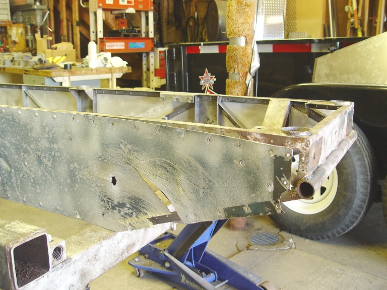

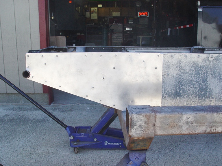

After the chassis was sandblasted I had to repair some sheet metal damage caused from what looks like a track problem back in it,s day. So I made up some patch panels one for each side both sides had the same damage. I removed the rivets (ground them off) and reattached the new panels with stainless button head screws.

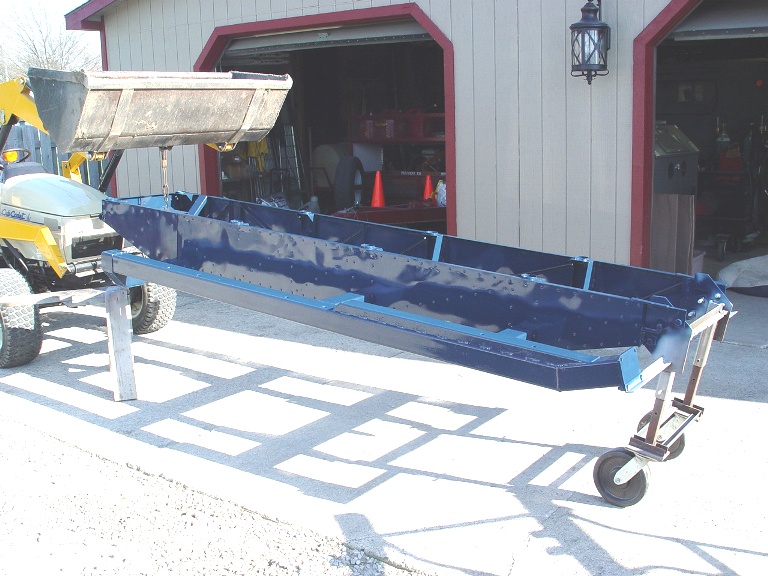

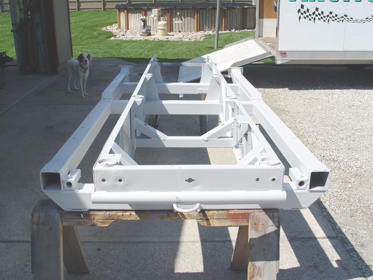

After the patch work and some welding on numerics small cracks here & there I prepared it for paint

Well look at you! Must be nice having some good working weather! Been snowing here AGAIN. I love how the axles came out! That stuff seems pretty good. Do you have a picture of the product? Also the lower frame repair came out pretty good to. Nice paint.
