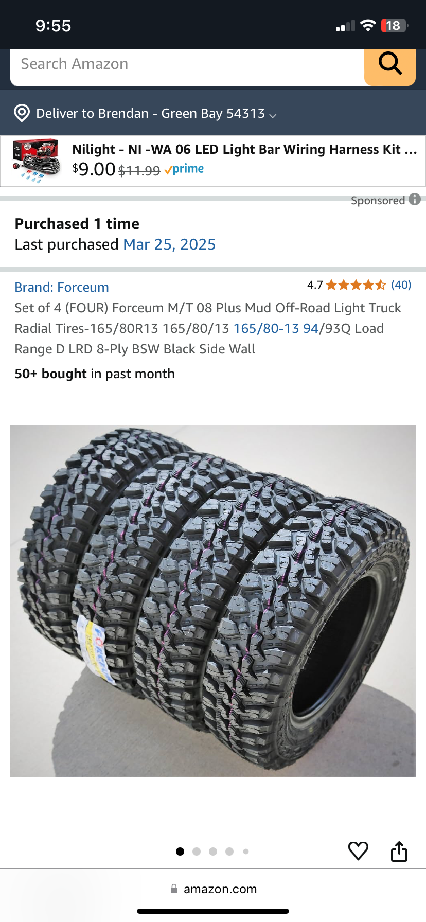

I have no Idea. I may try the 3” again if I have problems when track time comes. I learned a lot. I attached the tire combo, roughly $450 before mount and balance.

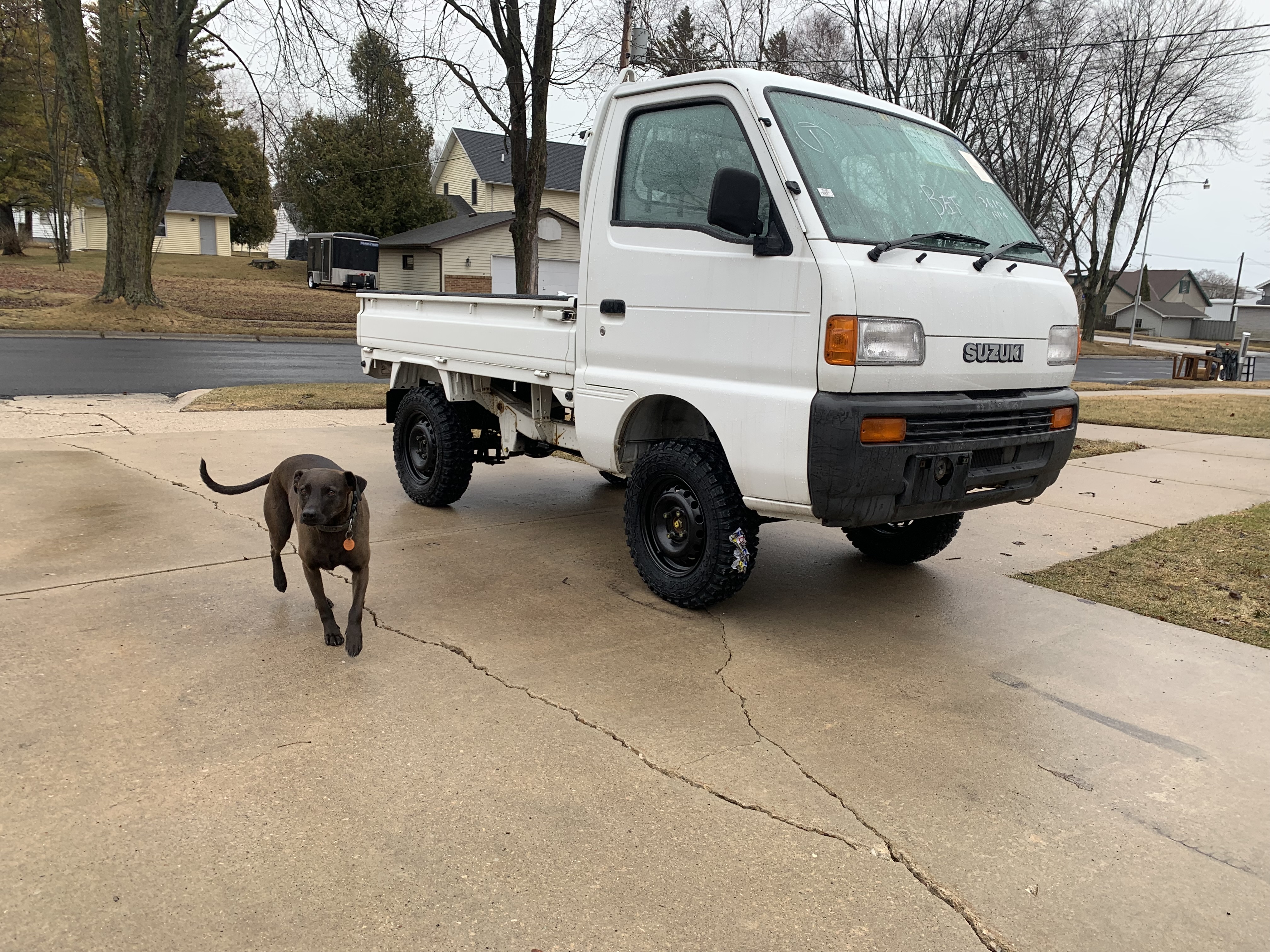

Got tires on with no spacers. Seems pretty good for the price. Rims seem cheap but ehhh. I still need to find rear shocks. I have read monroe 31000s will work with some modification.
The camber on the front wheels looks to be a little excessive. There should have been an attachment bracket for the top of your strut with a slot in it. This allows you to push the strut inward on top to correct the camber, mine is all the way at the end of the slot to get the wheel straight up and down, and could be your axel binding issue.
It’s not terrible. I have both pushed all the way in. We I remade the lift, I made those slots longer. I bored out 2 inner holes and put machine screws in, so I could slide it all the way in. Also added washers to try to help but didnt do much. I almost feel like the lower control arms are holding in place.
