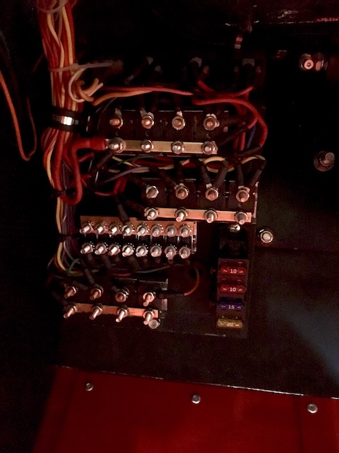

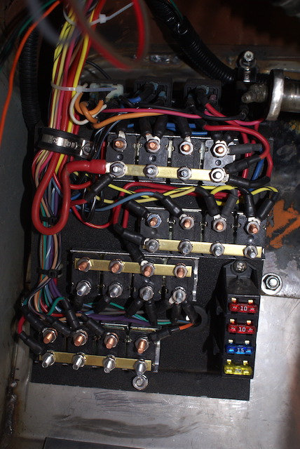

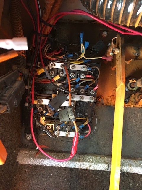

Here’s a pic of Snowzilla’s panel when I bought it. Mostly stock, though owners along the way have added some wires.
We completely rewired Thundercat, and we added several electrical circuits. Bosch style relays are mounted on the top of the panel and on the underside of the top as well. The fuses on the lower right are for the computerized engine’s conversion harness. (There are also some large relays for the electric fuel pump and the two electric fans that are mounted close to the engine’s computer on the opposite side of the cab.)
But we subsequently decided to add even more circuits, and there wasn’t enough "real estate" for the additional required circuit breakers. Doing a little Internet research I learned that John Deere used a narrow style stud mount circuit breaker almost exactly 1/2 the width of the ones we were using. They were slightly different in length, but the mounting brackets could be easily bent just a little to accommodate the narrower CBs. We removed one row of the wide style and replaced them with the narrower versions. I will say while the wider ones are easy to find, the narrow ones are somewhat harder to locate. I bought them from a company called Crimp Supply.

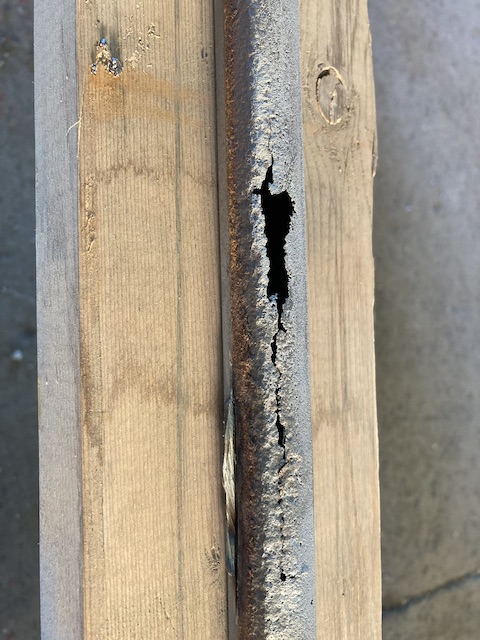

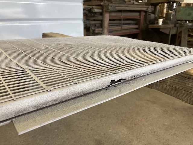

The blasting process of course removes the paint, but the force of the blast media hitting the surface will result in any weakened areas being exposed. This is the bottom of the grille. The square tube with the newly exposed rust hole rests on the Tucker frame.
The damaged section of square tube had to be cut out and replaced with a new piece of square tube. Here’s a close up shot of the damaged section after being cut away from the grille. After Scott welded in a new length of square tube we drilled drain holes for water.

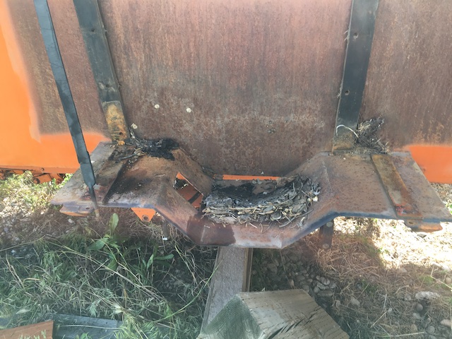

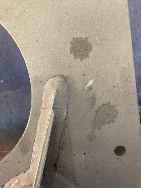

Blasting can also reveal heretofore unknown issues. This is the bottom side of the front fifth wheel plate (aka: turntable). Nice cracks! Of course they were repaired. The dark spots on the surface are sweat from yours truly. Yes, poor old Blackfoot was sweating in the summer heat.

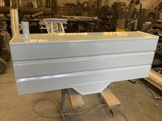

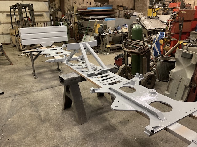

Next came the laborious process of priming and painting all of Snowzilla’s parts and pieces. We use a catalyzed epoxy primer that chemically cures more than dries. It’s very hard once cured and has excellent rust and corrosion resistance. We would lay out various parts on some boards and prime one side. After the paint had cured enough, we moved them outside so the shop could be used for normal work during the day. Then we’d do it all over again the next night. I'm the chemist, responsible for mixing the primer, the catalyst and the reducer and Scott sprays the primer.
Here’s a bunch of parts laid out after priming.

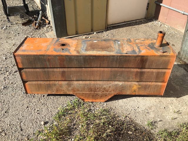

A close-up of the gas tank.

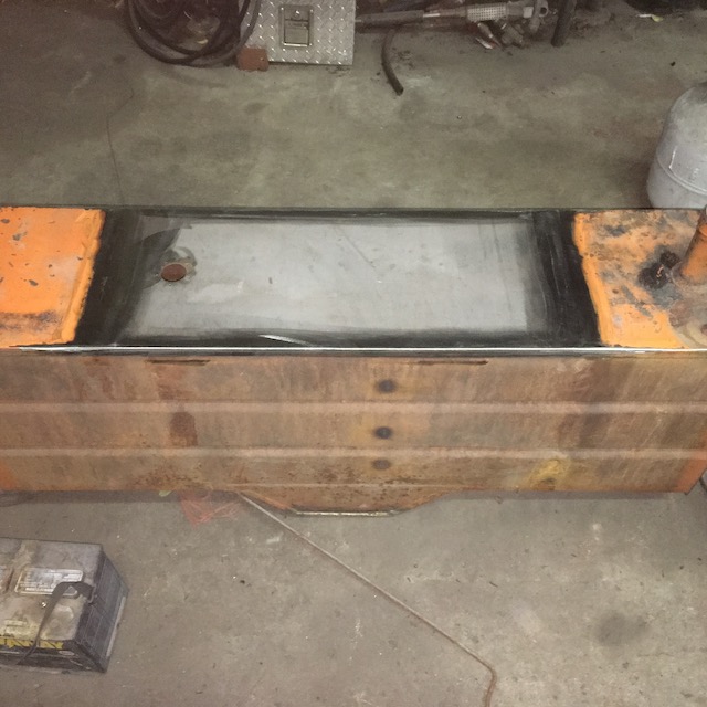

Remember what it looked like when we first got Snowzilla? (Yes, the entire side of the tank is rusty. Tucker never bothered to paint it.) The “quality" of that level of workmanship is self-evident, and needs no commentary from me.
The rather pathetic patch on the top of the tank done by a previous owner.
Here’s a pic of the tank after we had cut out part of the top and welded in a new section.

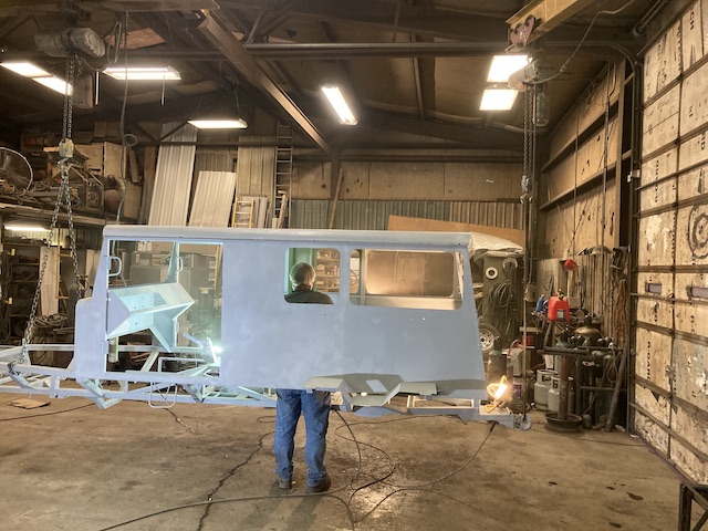

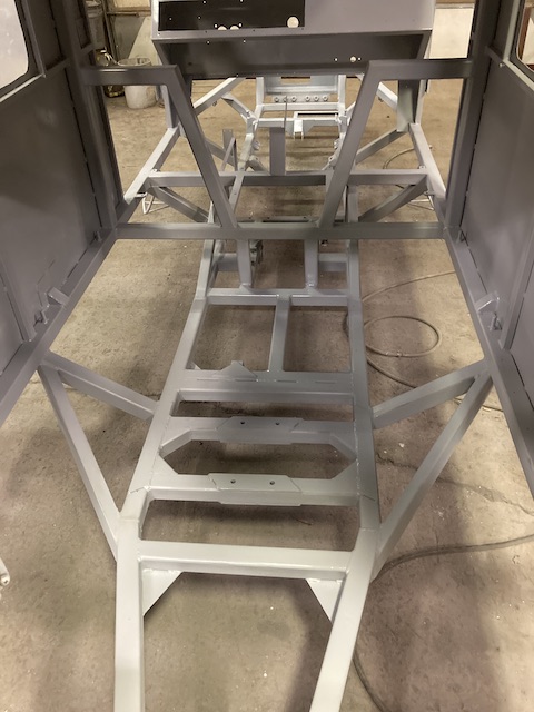

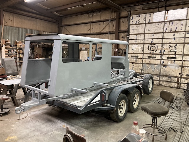

There was actually quite a bit of work involved in getting the cab and frame ready for the color coats of paint. The cab sides are basically flat sheets of 16 gauge steel. Unlike body panels on a car or truck that are pressed in dies to give them various body lines, these are just flat. Those body lines give the shape some interest, but they add considerable strength as well. The Tucker cab just uses the steel sheet metal skip welded to various cab structural members. Auto manufacturers will typically use structural members which are also stamped and they’ll have flanges on them where the sheet metal attaches, and they use multiple spot welds to hold the two together. Tucker uses tubular steel frame members and as you can’t access the inside of the tube to spot weld the sheet metal to the cab, you skip weld it. The spot weld certainly creates heat, but it’s much more localized than skip welding, and the skip welding process causes more distortion in the panel than if it were spot welded. Between the distortion from the welding processes and dents picked up over the last 40 years, we had a fair amount of work to do. We did not try and make it perfect, and WBJ1 was encouraging us to “spray it already”. But we did try and take the worst of the flaws out and make it at least presentable. In earlier posts in this thread I pointed out poor workmanship on Tucker’s part in not painting, or even priming, various components. I assure you - we took no such shortcuts; even to the point of filling small dents and rust pits on the cab side that is obscured by the gas tank. (Tucker, didn’t even bother to paint this surface.) Most of the time we left the cab on a trailer and moved it in and out of the shop to work on it. But when it was time to spray the final coats of primer before spraying color we suspended the cab and frame from the two shop cranes.

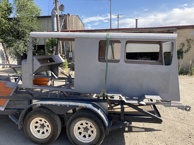

On the trailer...

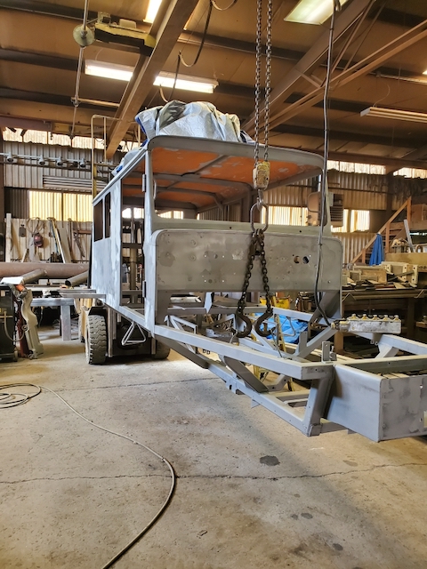

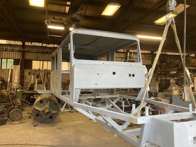

Suspended from the two cranes.
The cab side and fuel tank protective shield.

A shot of the frame from inside the cab. Yes, those surfaces will all be covered, but painting them is doing it “the right way” in our opinion. If you look at the intersection between the sheet metal on the sides and the frame members you can see a slight gap. Tucker did not apply any seam sealer to this joint and water can get down between the two components. After spraying the epoxy primer we applied seam sealer to the joint. I had intended to take a pic after the sealer was applied - but I forgot to.

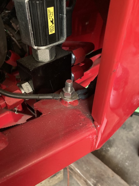

So,a question: With all the prep paint and such, do you have any issues with grounding? Just wondering if you are going to have to add bonding jumpers or return wires. Or is there enough fasteners that it isn't an issue? I'm going to be dealing with this next year and would rather learn from others.

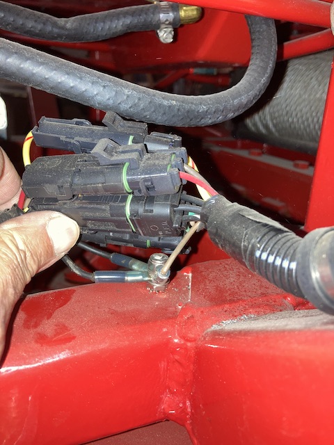

I decided on my rewire to use return wires where possible to keep electrolysis minimized between the aluminum and the steel frame. But I was dealing with a few points where steel was supported by aluminum which was supported by steel. I don't know if return wires are overkill or not.
Just some thoughts after running/owning big rigs for over 20 years.
Most big trucks (Pete, KW, Western Star, Freightliner) use a ground for each circuit and not the frame or body....
Grounding through body panels/frame and such can lead to ground issues after time due to corrosion and other degradation of things.
Bad grounds can literally drive you nuts unless you happen to stumble onto the break.
If you run all the lights or ??? equipment grounds to a common bus bar and then use a common ground wire back to the battery/engine and the same scheme all the way you can eliminate loads of grief later on.
The practice of using the chassis as the ground plane has other problems too..
Electrolysis can set up and his can add even more troubles.
Electricity will find a way.....back feeding through wherever is can to complete its path to ground.
I had a 1986 Chevy 3500 that one day started making the wipers run when you accelerated hard.
Drove me nuts.....Finally after thinking about it I went searching....I had replaced the HEI Distributor cap and parts a week or so before....and shortly after the gremlin appeared.
Broken ground wire from the coil in the HEI cap .....Fixed the issue and the gremlin was fixed.
Broken or bad grounds can make gauges wiggle when the signals are on....
Step on the brake and other lights dim or come on......
Dedicated grounds are simply not a bad way to go.

You’re absolutely right about all the primer and paint creating potential grounding problems. As yet, we haven’t really gotten very far with Snowzilla’s wiring. We’ve got the instrument panel probably 80% done and we have spent a fair amount of time reconfiguring the conversion harness for the L94 engine (adding some wires and removing others). We have also run most of the other wires to their respective locations and left them long. But the majority of the work is ahead of us. When we re-wired Thundercat, we ran a number of ground wires and proper circuit grounding was something Scott emphasized all along. We added a couple of welded studs to the frame and some ground wires are secured there.

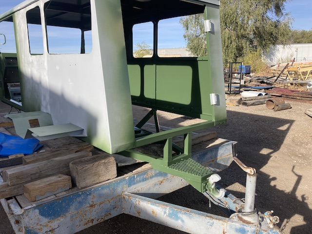

When it came time to spray the color, we decided to spray the inside of the cab and the frame first. Having the two shop cranes made this task a lot easier. We could raise and lower the cab at will to position it at the optimal height for accessing various parts from the interior roof to the frame. That said, it was still challenging, and a team effort. Scott would bend down and crawl under the frame and then stand up in an area between frame members. Then he’d spray what he could, bend down, crawl to a new location and do what he could from there, and so on. But the lighting in the shop is really lousy and that’s where I came in. I’d hold a (WBJ1 will love this) LED light stick and shine that to help Scott. I’d also point out areas that needed more paint. That might come across as being critical, but neither of us took it that way. It was an extra set of eyes from a different vantage point, and the goal was to do a thorough job. It helped to achieve the goal.
Here is Scott just starting to spray the color.

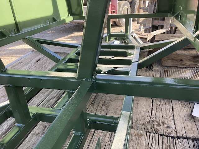

The Tucker truss frame is composed of many individual pieces of steel, all welded together. Each piece has multiple sides and they all need to be painted, and the coverage needs to be 100%. That means multiple spray gun angles to cover each piece and the multiple angles means overlapping paint on adjoining frame pieces. This can very easily lead to runs in the paint as you strive for that 100% coverage. Honestly, I think Scott did an outstanding job. He’s not a professional, and yet there are only a very few number of boo-boos. I can unequivocally say I could not have done as well.
These pics were taken the following day.
We had suspended the cab from a strap on the pintle hitch and Scott didn’t want to spray the strap with green paint. The pintle hitch was sprayed when we painted the exterior.
