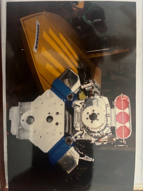

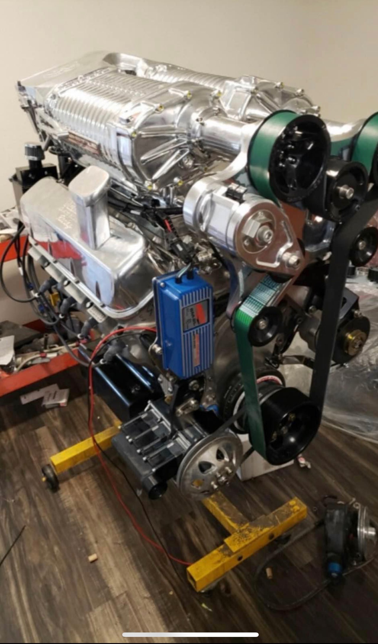

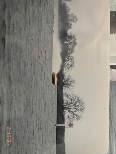

I’m no stranger to going fast in a boat, this was my first whitewater marathon boat, 447” Donovan hemi alcohol injected and supercharged around 1600 hp, I gotta dig the pictures out, you can see the block peaking out in the third picture in the garage that went into the second boat, that engine was a 526” KB second gen. Hemi, injected alcohol with a 1471 blower, around 2000 hp. These were marathon boats that ran rivers during runoff in the mountains, like the Rogue in Oregon and the salmon in Idaho. Top speed around 120-130 depending on conditions. Now days unlimited class uses helicopter turbines. I started my own business and that was the end of all the racing. No time after that.

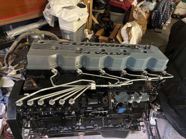

Nothing wrong with the 6.7 after the emissions crap is removed. It’s a bigger engine but a lot more expensive to put on a p7100 injection pump as it’s a common rail, with electrical fired injectors, I think you use 24 valve injectors and cross tubes to go to a mechanical injection pump. Then there is availability and cost.

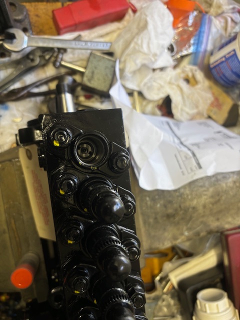

The injection pump showed up today, tomorrow after chores I have a job walk, so may or may not work on it, Saturday I have a family outing, so maybe Sunday I can get back on it. This time I’m doing all the modifications on the bench incase somthing else shows it’s ugly head.
What's your thoughts on a 6.7 Cummins?
Researched modifying the 6.7 some out of curiosity, it’s very easy to get 500 hp with it, as it’s just a tune, where with a 12 or 24. valve it’s going to be a turbo, delivery valves and injectors = couple thousand dollars
And the same couple thousand plus head studs, rod bolts and valve springs and another upgrade on the turbos by adding one to make a compound set up, about 4k so around 6k for a reliable 1000 hp
6.7 is going to need turbos, the bottom end treatment, injection pump , injectors and a tune. The difference is the parts cost is astronomical compared to a mechanical pump. So 6.7 around 20k to get to 1000hp
