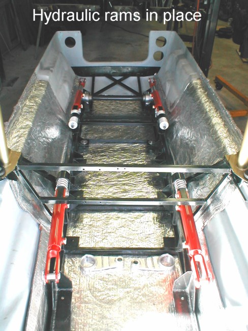

Today , I got started on the Hydraulic ram lift system and the front and rear drive mechanism .
All hydraulic rams are repacked and installed as is the rear drive mechanism . It took quite a while as I have added rubber bushings where there were none before . I have the front “right angle gear drive motors installed in the case and the whole unit setting in place .
I should finish up that tomorrow and then install the track rails . The rubber mounts should help quiet everything down immensely . I can’t believe the whole running gear never had any:mad: ,but I am not surprised .
Got to go look for my butt ,as it was draggin when I headed for the house . I think it’s at the door and wants in …..
Here’s a couple pictures to hold you over until I get the front gear drive installed .

Snowcat Operations said:

Its going together quit well! Did you repaint the old rams or just buy new ones?
Good Morning Mike ,
Nope ,I just repacked the existing ones and cleaned them up . Finished up by throwing a new coat of Red paint on them . These were made by "Energy Engineering" back east and I doubt if they are even still in business .These rams are a 2"x8"x 2500PSI ram . Pretty standard in the business . I don't know but maybe all Kristi Model had this brand .

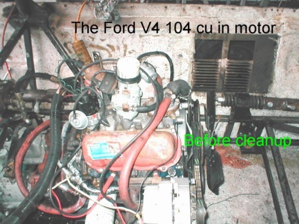

Here are a few shots of the motor . I was waiting for my 8mm plug wires which I custom fitted and shortened for the Ford V-4 Industrial engine . This motor produces about 80 horse power and is 104 cubic inches .I have added a remote oil filter kit and also a air cleaner ,which it did not have when I bought it .It now has a high amp alternator in place of the old one because of the added electronics that will be installed .
