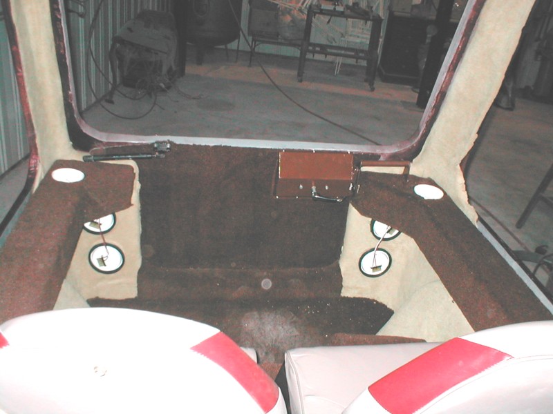

I started out down at the Auto Parts store and bought all the remaining electrical I needed to complete the KT7 :cool2: .
I headed back home and finished installing upholstery to the rear door . I them started looking at the exposed rear tail lights on the inside and decided that something had to be done to make them blend in more :confused2: . So I ended up taking a 12" piece of 6" diameter single wall stove pipe and slicing it in half length ways . I then bent under 3/4" to form a inside lip and upholstered the whole thing in fleece . I installed a velco strip to my 3/4" lip and another velco peice to the body where the lights are at . This makes it easy to remove ,if need be but locked securely in place ,the rest of the time .:thumb:
So The back half is completely finished other the the windows being tinted and installed .
Then I moved on to the front and wired up the front fog lights .
The inside top was fleece lined to be able to install the moon roof .I also radius the moon roof to follow the arc of the top so the margin is the same all the way around it .
At this point I dug out my new remote controlled spot light and mounted it into position . I am very pleased with how well it turned out :thumb:
As I was closing the shop up for the day , UPS showed up with my new Kristi Travel mugs . Thank you Mr. Bob S.:applause: I have different base inserts for my homemade cup holders so I will dig them out to make the cup fit nice and tight .
Here are a few pictures : The first picture shows the exposed tail lights . The second shows my home made covers .
