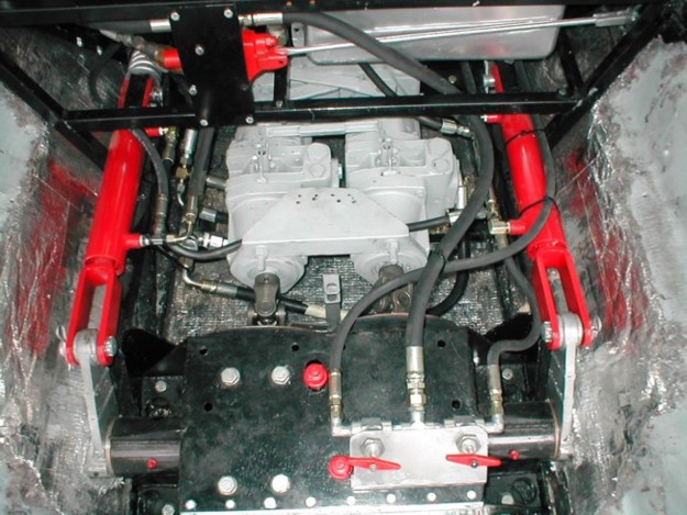

The last hoses were made today . I have 4 left to hook up and the hydraulics are complete . All new hoses and fittings ran about $715 . Those last 4 are going to be a "son of a gun" to hook up . They are under the transmission :pat: . Found some major BooBoo's by the Kristi builders in their orginal hydraulic hose lay out . This may explain why it was reported the KT7 could not obtain 20 MPH in testing . WE shall see . I don't think they were much of hydraulic experts . I know I'm not . It took the boys down at the "Catapillar Shop" about 1 minute to locate the problems and find a solution .

Well.... The #@!!XX$$$!! hydraulic hoses are all installed . I have one left to tighten up and it is directly under the Transmission . I have about 4 inches to access it . Looks like I am going to end up cutting a wrench in half to tighten it up .
Overall ,I am pleased with the outcome . It is much cleaner as far as the hose routing goes . The Hydro Transmissions now have there own large oil supply so there should not be a oil stavation issue anymore .
If the last hydraulic hose can be tightened in the morning, I will connect the remote engine oil filter hoses ,secure the hydraulic tank ,connect gas line ,add oils, battery, temporary wiring and get ready to fire it off over the weekend. :5boobs: :5boobs: :5boobs: :coolshade :coolshade
Here are a few pictures of the new hoses and the routing ....

BigAl said:
temporary wiring and get ready to fire it off over the weekend. :tiphat:
Have a fire extinguisher ready just in case something goes wrong. Too much hard work to let something stupid happen.
I would not be surprised to see it going 30 MPH sitting still.:yum: :thumb:
Thanks Bill , Yes, I keep 2 big "10 pound" fire extinguishers in the shop at all times . I think I may just use a boat fuel tank as a fuel source before adding fuel in the tank . That way I can isolate it outside and away from the KT7 .
