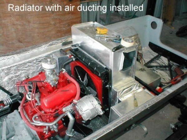

I spent the day installing the air intakes and cleaning the radiator . I think I orginialy said the radiator was out of a 65 Ford Mustang , but it is not . It is very similar in design but has a industrial 3 roll core installed , This one was built in Canada and they used a very cheap gasoline based paint to paint it with . Over the years the grease and grime worked against it and the fins were pretty much plugged up with old paint and crap .One thing I found odd is the fins per inch on this radiator . Most industrial cores are about 14 fins per inch maximum . This one is 18 FPI . Better cooling ,but you have to keep it clean to flow air correctly . I got out my old Radiator repair tools and went to work on it . It has been 8 - 10 years since I have done one but everything came back to me and it is now sitting beside the cat, ready for reinstallation . I am also going to add a overflow reserve tank to the system ,so I will not have to worry about losing anti freeze .
I also installed a "thur hull fitting" in the bottom of the body so the engine crankcase air breather could vent to the outside .
Not much to look at so i'll save the pictures to later .
:tiphat:
Today was spent trying to adjust the radiator and get it to sit properly in the brackets . I added 1/2" inch in height to Radiator mounts to get it to line up with the engine fan . I also welded in the radiator supports once anything was in line . The radiator drain hose was extended to drain under the body .
So the Cooling system is pretty much completed . I also plan to run "Water Wetter" by Red Line along with the anti freeze to increase the cooling ability. This should also bring the freeze protection down to about -75 degrees . I think that is good enough .

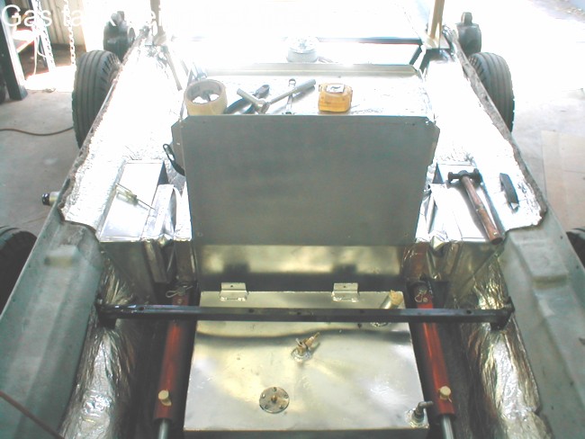

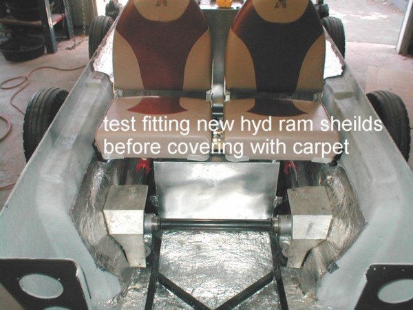

I spent the day cleaning the fuel tank and repainting it . I am still not sure how it was fastened into the frame as there are no connecting points anywhere . There was no build up of crud inside as it had a very heavy galvanized coating inside and out .I cannot believe they would have left it like that . Tomorrow I will go pick up some 1/16”x 1” wide steel strapping to weld in as a hold down to the frame .
I also installed the cross bars that hold the rear seats in position . I will be building a new plywood false floor , a plywood deck for the seats to sit on and complete shields to hide the hydraulic rams which are near the passengers feet . Once everything is fitted correctly it will all be covered in Marine grade carpeting before permanently installing the seats.
I sat the seats into position and found that there is still extra room on each side . These should work better and be a little more comfortable on the butt . They also fold down when not in use .
Here are a few pictures of the last few days worth of work .
