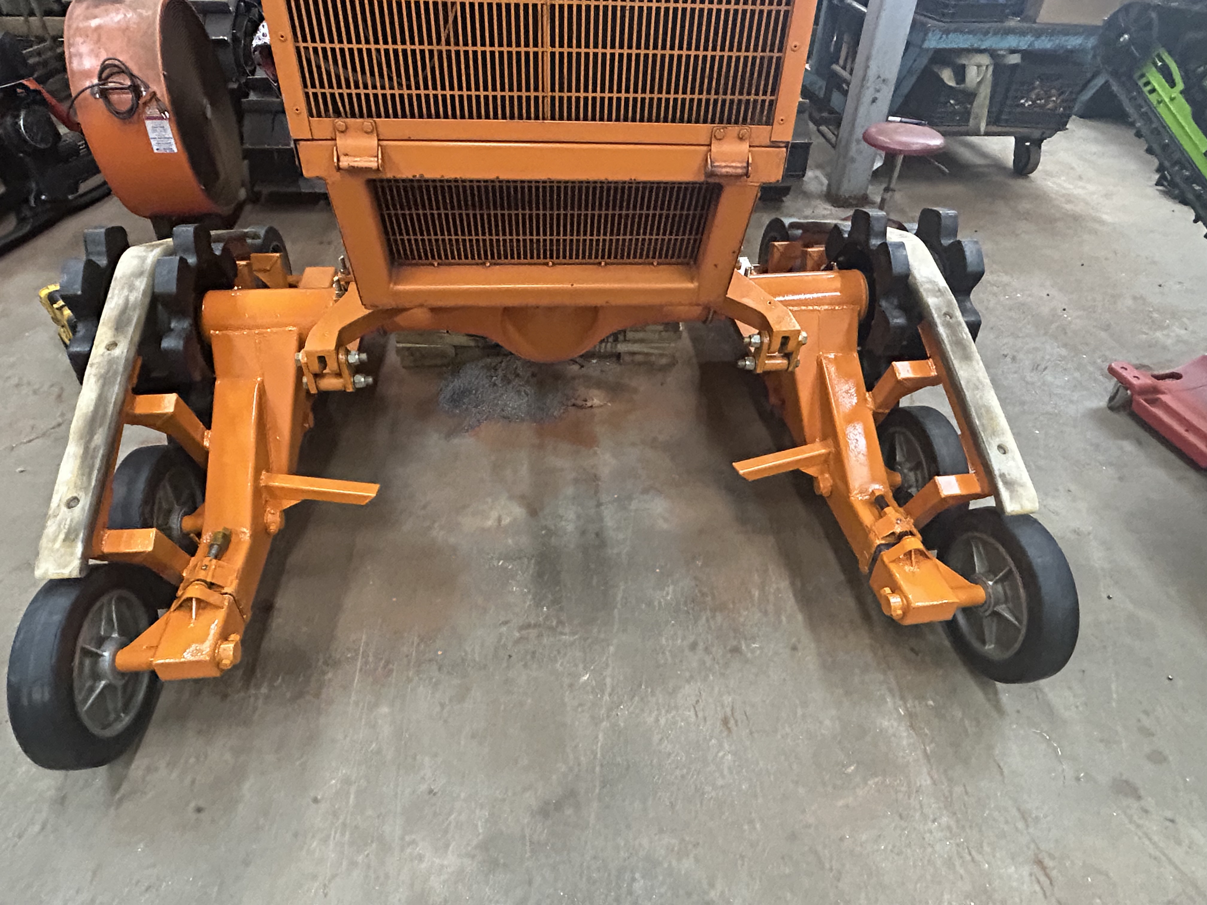

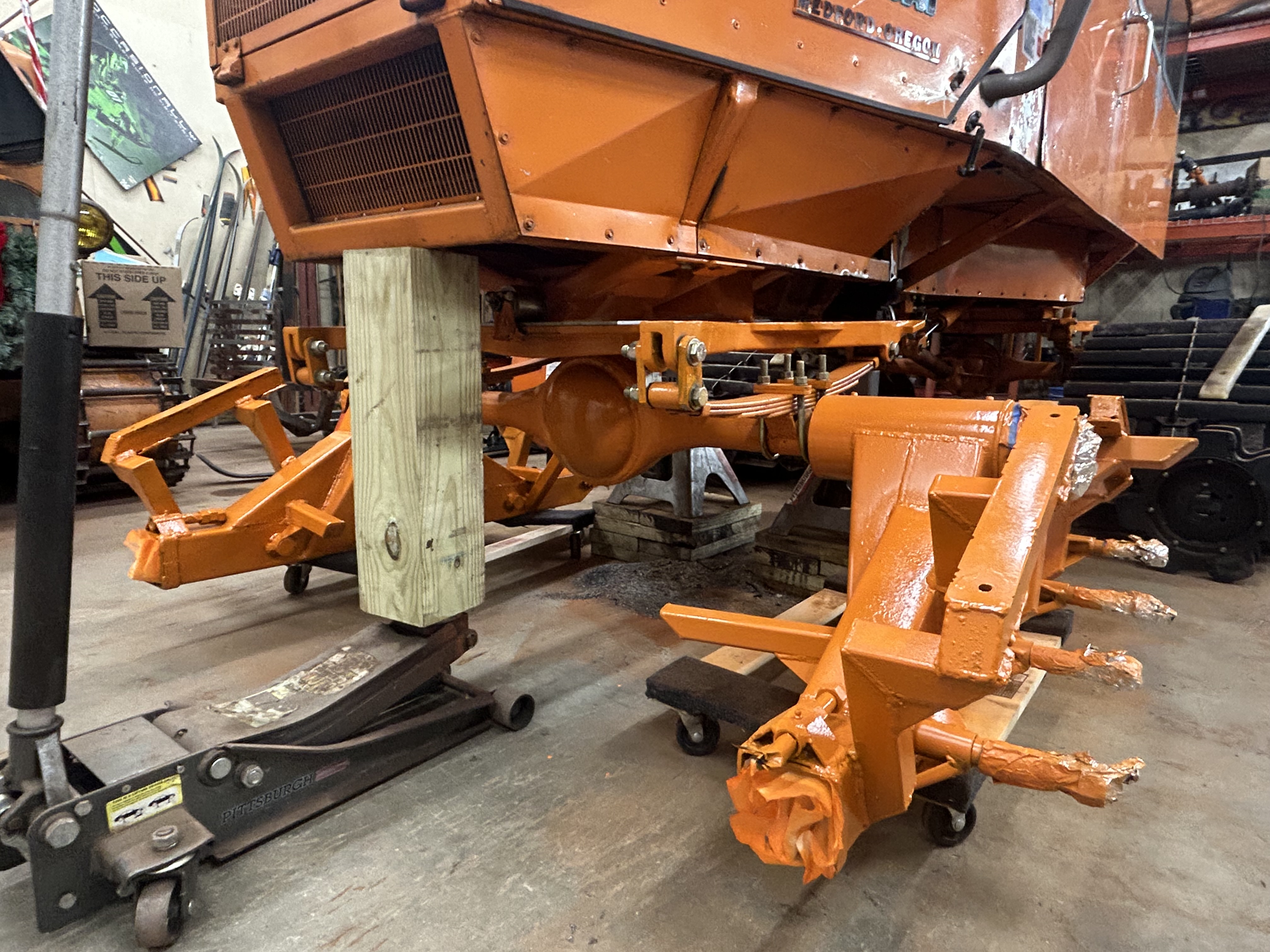

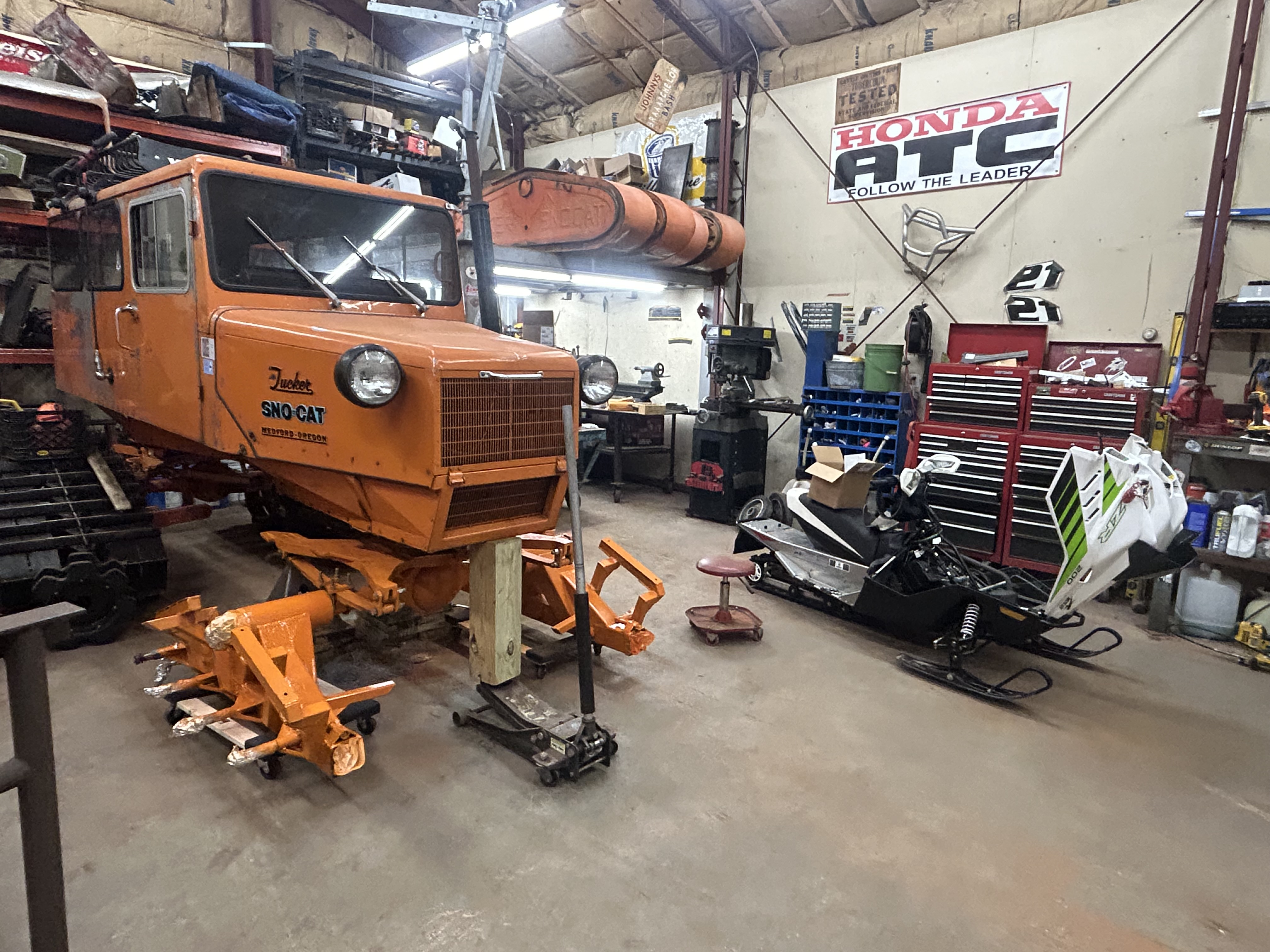

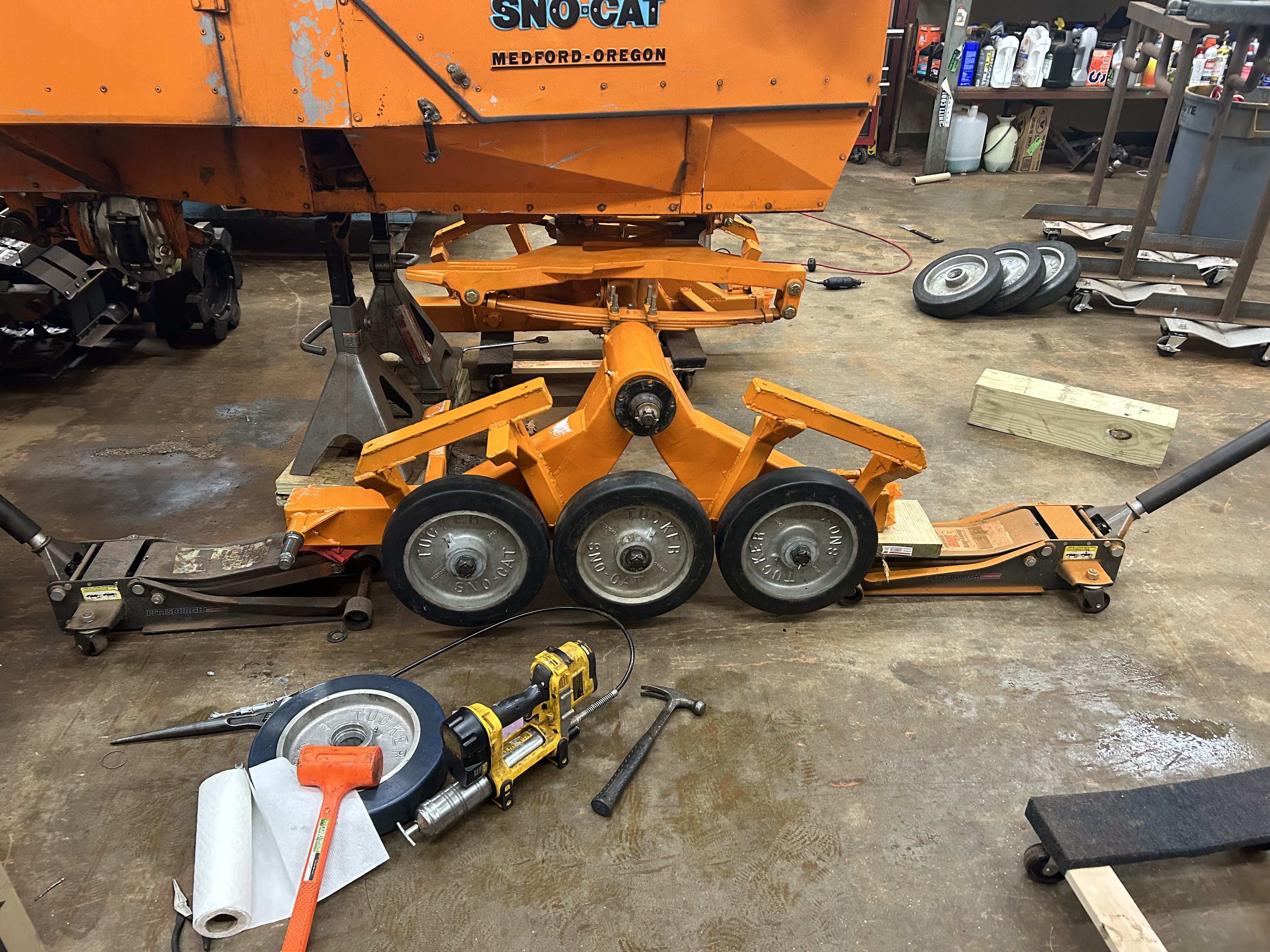

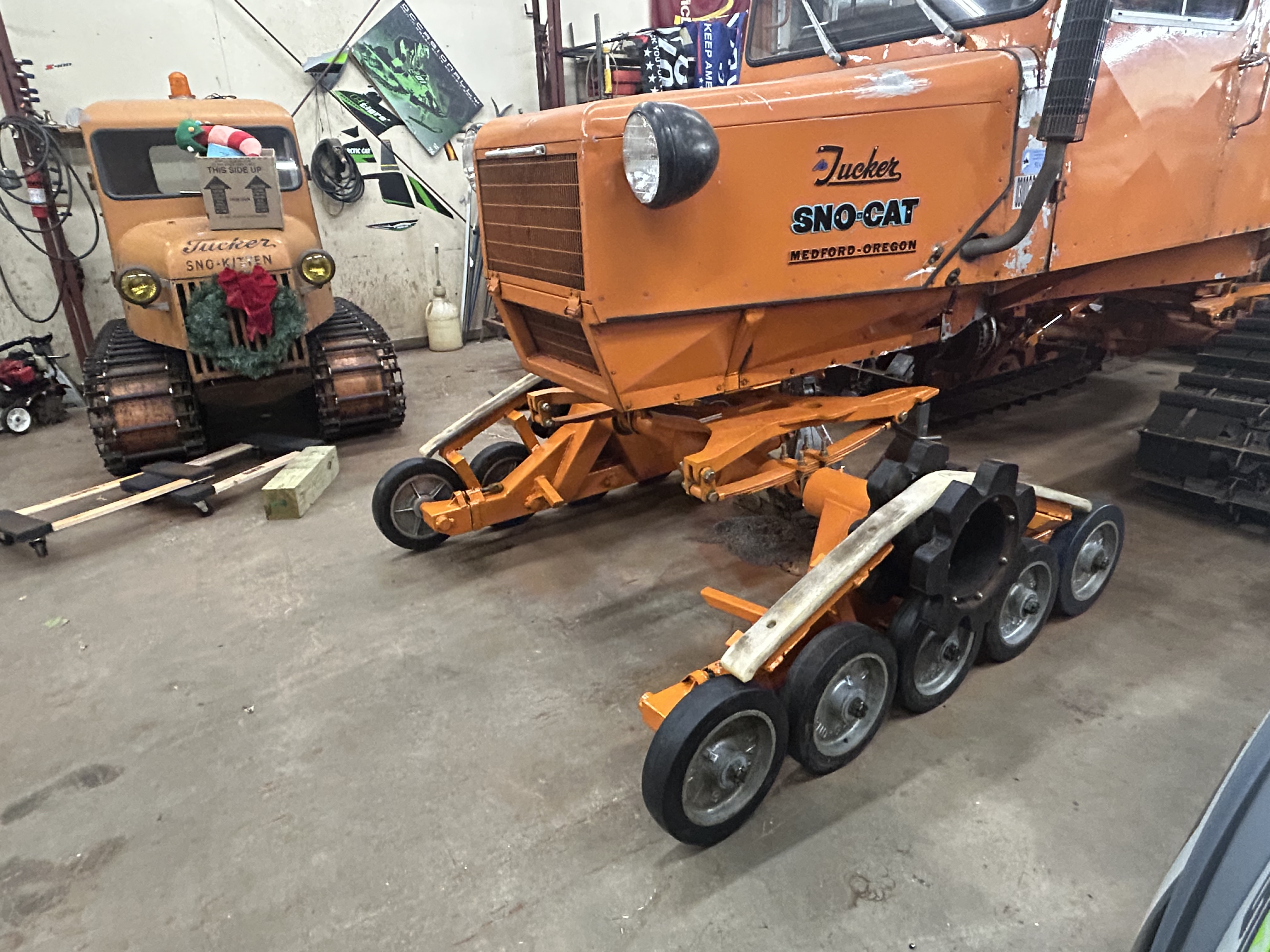

Front carrier back on trunion mounts. All greased up and bolted down.
Mixed up a quart matching brush paint and did some touch up.

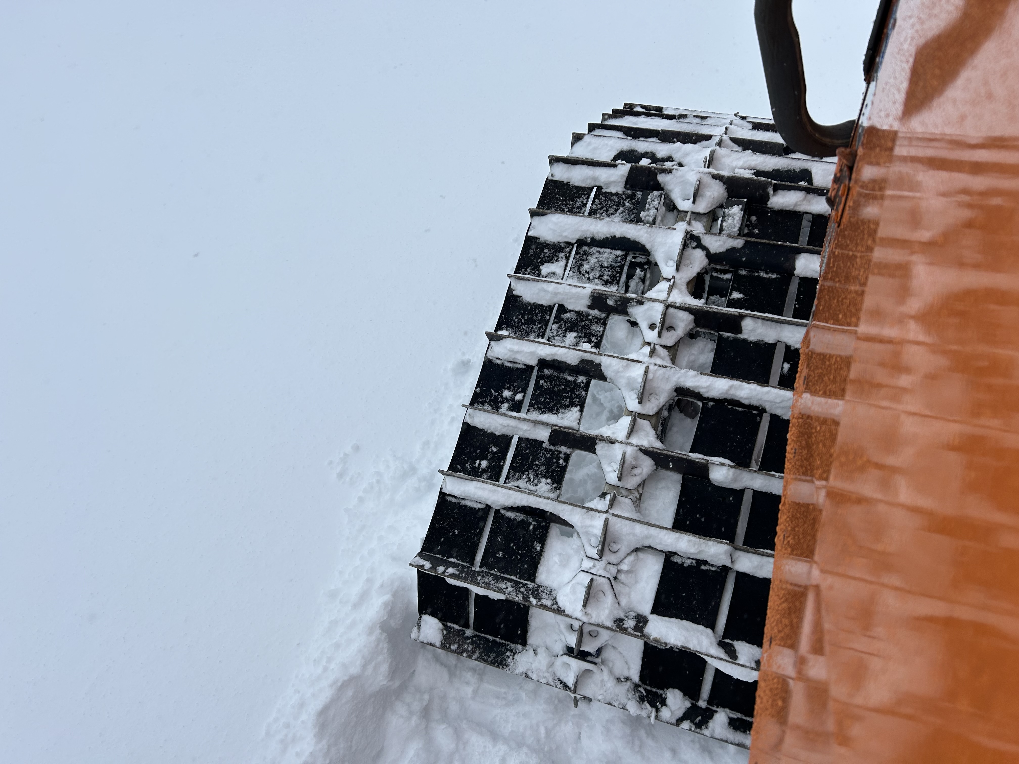

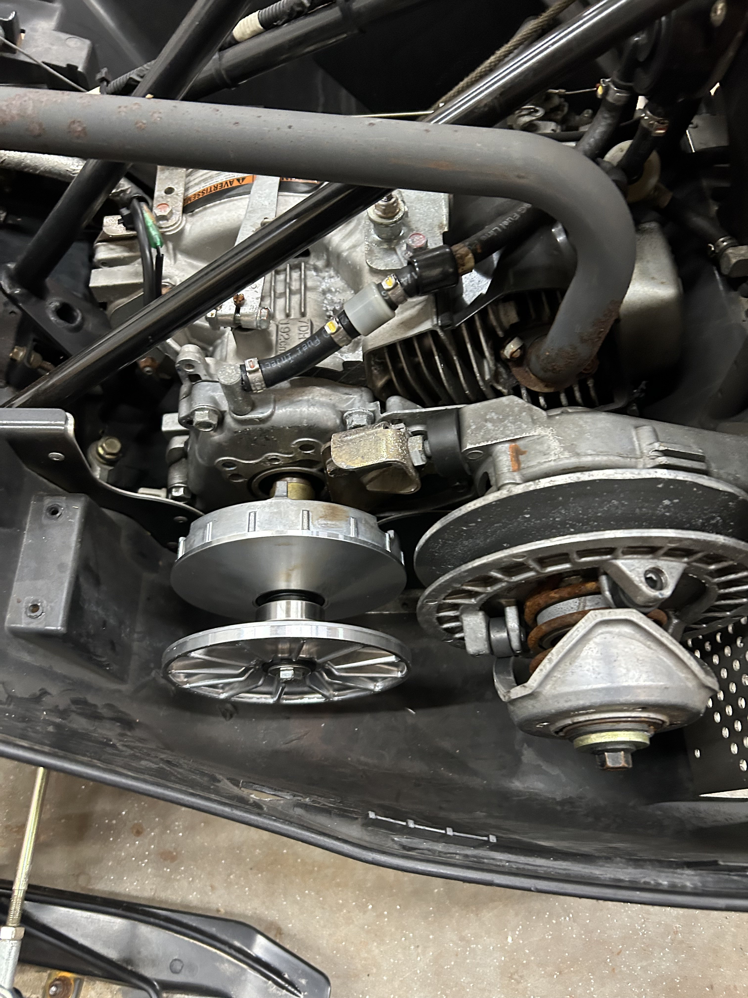

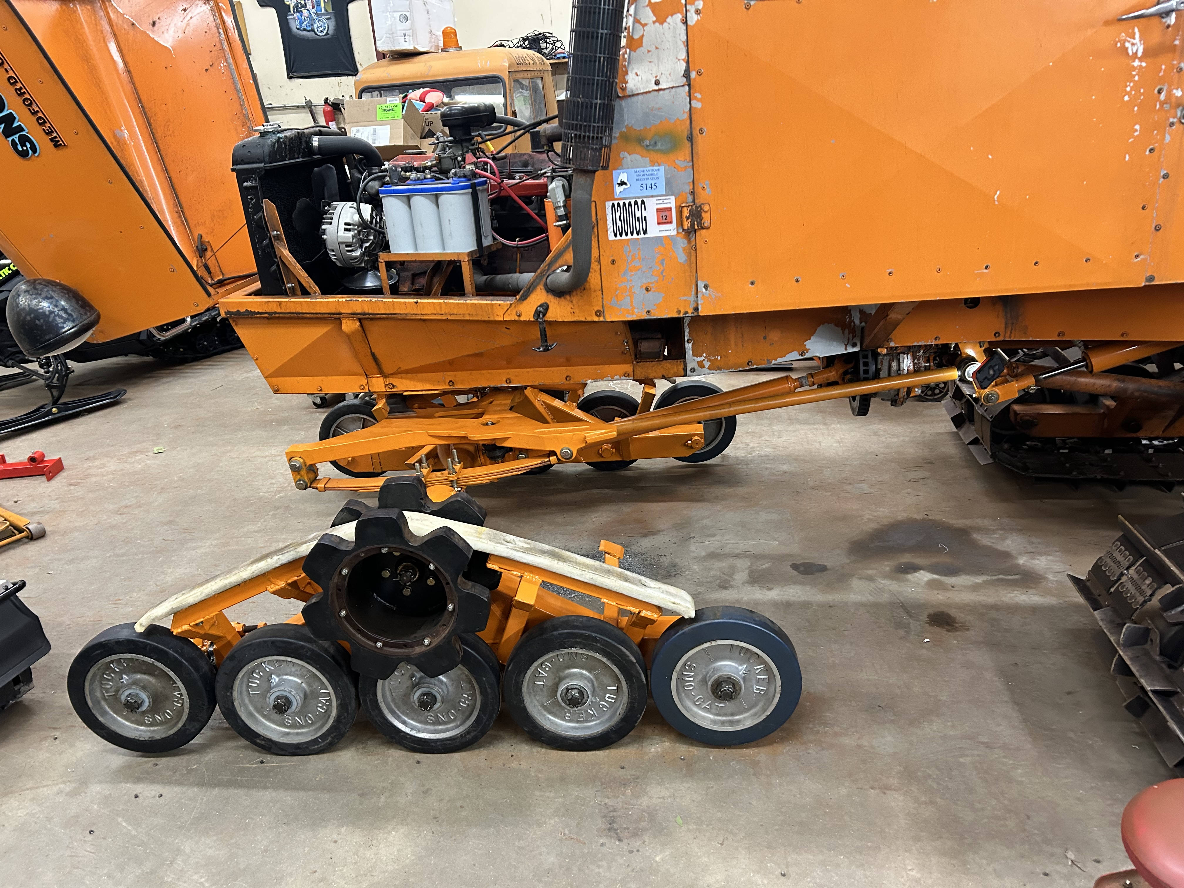

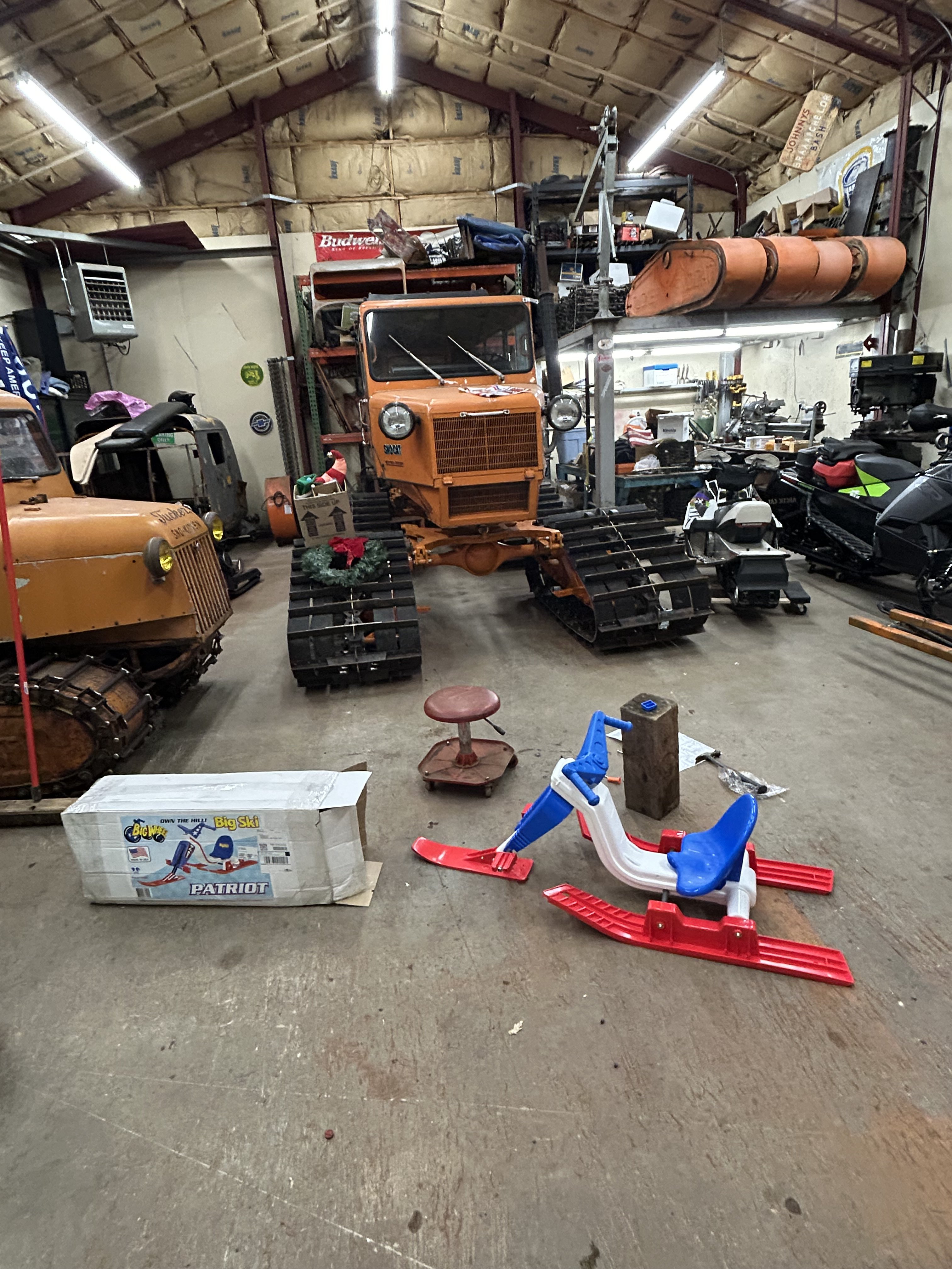

Single tracks starting to move in. Just bolted the 4th drive clutch on for second child rider. We got lots of mods and it runs to the bar all day. Pay to play I guess.

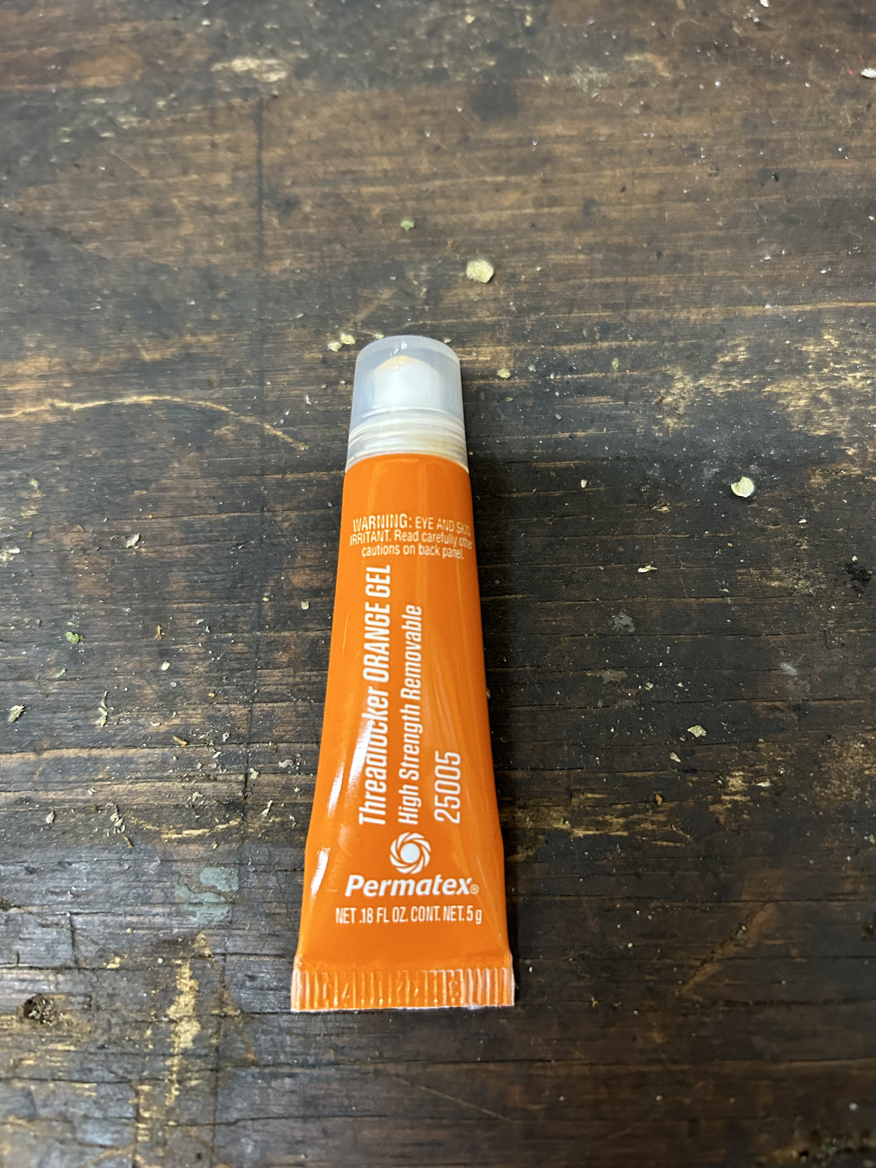

Trying the Tucker orange thread locker see if that holds the clutch bolt better.
Swapped the passenger and driver sprockets to spread the wear. Changed out some hardware.

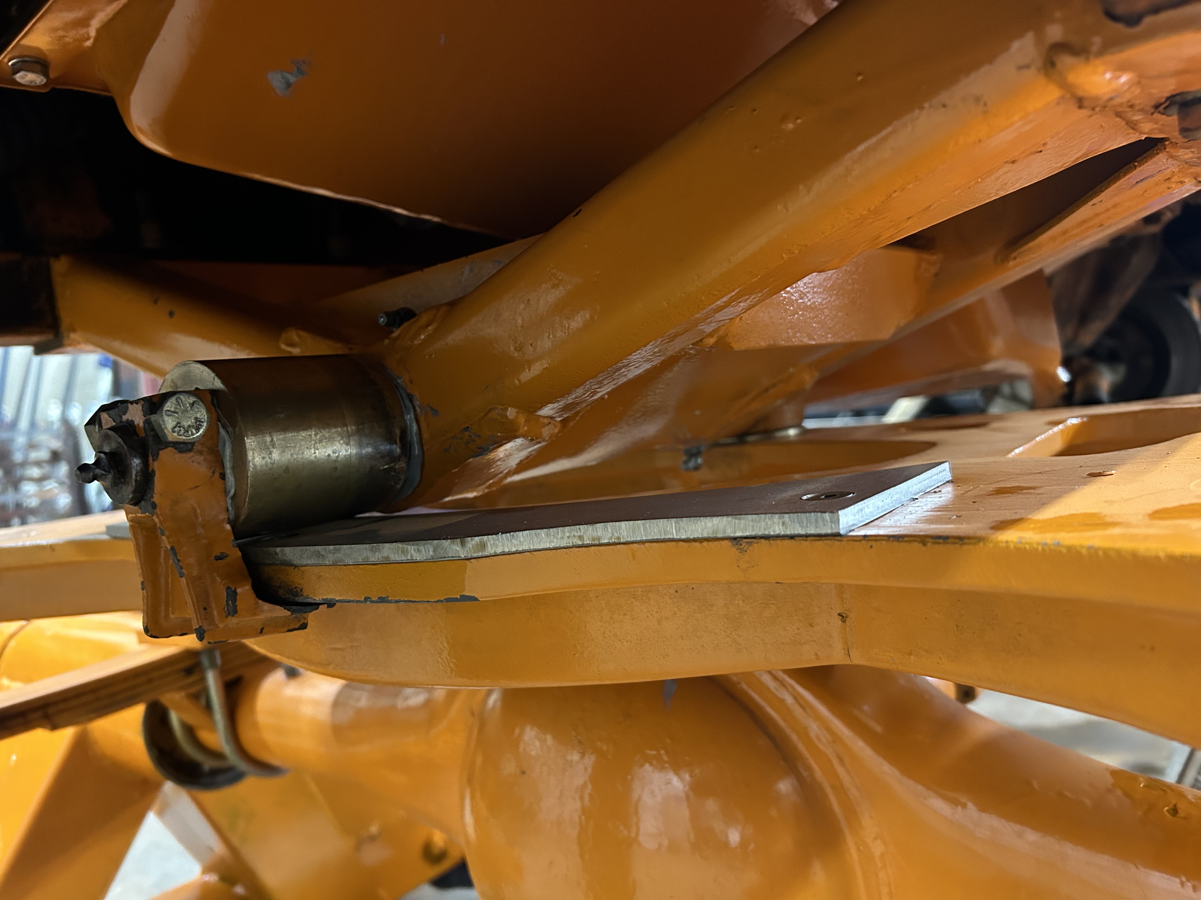

Found some cracking on the newer carrier adjuster stop. Newer carrier has this additional support hoop. Not sure if OE or afterhacket but can’t hurt so adding one to match?

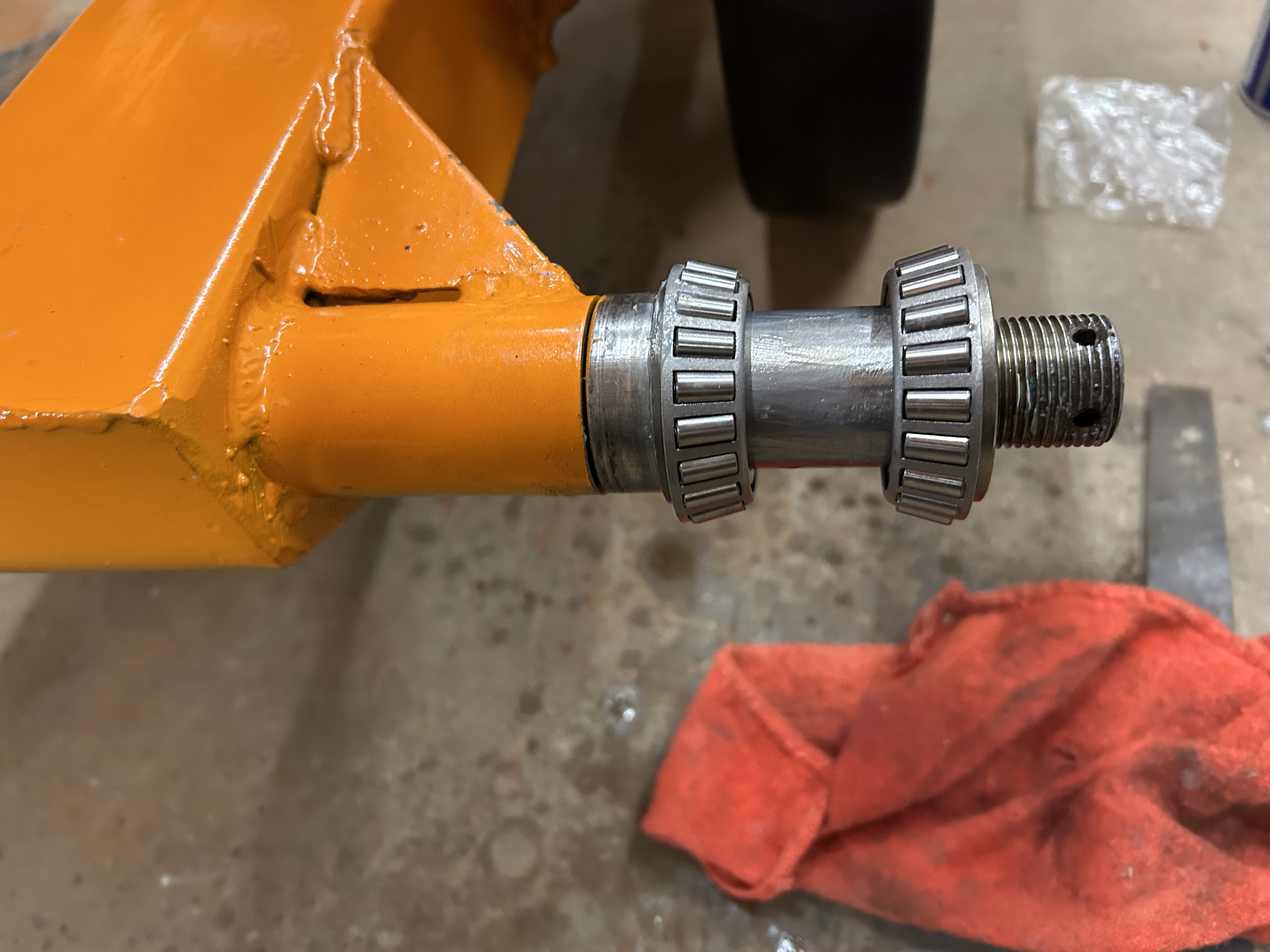

Had to hone the bearing id to get the bearings on this newer style shaft. Even got different brands of bearings. Wheel slide right off figured bearings were same didn’t check part numbers before discarding.
Tried many different bearings and brands. Some fit a little some not at all without force. Ran the brake cylinder hone and we are now good. Oddity….
Not an oddity. it should be an oddity though. I repaired a piece of equipment for OSU a few years ago. ALL from same supplier. found the ones that would go to the inner side, the others fit outside ok. I used several choice words. they had plastic seals, or I would have tried heat.
Welded the front adjusters and added the updated hoop support and repainted. Treated the adjuster tubes to fluid film them a lubriplate massage.

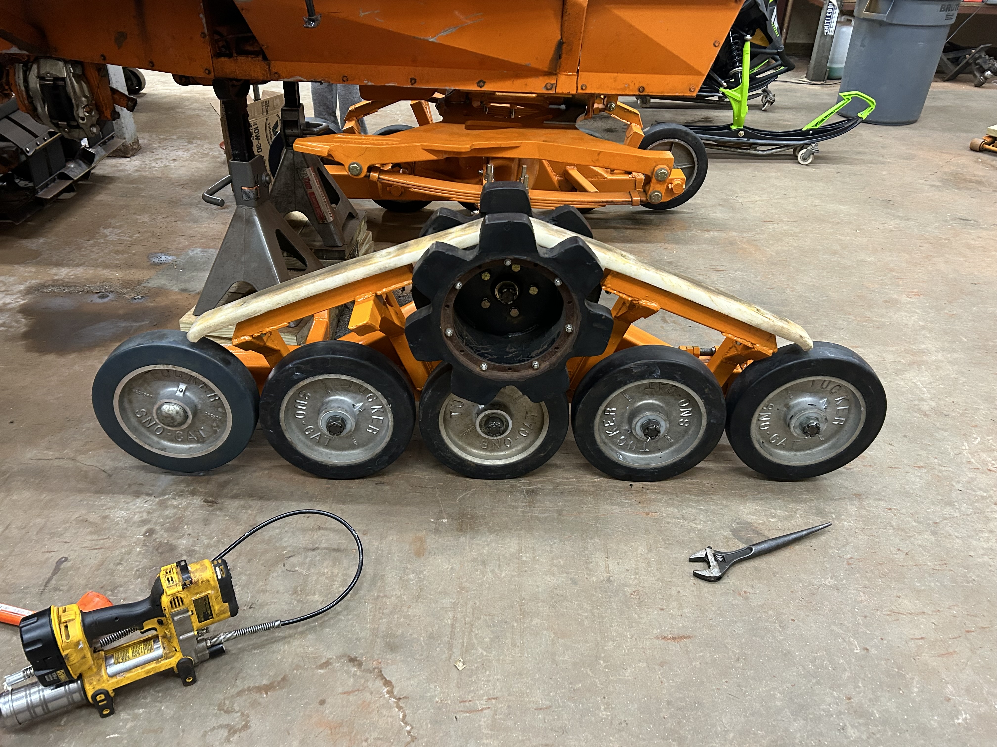

Front idlers all rebuilt. New races seals and bearings. Full lubripate treatment. Carriers greased.
Swapped sprockets to extend wear and upgraded the hardware on the sliders.
New cross joints, front diff fluid, and table alignment and we are sno ready.

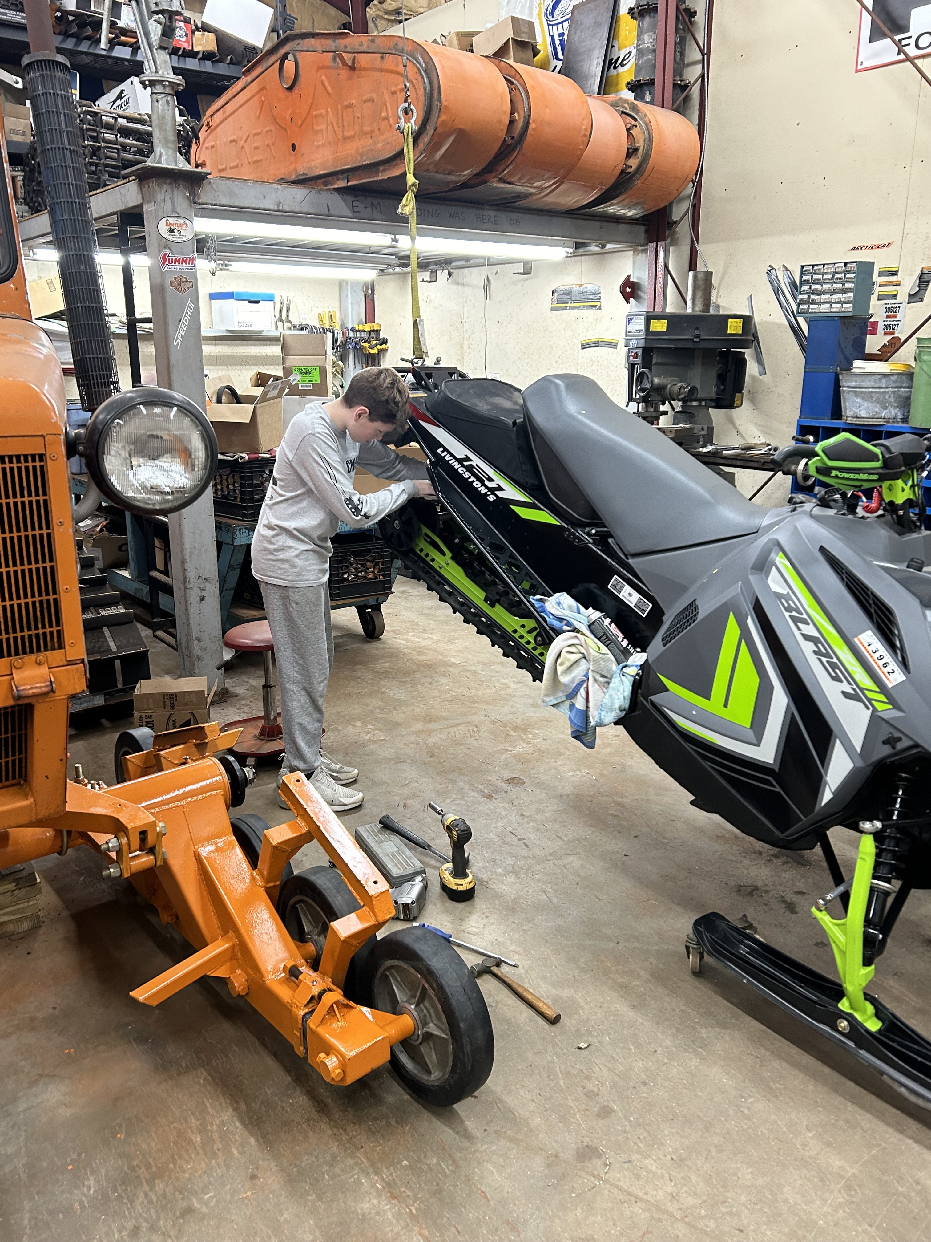

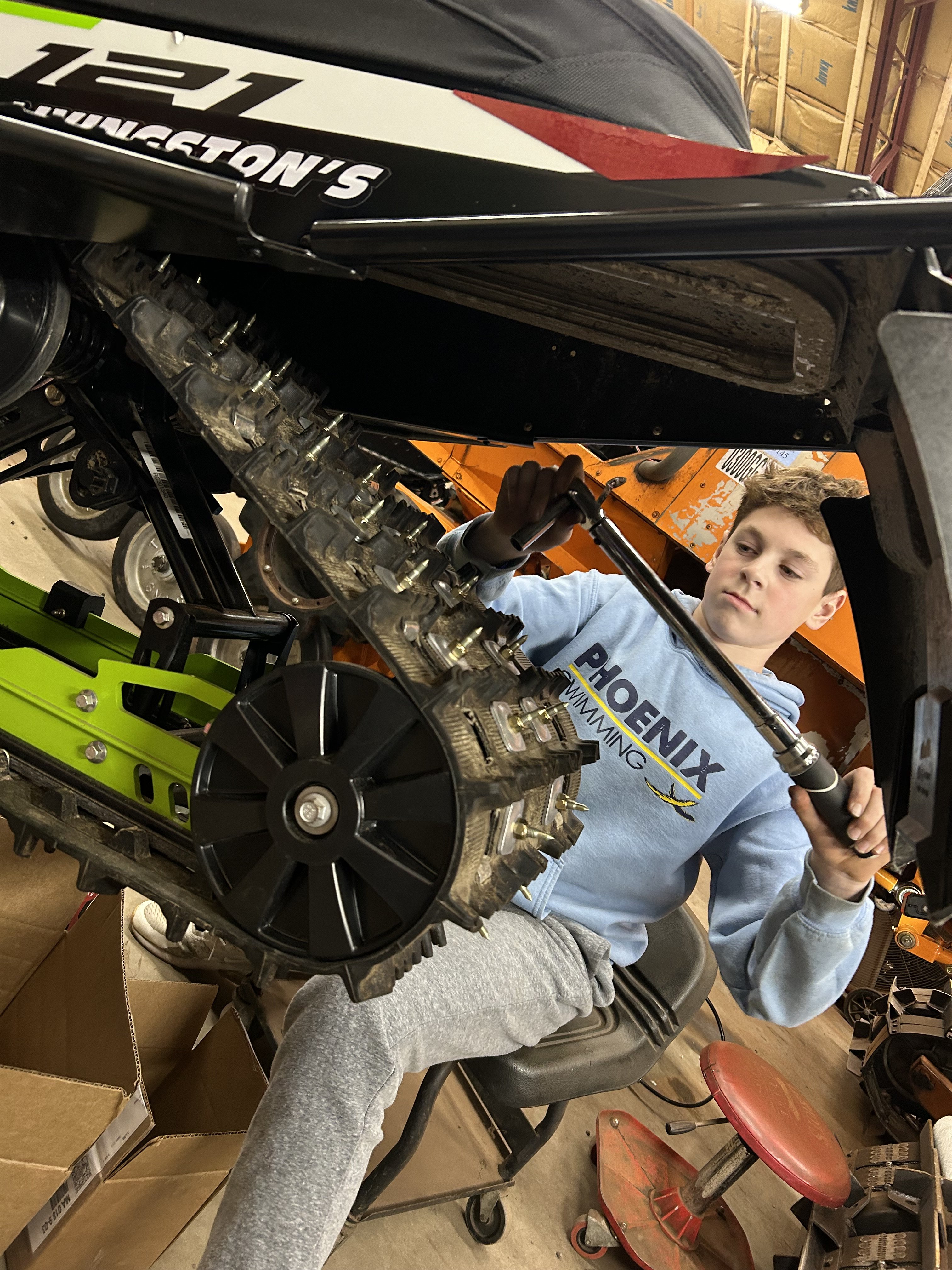

Single tracks moving in. JR learning then joys of adding studs to a sled. First question was “is this rigging safe to be under”?

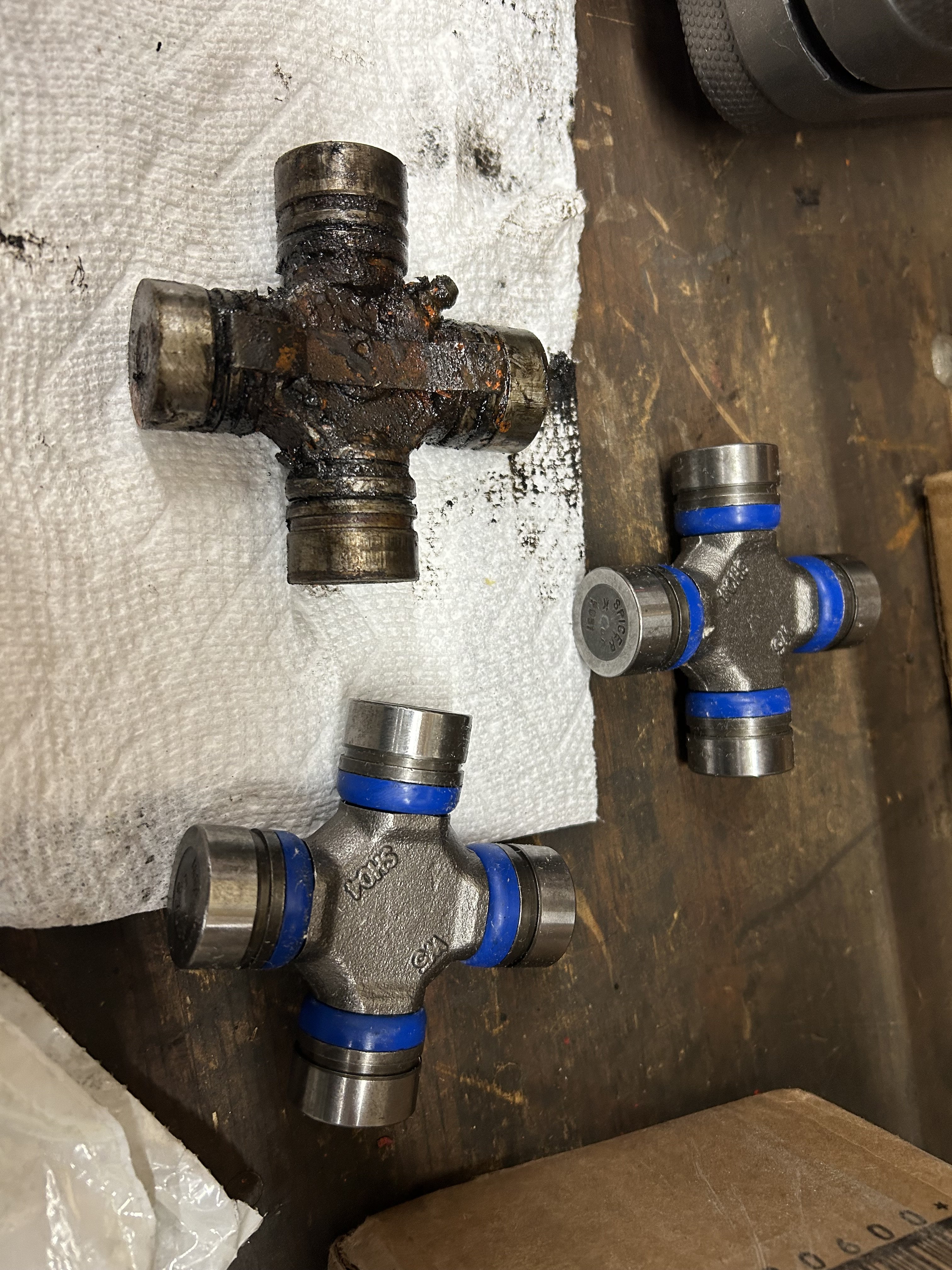

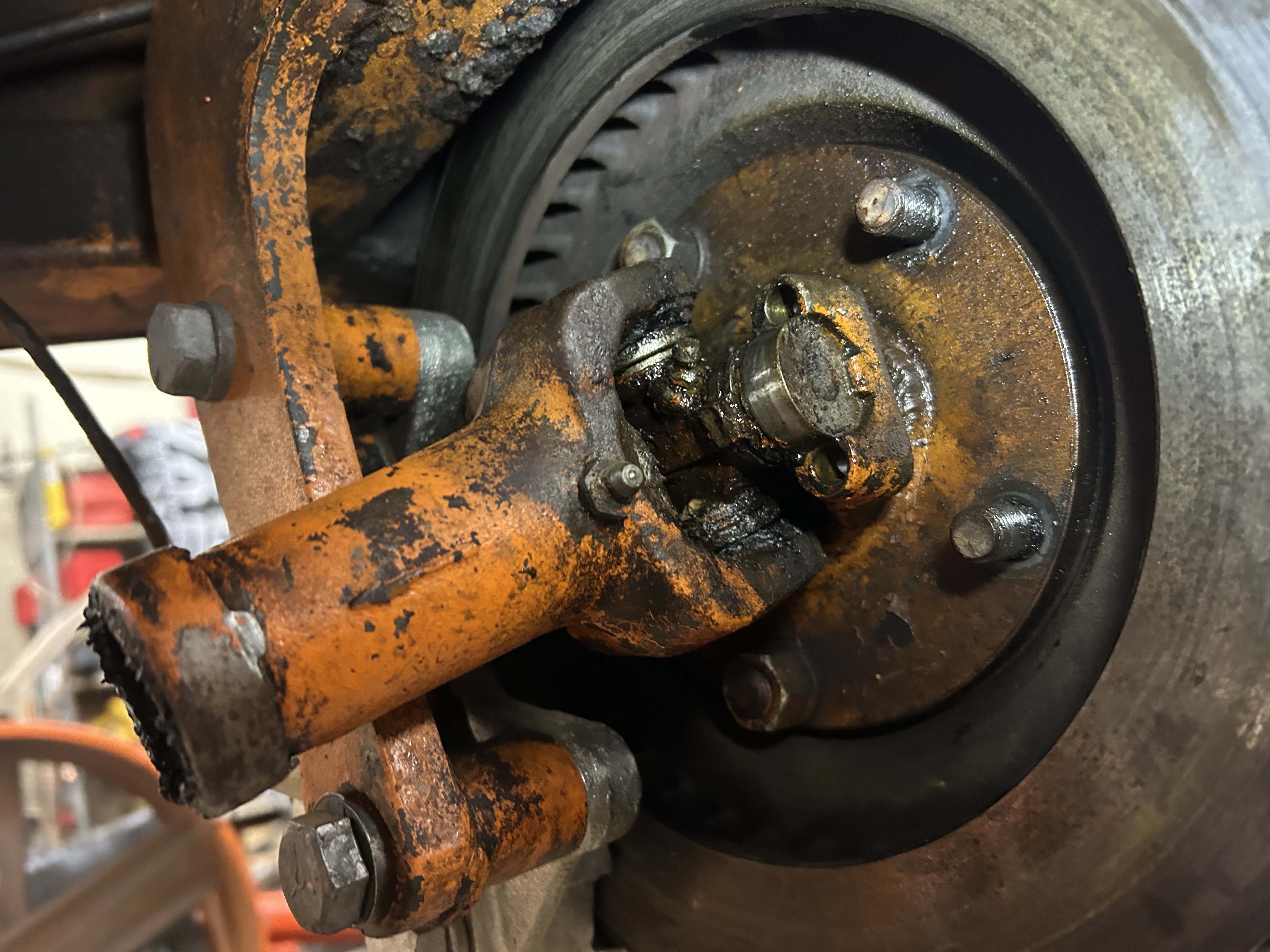

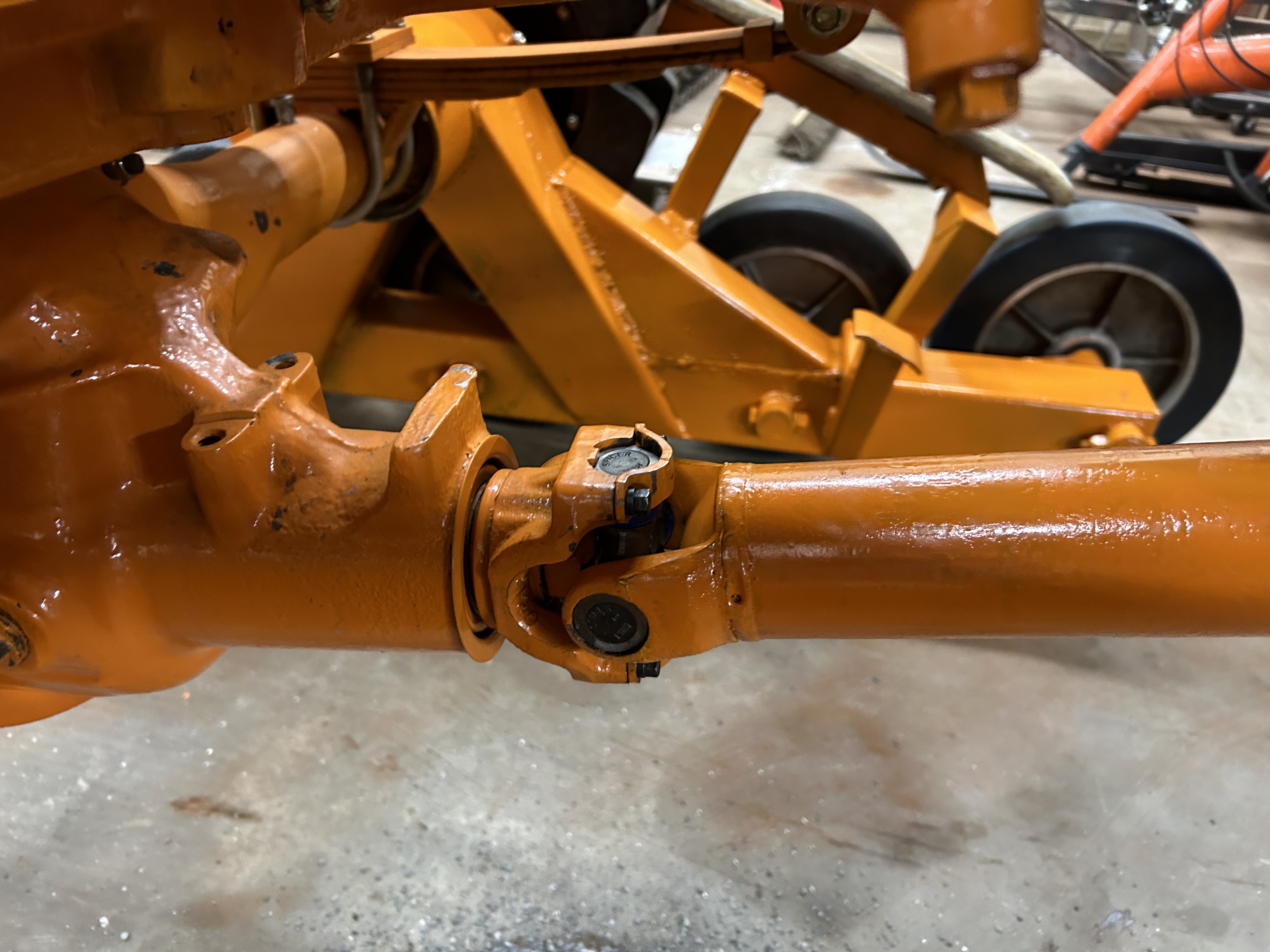

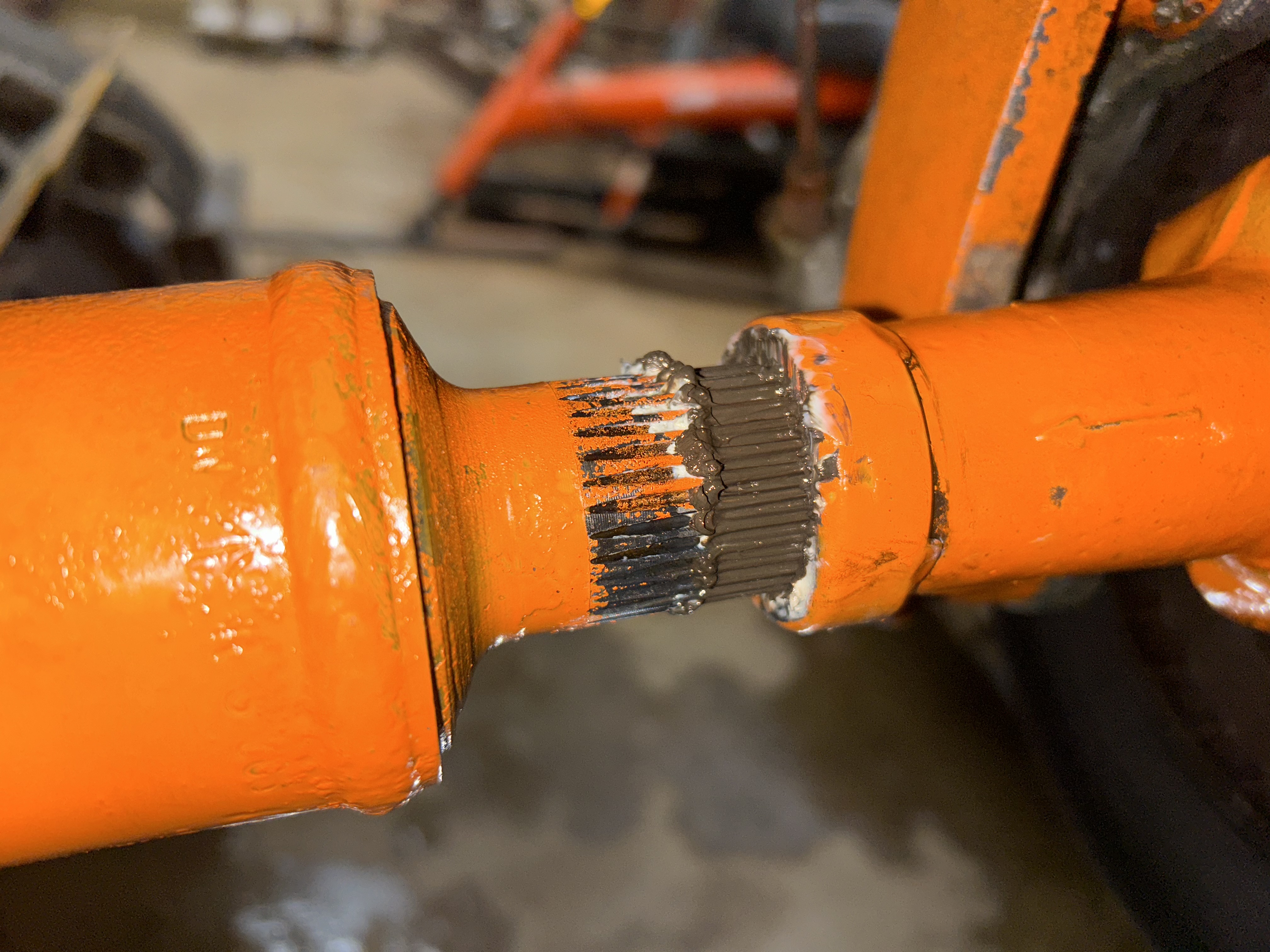

Filled front diff and removed the upper front drive shaft yoke. Tight tolerance needed to remove some other bolts.
All cleaned up and laying paint in prep for new ujoints.

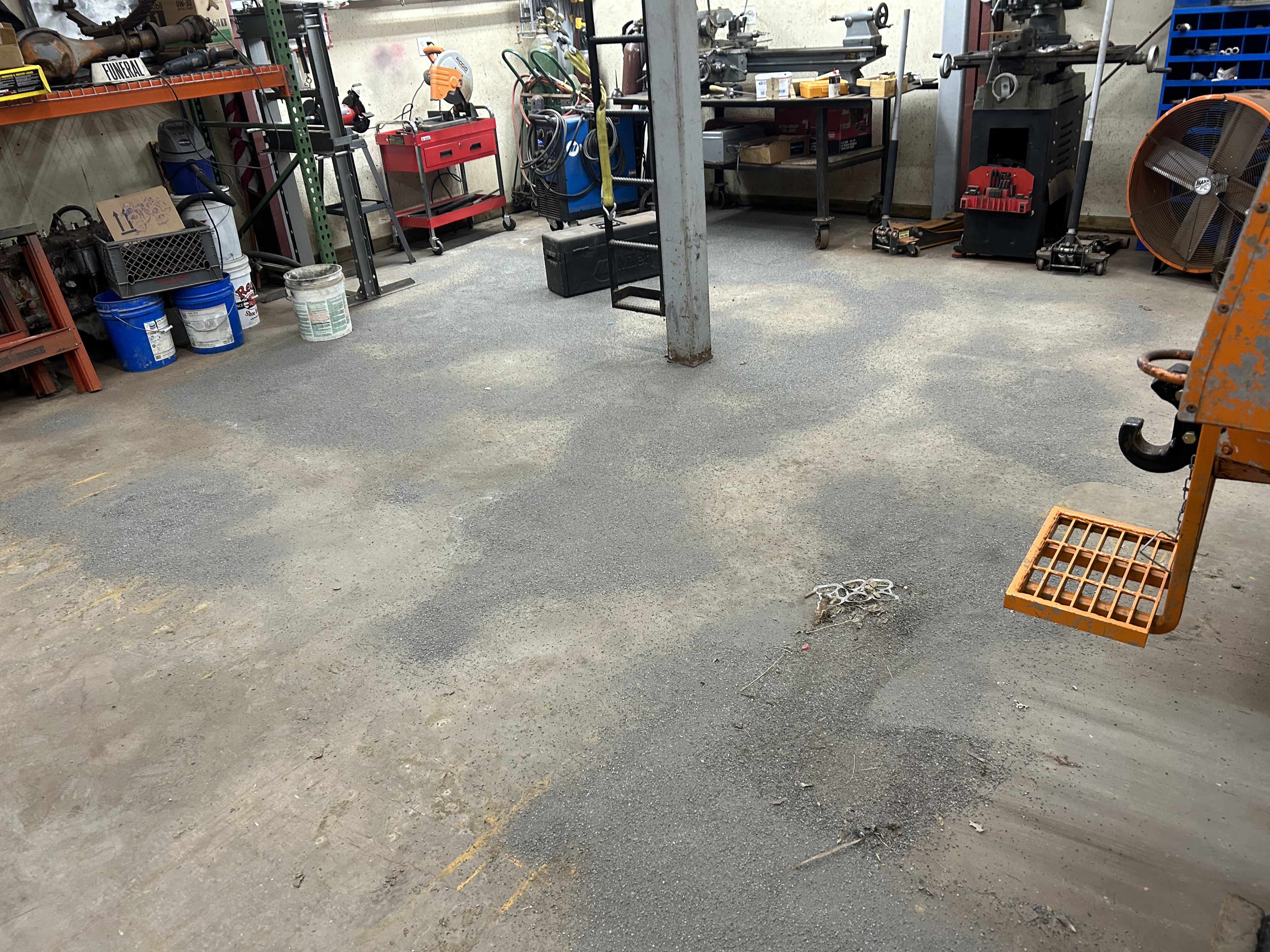

Changed the fluids in transfer case, transmission, rear diff. Got more on the ground than in the machine.
Should have used a marine oil extraction pump to fill. Next time!

View attachment 172284View attachment 172285View attachment 172286View attachment 172287View attachment 172288View attachment 172289View attachment 172290Filled front diff and removed the upper front drive shaft yoke. Tight tolerance needed to remove some other bolts.
Single tracks migrating in and looks like Santa came early for one of us!

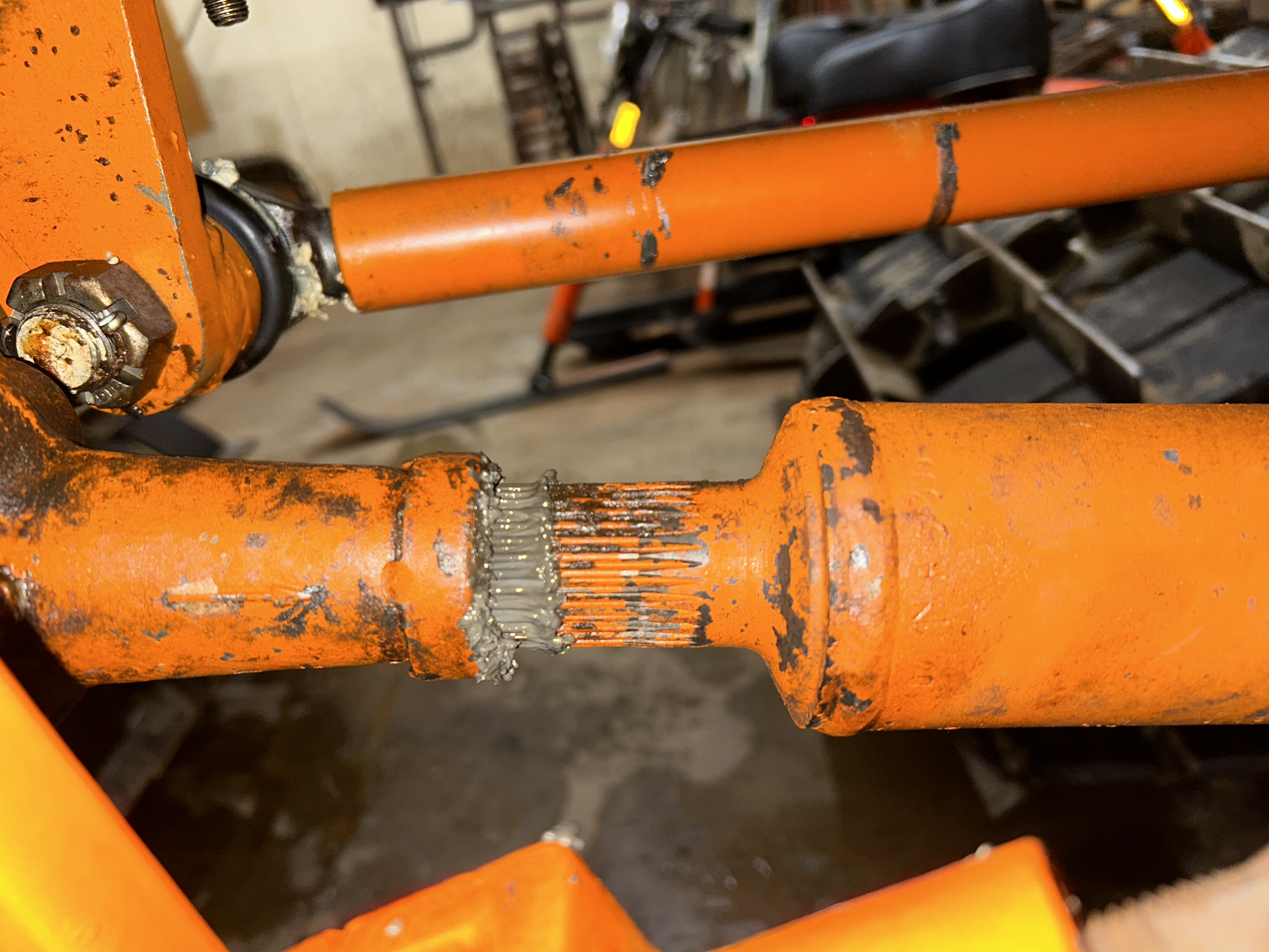

Be sure to time the driveline when you put it back together.
Didn’t know Marty. Was in an article with him few years ago. We knew about each other from the cat connection but never direct meeting.
A great story still in the works and I hope to serve his legacy well.l!
Never gave driveline phase a thought or know that was a thing but did see an arrow on one. Will be a Tucker phase expert soon I guess. Thanks for the wisdom!
Great visiting with winter. Arc was loaded just before the flood rains this evening:(
Thanks sno drifter for the tech tip. West coast advice is always though provoking and impactful.
Turns out there is and arrow on each side and definitely were not aligned.
Took the driveshafts off and aligned the arrows and reinstalled. These rubber tracks vibrate so much be curious to see how it works.
