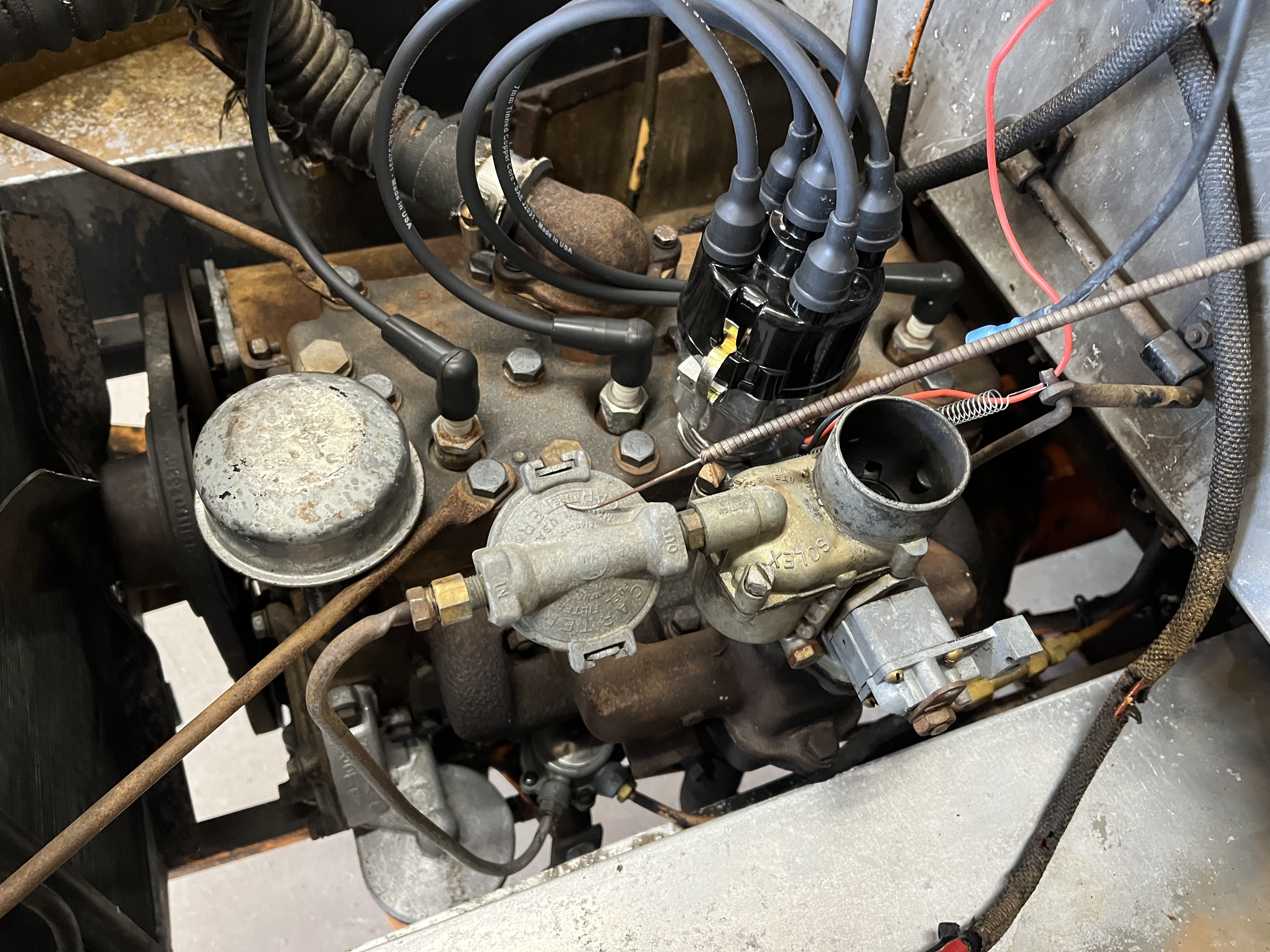

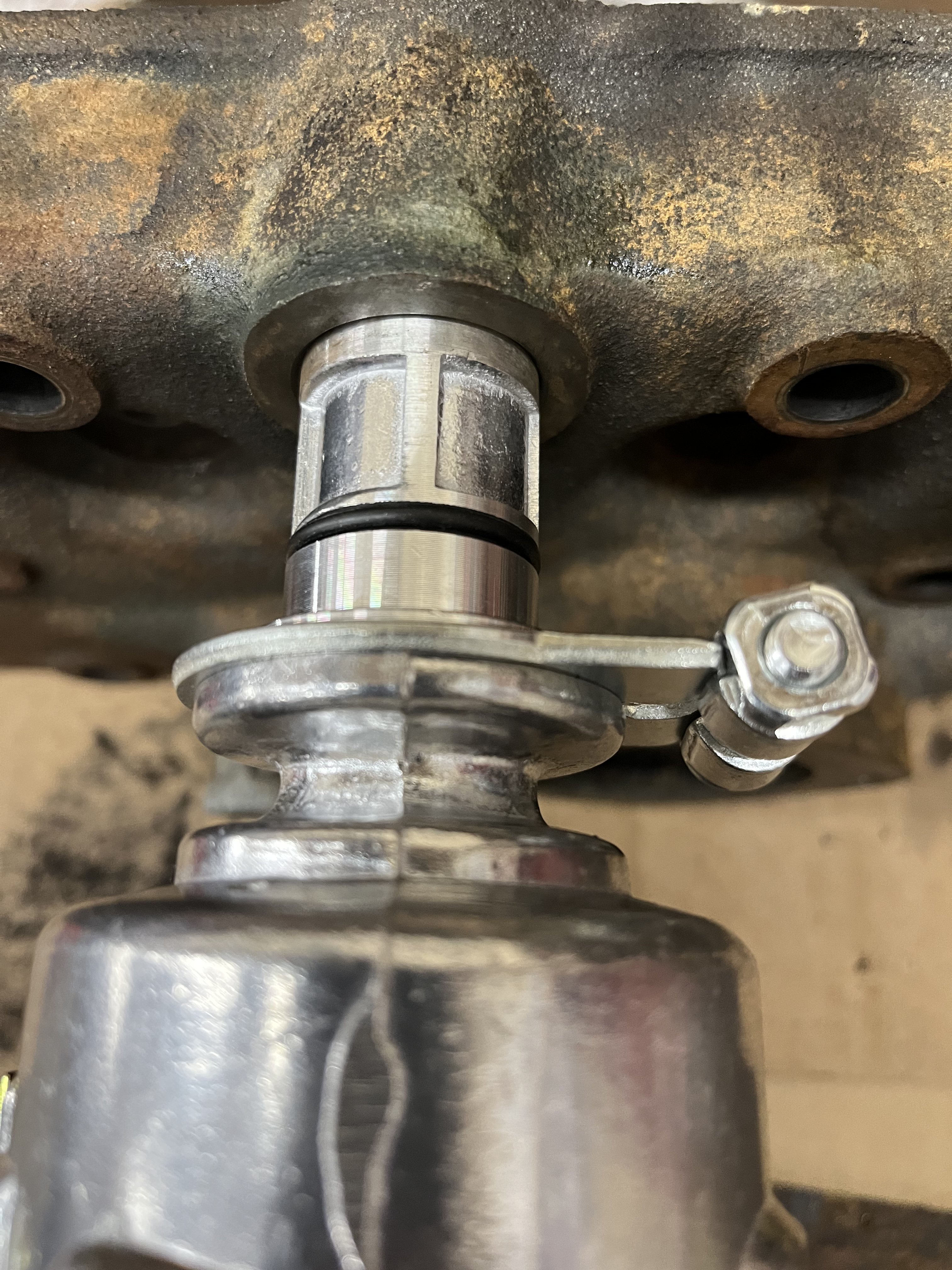

Really happy with this aftermarket distributor.
Plan is to keep this as original as it came out of the barn so the stock distributor will be addressed in the future.
I will say this aftermarket solution has some upside. Less body shaft surface to bind, and oring to lock out moisture from above. What’s interesting is the manual states to make sure a vent slot is cut into the head. Thought it was and errant screwdriver mark but intentional.
Had to polish the head bore for a smooth fit. Final assembly requires a high temp synthetic waterproof grease smeared on the body.
There is also a starting point indicator mark on the head and a pointer on the distributor.

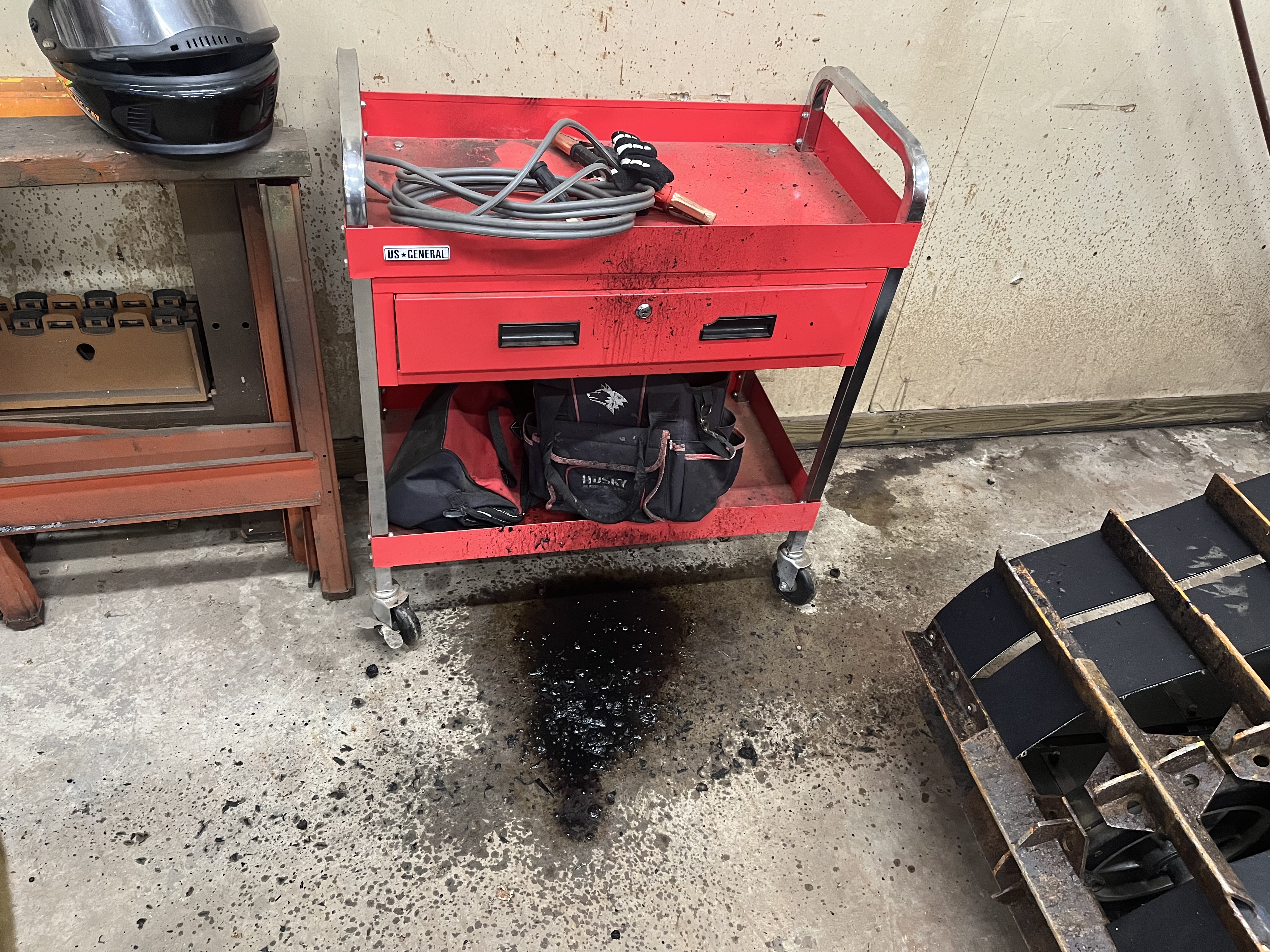

Now prepping for reassembly. First order of business was how do I get the oil out of the intake pathway? I could see the level was high when the valve opened.
The respiratory therapist kicked in and I called for tracheal suction!
Got 100cc out and was able to drain the blind holes. Rest should blow out and I’m sure their is that much in the exhaust.

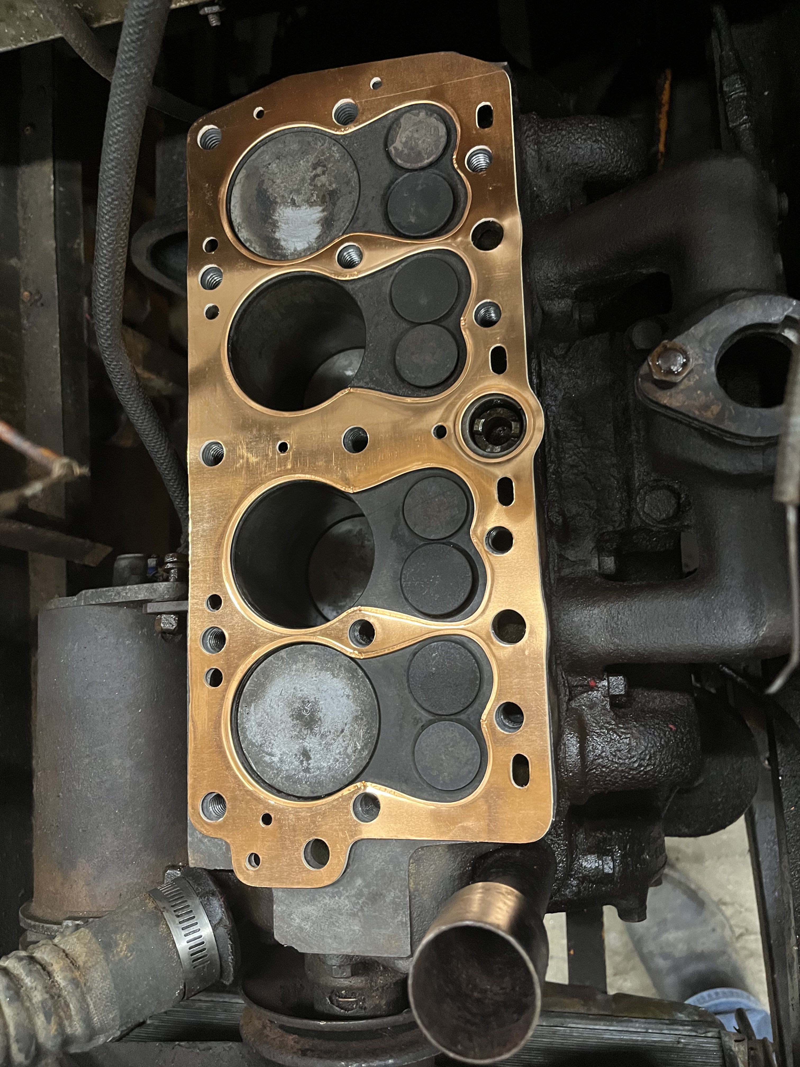

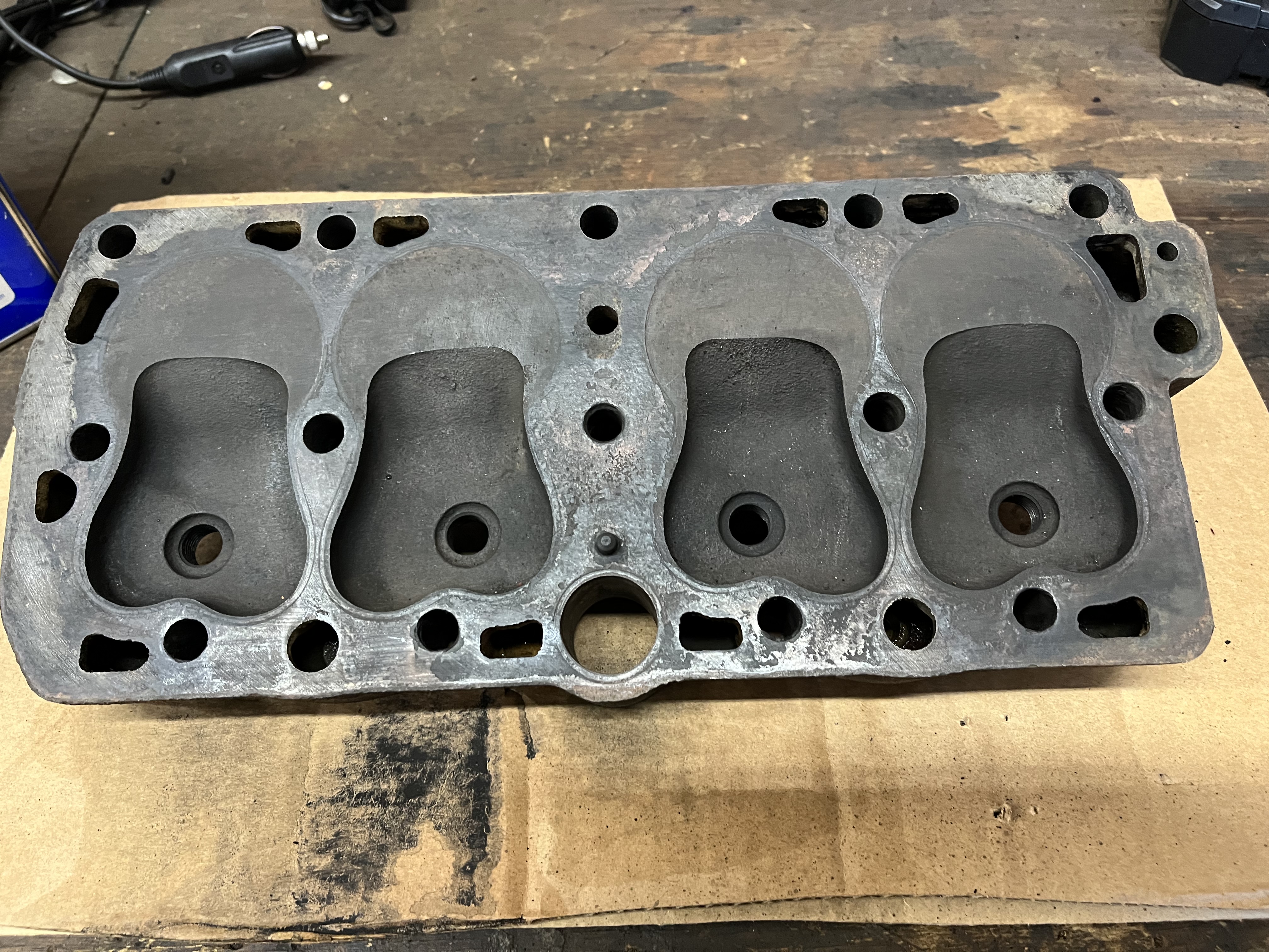

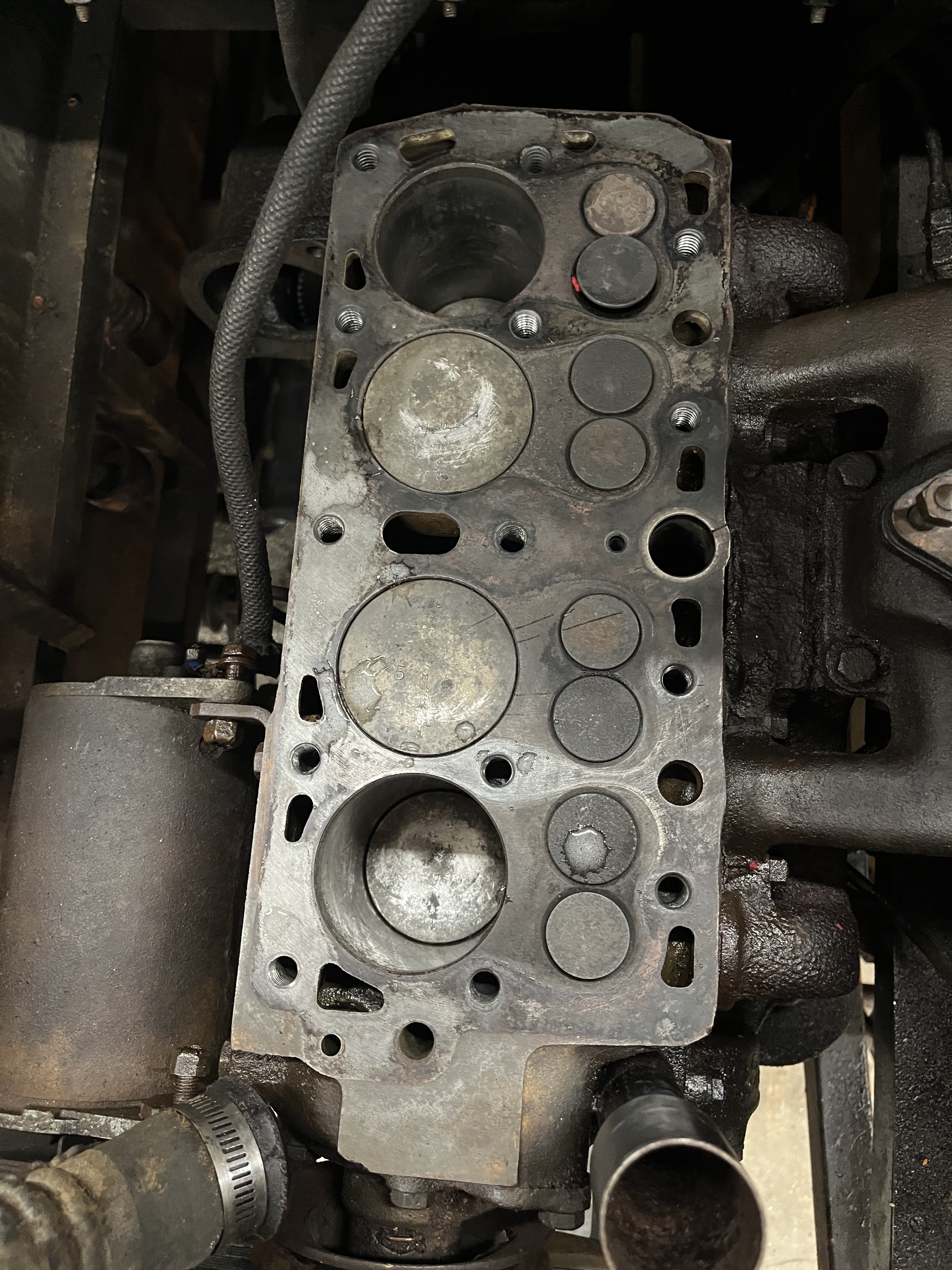

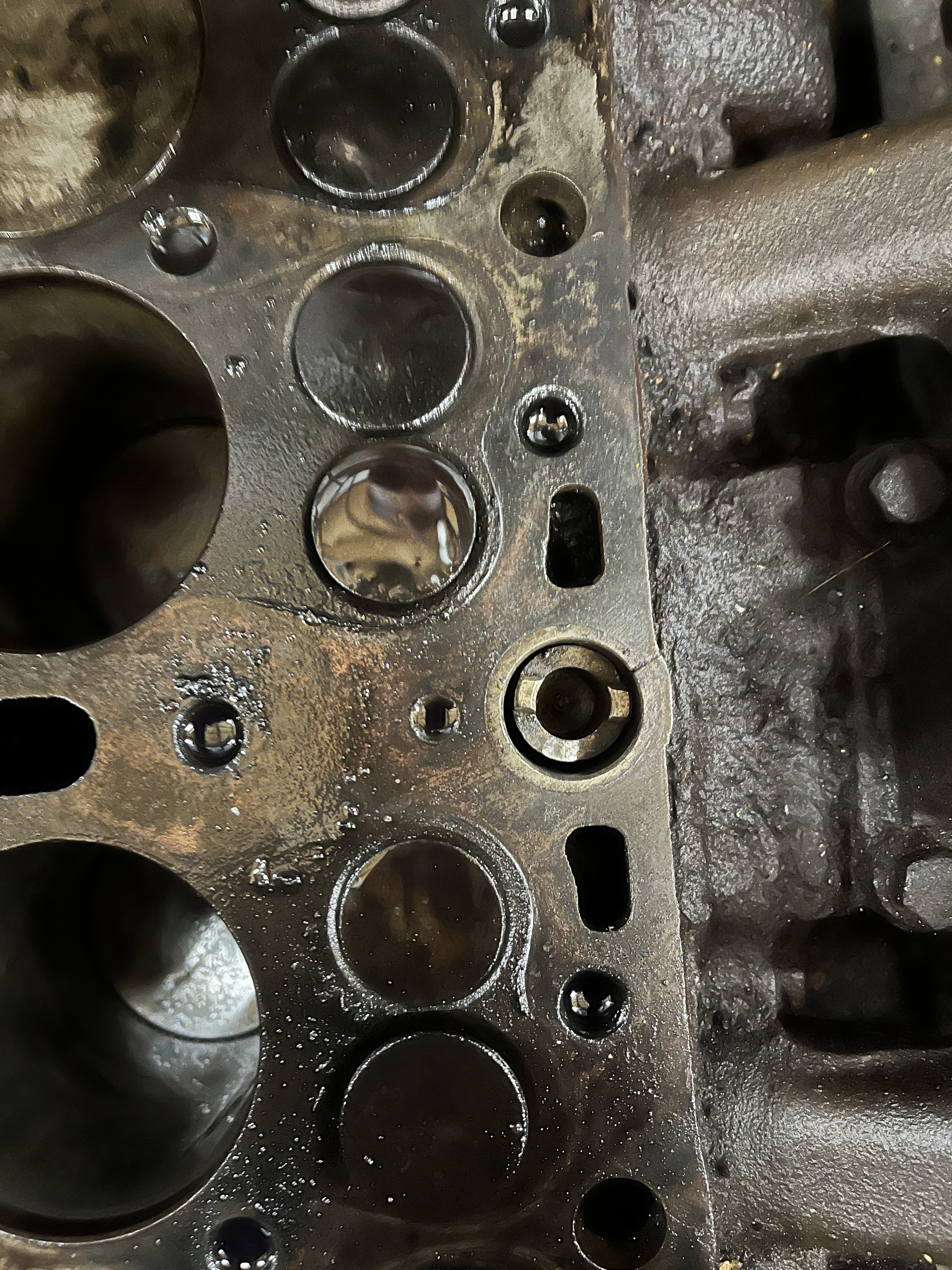

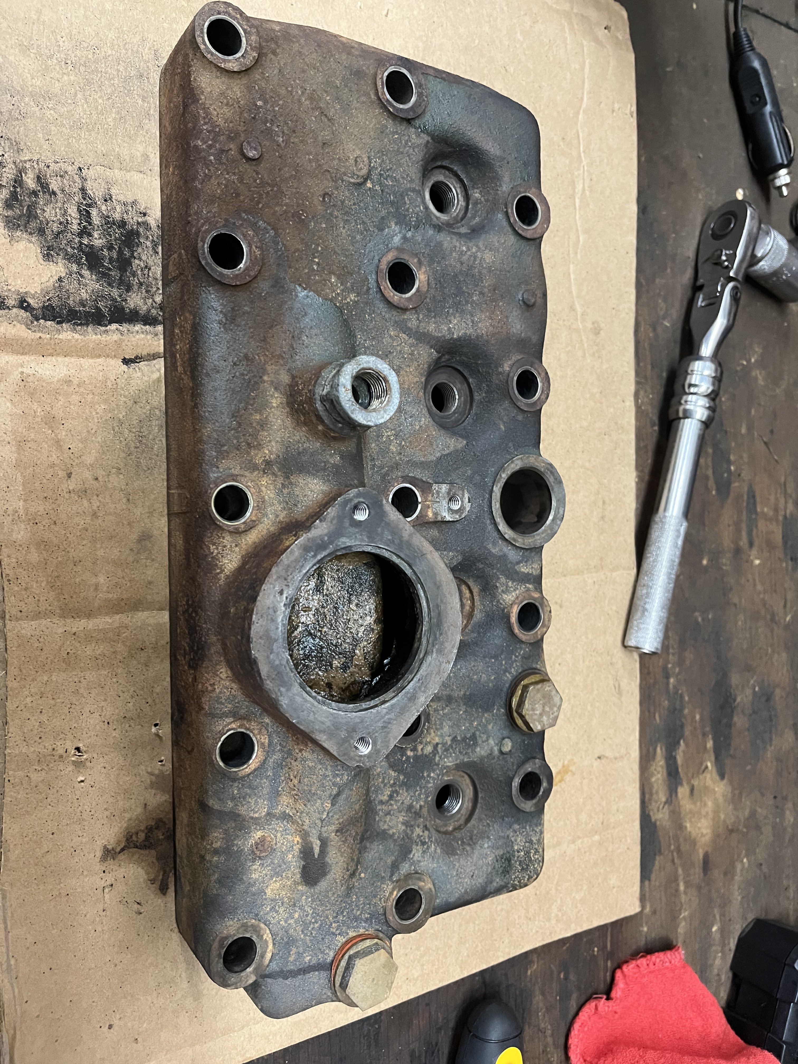

Head surface cleaned. Head bolt holes tapped and clean. Light coat of oil on the cylinder walls and head bolts.
Smooth side of the gasket goes down. Dowel pin centers then you loosely thread the bolts.
Distributor has to be installed and aligned prior to head torque. Have to use the stock indicator bracket. Little more static timing to check before torquing down tomorow.

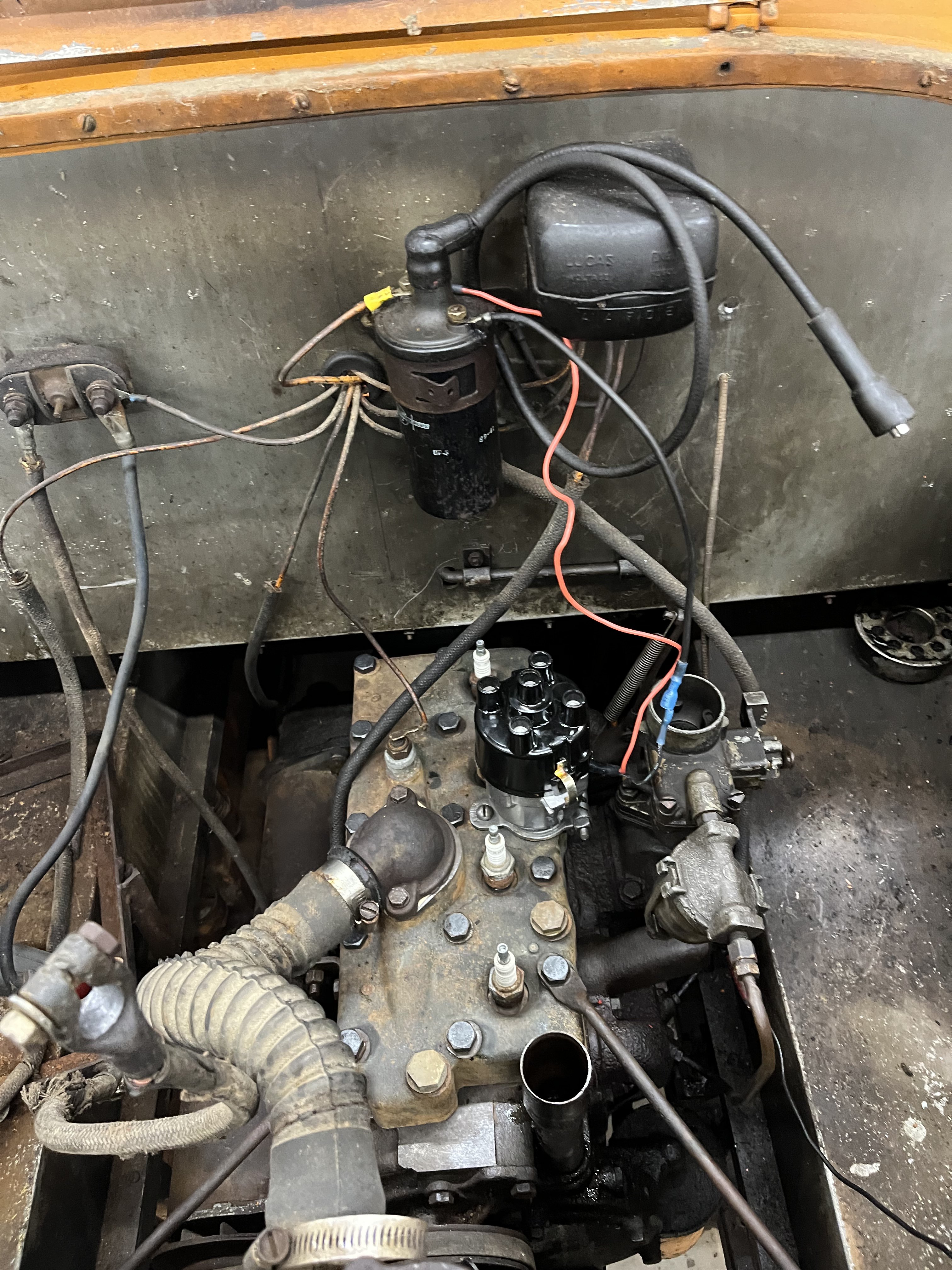

Major progress this weekend on the kitten! Now it’s officially a runner and moves under it’s own power.
Quick driveway test and the clutch gears steering all feels great!
Fresh 50w Valvoline VR1 racing oil with zinc and oil filter. Reused the plugs that were in it as I burn off the oil and everything else I soaked it with.
Drained out about 6 gallons of old gas. Was real clean and didn’t smell that bad. Must have been the good old stuff!
This pump called the Gas Tapper is a great tool. I recommend every shop have one. Refilled with 5 gallons ethanol free with a splash of stabil and some marvel mystery oil.

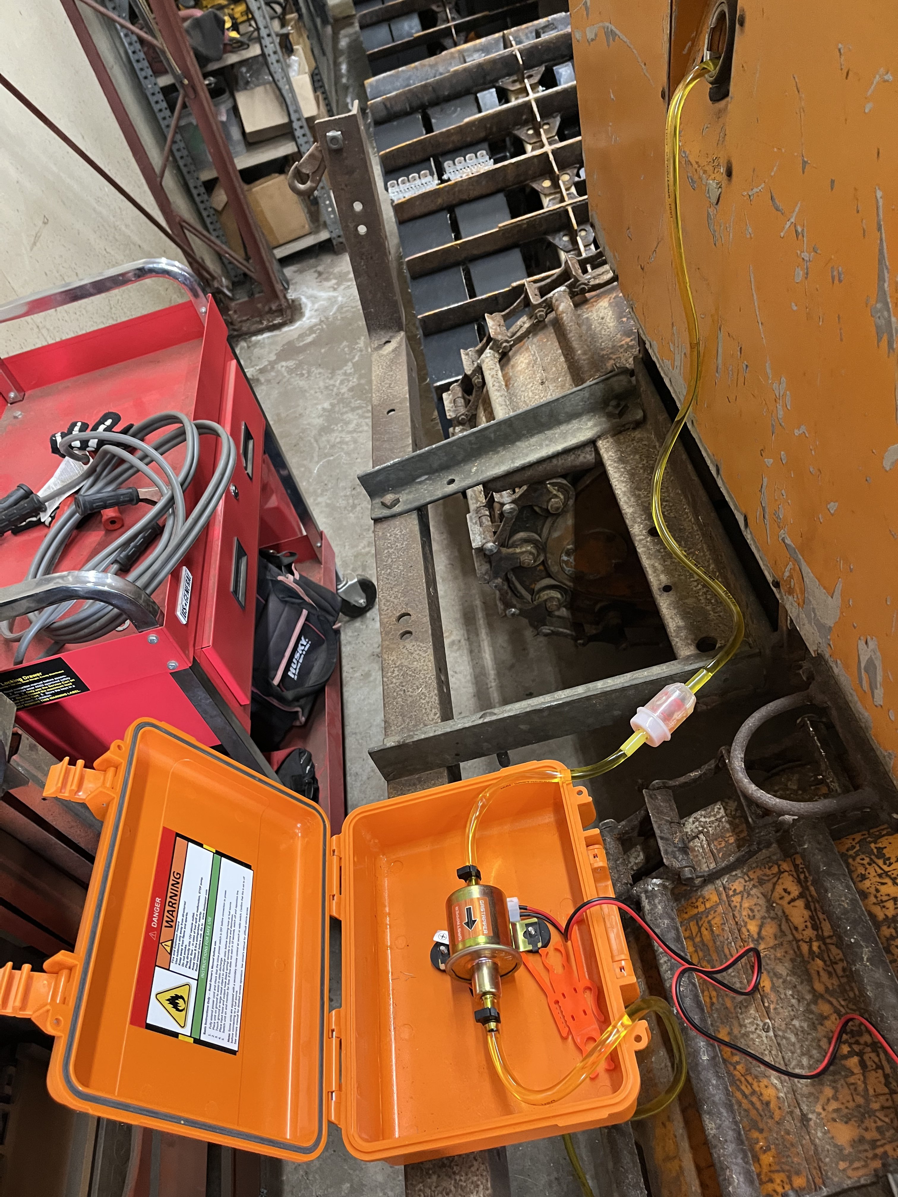

I didn’t want to change too many variables so the fuel pump, carb, and sediment bowl were used as they came off.
Used a photo tach to get the idle to around 600 rpm. After static timing the motor I dialed in the timing with the light per the manual. It says match the notch to the mark but the specs also say 5 degrees BTDC. Not sure if that at the mark but it runs good there for now.
The choke detent is missing so not totally sure of full off position Fuel system needs some more work and parts.

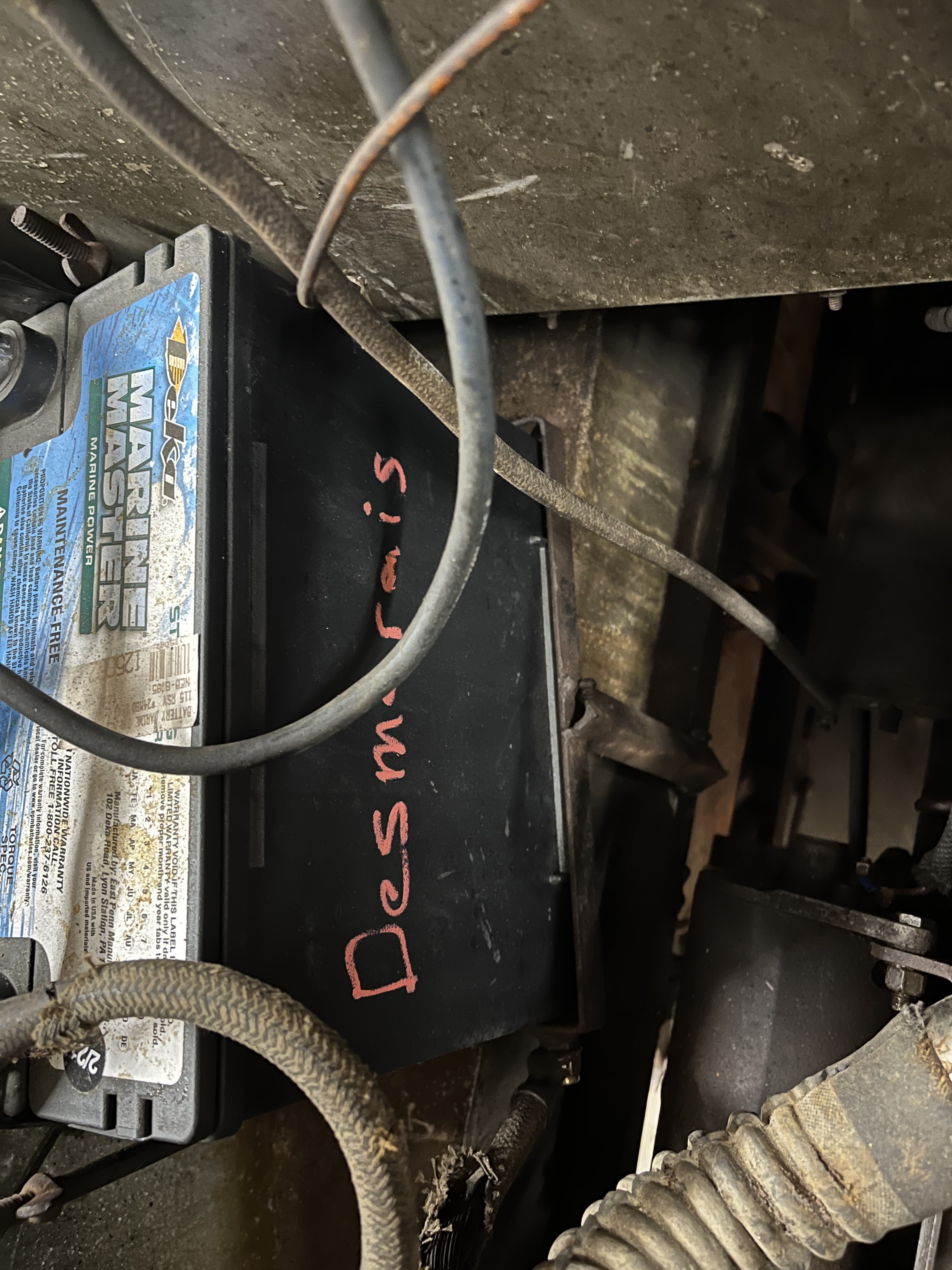

The battery tray weld was broken so the ground was moved to the radiator at some point. Welded and returned the ground to the correct position. The battery smashed around in life adding some character to the side panel.

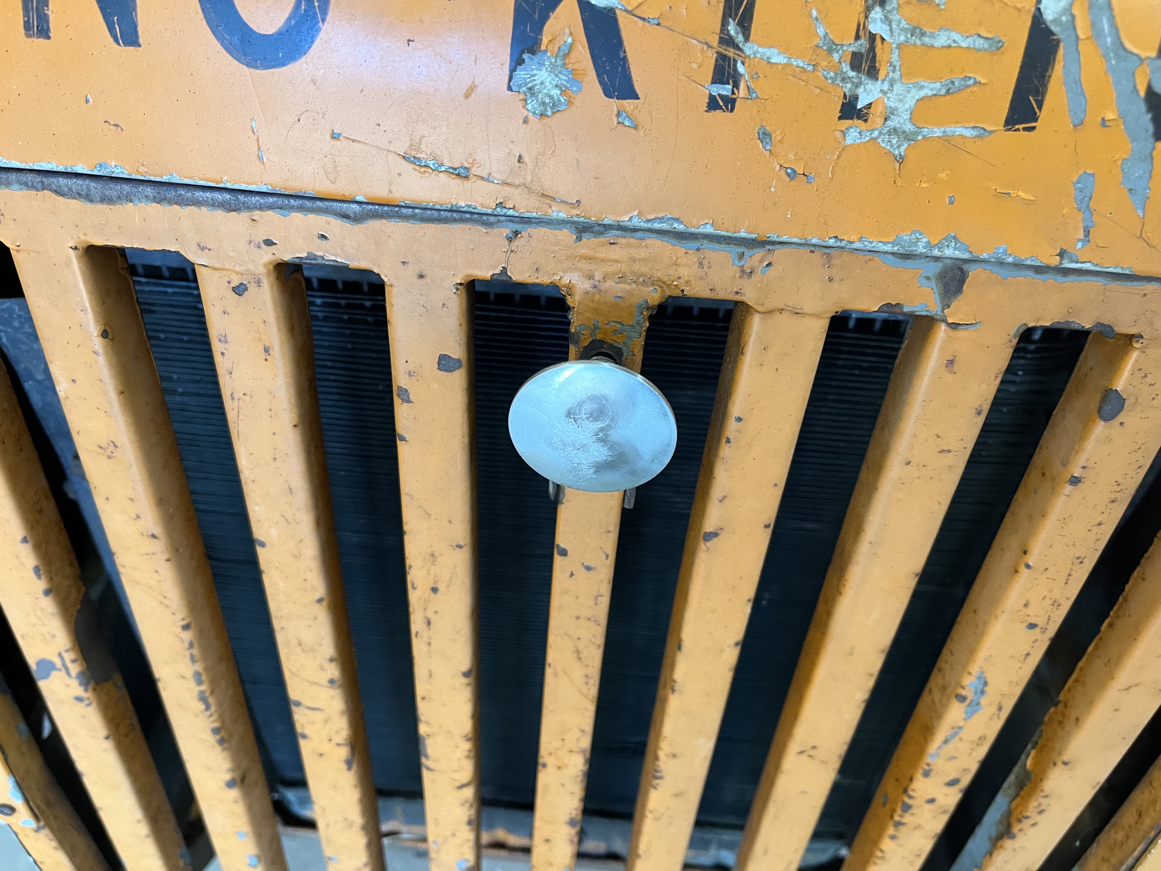

The NOS Chrysler freeze plug/hood button/gas pedal arrived.

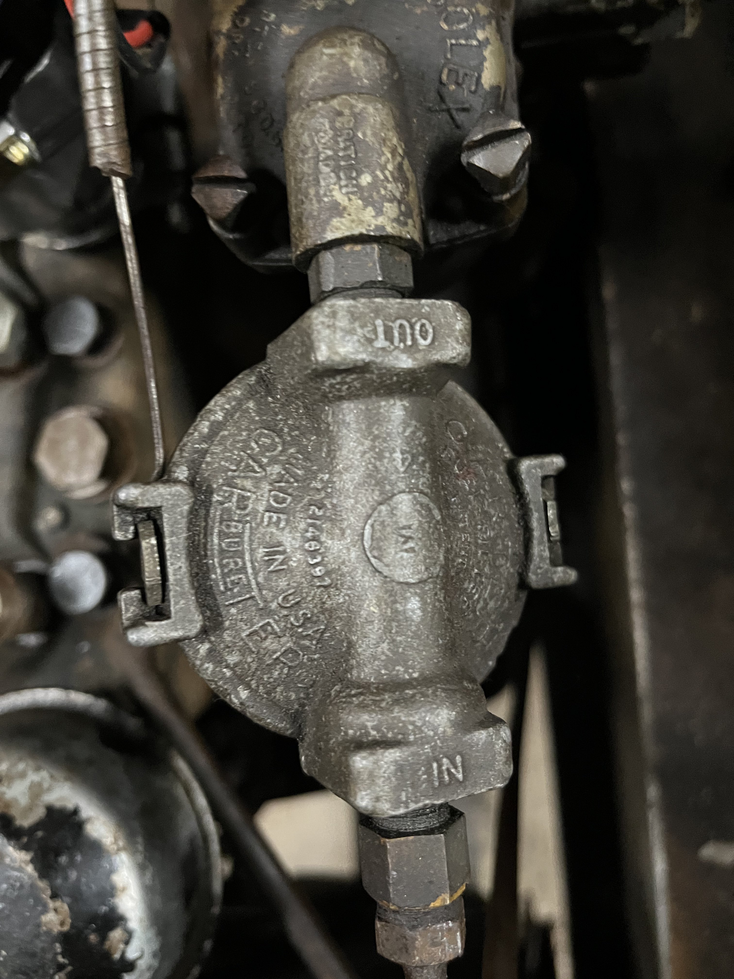

Temp plug wires need to be replaced as well as getting a new ceramic filter for the carter sediment bowl

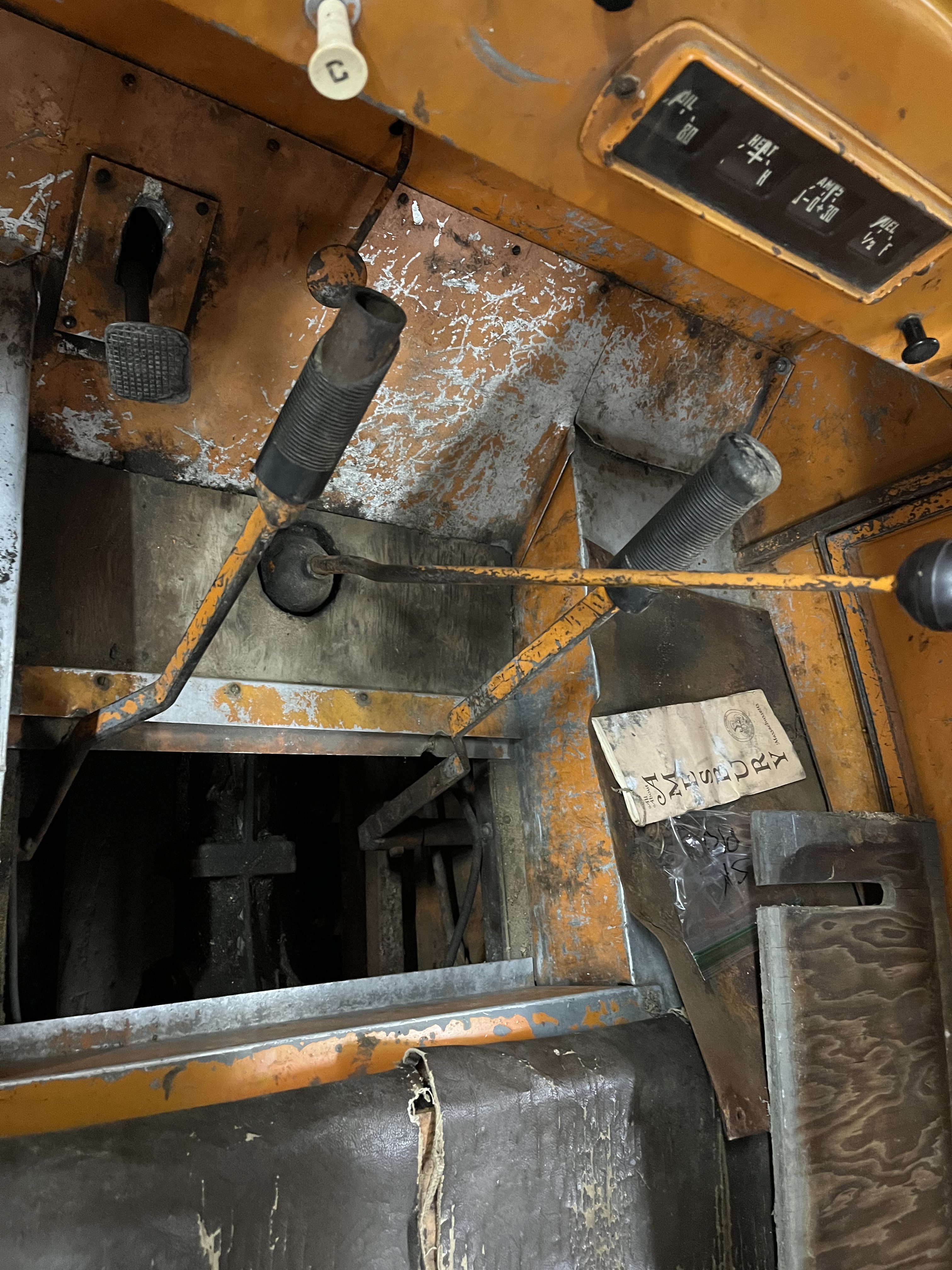

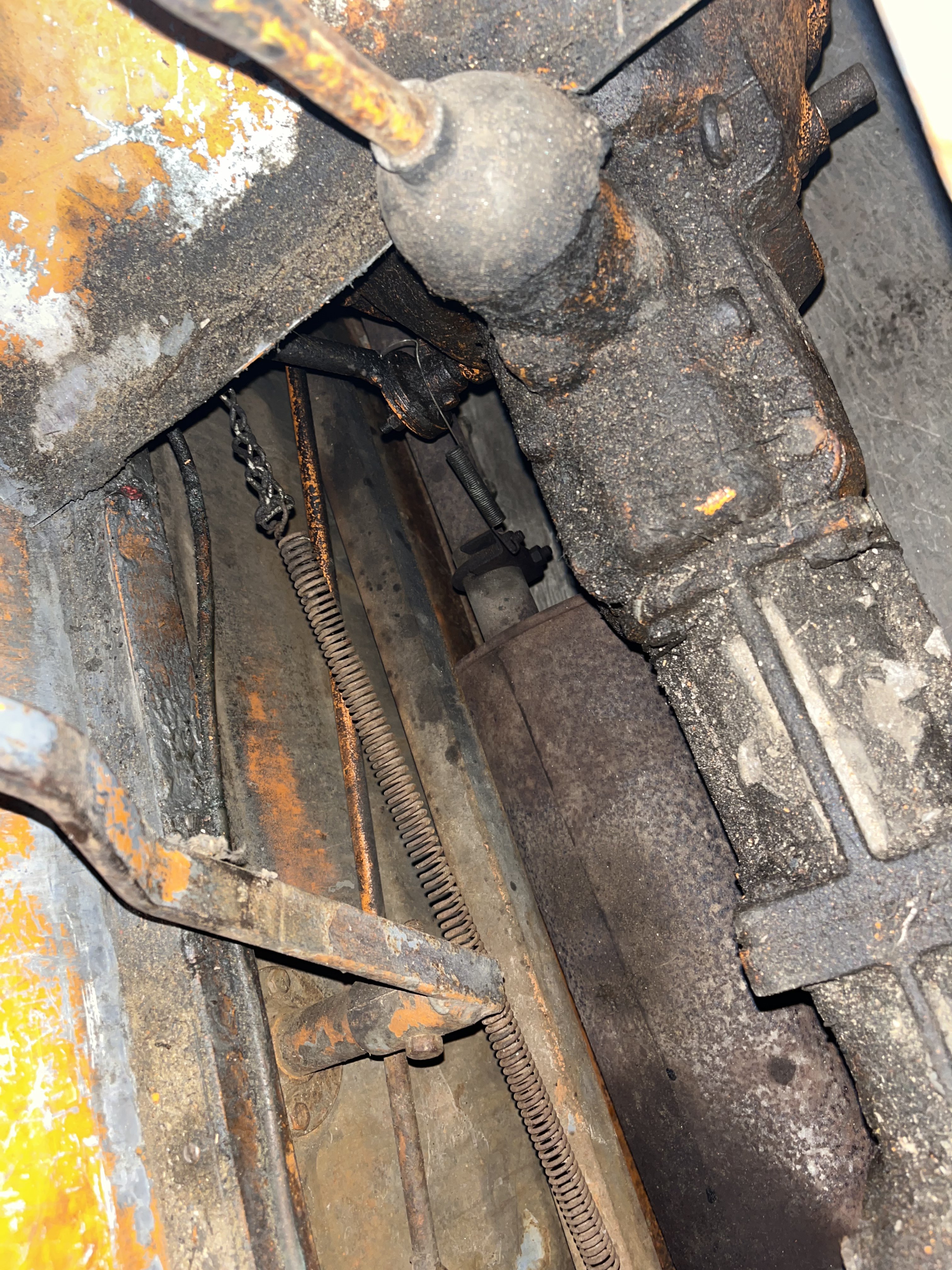

Took the floor up in prep for trans and rear end fluids. Clutch spring isn’t right need to fix that.

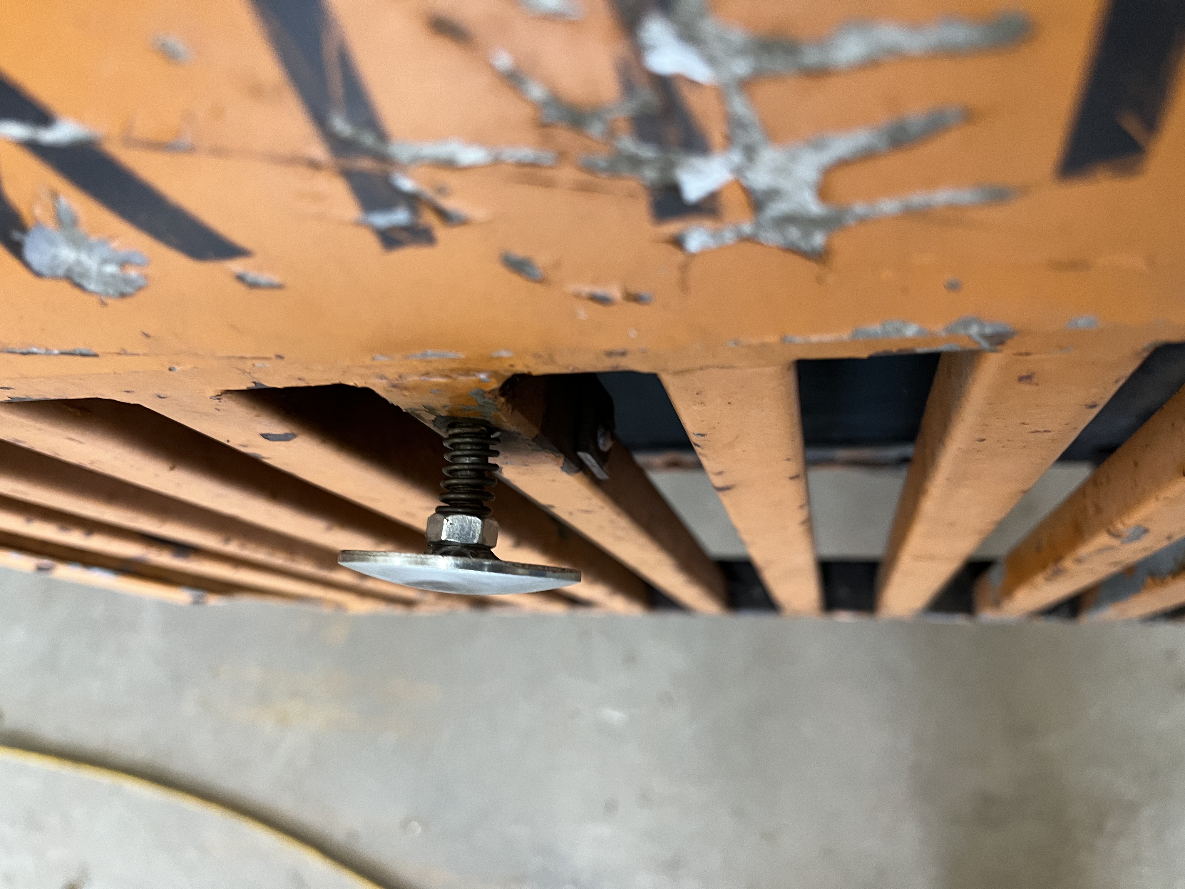

FYI those Frost plugs work really well on the backside of rollers that have rubbed or been over greased. When I first saw them I though you were fixing rollers.
