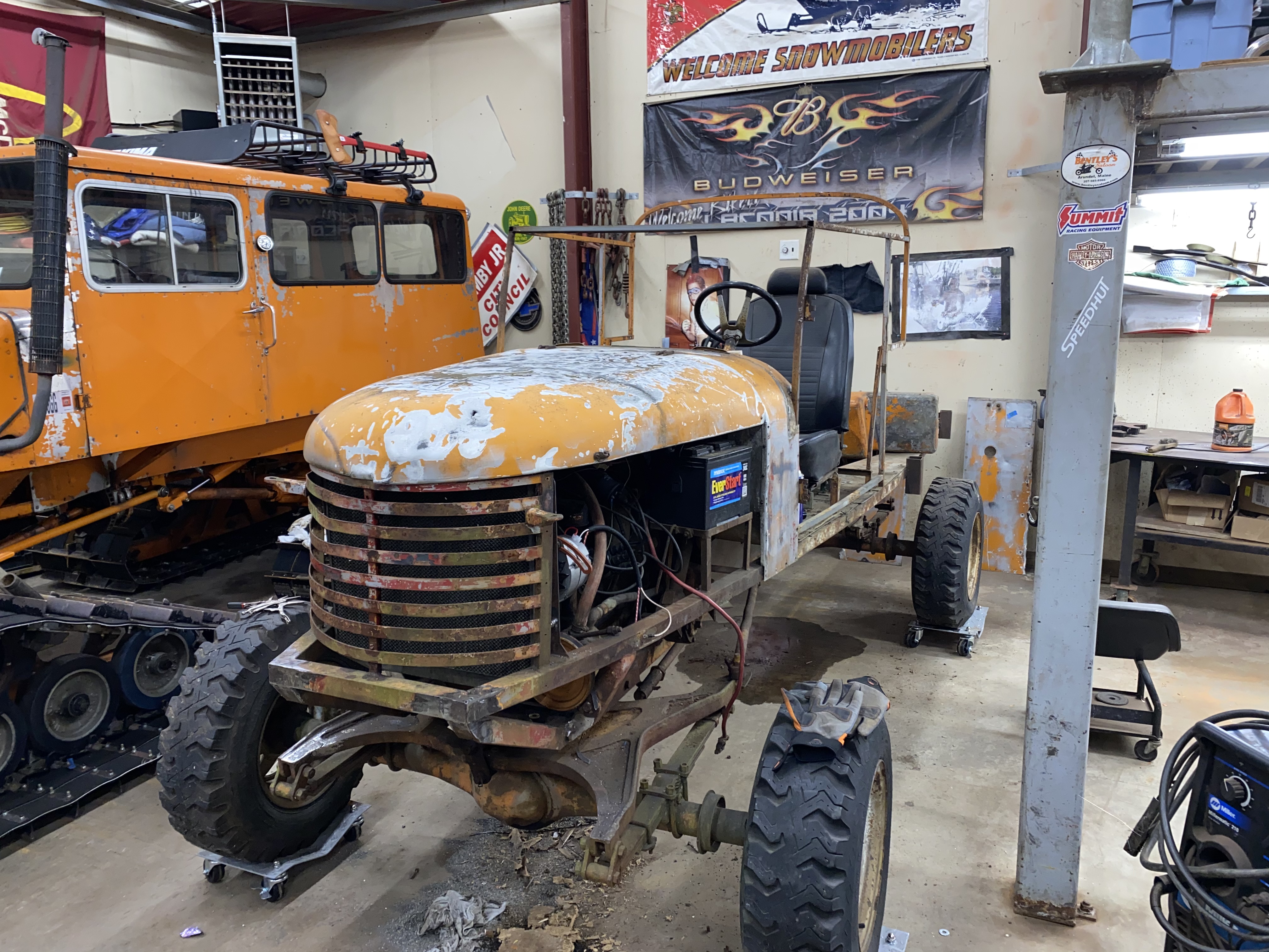

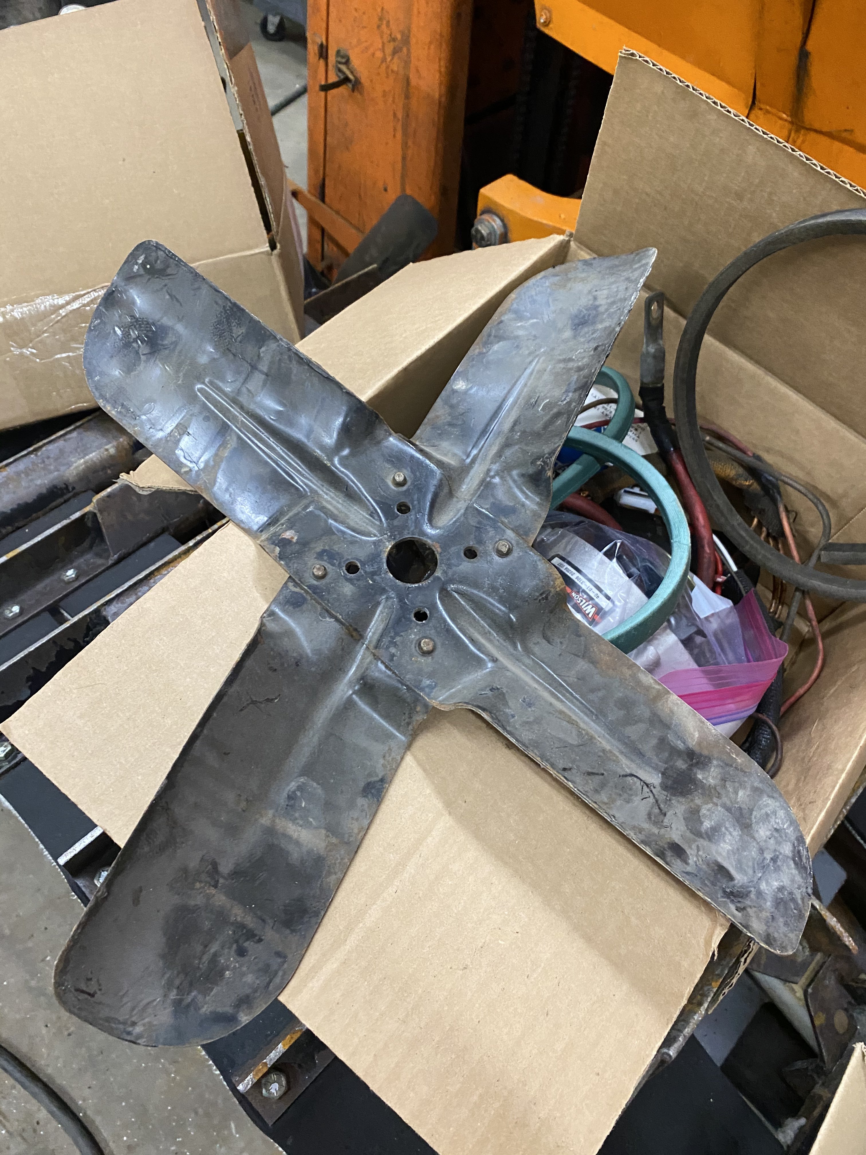

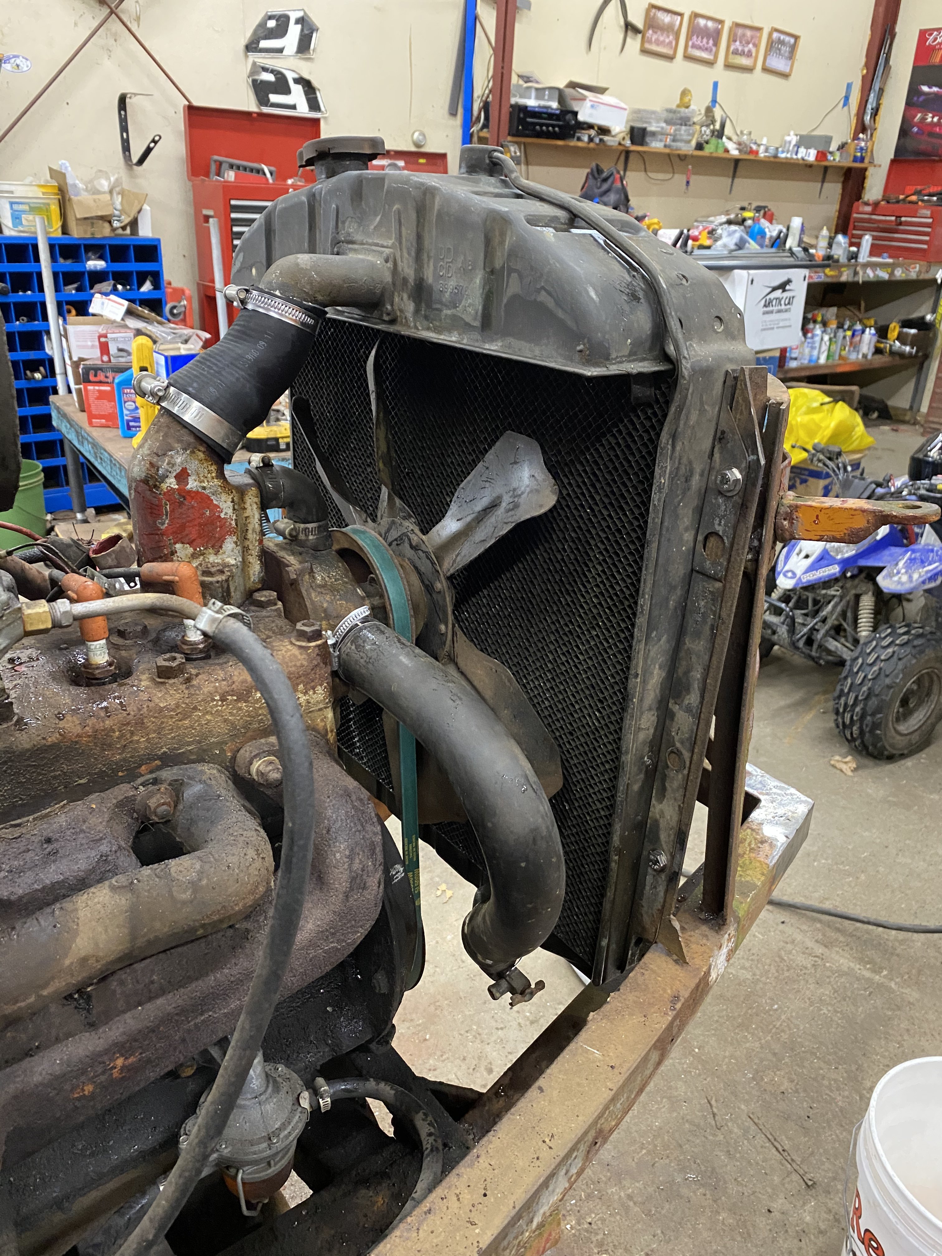

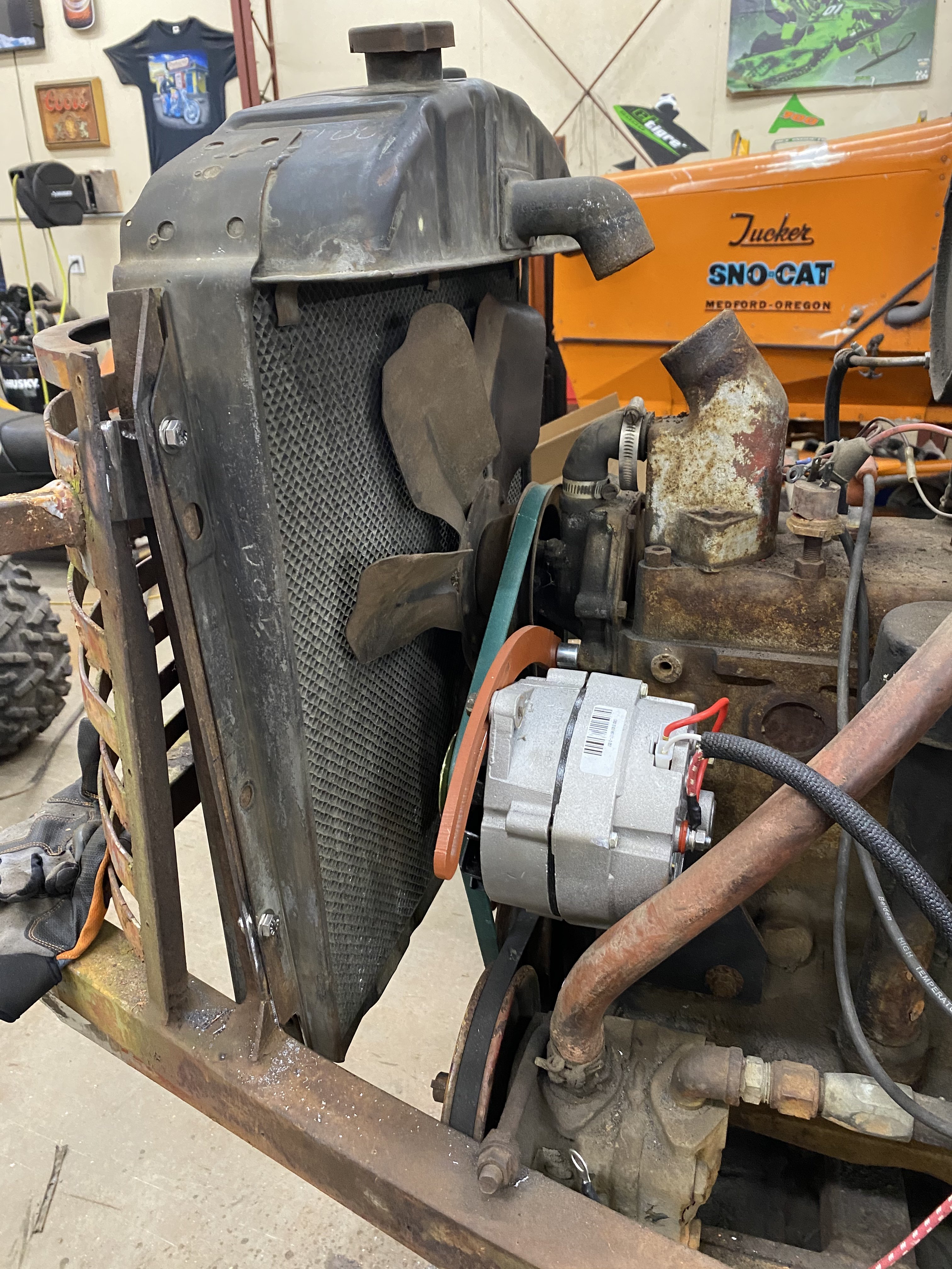

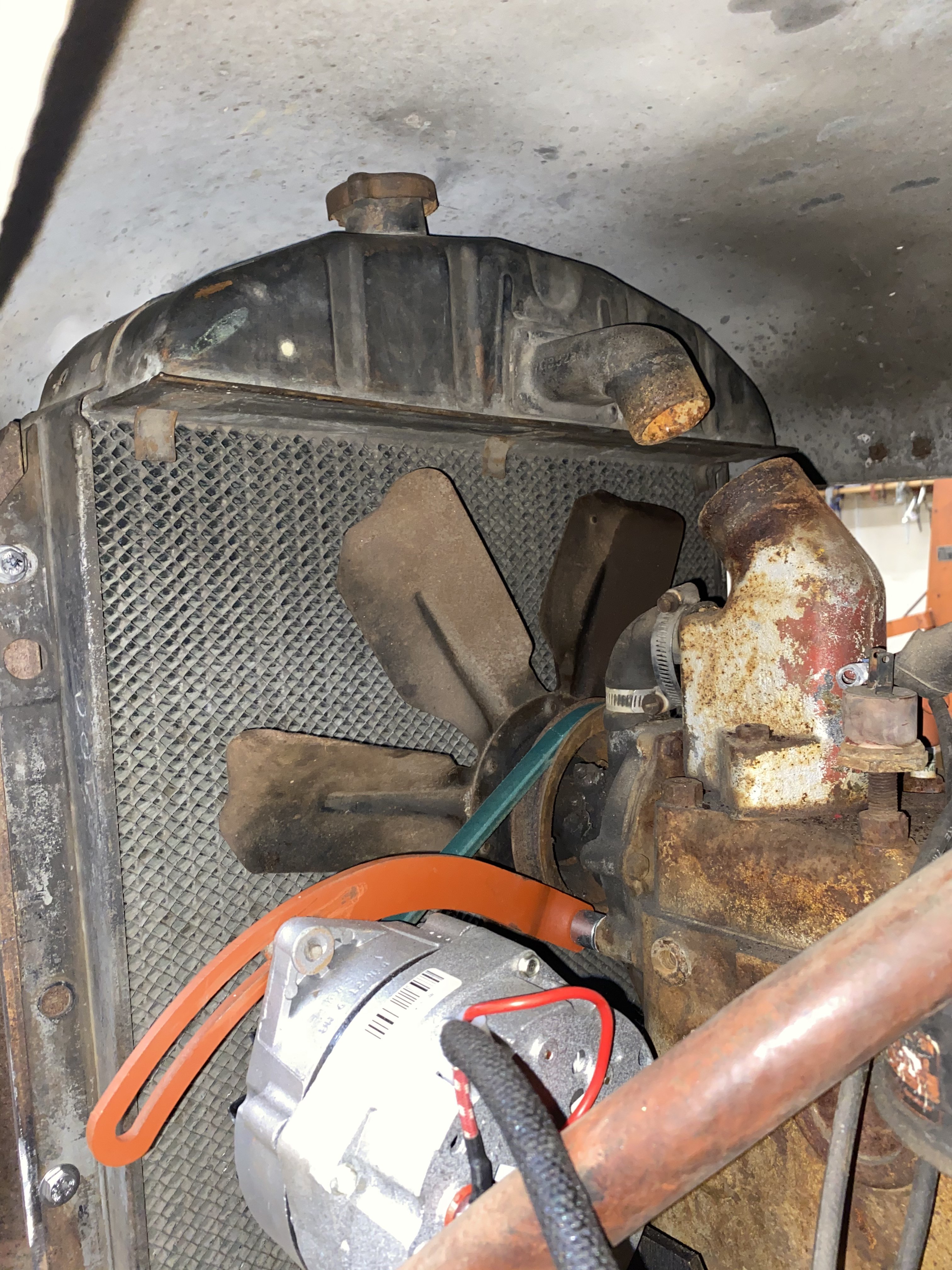

Radiator is in fan hits. There is no more height to go up. All the pics of 53 tuckers I found have this radiator mounted approx same height. The cap is touching the hood so that's that.
4 blade fan measures about 19 1/4". The six blade on another flathead I have is under 18 which clears.
Junkyard life could have swapped any of the oddities on this. Should have been a 4 blade fan.
Love some pics and mounting measurements from 53 vintage cats!
Things definitely are not what they seem after almost 70 years of who did what.
Fan was wrong and the mounting holes in the radiator were too low from prior Dodge application.
About 1954 dodge switched to a six blade fan to improved the cooling situation on the non pressurized system of the 251 and eventually 265z This is a popular upgrade on cars prior to that error. So another sensible upgrade to solve the wrong fan and benefit the usability.

Took a bunch of internet searching along with some expert support to dial what should be the correct radiator. This is the 53 at the factory. That radiator I think was lost in the fires out for repair and they are sourcing one. 52 and 54 have the same on some.
Even though the radiator is the same the mounting is different on some. My water neck is 2 1/8 which I have yet to see on others which are smaller. The angle supports for the radiator are reversed on others.

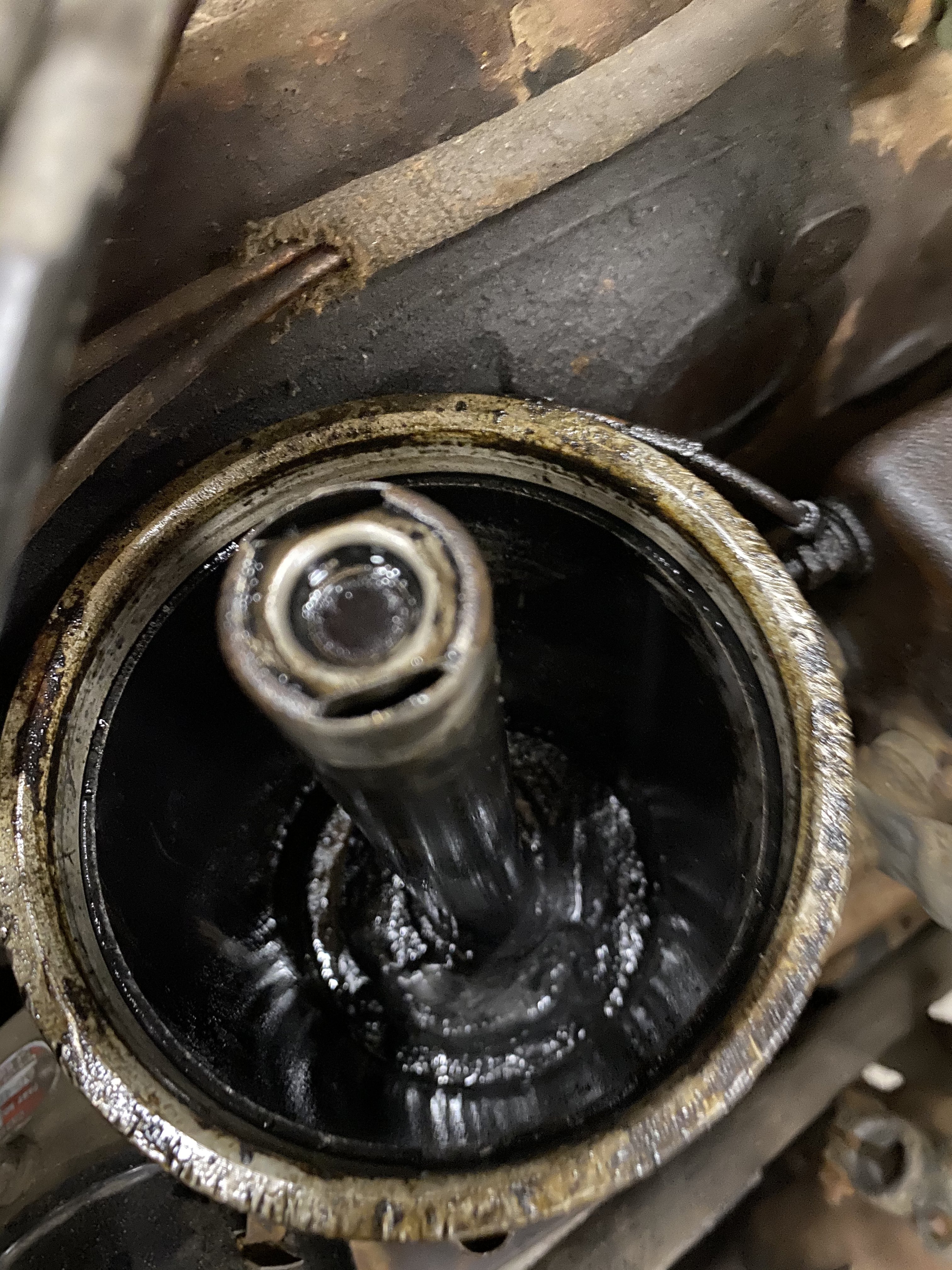

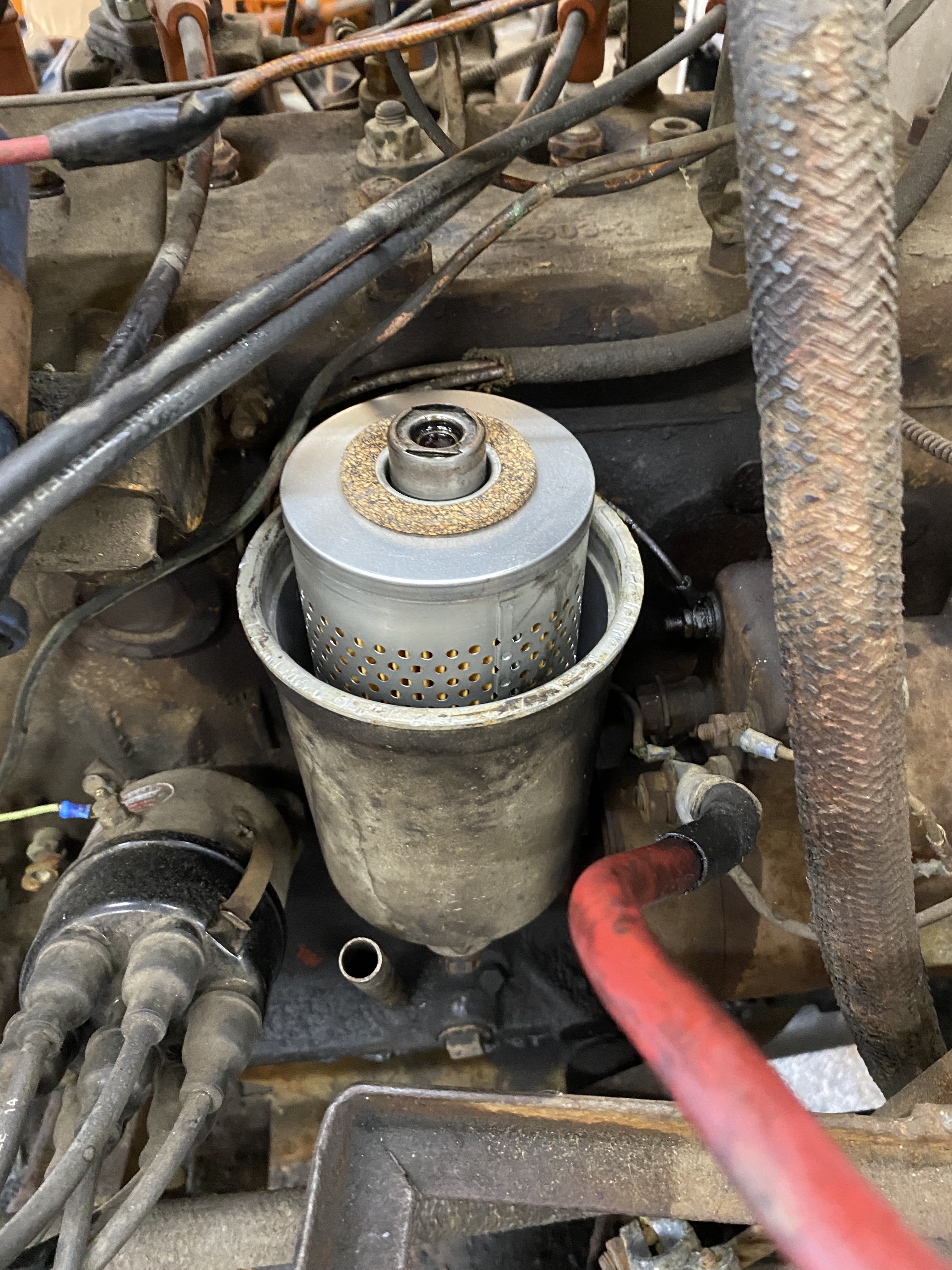

Thought the filter was a sock type filter. Looks to be a paper carteridge that turned to mush taking out. The filters I am finding now seem to have a metal surround probably from the mush experience. Anybody have the filter and oring part #?
Drain plug has some sort of feltish gasket that doesn't look right. Need to figure that out as well.

That is one of the variants these dodge flatheads had but not on this one. That one is about 2" shorter and the lid uses a flat gasket and locks from the top with a tightener on the lid.
My setup the lid has an oring that seals then a split round clamp hinged in the middle for removal/install with a screw to tighten. Attached is a pic of mine I found online with the correct fram filter that crosses to Napa 1062 or Wix 51062.
We will find out this afternoon if a winner! Early days oil filters were an option on these motors fun fact I learned.
The filter fits this aluminum housing.
Cleaned all the sludge out. Part of the mess I made was because the filter drain was plugged. New gasket on the drain plug.

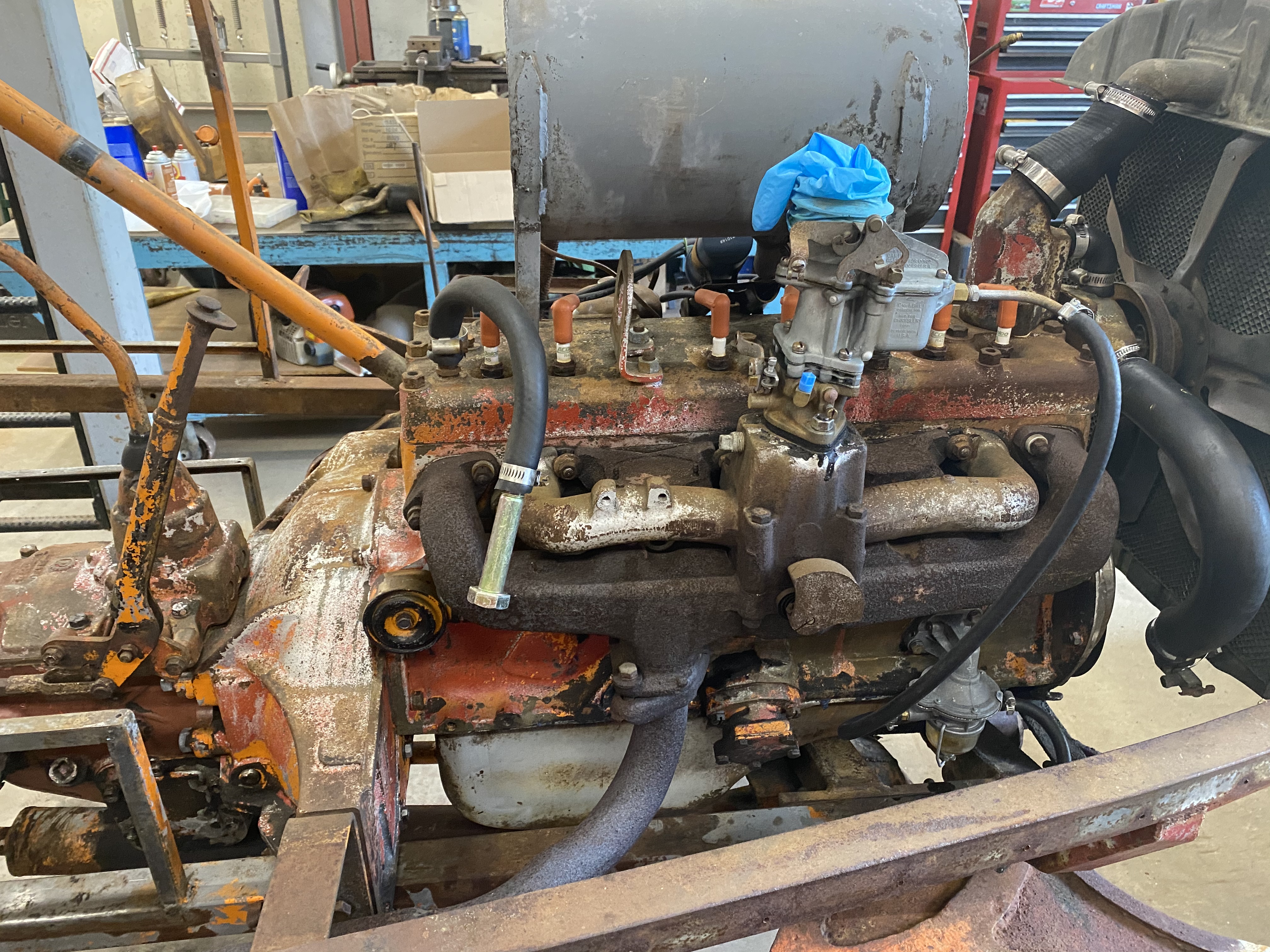

Filled with Mystery Oil and Valvoline racing 50wt zinc. Running some Ethanol free fuel and Mystery Oil as well. Motor runs and sounds amazing for how the car looks.
Makes oil pressure depending on the accuracy. Will do a other oil change before removal from chassis.

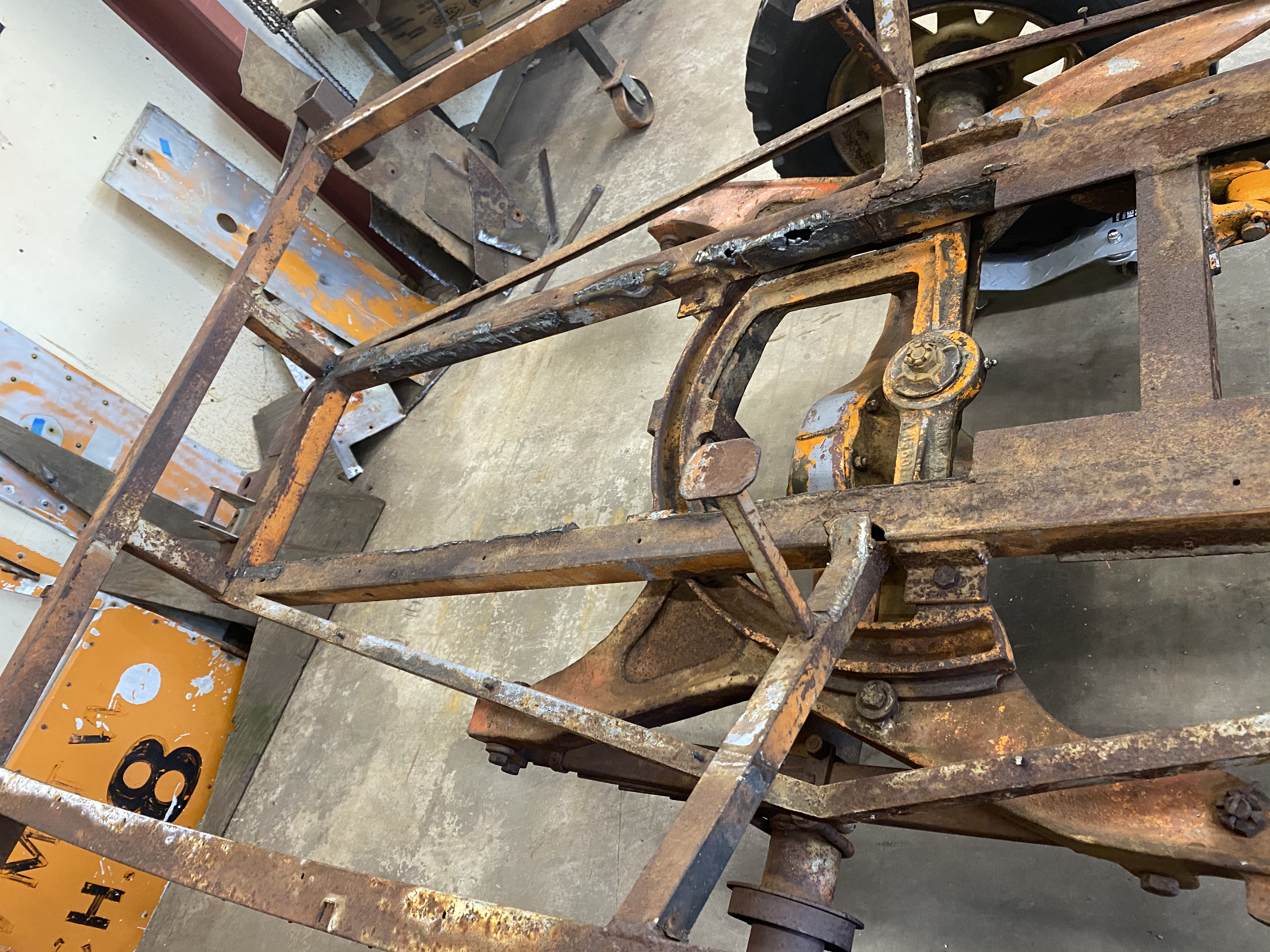

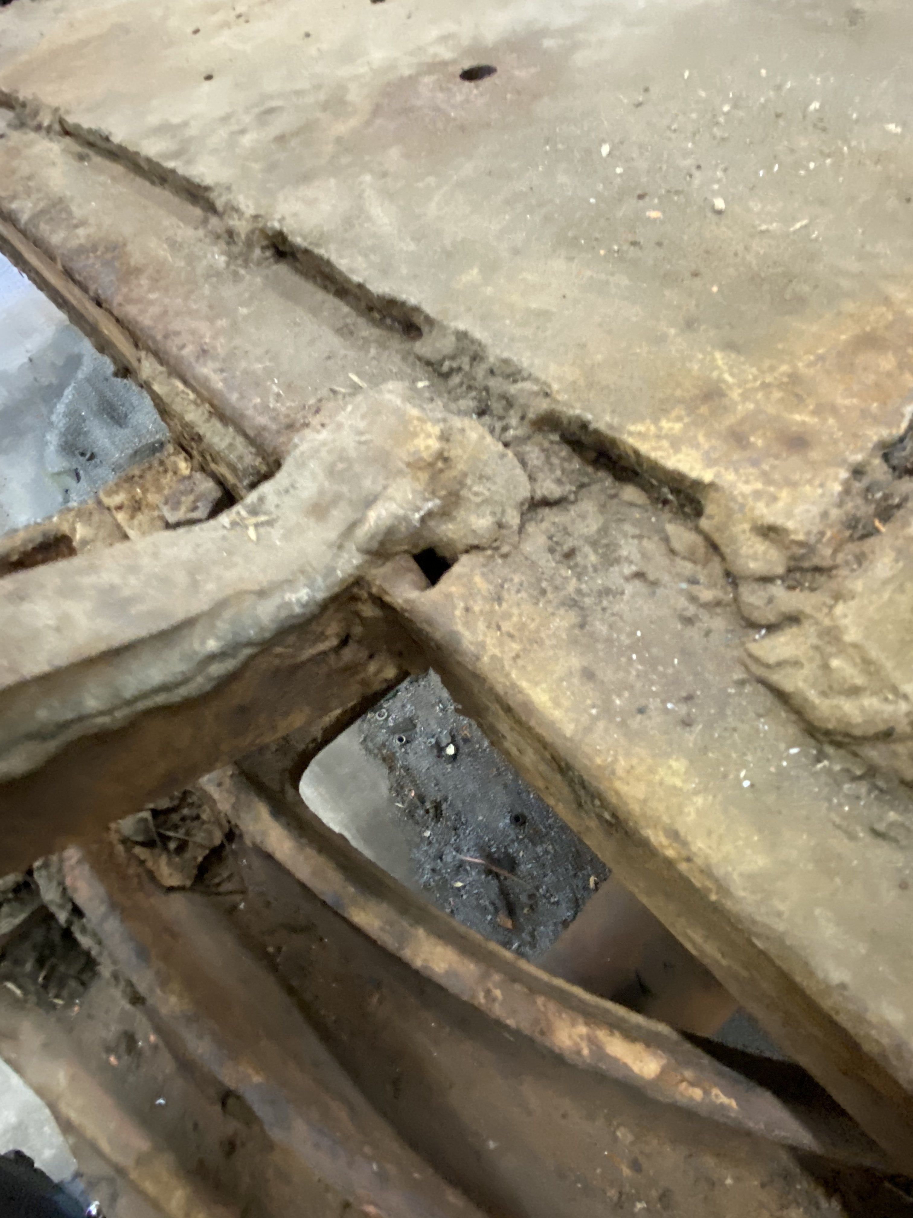

Removed the remaining body panels which will only be useful as templates and revealed the bones which are decomposed to varying degrees.

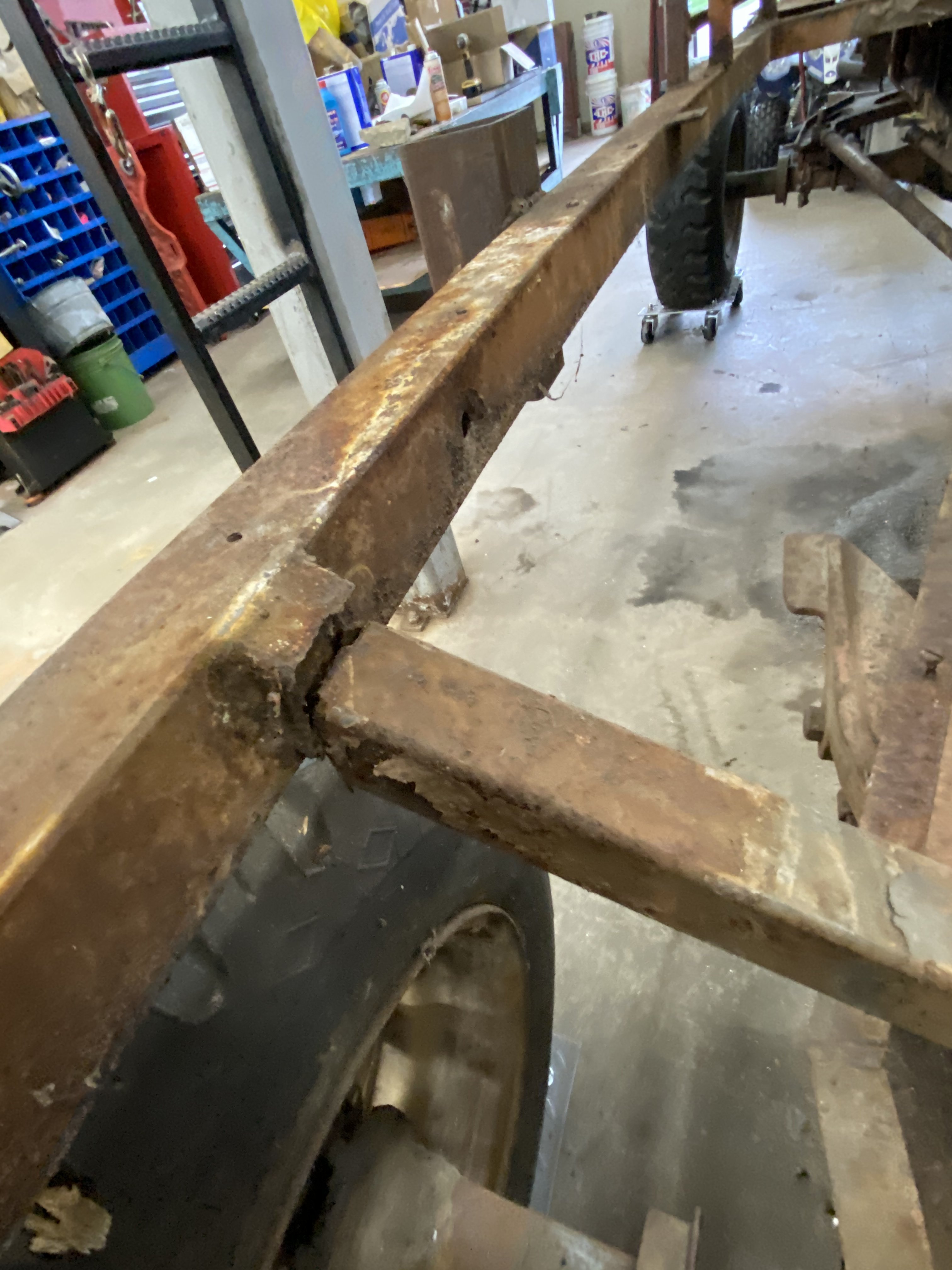

Frame has some challenges but I have a path forward for the project. Removed the junkyard handy work. Plasma torch really a surgical instrument in the right hands. Wish I had them.

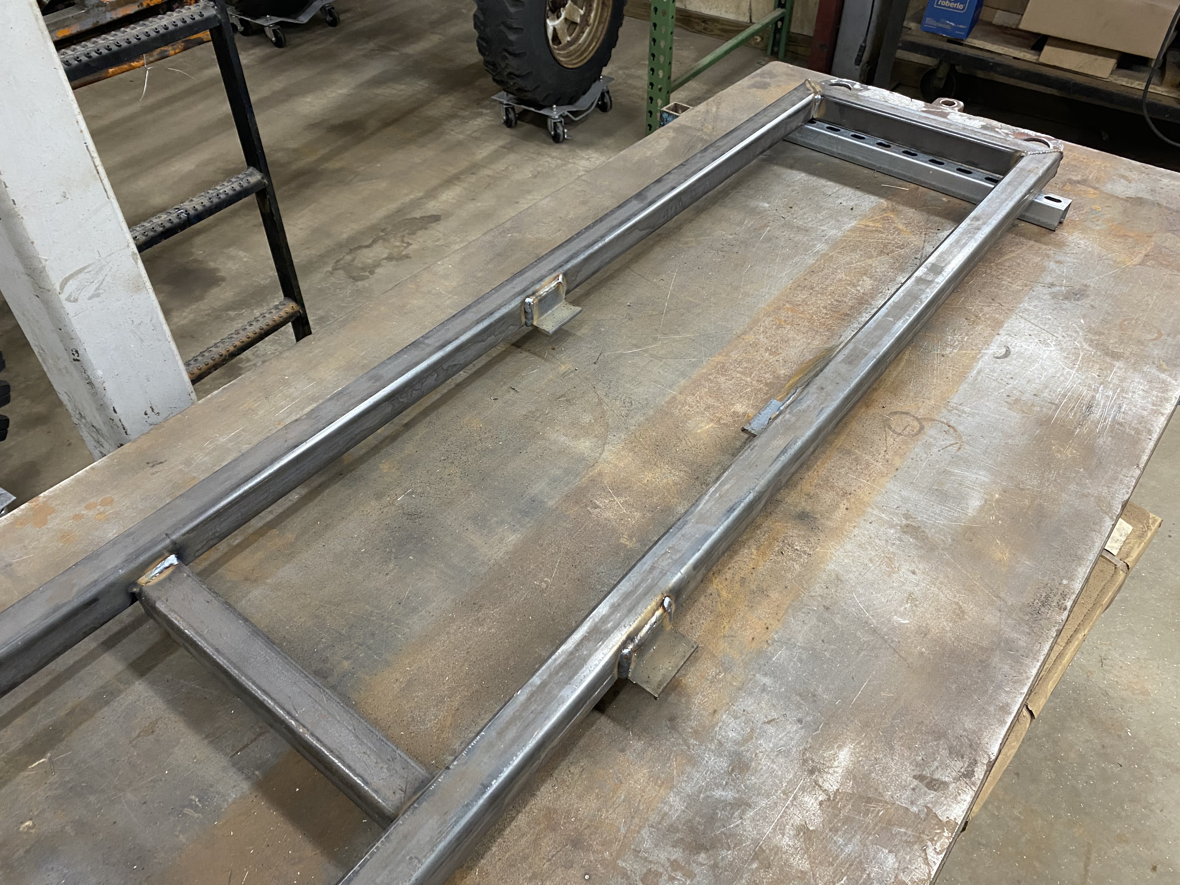

Plan is to build a new 2 1/4" box frame with thicker wall using the existing frame as a template and the bolt ones for mock-up and measuring. Take it off one fit it on the new other.
The upper frame will be repaired replaced and fixed. When ready will cut the bottom uprights at the lower frame intersect and then right behind the front down support the hydraulic pump is on the lower frame. That contains all the bends curves and variables I can reuse.
The panels were load bearing. The flex on the frame is comical. Surprised is lasted all these years. I can also see how Tucker evolve the base earlier designs which is cool!

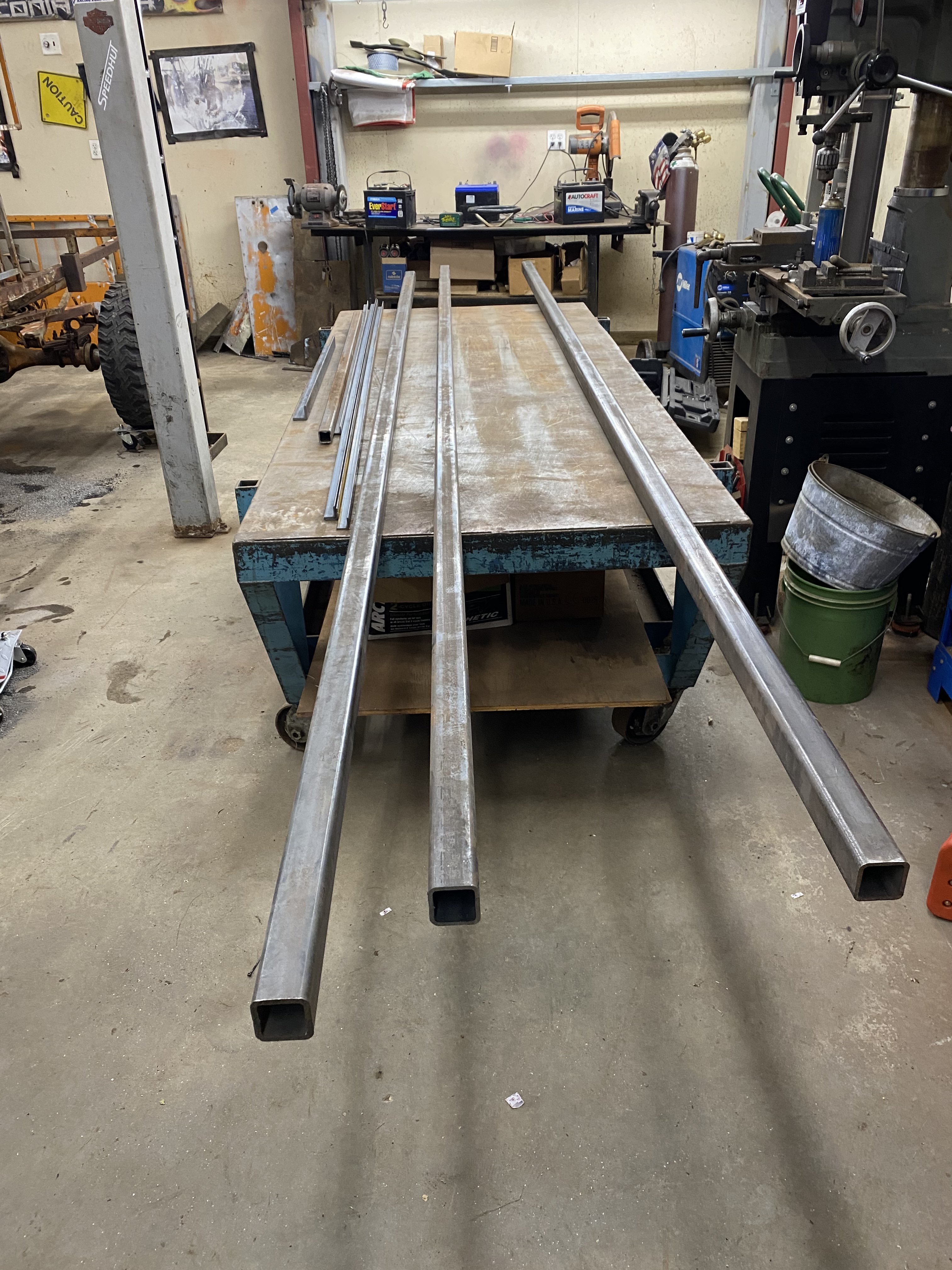

2 1/4" tubing is very rare in long lengths in appears. I can get 90" or shorter so will continue the hunt. Might have to just replace and join at a frame intersect.

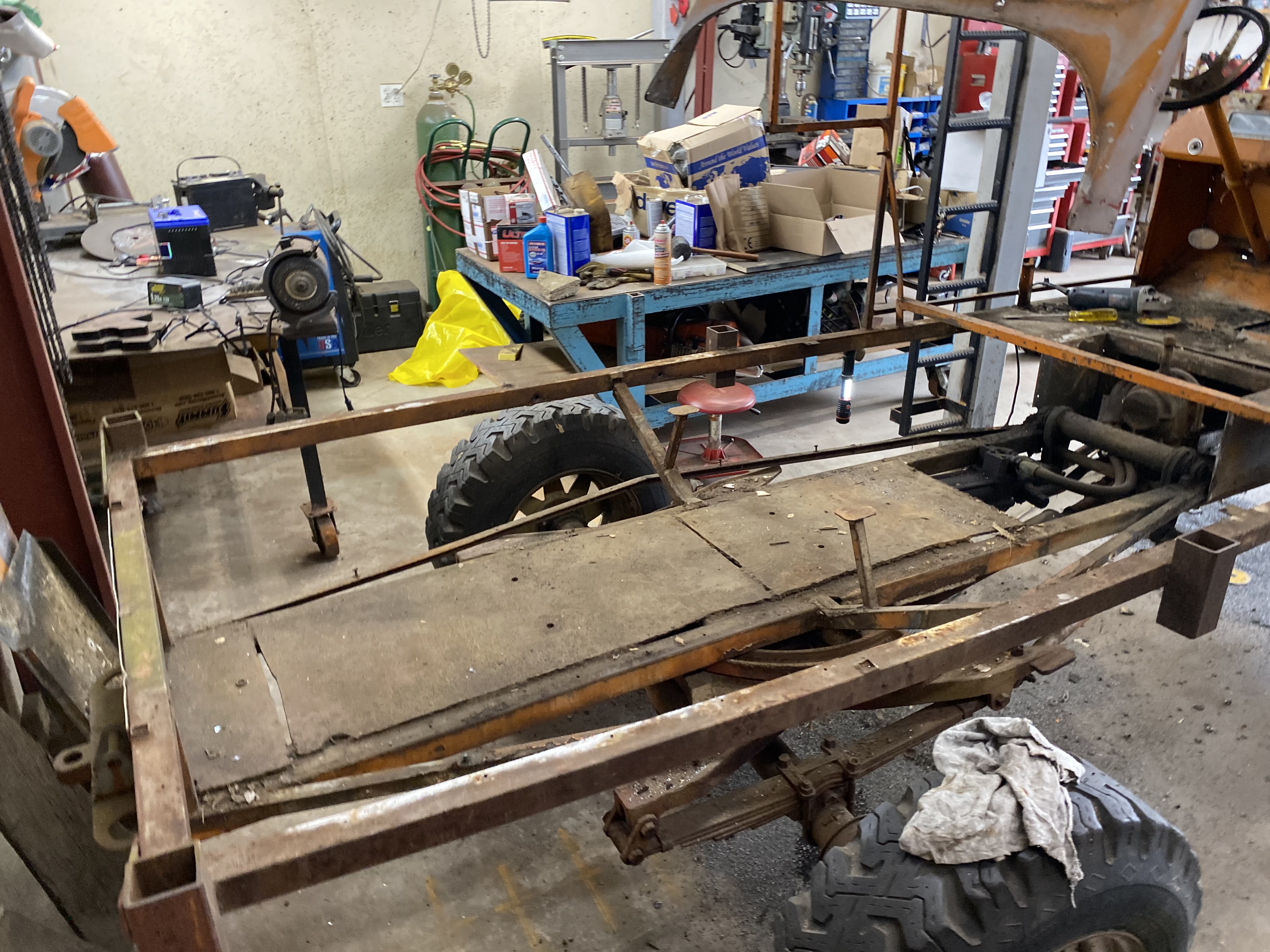

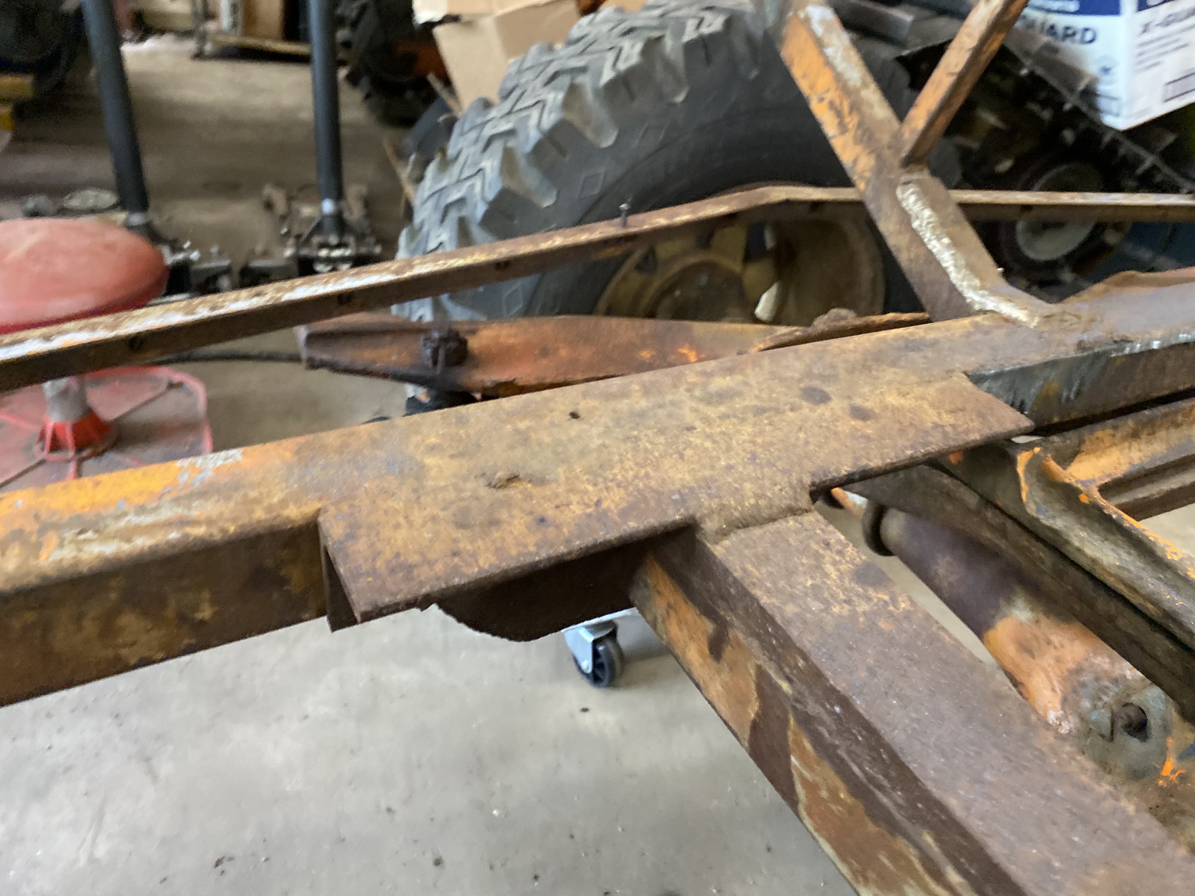

Measure twice think once. Good news the frame is common 14 ga 2". Where I measured in the back under all the gunk was 2 1/4" because of a scabbed on 1/4 repair.
Frame broken many places. Lower frame and uprights will be upgraded to 3/16 wall and the cross where the piston mounts 1/4. Table mount tabs will be thickened as well.
Got down to a base of silver/gray. Expert says silver with orange overspray would have been original.
Frame stock and table setup next along with hydraulic system removal.

Sourced the correct 4 blade fan. This confirms the longer one on it was junkyard.
2" 3/16 wall tubing for the lower frame. The 1 3/4" uprights will be replaced also 3/16 wall.
Table definitely not mounted center. Off 1/4 or so. Want to upgrade to 1/4" tabs but not sure Tucker left me enough room. Bolthead is tight to angle currently.

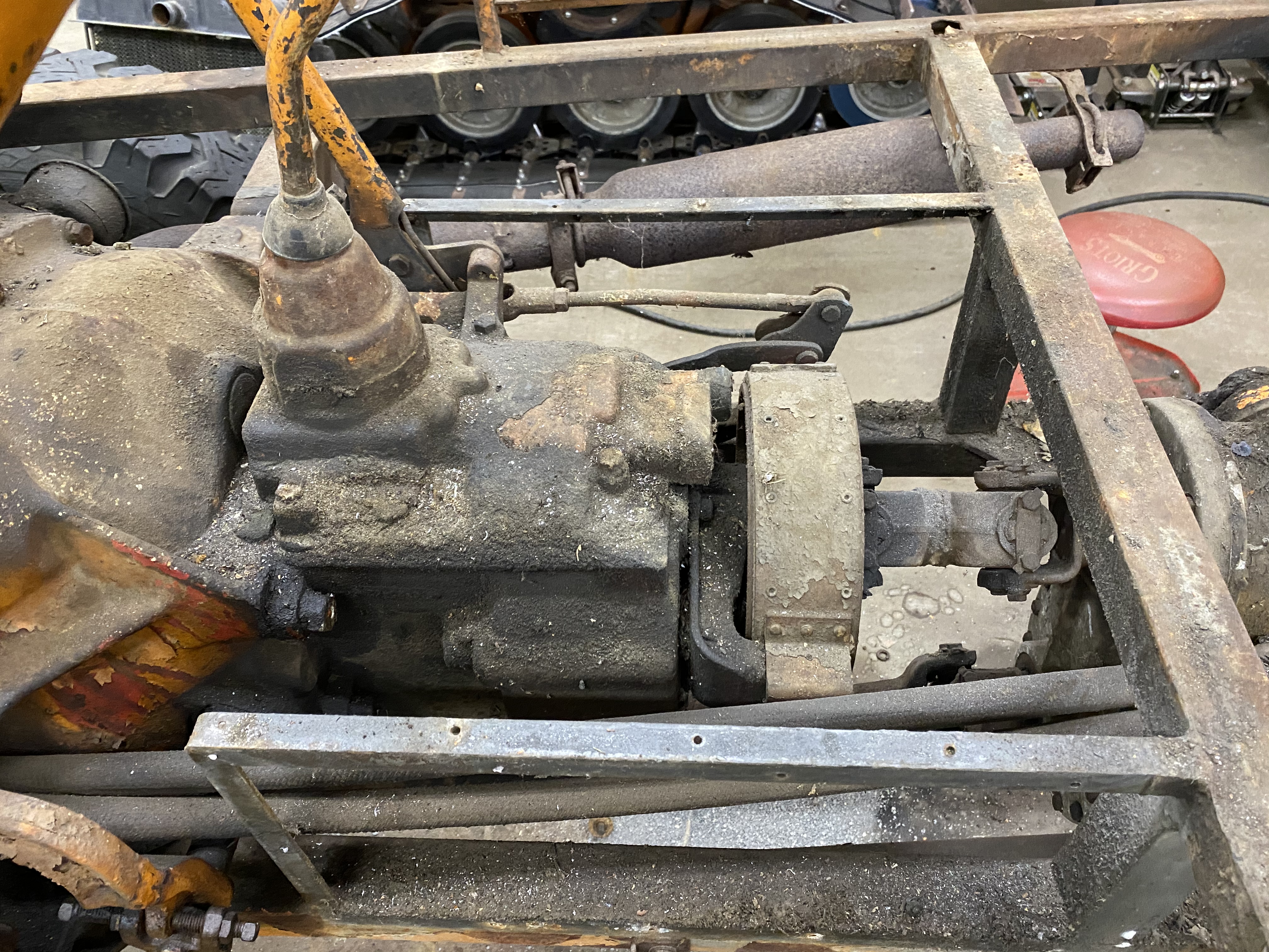

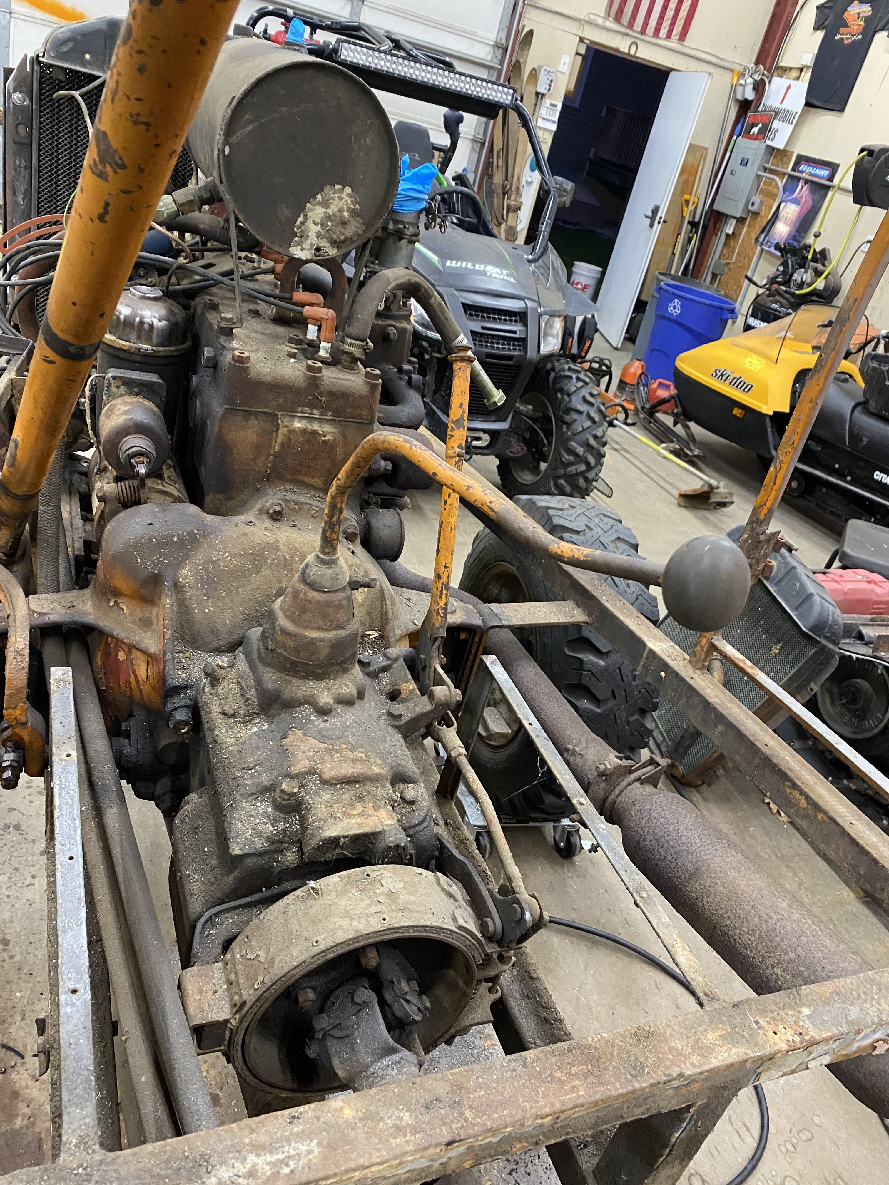

Got some of the driveshafts off and the tranfercase removed.
Freshwater from my power wash and coffee sludge drained out. Filled with mystery oil and fresh gear lube then spun the gears a bunch. Will rotate and marinate that mixture until I pull it apart.

Brought in my support crew for the frame mock up and welding. Everything is in within spex of what we call "Tucker Tolerance".

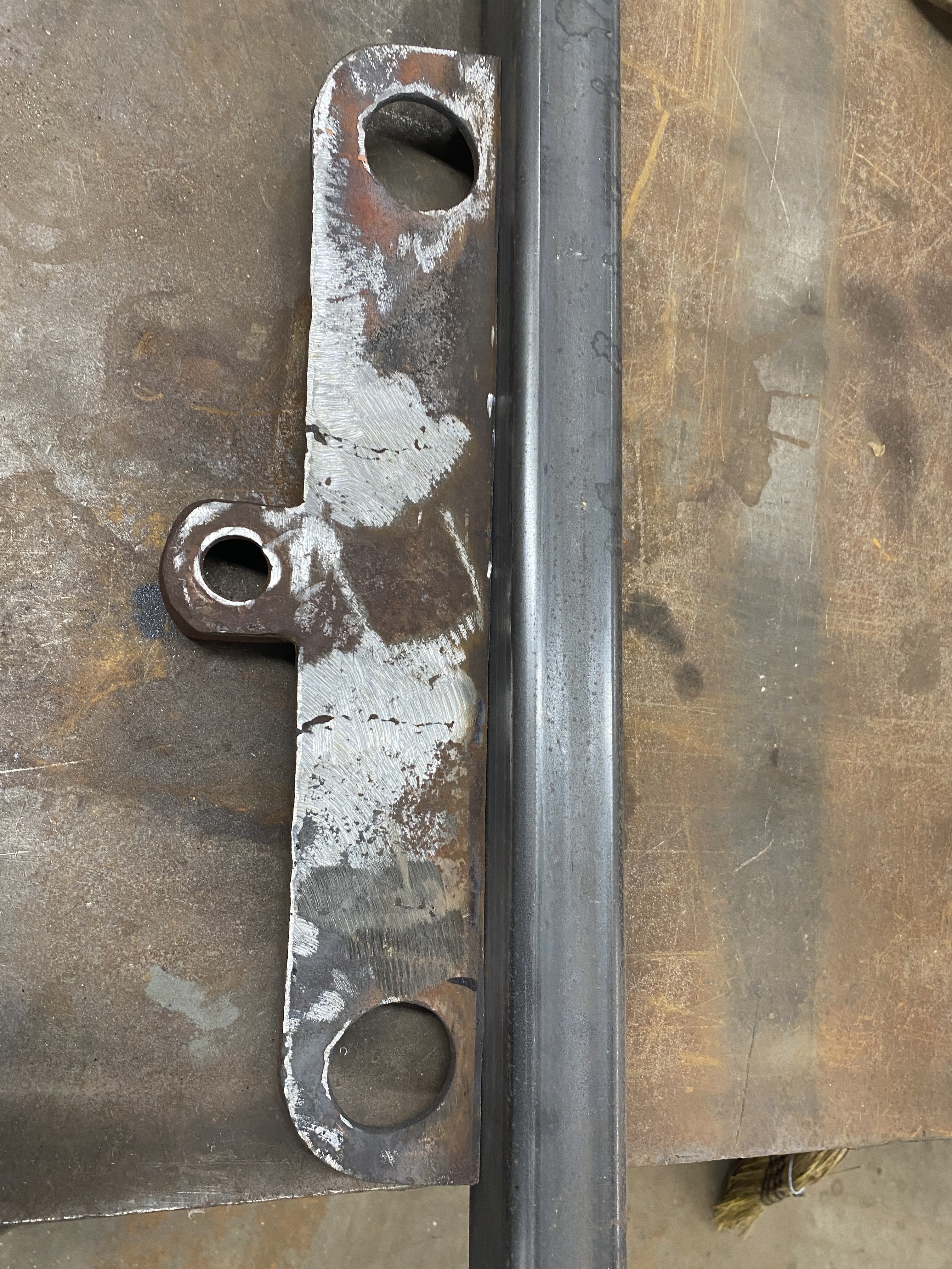

Cut the piston mount tubes caps out of 1/4" flat plate for longer rot duration. From that I can tell this is how it was 6" with a 2" flat tapered up.
Below are pics of this cat and a similar vintage. Mine has been reinforced but you can see the original gusset which is real thin. Between the thicker wall tube and gusset this will be stronger and match oem asthetics.

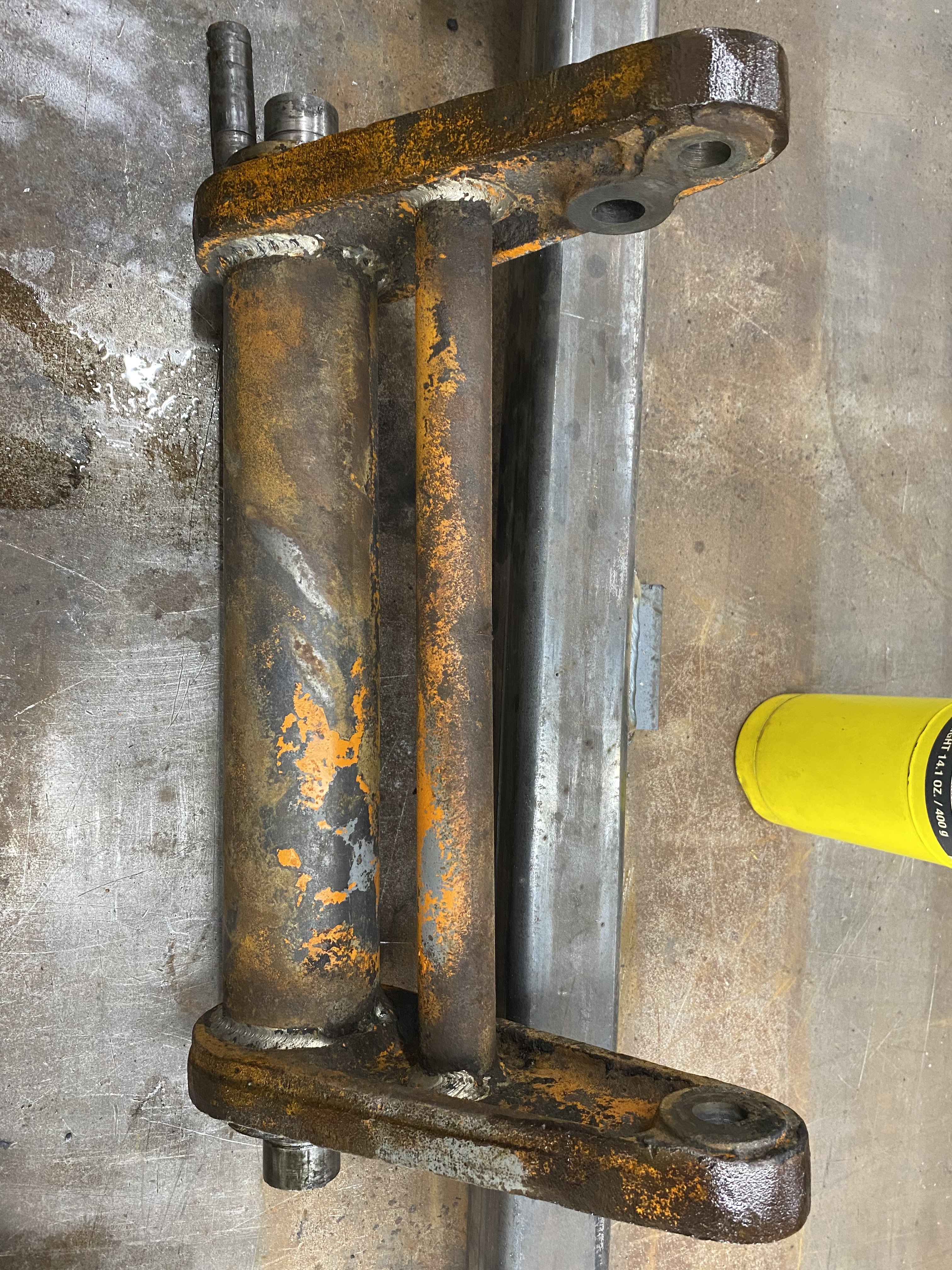

Steering piston out and center pivot removed.
Pressed out the piston mount from the pivot. As expected the pivot was tight and the clevis was worn. This will all be rebushed and pinned.
The pivot to frame bushings are in ok shape but will be replaced. They used a 2.5" od x 1.25" id bronze hollow bronze stock. It's was cut to 1 1/4" and turned down to fit in the 1.5" housing leaving a 1/4" thick flange. These will be replicated to tighten back up to oem before mounting the pivot on the new frame. Thereare some numbers stamped in the flange.
Note the lack of weld in the pivot. Thinking they welded in place on the frame and no overheard skills were required for this job. Otherwise not sure why they didn't if bench welded?
