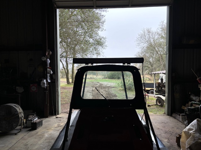

Also put the windshield on along with the hood. After the steering bushing is fixed I will drive it a bunch then check it all over, still have some improvements to make, so stay tuned for the next episode.

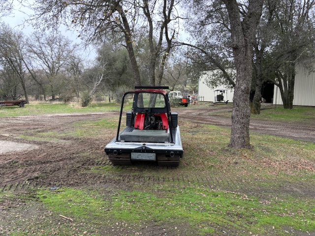

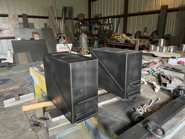

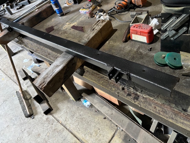

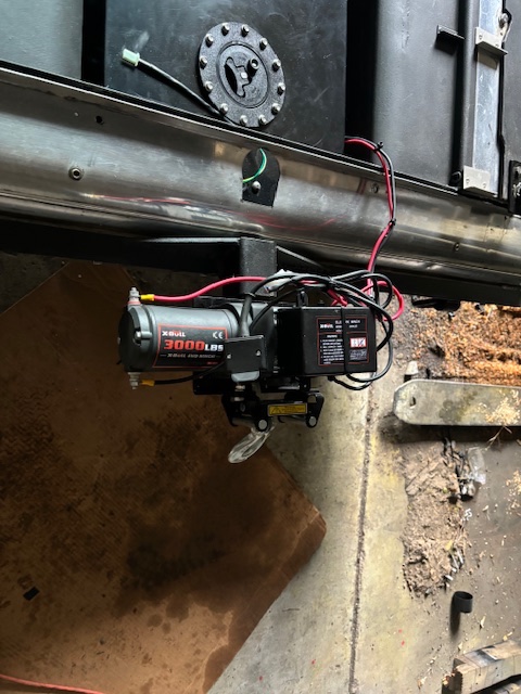

I put the bumpers on, I will likely leave the rear one, as it has a trailer hitch receiver and a couple of d rings. The front one will be remade to match the rear. Also like the light bar I found the 4 year old new winch, I plan to make a mounting plate with a male receiver tube so it can go on the front or rear. The ammo can tool boxes are also on. Cleaned it up some from all the work on it. Bought a new Optima battery and still need to make battery tray and hold down. Also thinking about a light bed for the rear. And lastly just ordered a carburetor rebuild kit because sometimes it runs good and other times gas comes out of it when it’s first started, likely the needle and seat or the float sticking, when it does that it also backfires when throttle is added. The more I run it the better it gets, but a rebuild will just fix it. Ordered some Naugahyde to recover the seats today.

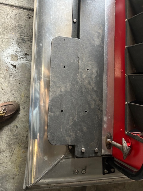

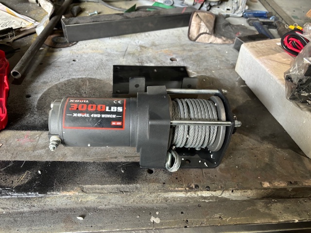

Got the winch wired in on a plate with a receiver tube

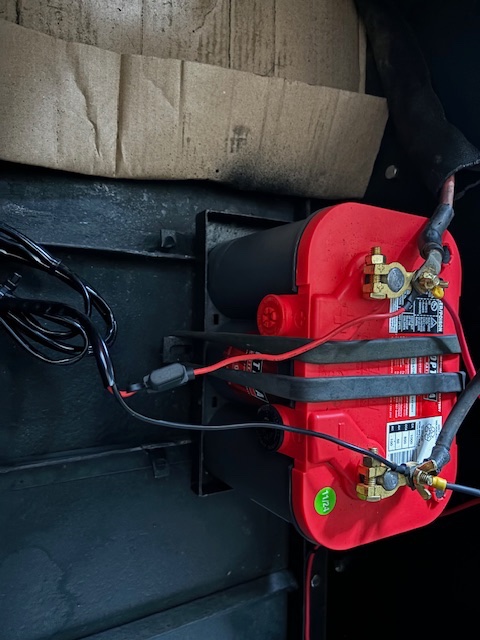

Made and attached a battery tray to the floor grate then secured the battery with a bungie cord
I just ordered 2 sets of 12v quick disconnect plugs so I can easily use the winch on both the front ( after I make a new front bumper) and the rear.

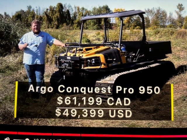

Every time I look at this ad, I like my RaidTrac even more. The carburetor kit showed up today so I’ll get that done soon. Just about time to take it somewhere for a serious test like the mountain

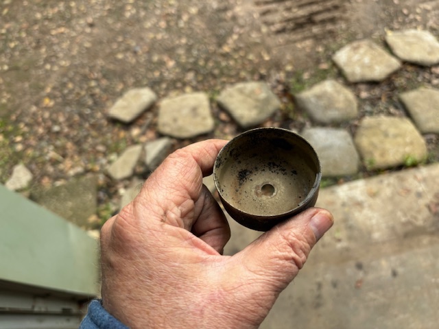

Carb was t too bad, had some dirt in the bowl along with some rust.
Only used one little seal out of the kit
The bowl O ring gasket was slightly large and couldn’t be used, i made one from some sheet cork that I had.
Cleaned it real good with carb cleaner. Put it back on and it runs much better, with the occasional backfire now eliminated.

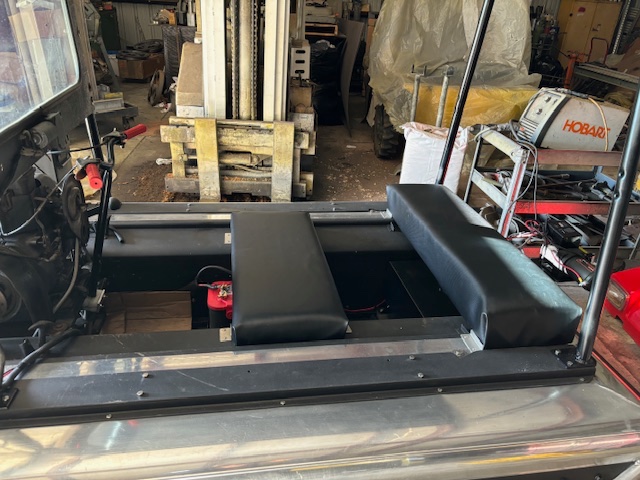

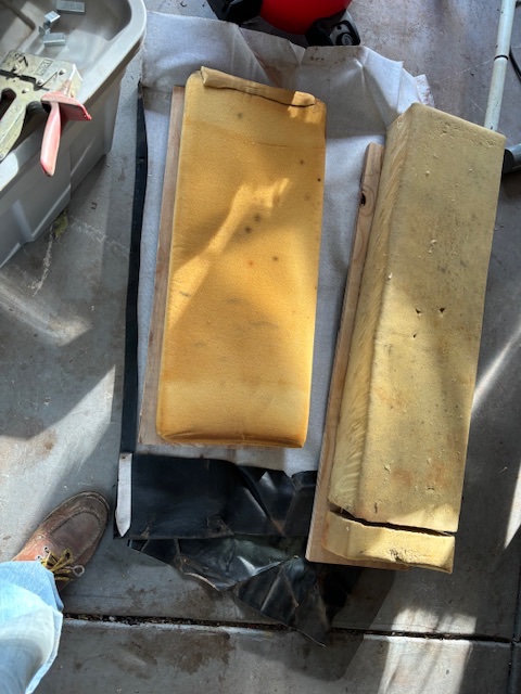

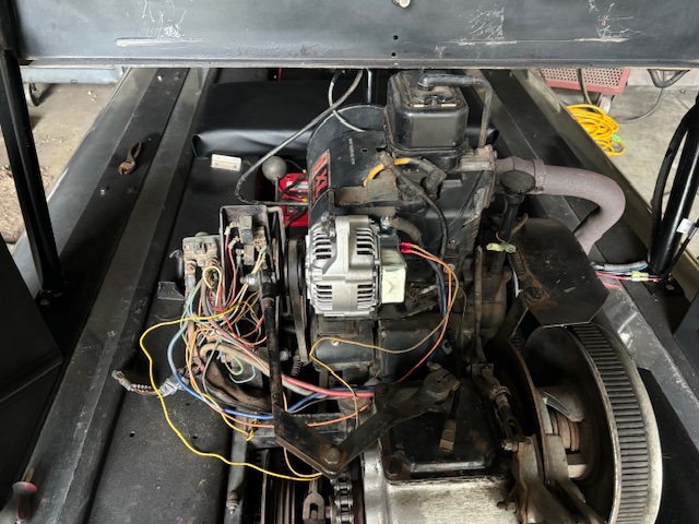

Today I made new seats, was just going to re cover the existing seats but when I pulled the old Naugahyde off the plywood was delaminating, so I made new from 3/4” plywood, used the old foam and some new Naugahyde. Not a show job but looks a lot better. Before it looked like it was dressed in a new suit wearing work boots. Now at lest everything is shiny. Also while cleaning up the wiring I discovered the alternator isn’t charging. Ordered a 70 amp one wire mini alternator, I’m sure I’ll have to modify the bracket as well. Been driving it round the property a bunch, I’m only on 6.5 acres but I figure a lap is about a 1/4 mile. So far so good.
New alternator showed up, didn’t have to modify the bracket. It’s now charging, but I had to put the wires that excite it on a switch because it pulls the motor down at idol too much and effects low rpm performance. So the plan is to just flip the switch after I take off. It’s a 70 amp alternator and the battery is low and may improve when it charges up. Next is to clean up the rats nest of wiring, now that I know what is needed and what is not.
