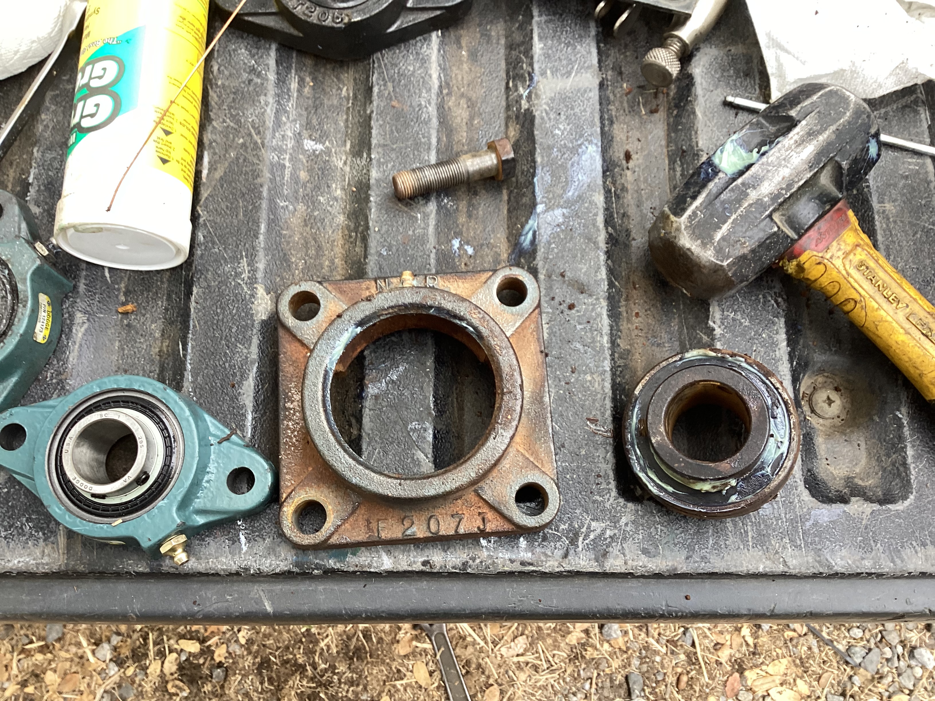

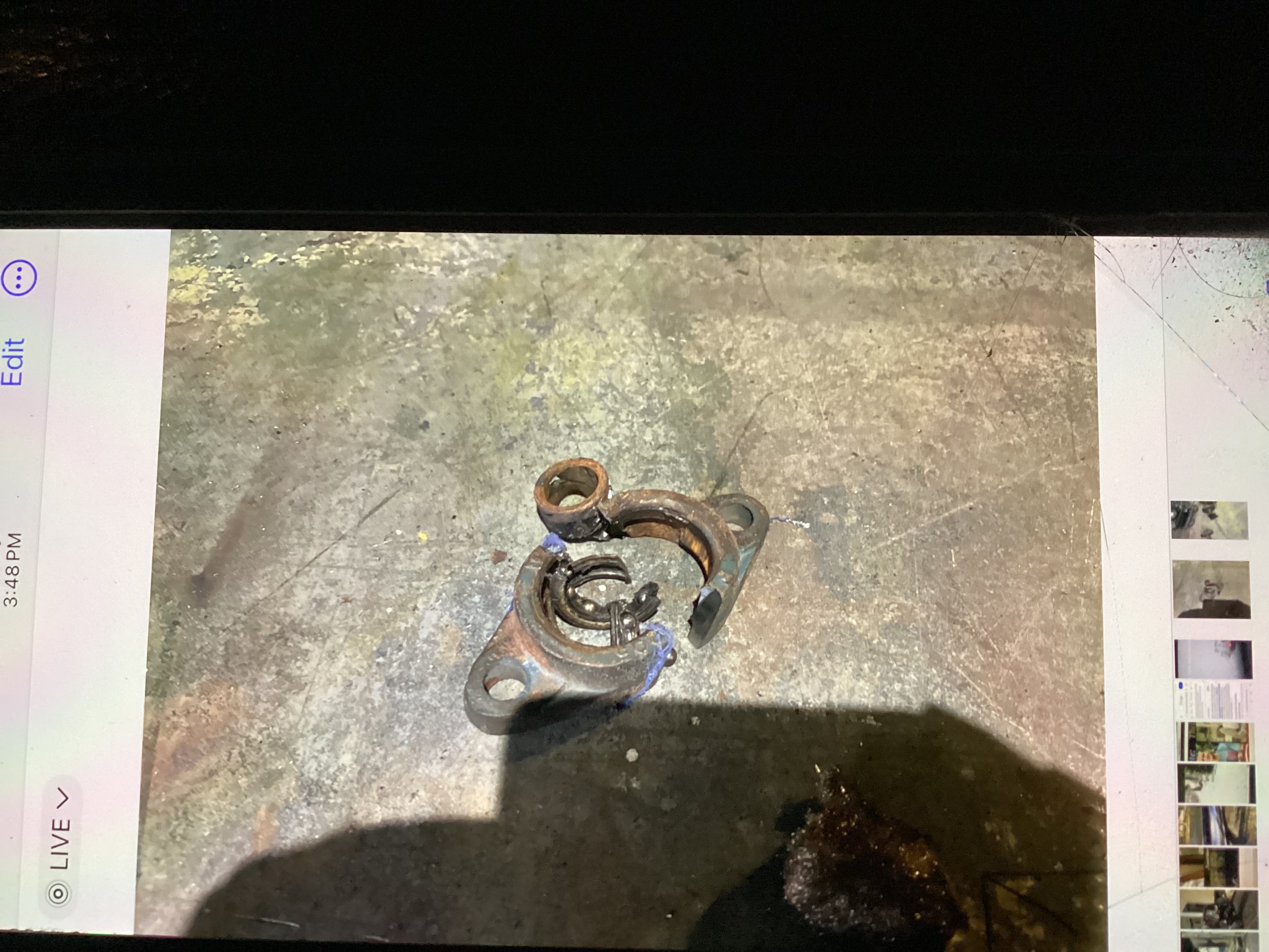

I think this is the last crappy job, some of the bearings have to be replaced, as they were pretty loose and rough when turned. The others all had to be disassembled, taking the bearing insert out of the housing and clean the grease channel and the hole that lets the grease into the bearing along with the grease nipple, the dried grease was hard like silicone. I wonder how many times the previous owner thought he greased it.

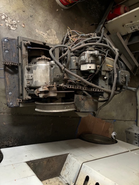

had to go to the field this morning but had time when I got back to pull the power unit out.

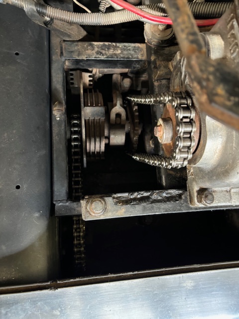

Pretty good design as a module that the engine and whole drive and steering system are mounted in a common frame that bolts into the tub. That makes maintenance much easier. I’m going to clean it up a little, change oil on the engine and transmission and put it in, looking at I think it needs to go in before the drive axels.
Still working on bearings today after real work, I got 2 more bearings, both had to be cut and broken off the shaft.
Neither would take grease and you can’t take the bearing apart on the shaft.

Also cleaned up the power unit by blowing it off with compressed air then a wipe down with degreaser then Acetone.
I’m not doing a full restoration, just a good clean up and address any mechanical issues the engine ran good as well as the clutches and transmission.

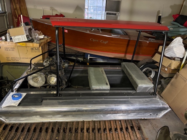

All the bearings are done, the tub is elevated on wood blocks to a good elevation to assemble it.

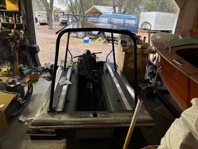

The assembly has officially started, the first piece installed was the floor grate. for non slip and to stiffen the bottom.

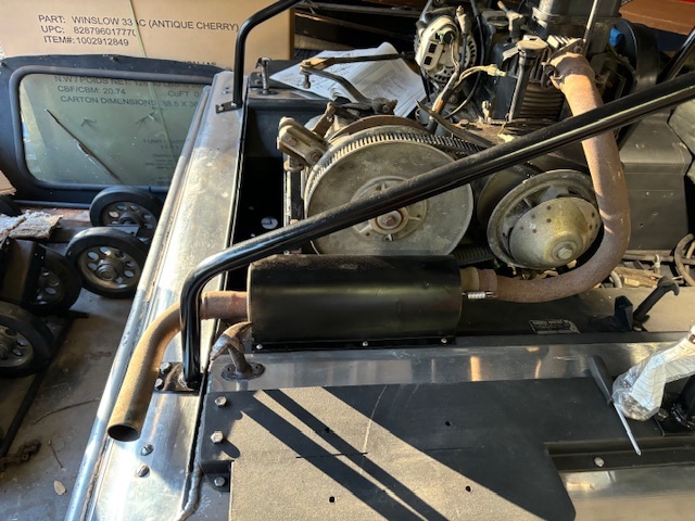

Next will be the drive module, then the roll cage, today I realized that every thing bolted to the tub over the tracks has to be done before the tracks, or you can’t get to the bolts. Also changed oil in the engine and transmission. Been a long time since I worked on it last, now I have to figure it out as I go
Had to help out in the shop some today, but still got a little more done.
Roll bar and roof are pieced together but bolts are not tight, same with the rails that te roll bar bolts to.
I had already bought new stainless hardware when I worked on it last, sure making bolt up nice.

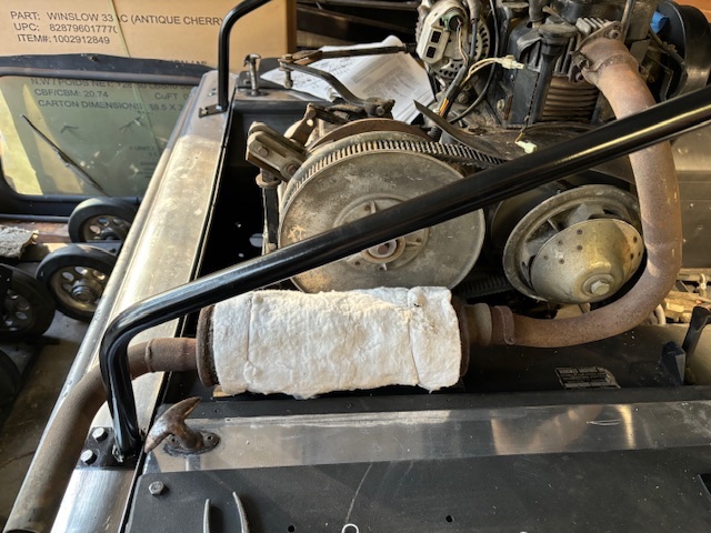

I got a little more done today, re insulated the muffler, painted the heat shield and got it mounted, along with the bolt up of the gas tank thru the tub into the aluminum spacer tubes.

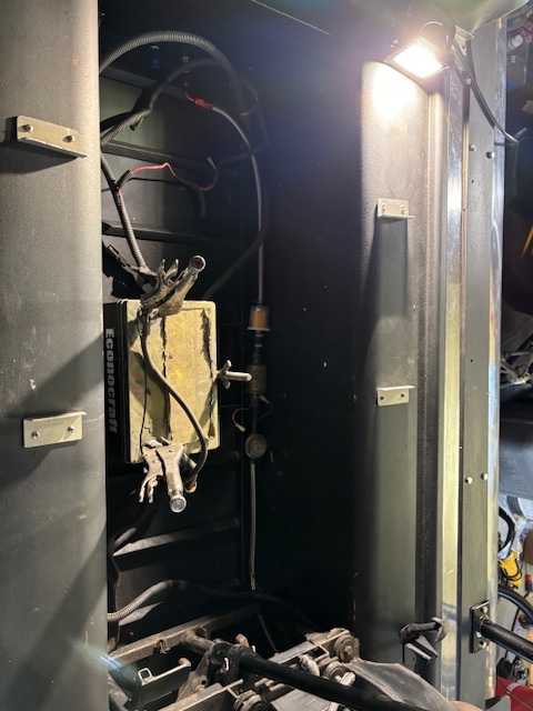

Hooked up most of the electrical connections except things that have been deleted, after adding a light bar and winch I will clean up the harness some
Threw in a battery, everything that needs to work does
Installed the electric fuel pump with a new filter and connected to the fuel tank, carburetor and electrical harness.

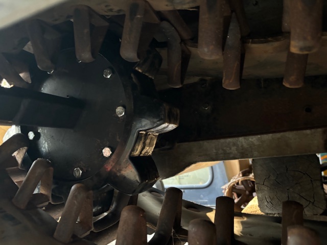

Had about 4 hours of free time so I started on the tracks/undercarrage.
What a #@&$ bitch, happy I don’t do that for a living. It’s about a 8 hour job per side of up down up down.
The tracks weigh around 250-300#
Put in another 4 hours today and got her back on one foot, my son volunteered to help me tomorrow to get the other side done. Once she is on her feet, there will only be a day or two left on miscellaneous item like the drive sprockets and chains and a few others. Then double check everything and give it a go.

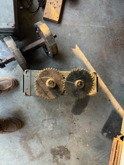

After a 5 year rest torn apart, the old gal is back on her feet. Tracks and undercarriage are done, and I think it was the last hard time consuming Job on it. Still need to put the drive sprockets on the shafts.
Make up 3 chains and tension everything.

All 3 drive chains are on along with tensioning.
