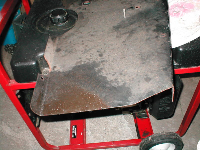

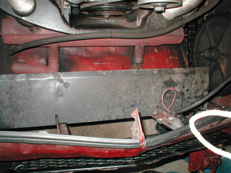

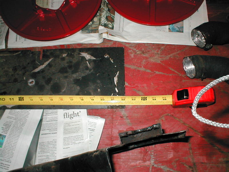

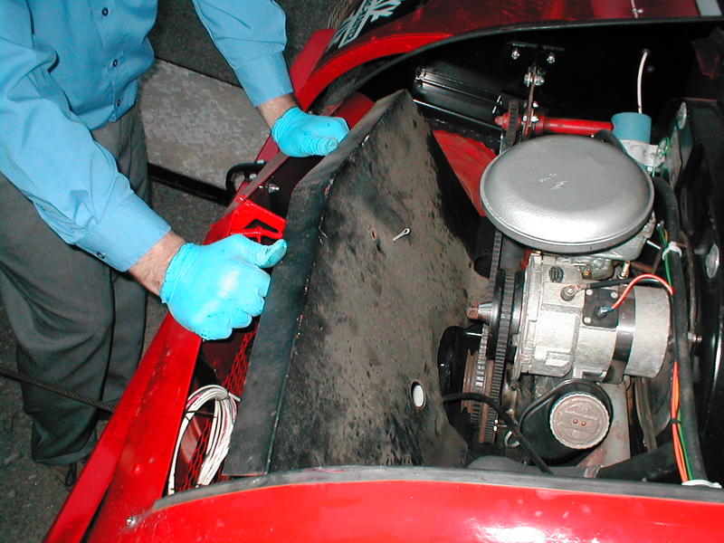

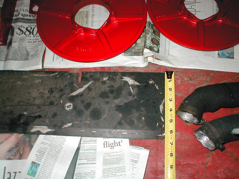

Anyone have dimensions for the air horn? I can't seem to find anything on the forum.
I don't know if this will help or not . I had made a paper template but i sent it to someone on the forums and cannot remember who it was .

. . . it appears that Big Al is secretly using Snow Trac technology for his Kristi redesigns. :yum: Wonder what kind of wicked spawn he will make.:hammer:
Thanks Joe and BigAl and Don,
BigAl, I do have the front pieces. I didn't have one of them on when it overheated a bit. I have it on now. Moosegby is sending me a template of his. I'll see if I can make one. I post some photos as I go.

I am now working on making the air hood. Moosegby has sent me the template and I have a cardboard unit made up. I noticed on the one he sent me the top of it isn't flared out to cover the whole louverd area on the hood. What I have only covers about 2/3rds of the louvered intake area so I wouldn't have the "seal" that's optimmum but still seems like it would be enough bring the cool air in. I see some of the horns gets flared out a bit at the top to accomodate this. I could alway modify the one I'm working on later if it doesn't do the cooling job properly.

forgot asfar as yur intake scoop modify the with t acomodate your louvers your rig may have origionaly had a dog house oil cooler on it i believe it is newer than advertised and once may have had a newer motor with the dog house oil cooler
