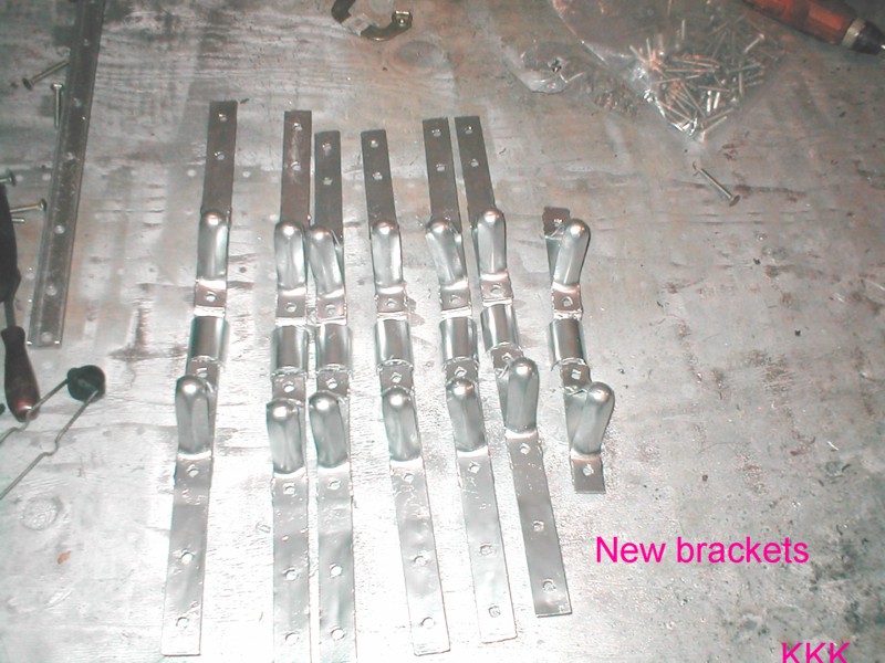

I just about finished the rebuilding of the other track today . I had to completely build the center section on 6 wheel alingment brackets . They were gone and only God knows where and when they were lost .My brother, who has been helping me ,had to return home .So the last 2 days I have been on my own , but I have developed a pretty good system for assembly.
Ok you KT3 Kristi owners . You will probably find you have some track brackets that are missing the center section too . Here's how I fixed mine .
The easiest way to do this is go to a muffler shop and get some stainless steel exhaust tubing . About 1 3/4 "diameter will work fine . Cut it in 2 3/16" lengths then split it down the middle into 2 halves . Heat it up and wrap it around a short length of 1 3/8 pipe . Hammer it down to that size which is the correct radius for the brackets. Cut 2" lengths of 1 1/4 " x 1/8" flat bar stock to weld between the two halves of the broken track brackets .The stainless steel wear sleeves are then welded to this .
I should have the second track installed in the morning and then it is just a matter of doing a little touch up on paint and other small detail work . Here's a picture of the brackets with new "homemade" center sections

BigAl keep some good sections of that old belting for splices. If you dont have any make a few up. A couple of 18" to 24" or whatever it works out to bolt up should be fine. Have those and the tools and bolts to replace a section or splice a section if needed.

Thanks Al, for that info on fixing the track brackets. Have a couple or so on my KT-3 that eventually will need replaced, especially the center section. Luckly, I do have about 3 or 4 spare new brackets.

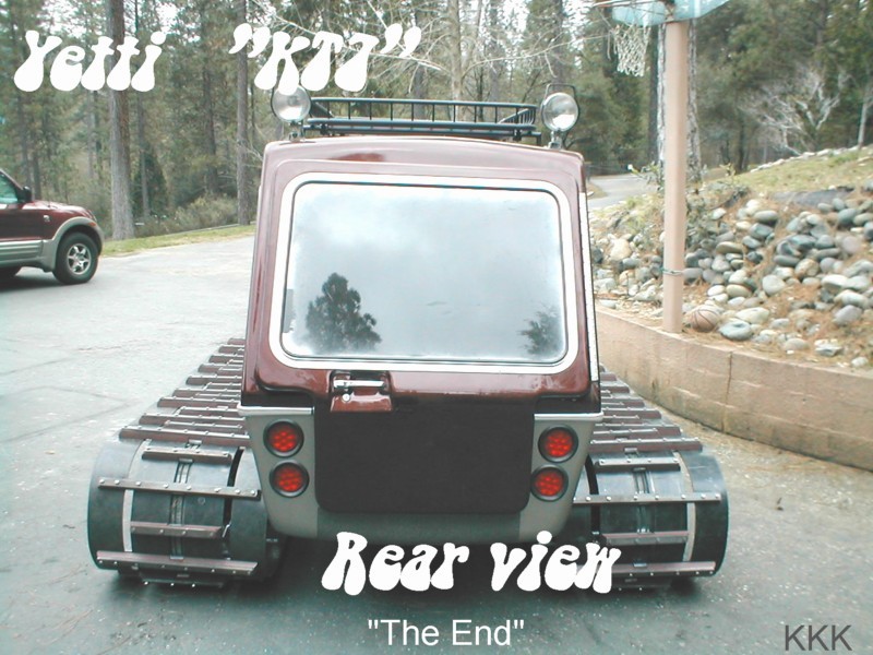

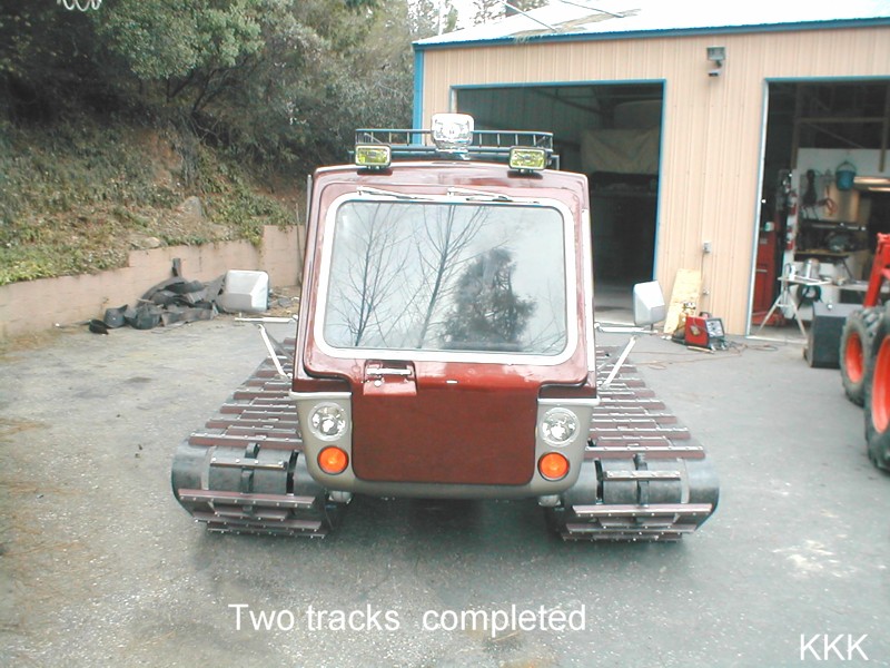

Evening Folks :tiphat: ,
Well after 15040 views , 887 post and comments , Numerous PM's , and almost 1 year exactly from the start date , Old Yetti is sitting in the garage completed .
Now its my turn to compliment ! I personally want to thank each one of you who stopped by and took a look at my Restoration . It has been a real labor of love and a learning experience .Not so much what I learned working on the KT7 , but what I learned about friendship and getting to know some wonderful people here on Doc's Website , ForumsForums
I can tell you now. There were a couple times I was in doubt I would be alive today , to see her finished . But God stood by me and bought me back home from some health issues . I guess he just was'nt done with me yet .
The bad news is No more "Dr. Rums" for me so would someone please have a double for me tonight !!! I would like that .....
I still have to take Yetti out to the snow to get her tracks wet and maybe fine tune a few things but for the most part ,she is finished .

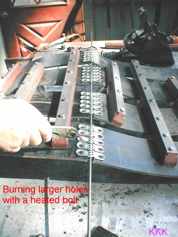

I am including a few pictures of installing the Flexco track fastners . I used a undersize drill bit to chase the holes then heated up a track fastner bolt "Cherry Red" and pushed it through the undersize holes .This is a great way to get a exact hole where you want it . The heated bolt goes through the rubber belting like "Grease through a Goose" !! Real fast ..
There are also a few exterior pictures I added ,showing both tracks in place .
Soon ,I'll do one more set of pictures on the "Maiden Test Run" for this thread along with a performace report on how Yetti did overall .
After that a complete set of exterior and Interior pictures will be set up in a photo file gallery .
So ..... I guess this is about the end . Again thank you for giving me the support to keep going .
