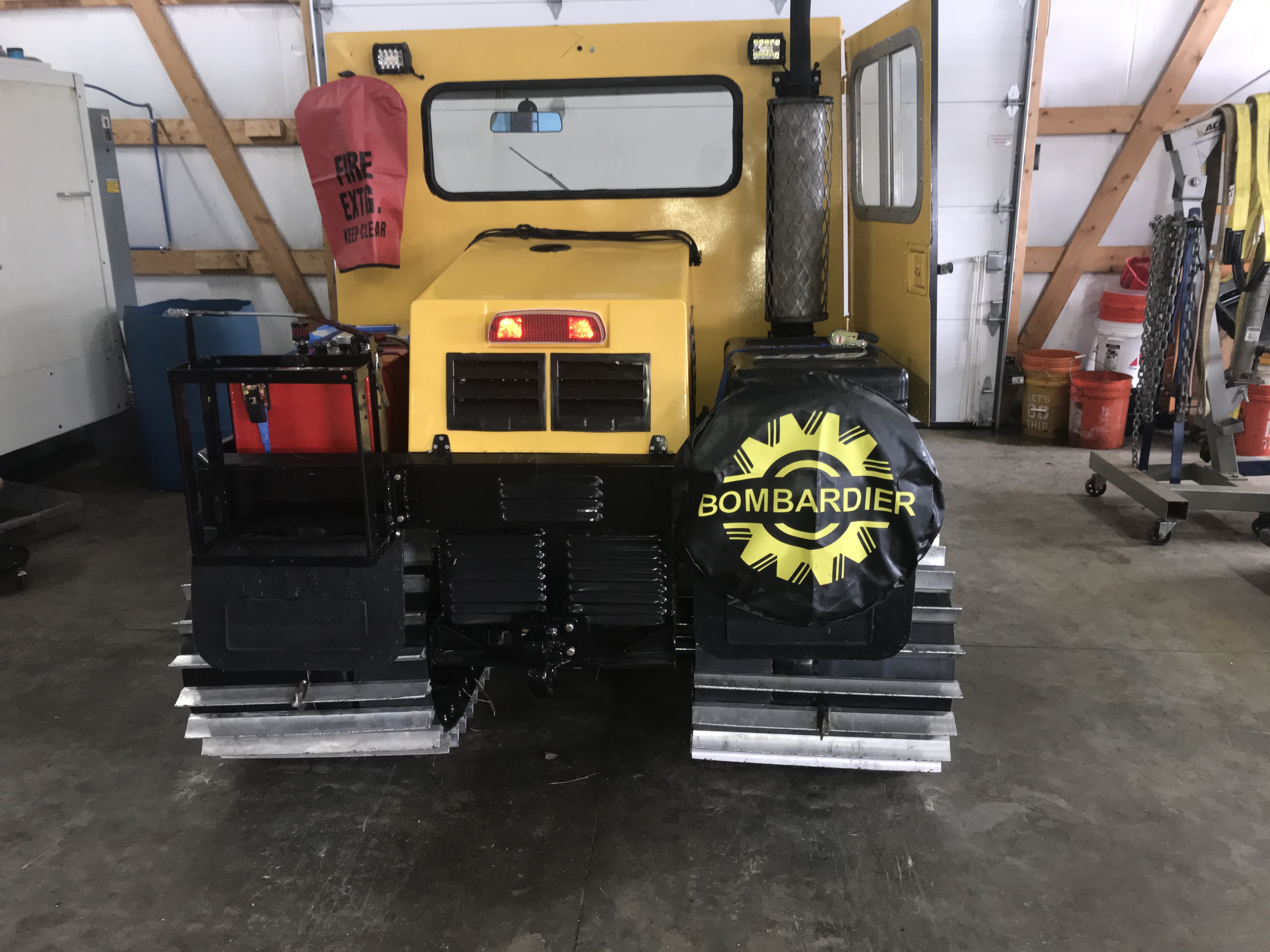

Couple more “finishing“ touches to go: added a Jerry can and carrier along with a Hardigg case for storage. I’ll add a spare tire over the next couple of weeks, but she’s almost there (minus a Bombi trailer I’ll build for next year). Truly a fun project!
A few vanity shots:

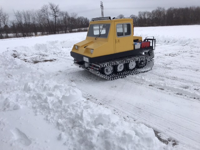

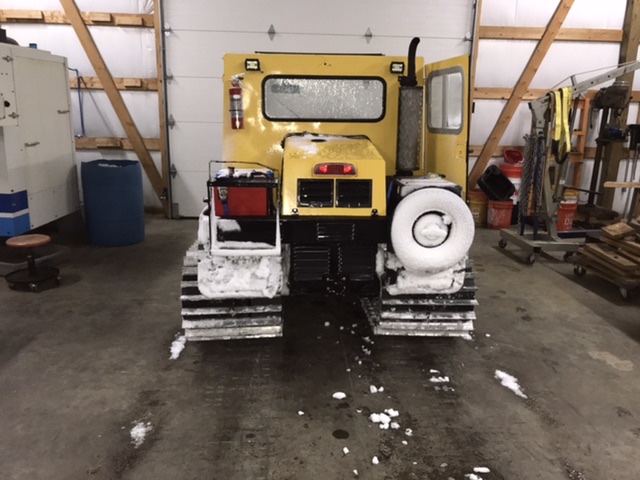

Got her out in the snow, ran great! Put about an hours time on the machine, tightened up the brake bands, turns on a dime! Fun! Mounted a spare tire (thank you Boggie) for “what if” scenario....but I can’t imagine changing a tire out in the middle of no where.

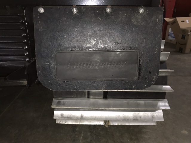

Replaced mud flaps. As Bombardier no longer makes these, I cut out the emblem from the old ones, super glued them to the new flap (CA is the best for rubber on rubber). Also, I’ve been using a rust inhibitor called ACF 50 on machine tools (tooling plates, gauge blocks, etc) for years (originally designed for aircraft).....and found it lasts about 2 years. On our machines, I use it on any non coated surfaces (carburetor, linkages, etc).

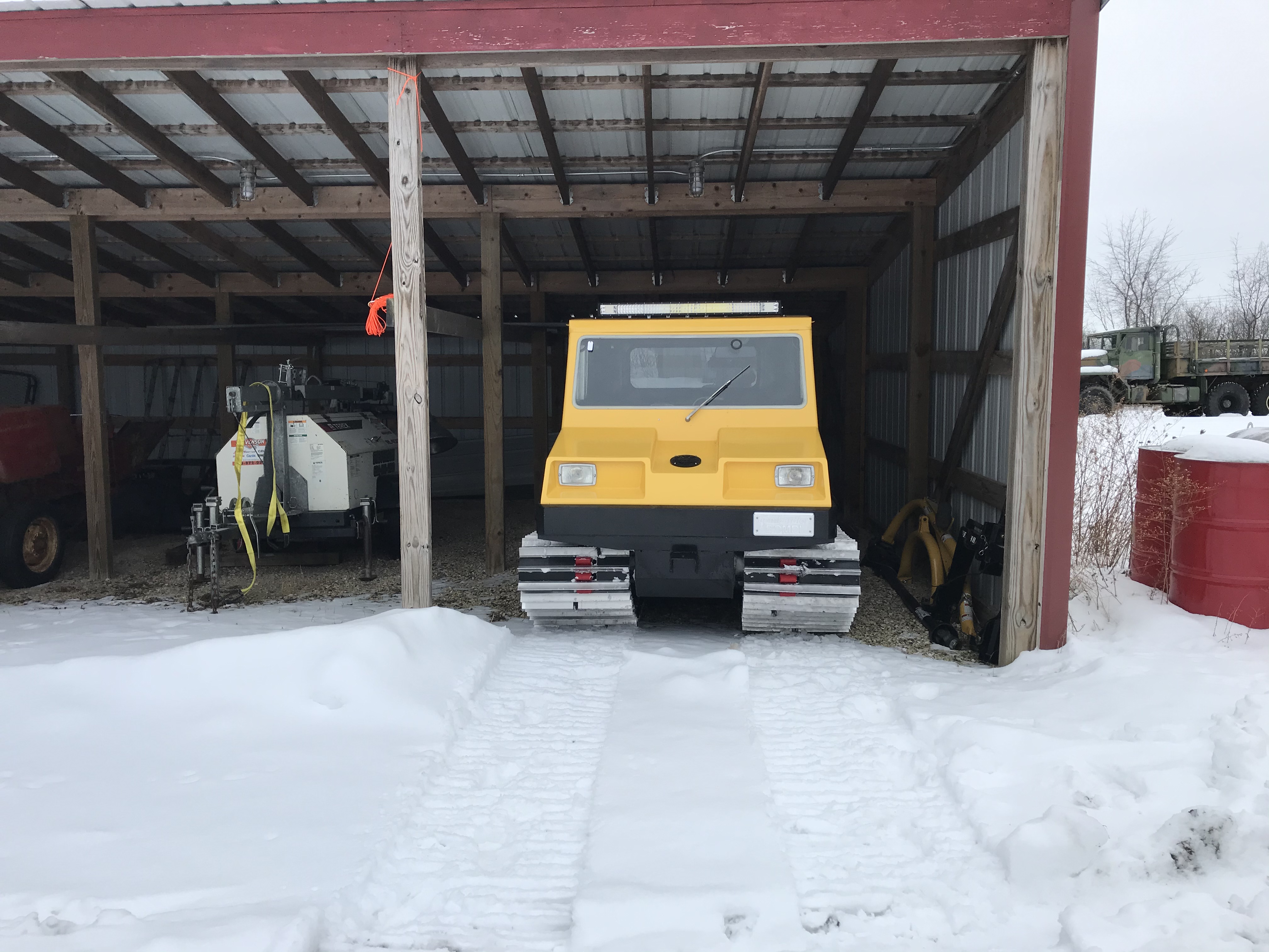

Project complete! Now going to build a trailer for the Bombi.....compete with those “Orange” things that use 4 tracks ?.
Parked for its next use....AND had a little garnishment made to cover the spare tire.

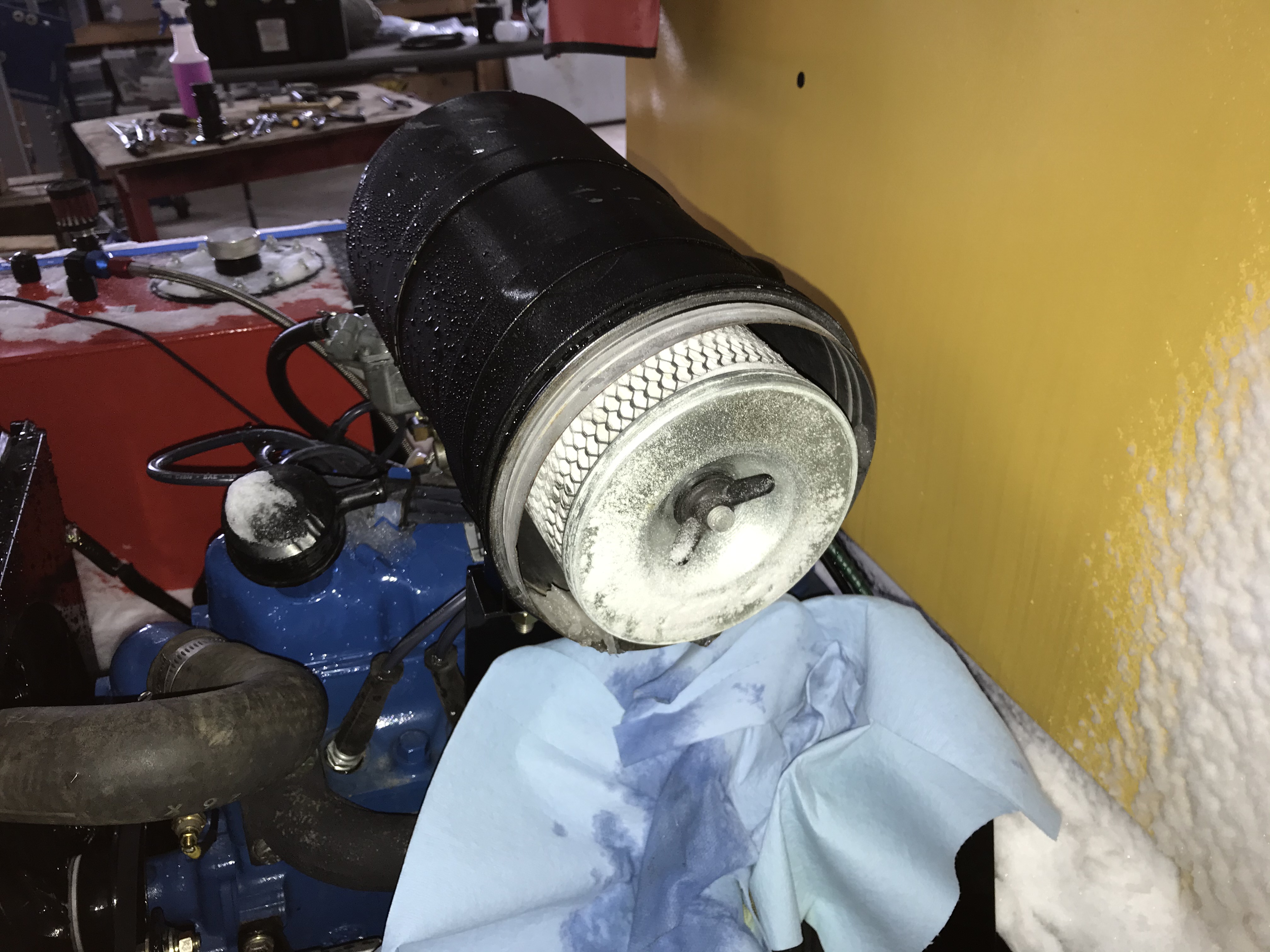

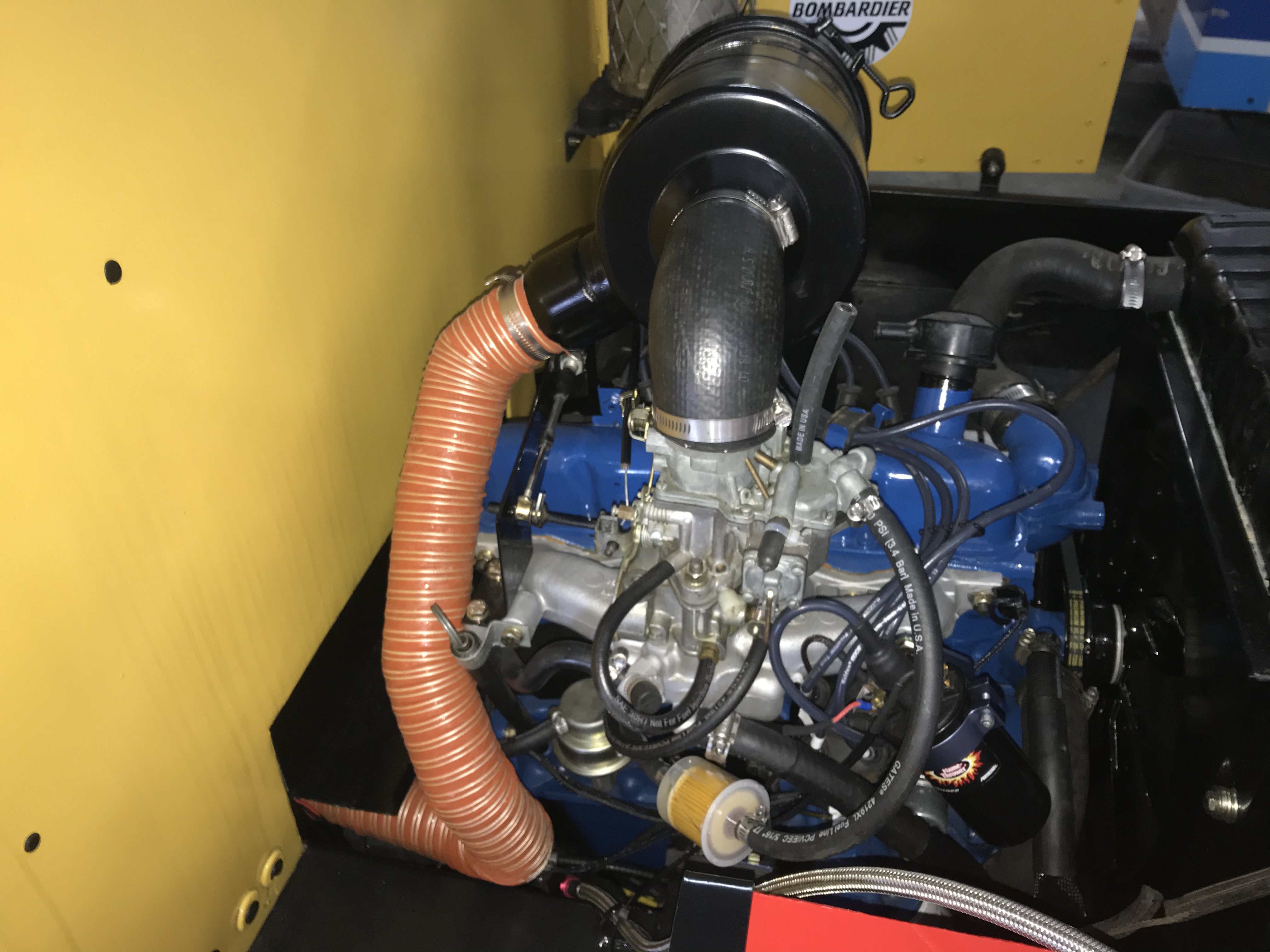

I figured out why Bombardier pulls the engine intake air in from the cab vs from the engine compartment......filter will freeze up! I ran the missing intake hose I left off from the air filter to the cab....all better.

Seems odd that they would have pulled warm air from the passenger instead of having some sort of VW type shroud to pull heat from the header area.
On a defender UTV we pulled air to cool the CVT drive from the cab. It was easier to hook up and didn't have any snow in it and that could have been bombardier thoughts.
Likely the cheapest solution with how tight the space is under the engine cover. The SW 48 does have a shroud to the air intake.

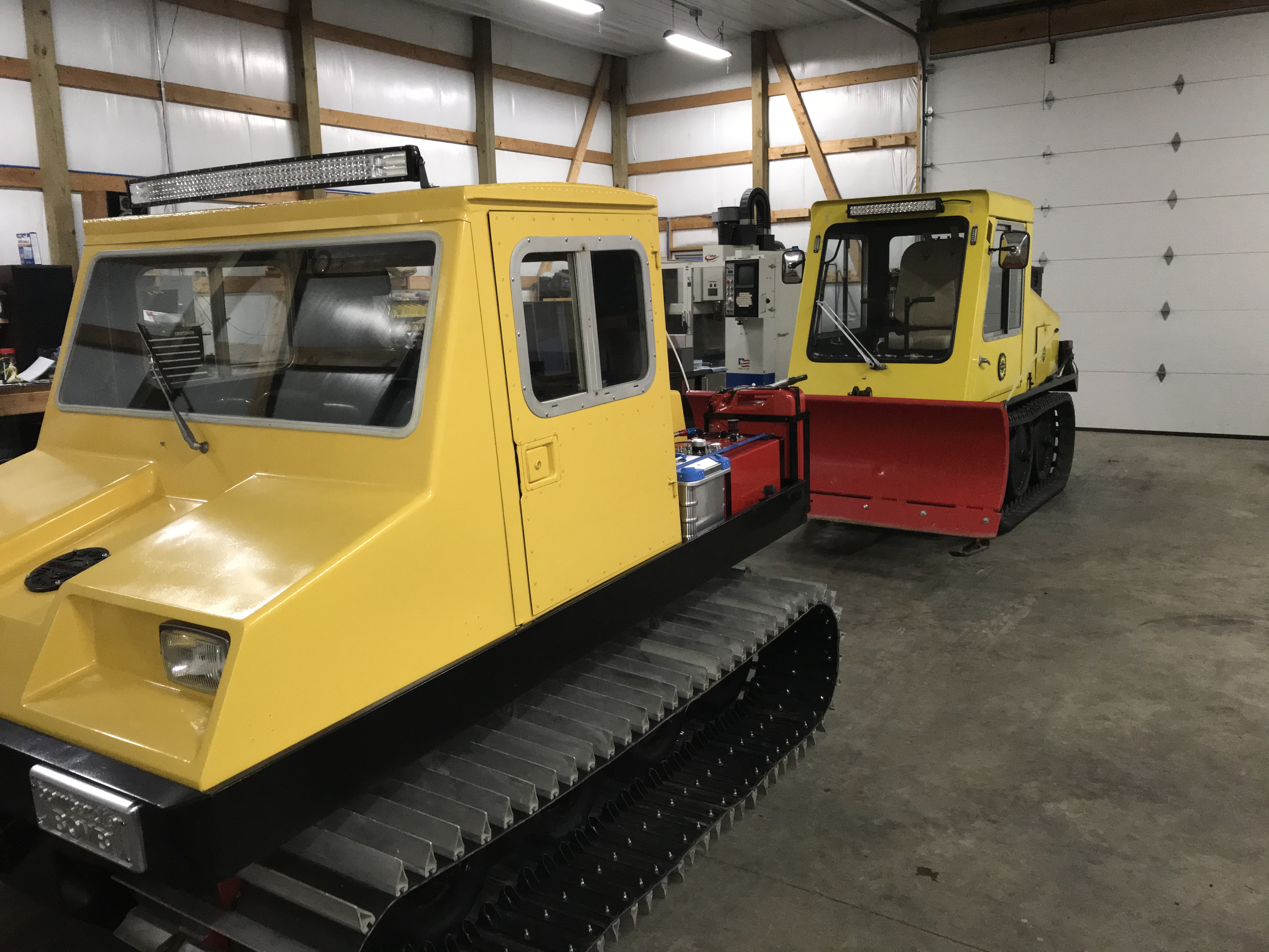

Sanded and painted the nose and engine cover over the weekend....a few sags and overspray, but for a weekend warrior, came out pretty good!
[/IMG]
[/IMG]
I placed the engine cover on the machine, figured out why there is a hole on the top (air cleaner front edge juts through, oversight on behalf of Bombardier or was this a mod prior owner did?)
[/IMG]
Boggie hooked me up with the paint type and formula Bombardier uses.....thank you Boggie! Looks OEM!
