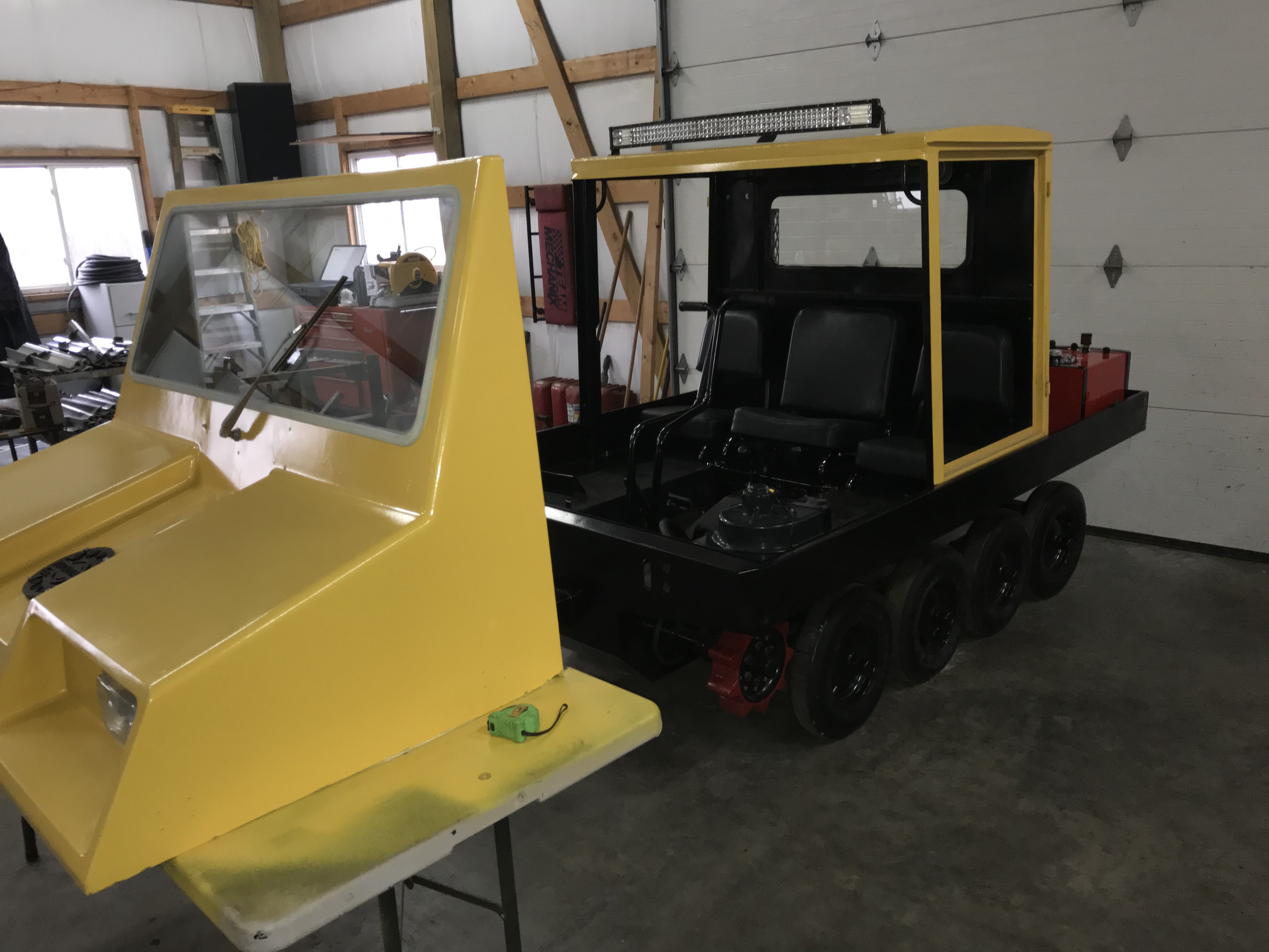

Sanded and painted the nose and engine cover over the weekend....a few sags and overspray, but for a weekend warrior, came out pretty good!

I placed the engine cover on the machine, figured out why there is a hole on the top (air cleaner front edge juts through, oversight on behalf of Bombardier or was this a mod prior owner did?)

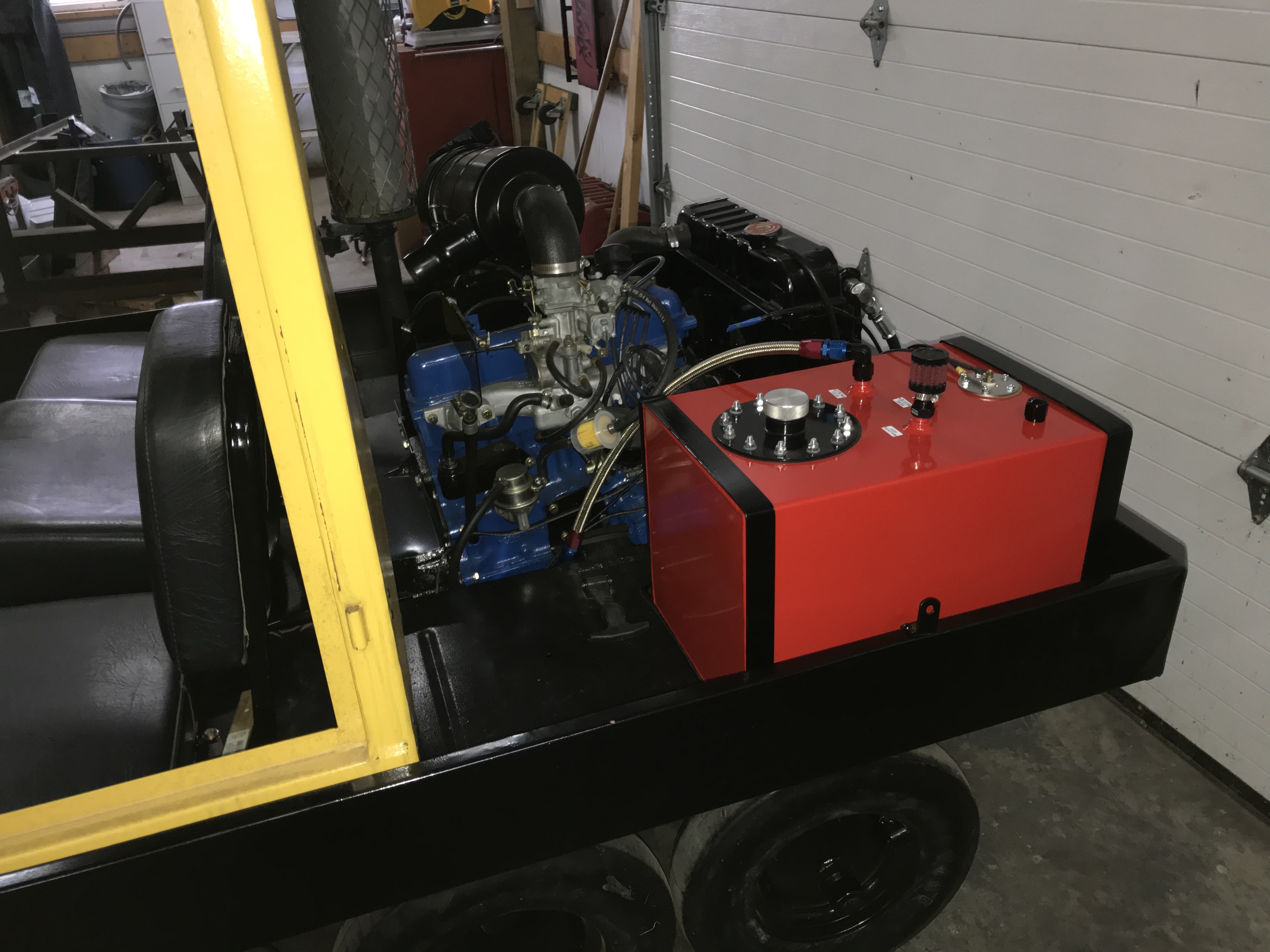

Almost there! Completed the wiring, installed a 12 gallon external fuel tank, added an LED light bar and rear lights....then mounted the nose. Turned the ignition key....fired right up! Noticed my gauges weren’t reading correctly.....mixed up the sending wires from coolant and oil, corrected...good to go! The original fuel gauge is set to a higher ohm, so ordered a SW fuel gauge that matches the fuel sending unit (0-90 Ohm).

Thanks J5 and Snowy. I’ve got a few more things to work on (lift engine and remove one of the rubber engine mounts....I put in two per side.....engine cover will hopefully sit flush after), assemble track #2, track down an intermittent parasitic draw (think it’s from the LED light bar relay, might just take relay out as wiring and switches are rated to handle load).

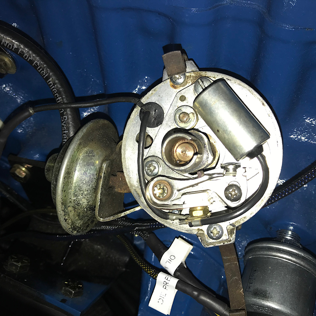

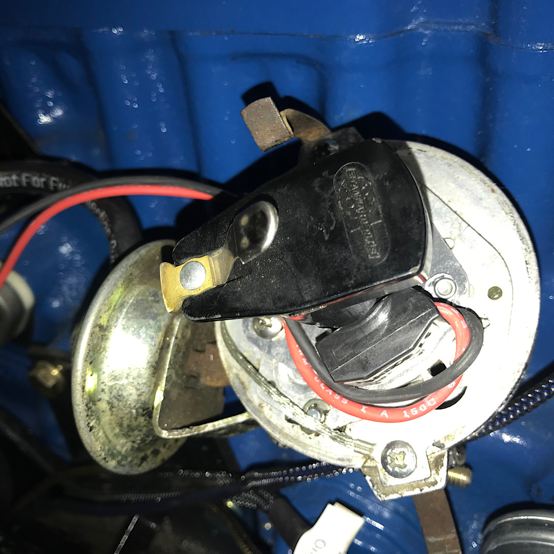

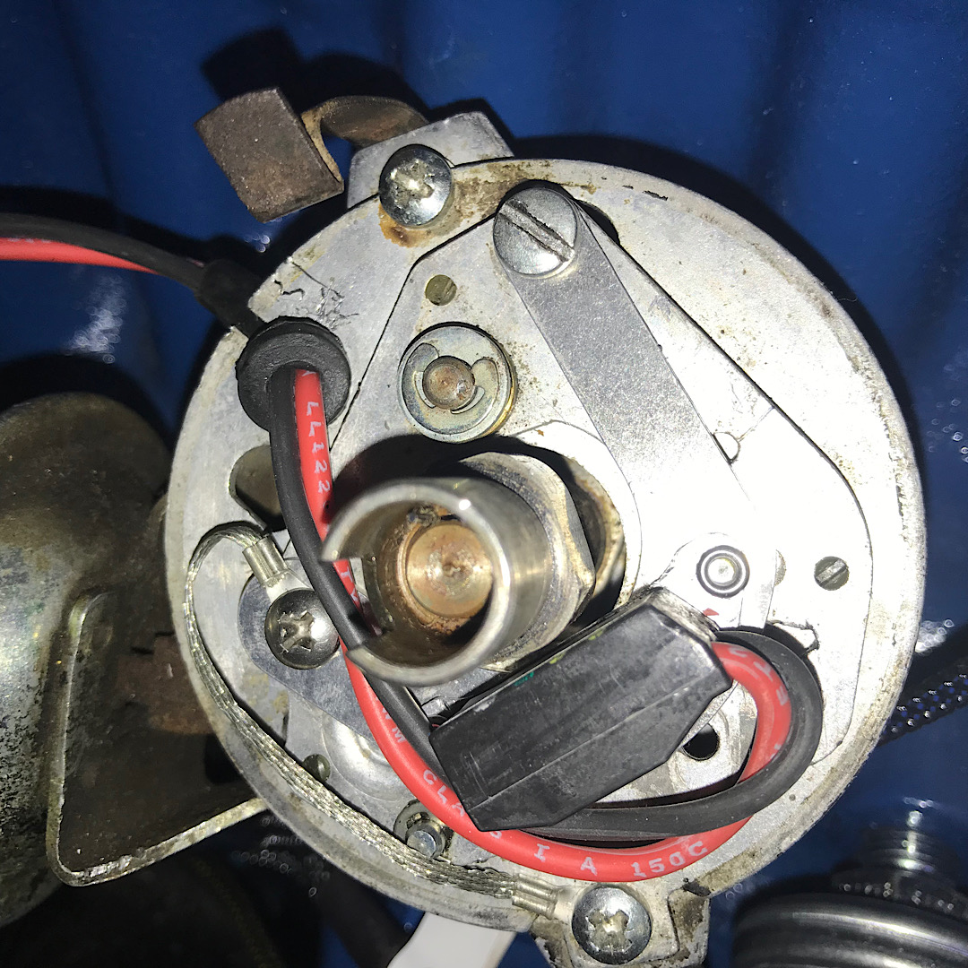

Putting the finishing touches on the Bombi before the tracks go on. Installed the Petronix electronic ignition (1241LS) today, worked like a charm! Engine fired right up, ran smooth once warm.....no more points! The Petronix 1241 LS (Lobe Sensing) works without the usual magnetic sleeve that would normally slide down over the shaft......instead, it senses when the lobe is within 0.010” to 0.035” of the pickup.... and triggers the spark.

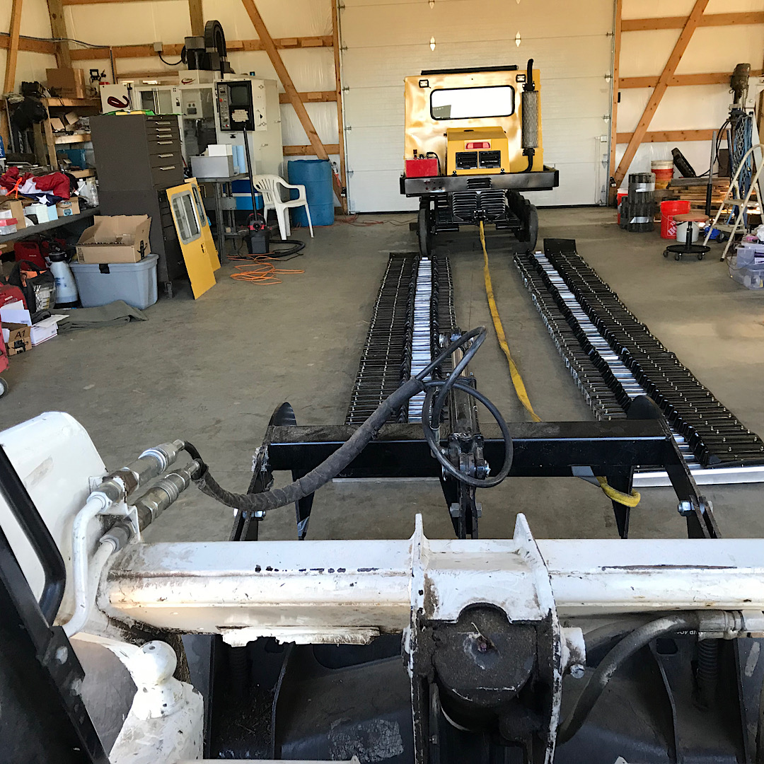

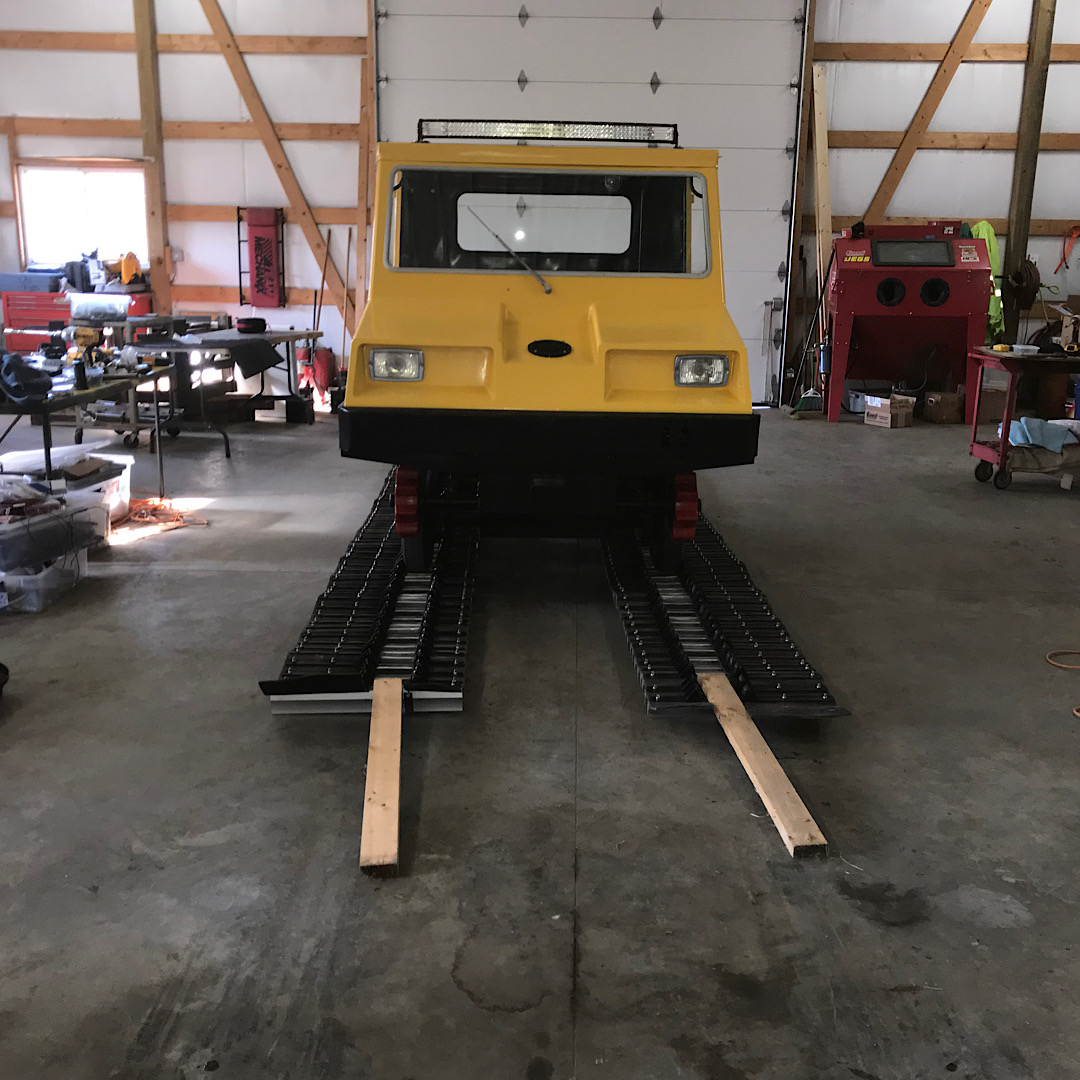

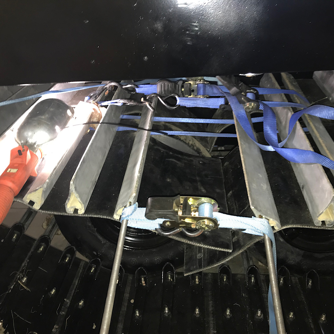

Finished the 2nd set of tracks this week....and with everything rebuilt and refurbished....it was time to give the lady her new shoes.....and go for a stroll! But like any gift, sometimes it’s not an exact “fit”....and round 2 begins. Ran into an issue and could sure use some help:
Tracks will not pull together to allow final two grouser holes to align. I’m about 1 1/4 to 1 1/2” from success.....but with no “give“ left in the tracks....and rear tension wheel fully stopped to next wheel.....was hoping someone has been down this road. Here’s a few pics from today:

Bob,
we always put the splice just below the front sprockets so you can get at both sides in the angled area. then take a 2“ratchet strap on the outside
placing it right over the points on the sprocket rachet the ends together. I have been known occasionally to used longer bolts to suck things together if needed on one set of holes with washers and then go back after the other cleat is on and replace bolts with the other cleat and standard bolt but don’t completely tighten until both cleats are in place. A round drift through the hole in the belt can make a pretty effective lever also

Thanks Brad! I’ll get the belt in front of the sprocket and then pull them from there. I ordered a 5/8 diameter pair of 3 foot rods (I only had 3/8 threaded rod on hand when attempting this today) and give it a go! I’m thinking with foamed tires, there’s little give until the belt wears in a bit.

How warm is the shop? What about cranking the heat in the shop to soften up the rubber?
Hi Ezroller
I had the shop up to 60 degrees last night and today. I thought that might help, but considering it’s vulcanized rubber, didn’t give much (god knows I tried). I’ll use Brads technique (he’s our go to on anything that moves over the snow) and report back next weekend.
Curious....?????
What dimension did you use for the length of the belts ????
In looking at my own track issues I researched the factory length and found discrepancies from various sources.
I finally took the number of grousers times the pitch of the sprocket teeth... In my case it is 72 grousers on a 4" pitch. 288" total.
My old belts had laid out in the sun and shriveled up about 4" over the course of time....so they were useless as far as gaining any usable numbers....
The 288" number on mine did agree with two of the four sources I had searched...The 2100 uses a mechanical belt lacing....and this uses up some of the belt length bringing the actual belt length to 286-1/2" of actual belt.
