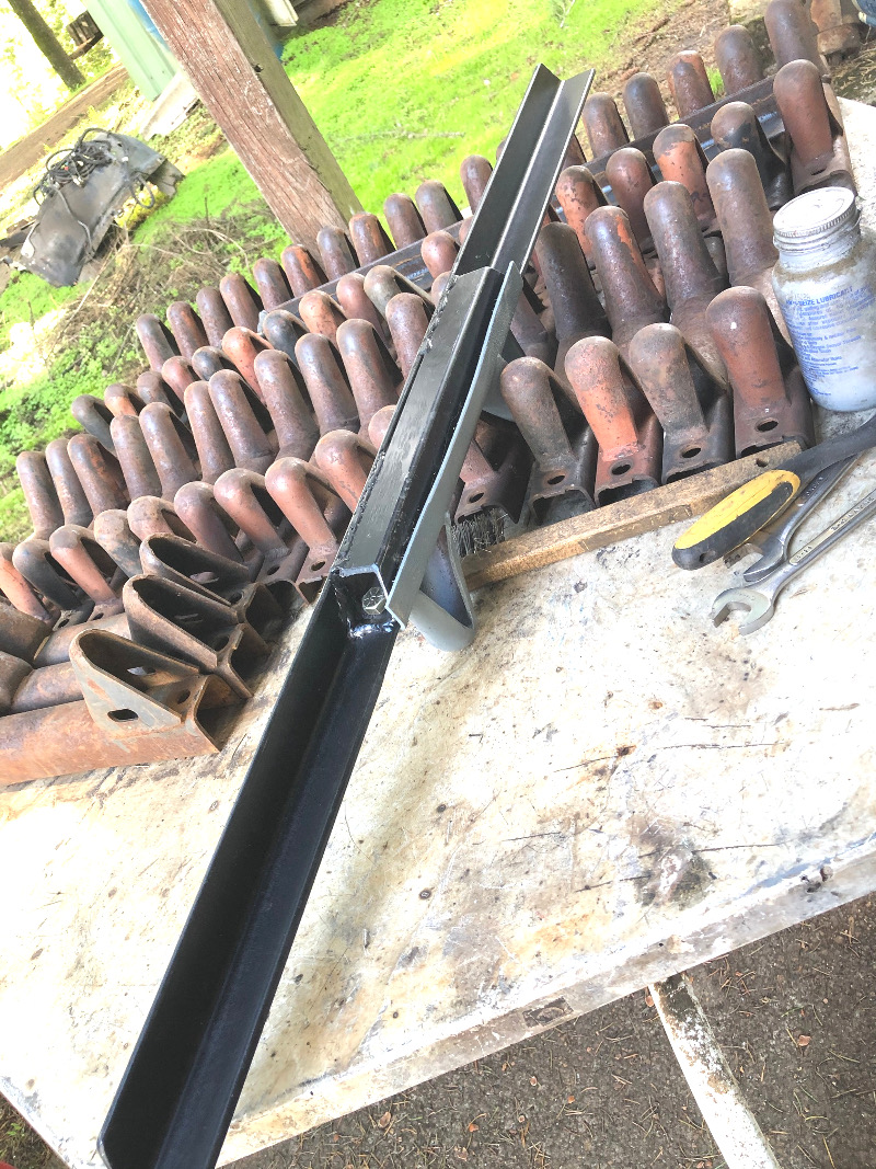

I have my track issues handled.
3 ply belting ....Two 12" belts with the tire guides between @12"
This give me 36" tracks......Should be pretty good.....
1-1/2" x 36" angle grousers with a 12" box tube in the center where the tire guide bolts on.
The road wheels are 92" on Center on the 2100 Machine is still gonna be 10 foot 6 inches wide.
It had 57" tracks originally......

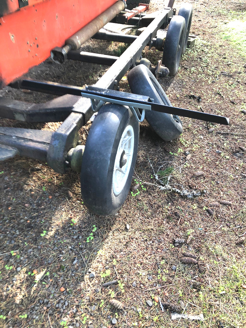

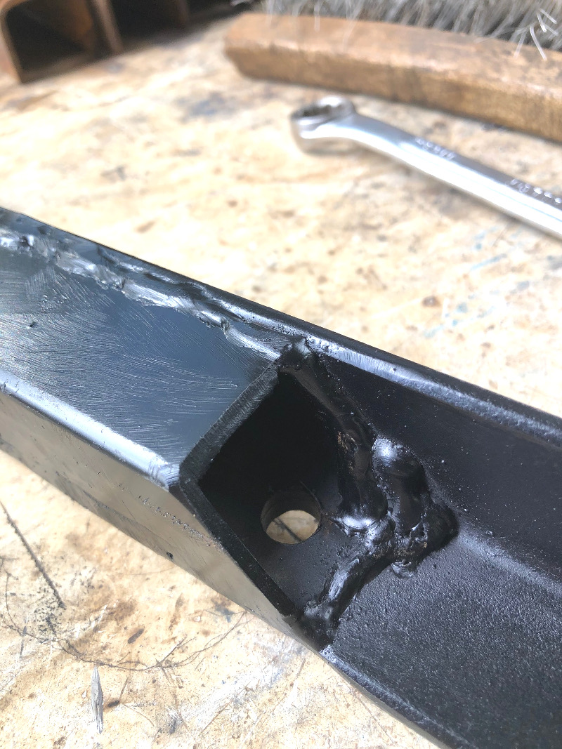

Finished the tracks over the weekend, took her out today .....ran like a top! (minus the snow) I was able to get both tracks connected using 5/8“ diameter 3 foot long bars, ratchet straps....and bolting together one row of holes, then installed the tire guides on the remaining row. Thank you all for your help!

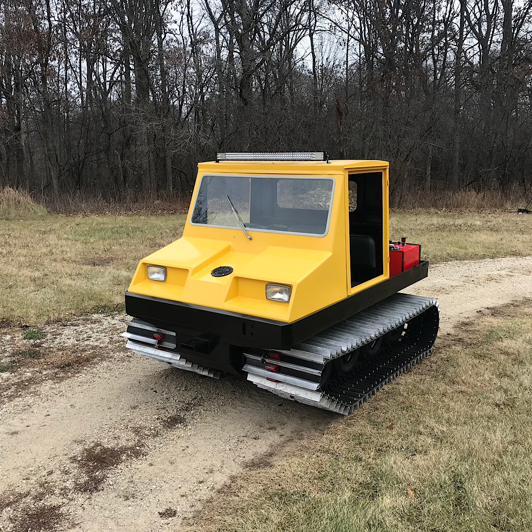

Bombi is complete! Added a fire extinguisher as it’s finishing touch (the cherry on the cake)......will add a storage trunk and a spare tire later on. Now the hard part begins.....what to rebuild next?
